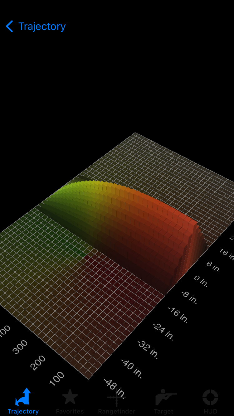

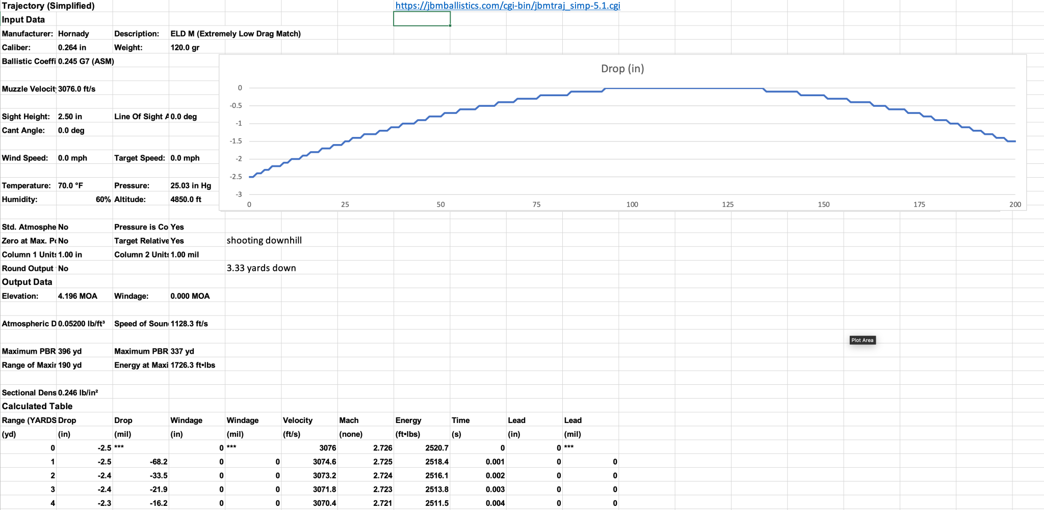

Does anyone know if there is a ballistics calculator/data program that will automatically graph out the data like this? I use the JBM Ballistics for the data here, but I had to put the data into MS Excel and graph it manually. I would like to find a program that has this feature built in. It's helping to visualize the actual path of the bullet. In this case, it's surprising the path of the bullet doesn't crest the line of sight more than once, but rather is tangent to the line of sight.

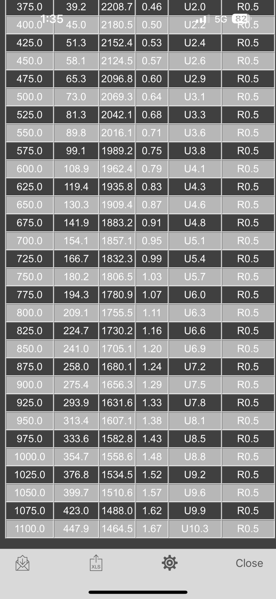

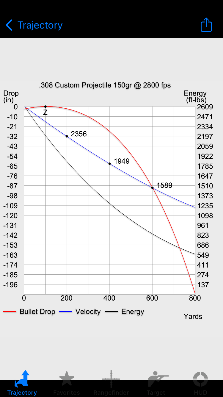

I don’t know much about that, I’ll post a couple pics that are from ballistic ae, but they are features i never use. Might be helpful to conceptualize what’s happening.
Just keep in mind most of them are not to scale, like in your graph the height to distance is many many times out of scale. But it gives a good visual.

This is for what? I don’t know.
Good point. It is NOT to scale. I am still having enough trouble putting axis labels on this chart. Seems every time Microsoft releases a new version of this software, they change things (trying to make them easier I imagine), and then I can't find anything in it. :).
It's tough to display a few inches in elevation change over the course of a couple hundred yards.
Can you change that Trajectory data to 2-dimensional? That might help. Also, change the graph to only display the data over 200 yards.
What I want to display is all the difference scenarios that were in the video that was posted earlier in the thread.
The 3d part is 3d, I don’t see an option to change that, but there may be. You can download the app for free.
Here is a rough approximation of the graph at 200. Might be easier than the Windows thing.

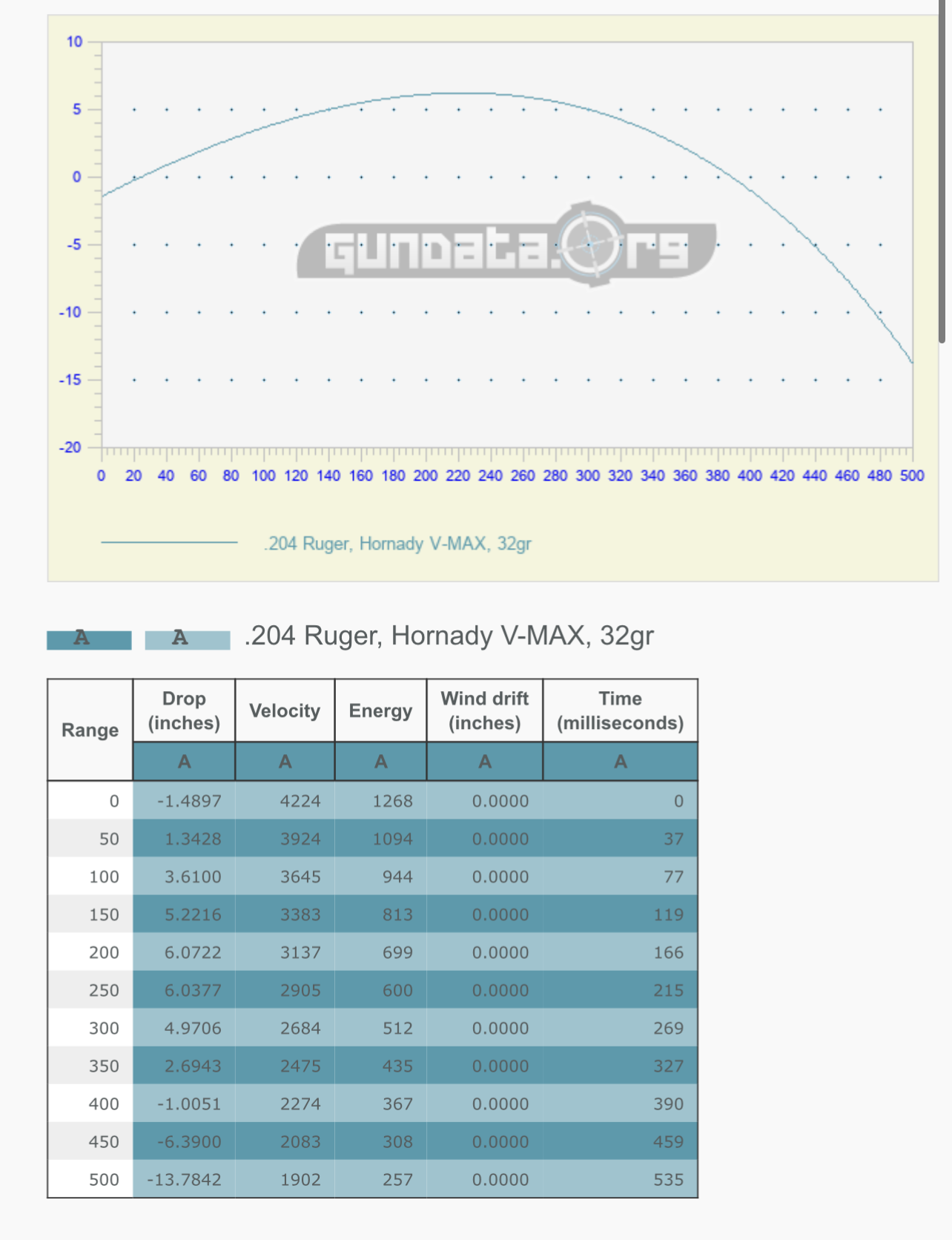

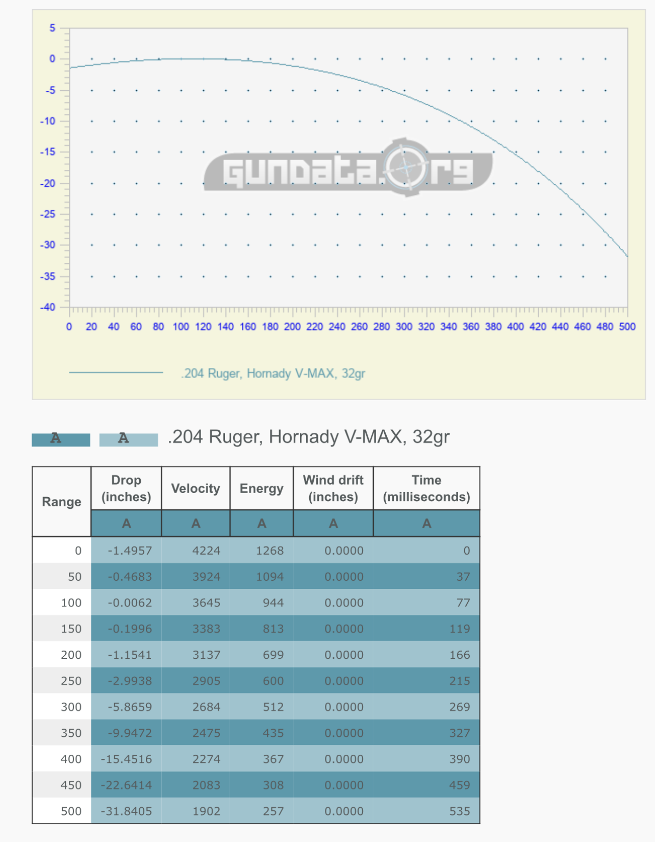

I’m not sure if the OP is looking for something like this.
Here’s 204 Ruger 32 gr 0° angle, zero 100yds:
Same as above, zero at 25 yds:
Seems like this calc doesn’t do negative angles…

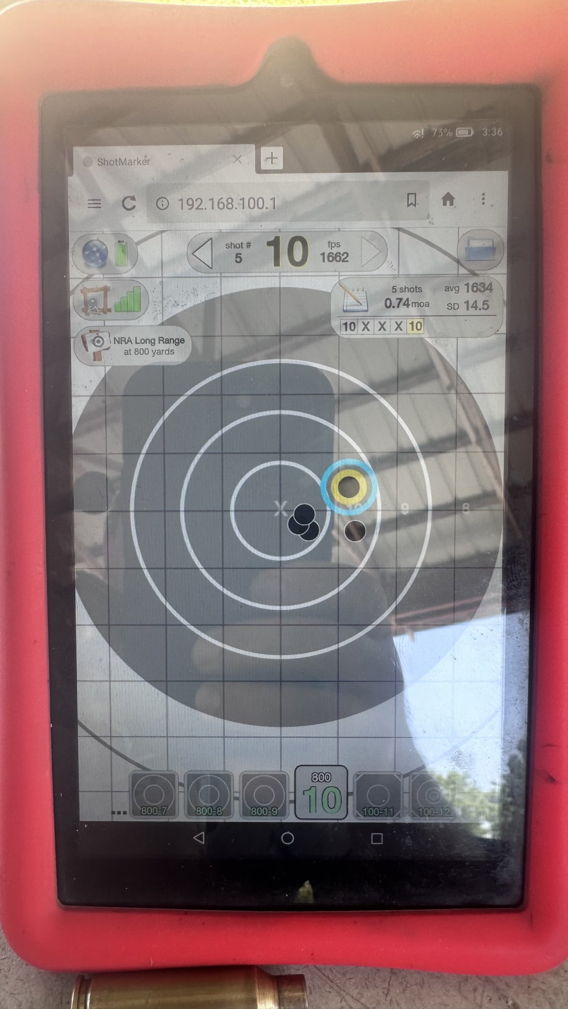

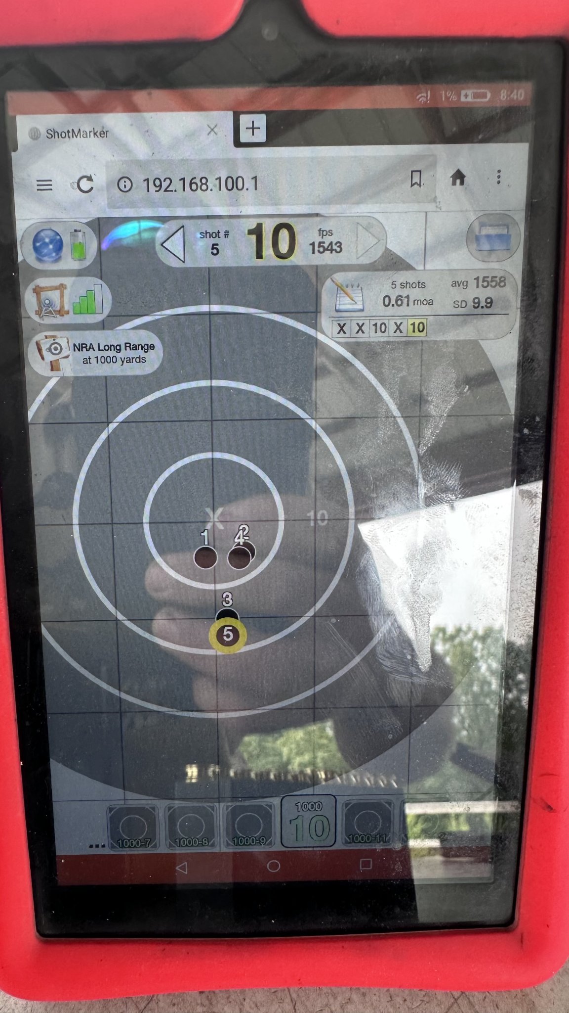

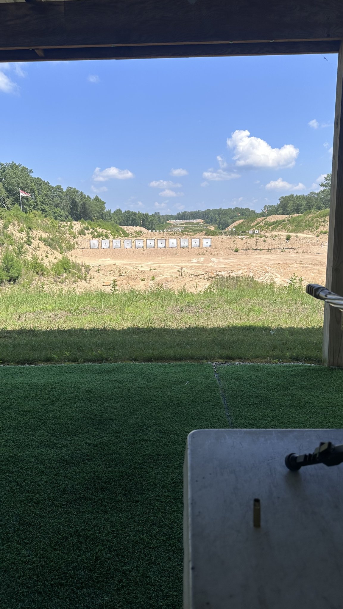

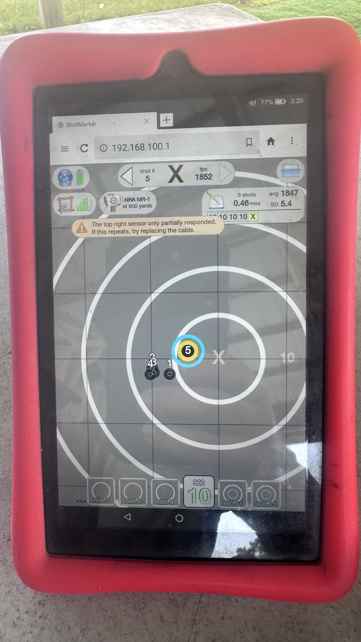

This is dead zero shooting park in Spencer Tennessee.
There is a lot more than 6’ of elevation change in this range.
All elevation was dialed
The targets you are seeing are at 100y, 300y, 600y, 800y and 1,000y
The lowest targets are the 600y. I would estimate that they are a good 40’ below shooting level maybe more.
The 800y targets are the 5 on the far left below the wall of 1,000y targets.
I ran out of hand loads at 600y so I switched to several factory rounds. The target I posted several posts above at 1,000y was Hornady 147gr ELD-M.
The 800y target were Sierra Custom Competition with 140gr SMK’s.
The target below are my hand loads with 139gr Lapua Scenar.
They are within 1/2 moa of the target center (vertical)
Each square on the target represents 1MOA.
On the fifth shot I was correcting for windage but I wasn’t quite there.
The point I am trying to make is that if you have a good zero and proper zero weather data plugged into most any good ballistic app you can shoot a group at your furthest distance and use the truing feature to bring every other distance in line with where it should be.
Gravity is a constant so trying to shoot at every distance out there is pointless.
Shooting from furthest back to closest will be more fruitful.
All I did here is hit the “calculate” button using the info that they prefilled when the page loaded.
Looks like you can compare two bullets and also add in the angle (under advanced).
Not sure if that’s what you’re looking for.
This is exactly what I was looking for! It shows the graph of the data and easily allows me to change the zero yard spot. I can lay over all the data I want! Thanks!

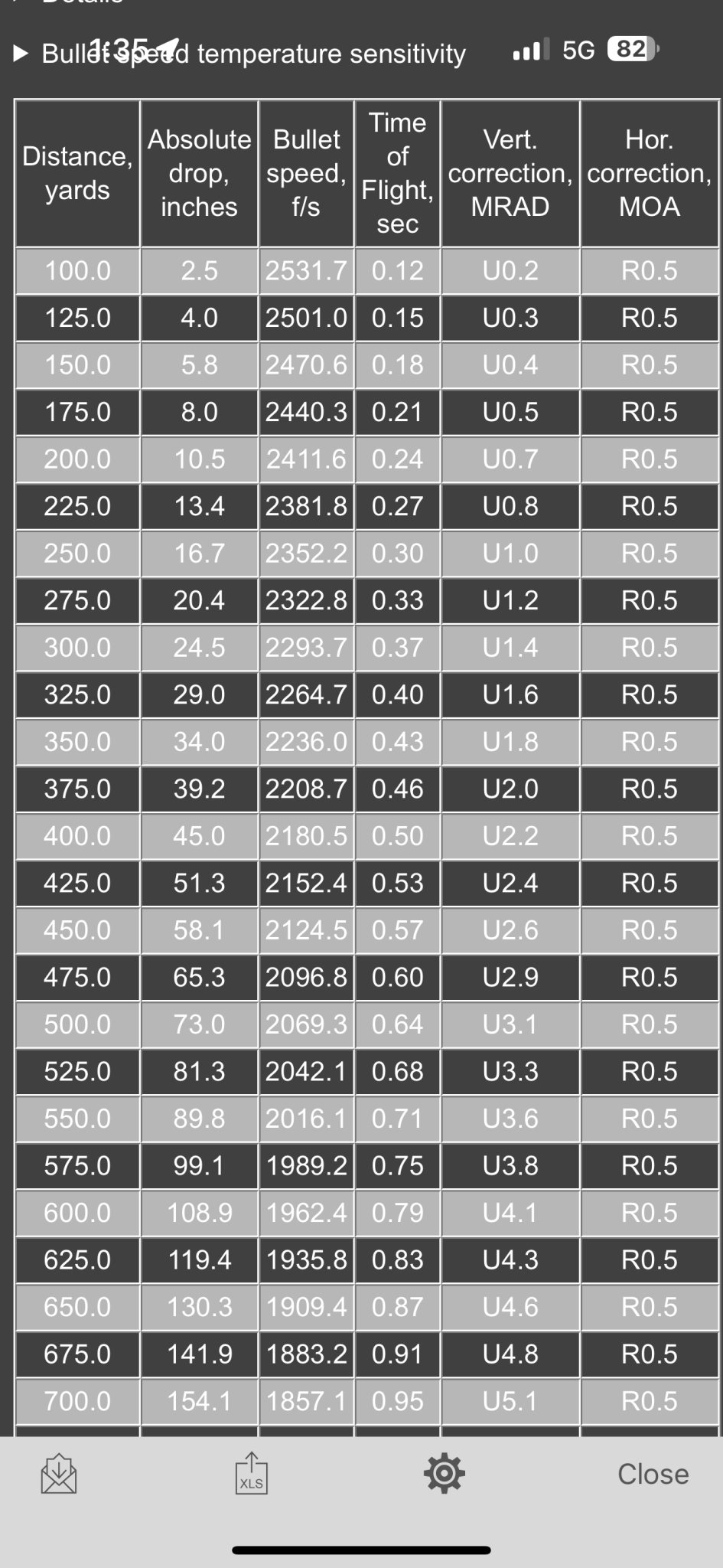

This is helpful
This is for what? I don’t know.View attachment 8494381

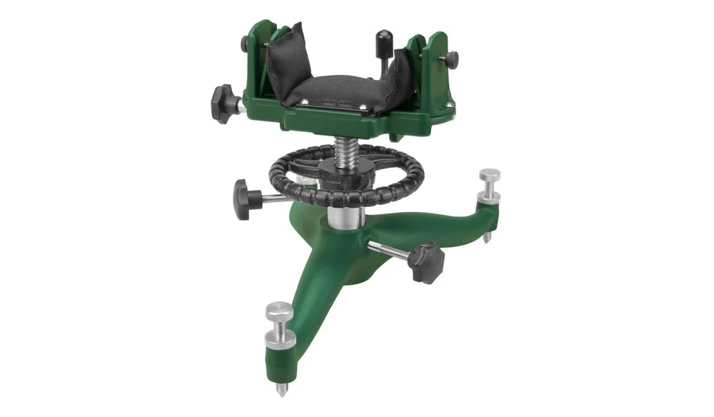

@yo-yo - I just saw your other thread asking what is the butt stock with a mono-pod in some pic you found.
In that thread you said you are shooting out of a lead sled, you don't have a bipod, and you seem very unclear about how to use a rear bag (and what constitutes a good rear bag).
All of this may well contribute to the accuracy issue at 200 that is being discussed here.
Am I wrong?
Reactions: yo-yo and spife7980
Am I wrong?
Yeah, I tried Caldwell sand bags and hated them. I ended up ditching them and going back to the sled, which is super stable, so I would think that would help stability, wouldn't it?
My friend wants me to buy a bi-pod, but I didn't really like shooting off it either. Perhaps it's something I could learn to like though. I did buy the Caldwell Stinger though. It should arrive tomorrow. If I don't like that, I will return it for a bi-pod. :)
As for lead sled…no. Not IMO. How are you going to control recoil in one…and the gun definitely moves before the bullet exits the barrel. If they were that stable of a shooting platform you’d see it in use at the range by many others. Again, just in my def non-expert opinion, the only thing they are really good for is bore sighting as it will hold a rifle (unfired rifle) in one position so you can look thru bore and then thru the scope to get close (on paper) and then refine your zero by shooting.
As to the mechanical front rest….well, they seem popular with the bench rest guys but they also often (always?) free recoil their rifles.
The F-class open guys also use big mechanical front rests but I’ve heard that called “prone bench rest” lol. But those guys sure know how to make consistent ammo and read the wind.
My personal suggestion is, as mention by others, get a good bipod and rear bag then get some instruction on how to use them.
But I’m nobody and…as I said…I’m no expert.
Best of luck, my friend.

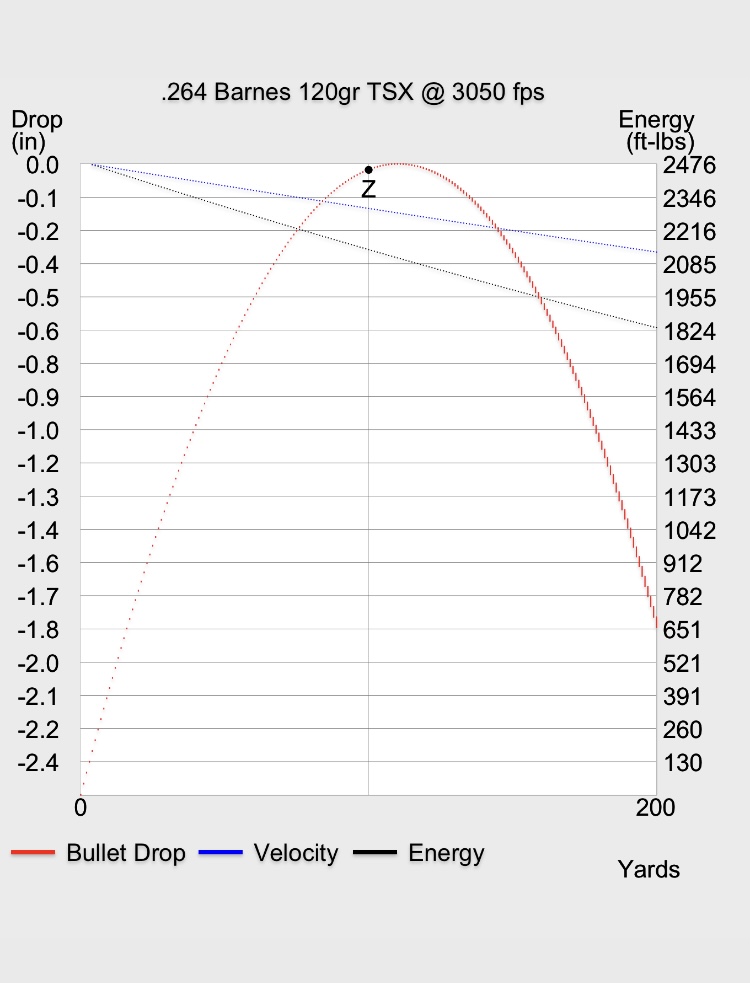

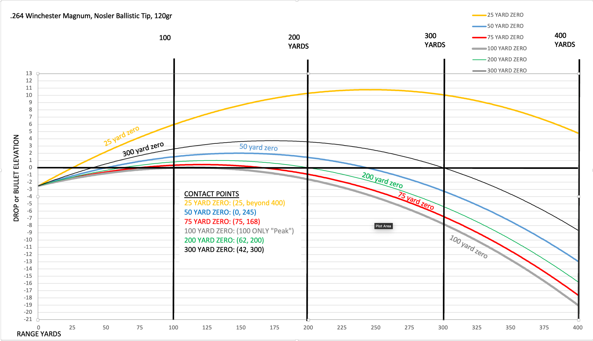

So, I put together this graph of zero points, relative to a 400 yard shooting range. This is the different positions the guy in that video showed in his presentation. Zero'd at 25, 50, 75, 100, 200, 300 and shooting shots from 50 to 400 yards. This is kinda shocking to see how each different zero point creates the different crossing point of the "line of sight" of the scope.
I used "gundata dot org/ballistic-calculator" to compute the data and I used a .264 Win Mag with BC and velocity altered to math that of my 6.5 Creedmoor. This sight didn't have any 6.5 Creedmoor selections.

Hmmm...what makes you say the bullet trajectory can be affected by the recoil? I thought these bullets were traveling fast enough that wouldn't be an issue? I haven't heard of that effect. .
Don't make this more difficult than it actually is.
The extra dampening of the recoil in the lead sled does not affect the "trajectory" when using that term to define the ballistic curve. It can however produce a different POI compared to shooting the same rifle/ammo combination from a different type of rested position. The lighter the rifle and the heavier the recoil impulse is, the greater the difference in POI between the two styles of holding the rifle.
Your POI is of course simply the endpoint of your trajectory. If you induce a change in the zero by changing how the rifle is allowed to move during recoil, the trajectory of that shot will bring the curve across different points. So changes in shooter input during the shot will change where the ballistic curve exists in space.
Same rule can apply to POI when shooting from tripods, barricades and unsupported positions.
I'm not happy with my choice of words but it's late. Hope this helps more than confuses you further.
Brother...the gun moves due to recoil before the bullet exits the muzzle. This is a fact. This is why people work on building their firing positions and their fundamentals including natural point of aim, trigger control, proper use of a bipod and rear bag, etc.
Little story from a Frank/Marc (Frank is Lowlight...owns this site, right) clinic I took where Frank asked if he could shoot my rifle. I said yes and he proceeded...with my dope...to bang steel at 600 yards. I get down with same dope and I'm shooting consistently high. Both Frank and Marc pointed out that my rear bag was slanted rearward letting it hinge a bit on recoil so the butt goes down and the muzzle goes up....all before the bullet exits the barrel.
I corrected my grip on the rear bag and was back to banging the target.
And this too was with 6.5 CM and a 23 lbs rifle.
Let me repeat this: the gun moves due to recoil before the bullet exits the muzzle. This is a fact.
Cheers
Hey, thanks for the explanation. I'm certainly not wanting to make something more difficult, I'm simply inexperienced. I understand what you are saying. I wasn't aware there were measurable movements in the barrel, prior to the bullet leaving the muzzle. I just watched some high speed videos showing such. Interesting!
I wasn't aware the sled might actually cause issues with POI, or be less precise than a bi-pod (and a rear bag). I just thought it was preference. I will experiment with this Stinger mechanism I just ordered too, and if nothing else, use it as a gun vice to hold/clean it, if it's robust enough.
I will likely end up with a bi-pod and a bag. Thanks for the thoughts!
Reactions: Terry Cross
Cheers

I’m a bench shooter, not prone. I find my groups are a bit better with a 14lbs x-shaped bag (vs. bipod) and the rear bag (The Compromise) made by our very own @Enough Said.
The front bag is now made by Armegeddon. Can’t seem to find it via their nav, but here it is:
I have the medium. Order it filled with the plastic regrind, if they still do that. Unless you hate yourself, don’t fill it yourself.
I imagine a good bipod shooter would be just as (or more) accurate than me. But I find that bipod technique needs more care, plus in the field it’s slower to quickly transition to multiple pdog targets. For me.
Thanks for posting this. Somehow I missed this post before. Yeah, that's super interesting to me how the path changes, and the "zeros" inside 100 yards are actually calibrated to the first crossing the bullet makes with the line of sight of the scope. I'm still ingesting this idea a bit. After plotting these out a bit, I see the reason the military tends to use a 300 yard zero!
