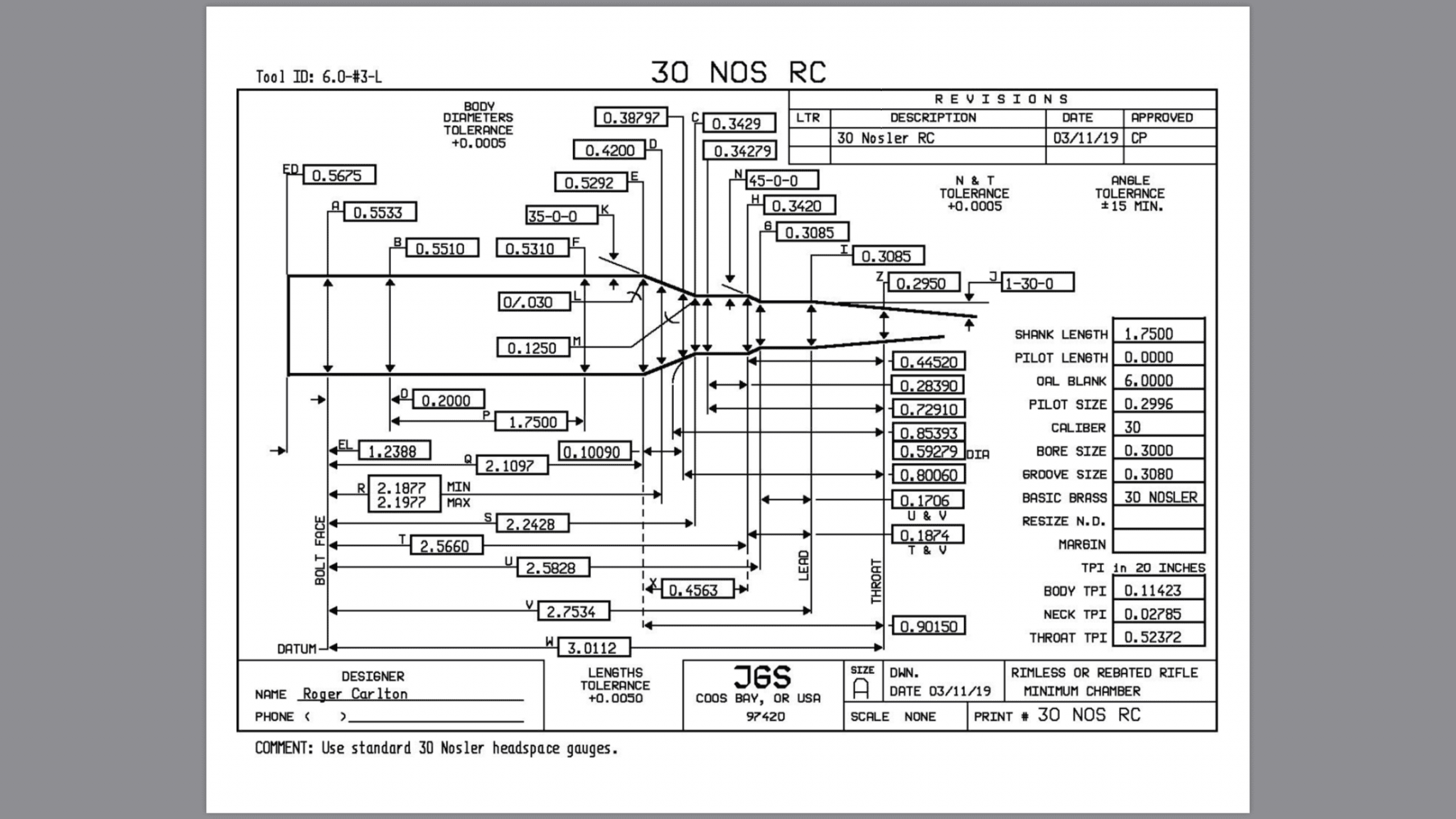

    So I think from the top of my head the case at the .200 line was .548 - .5485 and resized was .5475 to .547
    Reactions: rijndael
    id still like to hear the measurement at the head not the 200 line....i still think this is a die issue not an action issue or a chamber issue unless like @406shootist said the reamer was worn or out of spec.
    Remove the barrel and measure how much protrusion a round or piece of brass has. If you do not have a depth micrometer use the shoulder measuring feature at the dial end of your calipers it will be more accurate and easier than using the depth feature.
    An ARC can have .150" protrusion on a case that big without issue. Likely it's binding in the case head where the die can't quite size it down enough.
    The problem may be solved by going to .150" protrusion if it doesn't have that much already.

    The case could simply be sitting too deep in the chamber and binding in the case head where the die can't size it down. Case heads grow over time and a die can't size them down enough. You need case head support to prevent separation but I have found they can be over supported especially with magnums which simply have more surface area to bind up the case. Almost every R700 clone and several others allow for up to .155" protrusion. Some Savage prefits can only have .125"-.130" of protrusion. That could be just enough extra surface area to give you that resistance at the top of the bolt lift.
    That makes since because it usually happens s after 3 to 5 firings
    I ran a 30Nos from sammi body spec chamber, used redding type S dies, adg brass. The problem with adg brass, the web area is thick and it is very resistant to sizing. Very tight dies are needed. I had no issues with die/chamber/sized/fired brass fitment. I had a spicey load of 3100 with 215 Bergers that would give me light clickers, it was warm. Ran it at 3010 without issue. Other thing, the first firing needs to be LOW psi. If you fireform at 65k psi, you blew out that web area as its softest first firing, ans now its larger than it should be and reducing sizing possibly. With a chamber at 551 and your sized brass at 5475, that should be plenty. Whats fired brass above the extractor cut?
    ^^^^ THIS!! and thank you for putting numbers to this sir.
    @Schw15 as ive been saying your die is not sizing the base enough....i shot a BRX with the same exact issue...as a matter of fact it was 3 of us having this issue...i bought a small base die and that solved the issue and eventually i just ordered custom whidden full length sizers.
