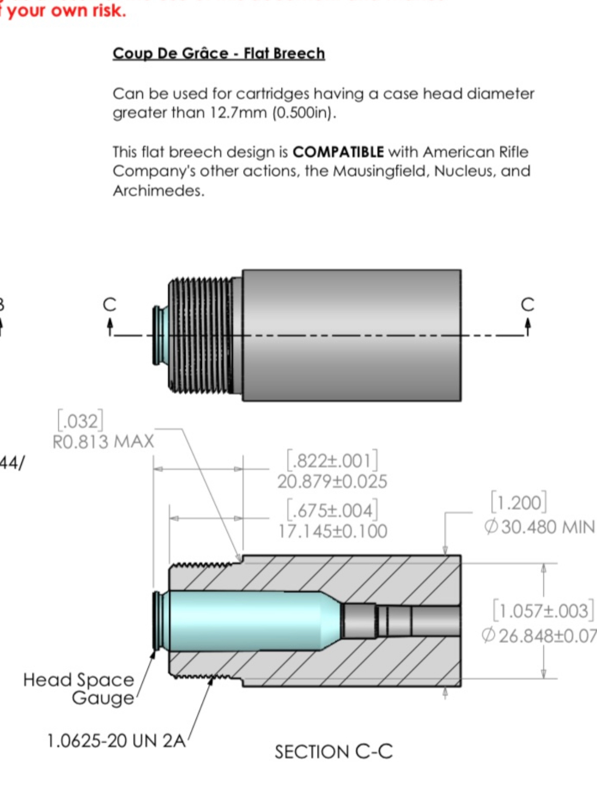

"HeysKSFirefighter Banhammer Banned ! Minuteman Jan 16, 2011 4,145 2,633 Assholistan Mar 13, 2024 #55 Mar 13, 2024 #55 https://www.americanrifle.com/web/content/145679#:~:text=Coup%20De%20Gr%C3%A2ce%20%2D%20Flat%20Breech,Mausingfield%2C%20Nucleus%2C%20and%20Archimedes. If I understand that diagram correctly (maybe I'm not), any .473 bolt face cartridge will be conical breech and is not compatable.
Geno C. Dirty Carnie Full Member Minuteman Oct 24, 2007 7,057 16,165 41 Wautoma, WI Mar 13, 2024 #56 Mar 13, 2024 #56 Correct. But there are people that are using flat breech and still getting them to feed fine. There was at least one in this thread.
