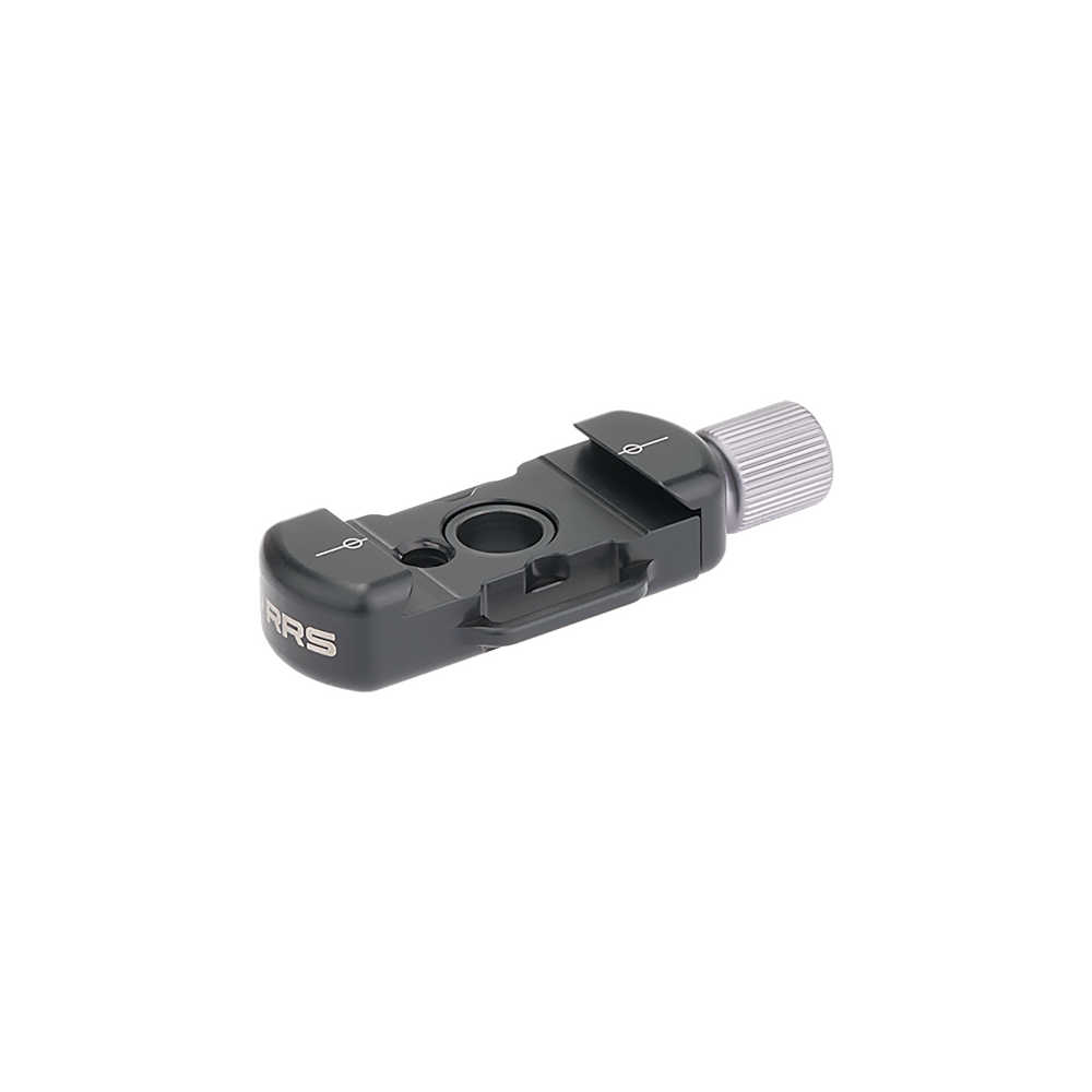

I have and enjoy arca rails from HRD and Sawtooth on my AI and AICS rifles. One thing I need is the ability to shoot slung up. Right now I use the pic rails with QD mount but need to wrap the sling around from the 3 o'clock side but that's not as comfortable as the more conventional 9 o'clock. Is there anyone out there making an ARCA or RRS Dovetail clamp that just has a QD/Flushcup on the bottom to meet this need?
It's sort of the opposite of what most photo people need so it's basically a shooting specific demand.
YEP!
http://www.reallyrightstuff.com/B2-FABN-Micro
or if you do not want to use a qd flush mount,
http://www.reallyrightstuff.com/B2-FABN-38mm-Screw-knob-clamp-with-strap-bosses

right on, you got me, I did mean I'm looking for a 6 o'clock position. Sorry for the treatise on sling use!
Depending on the rifle I use a 1907, a web sling, or on this one with the Arca rail the rifles only bungie sling. Arca bonus, I can easily adjust tension and elevation by sliding my new mount. Lever lock would be even better.

Sorry to resurrect this from the dead, but is anyone aware of alternative RRS/QD widgets that have the sling sticking out the side of the rail, instead of directly out?
For example, if I have an RRS rail on the bottom of a stock, and want both sling QD fittings on the non-bolt side of the rifle to avoid the rifle twisting as I carry it, but there isn’t enough meat on the stock forend to put a QD socket on the side, the B2-FABN-Micro won’t quite work.
