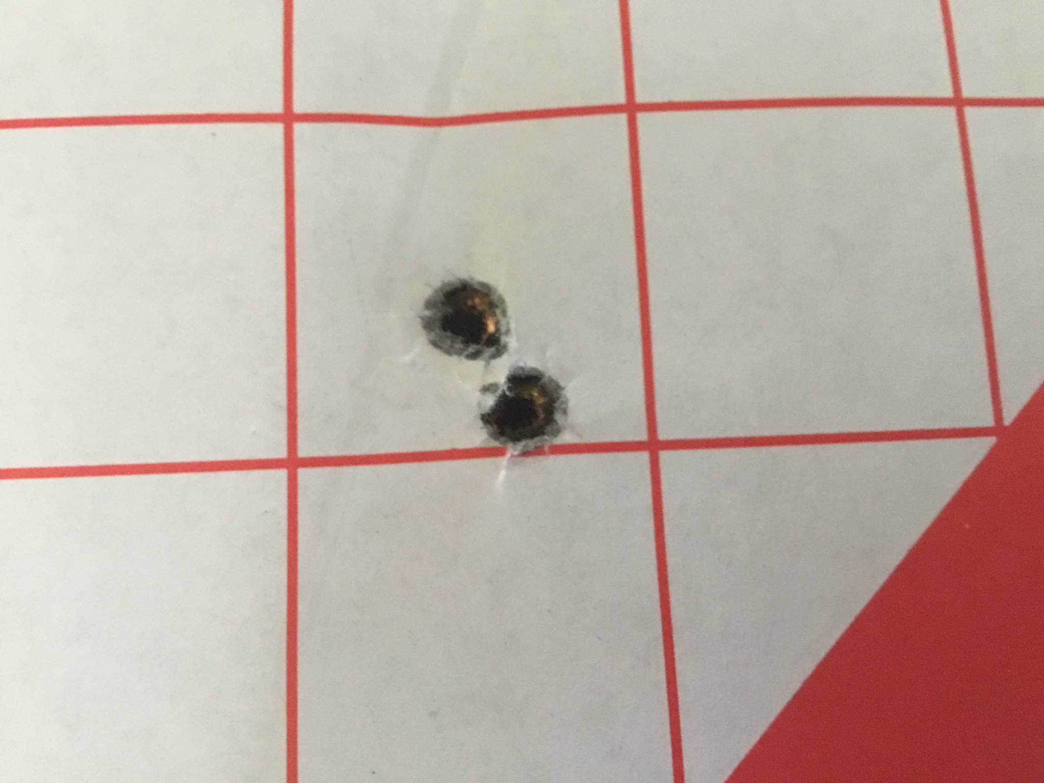

    I can't say on accuracy just yet, but I took a new rifle out briefly yesterday that is balanced really nicely now vs very front heavy previously and what a pleasurable experience. I have to shoot off a bench at this stage in my life and it sucks, but I can already see the huge benefits of having it more balanced with recoil....it's also got to be about 5lbs heavier than it was...22" Bergara barrel to 26" Proof comp contour plus a ton of weight in buttstock to balance out.

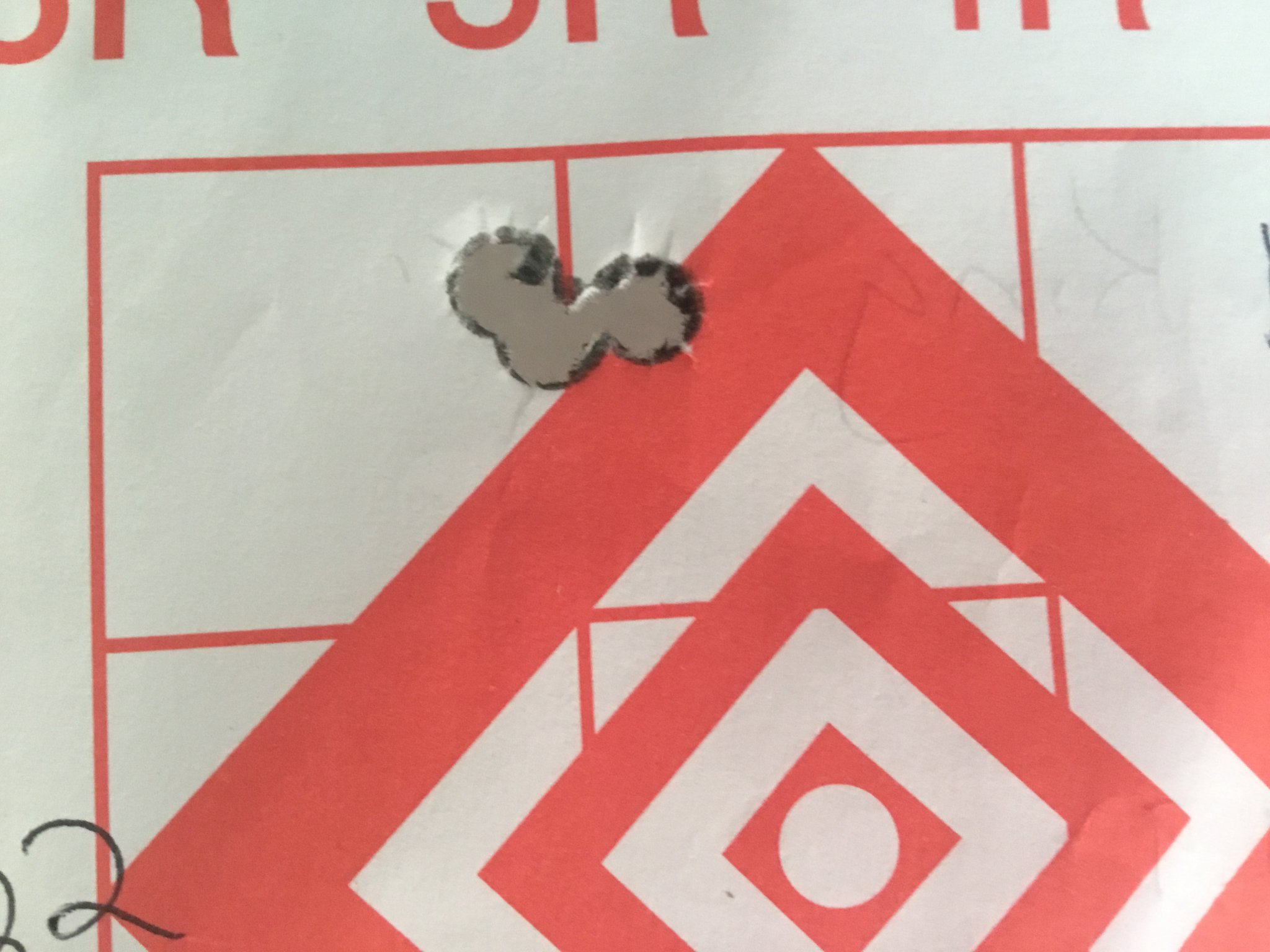

    757
    Two groups, both shot in testing, admittedly not enough shots to make a true determination of accuracy, but it makes a point. One group was shot with a 7 pound hunting rifle and one group was shot with a 12 pound PRS rifle. Guess which one.
