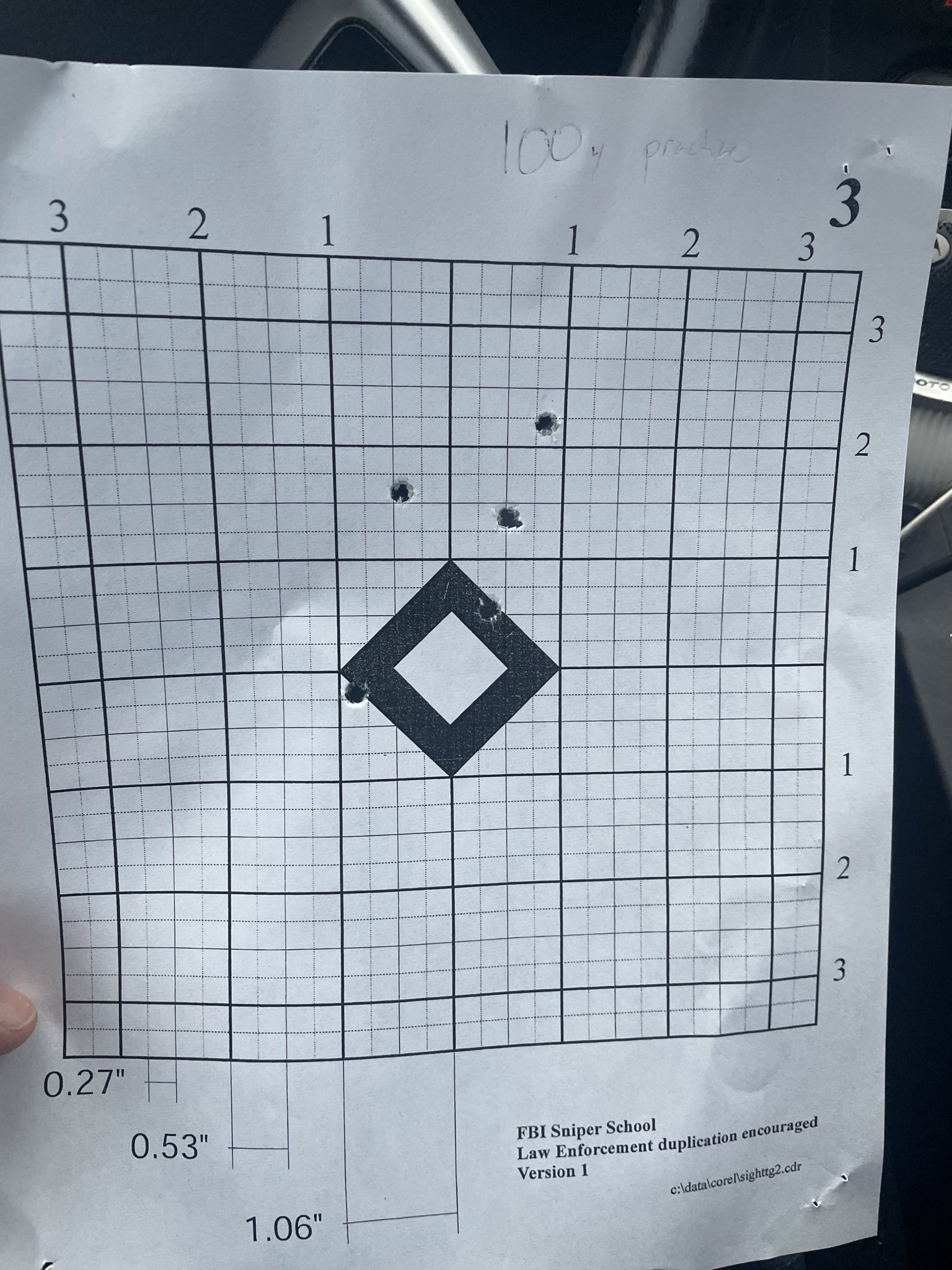

I can’t shoot prone but bench and bipod I get <.5 MOA on my bolt guns for 5 shot groups, but my Daniel Defense M4V7 was more like 3 to 4. I had someone who shots AR regularly shoot it and it was about 1.5. He noted in my case I was overgriping the pistol grip. After he noted it I got down under 2. Changed the grip to a Magpul K2+ which was more vertical like my bolt guns and what a difference. More like 1 MOA. Not saying that’s your particular problem but having someone else shoot it may help diagnose the problem.

Really excellent advice above. I would do the following - in order:
1. Check everything is tight, scope not touching the barrel, etc.
2. Get a couple of boxes of good quality ammo. FGMM, IMI Razorcore, ADI 69 gr. and maybe Hornady Match. XM 193 is in the best case 2 MOA ammo. M855 is generally worse.
3. Upgrade you stock trigger. LaRue MBT is an excellent trigger at a good price. Also hard to go wrong with a Geissele.
4. Work on your fundamentals. Just because you can shoot a bolt gun well doesn't mean you can shoot an AR15. Be sure you are getting behind the gun exactly the same way each time. Load your bipod. Follow through.
Assuming everything is tight, your disappointing results (and they are disappointing) is probably a combination of you and your ammo. Getting match ammo should get you down to about 2.5 MOA. The rest is up to you. Sub 1.5 MOA should definitely be achievable with your set up. And if you refine your technique and got a good barrel, you could certainly see 1 MOA.

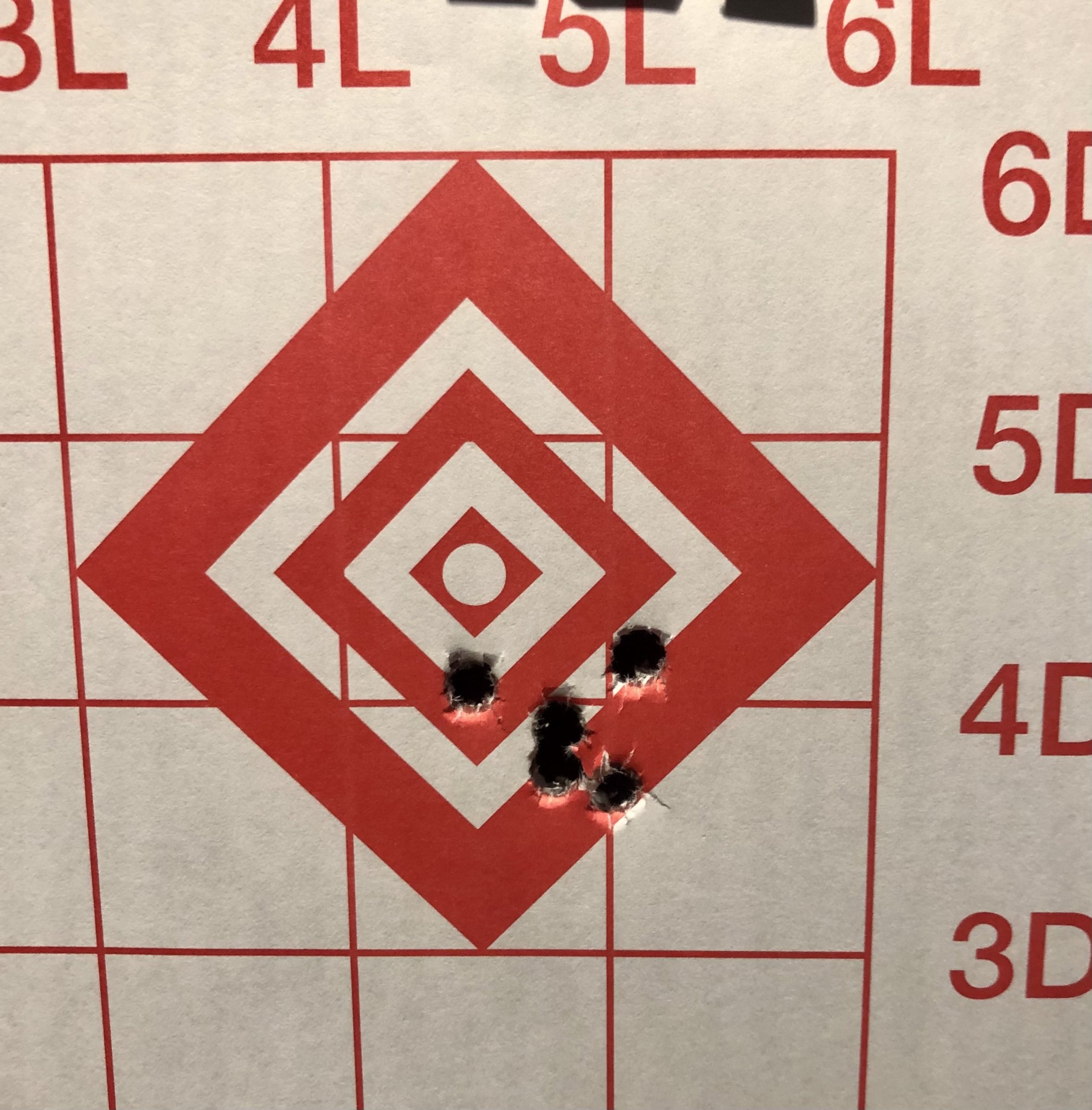

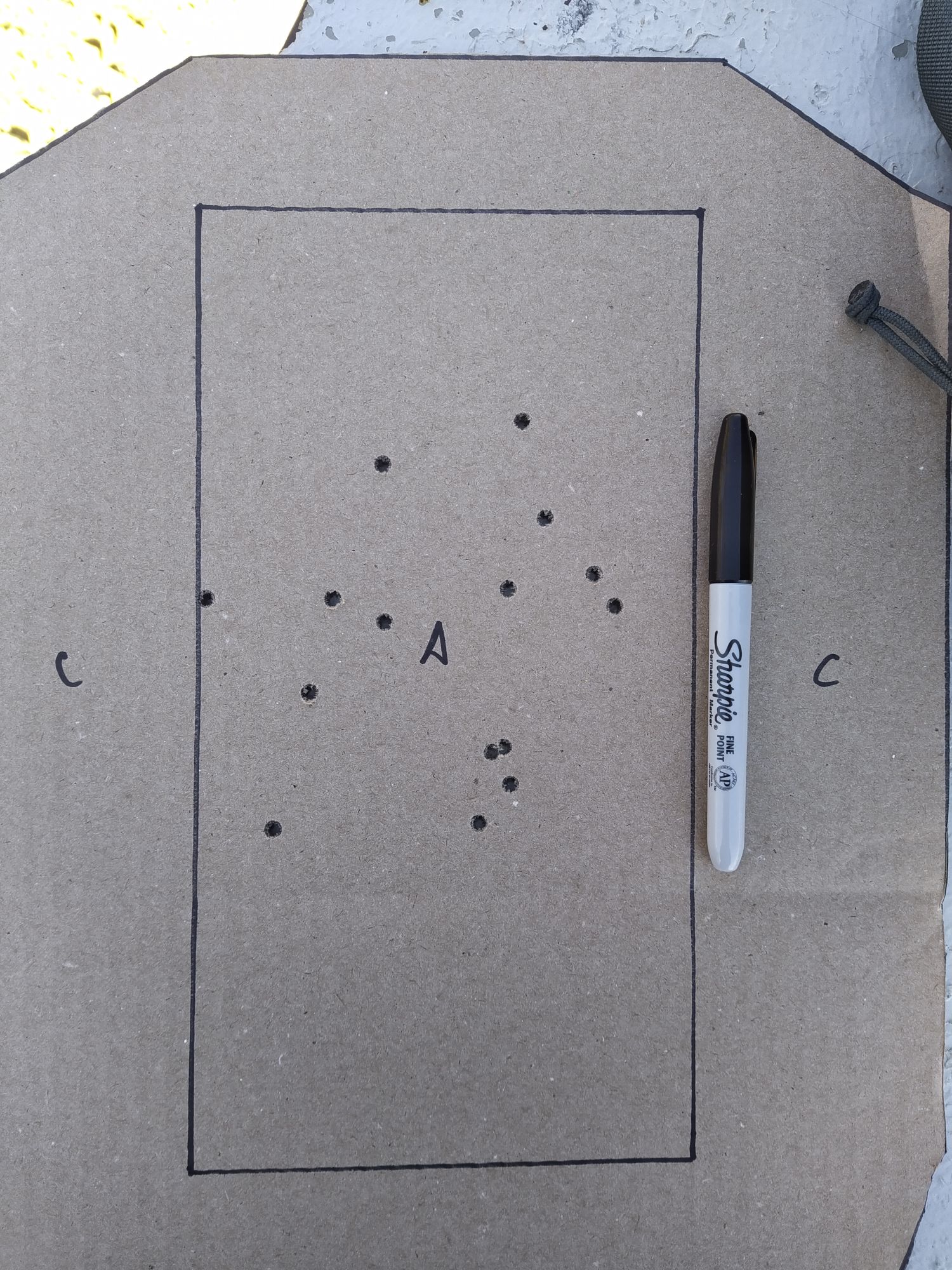

100 yards prone using a 11.5” barrel Bushmaster with about 10,000 rounds down the barrel. Shooting 55 grain Remington FMJ. Using an EOTech without a magnifier and using a grip-pod for support.
I guess you could start here when comparing.

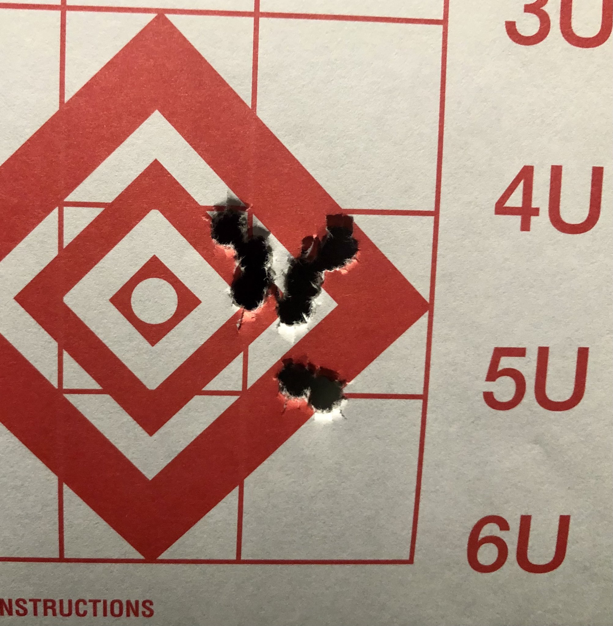

Context: Put together my first AR this past year. 14.5" Criterion CORE barrel, Brownell's BCG, DSA upper, Steiner T5Xi 3-15. It has right around 200 rounds on it right now. Shot 77gr S&B at like 3MOA, and this photo is from today with Freedom Munitions reman SS109. Sharpie for scale, but it's like 4.5MOA.
Now, this rifle was never meant to be a dedicated precision platform. I wanted a good general purpose rifle that I could stretch into whatever role I needed it to be. I tried to be as realistic as possible with this rifle. I wanted 1.5MOA with match grade ammo. S&B isn't exactly the epitome of match grade, but I thought it would perform better than it did.
Blaster ammo: My expectations weren't exactly high, but 4.5MOA doesn't really cut it for me.
I should probably order some FGMM or something good for absurd prices and see how it performs before I do anything drastic, but if that doesn't do it do I just tear down and rebuild the thing?
But maybe my expectations were too high?

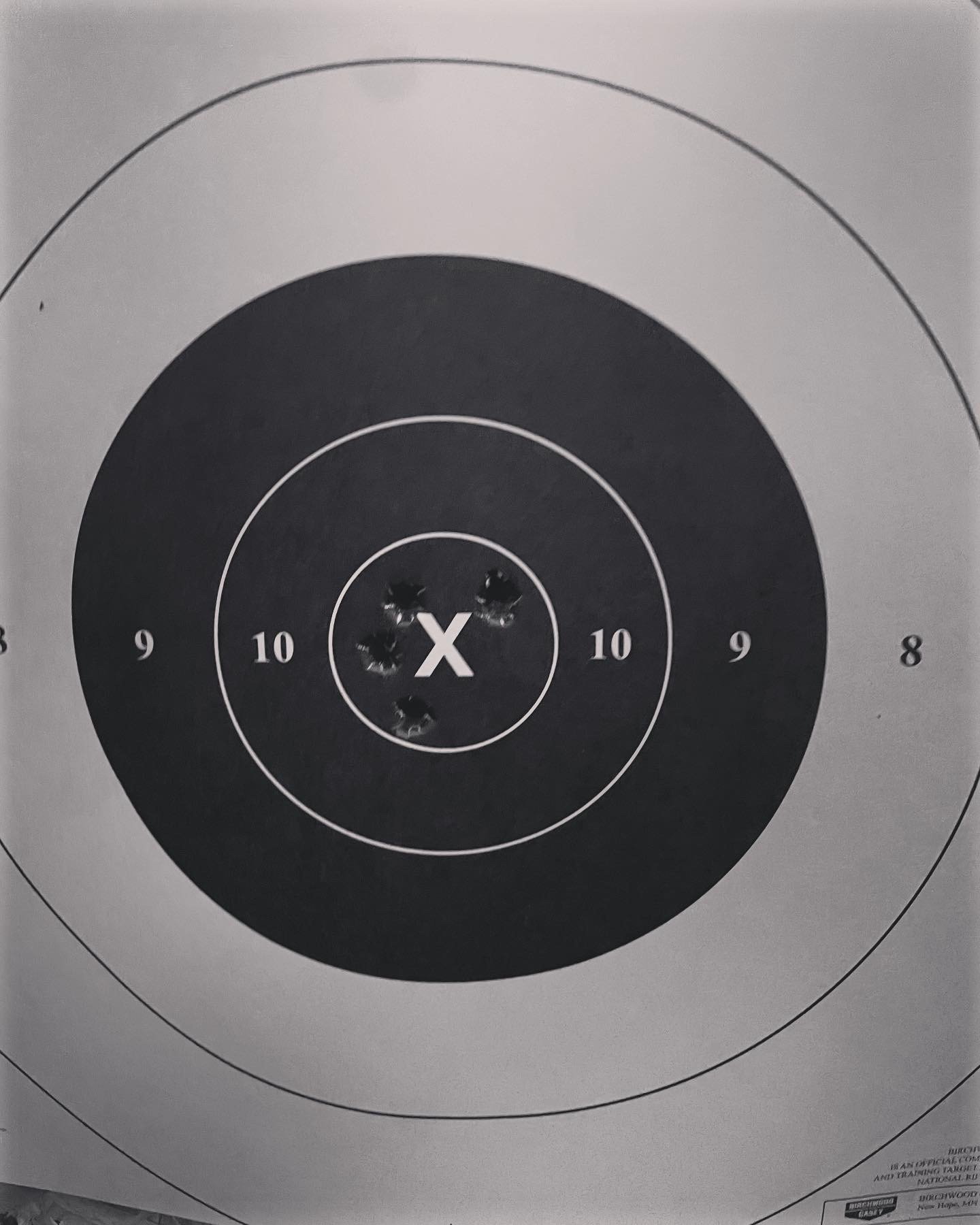

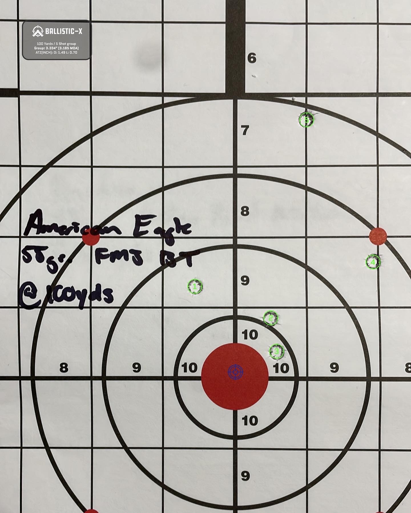

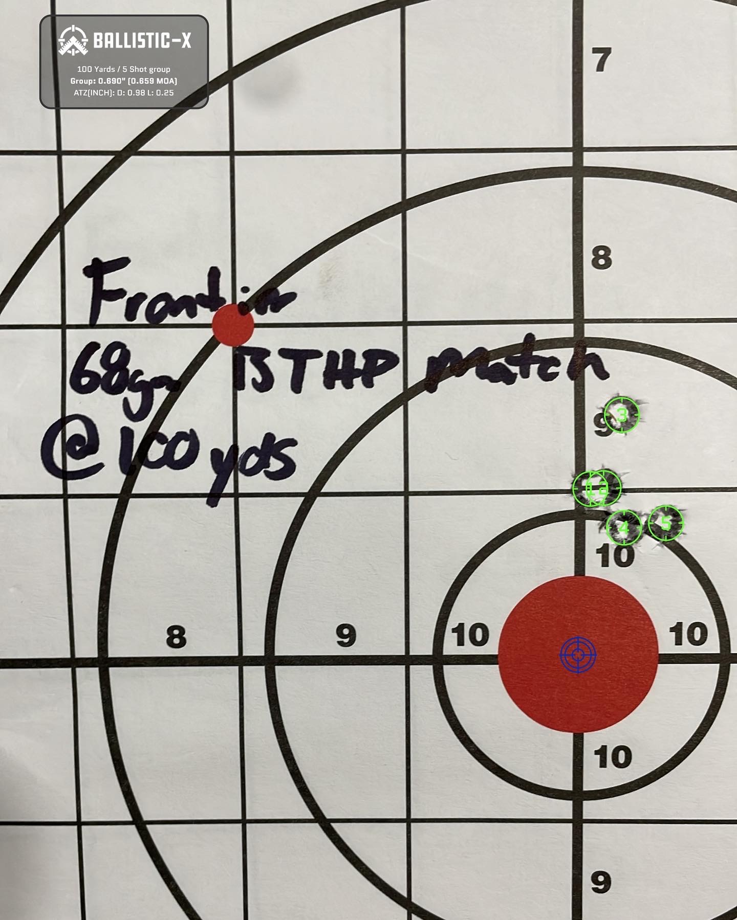

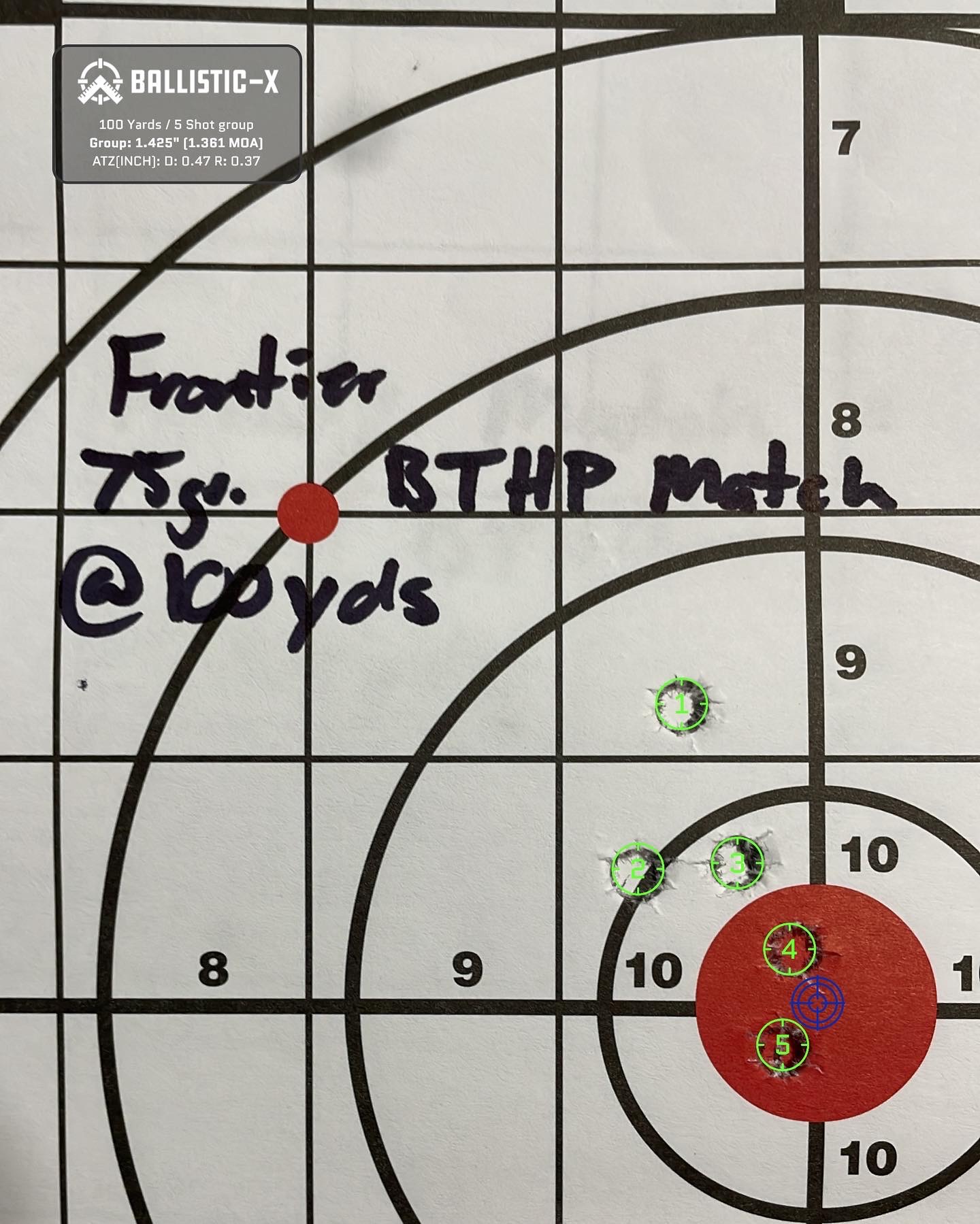

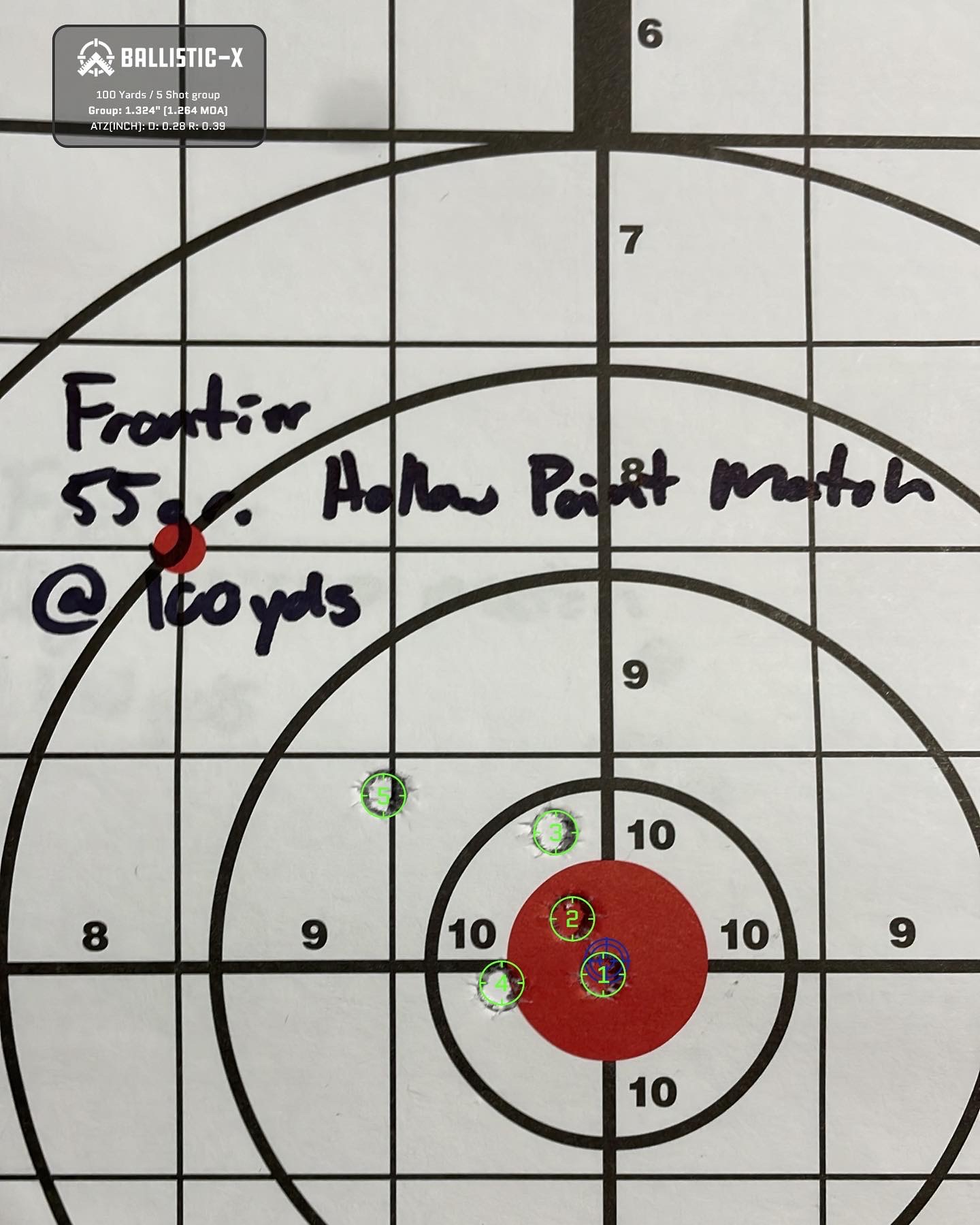

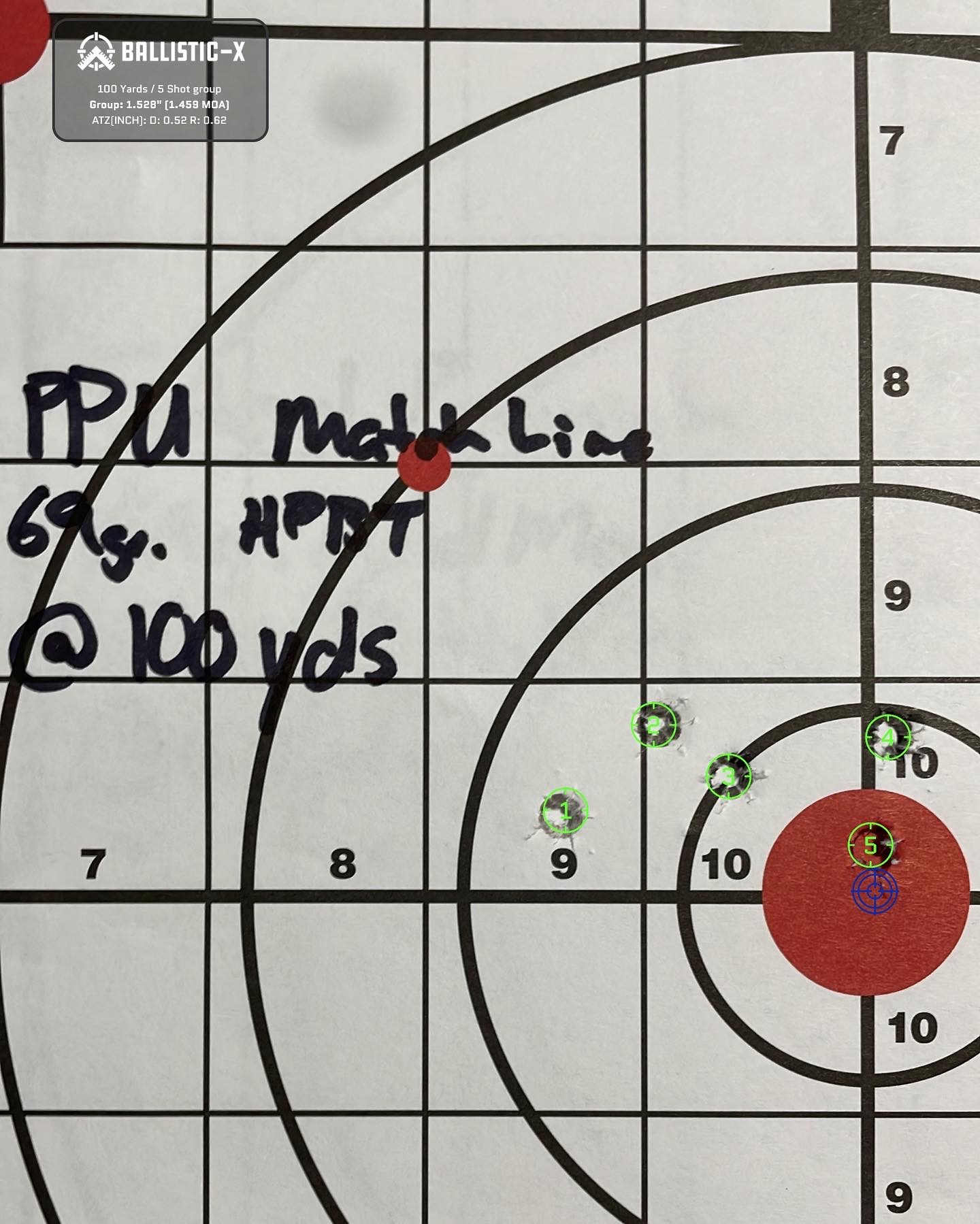

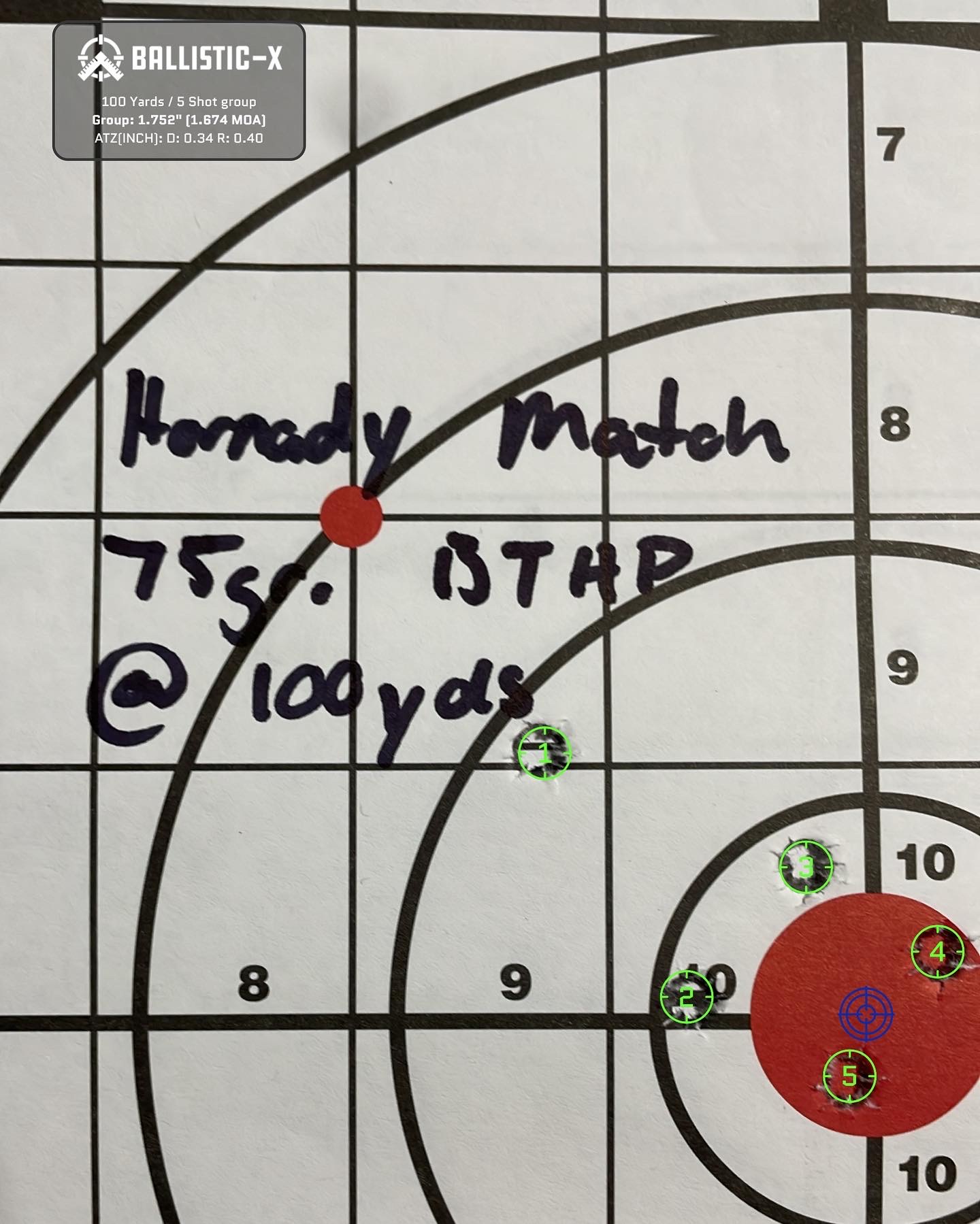

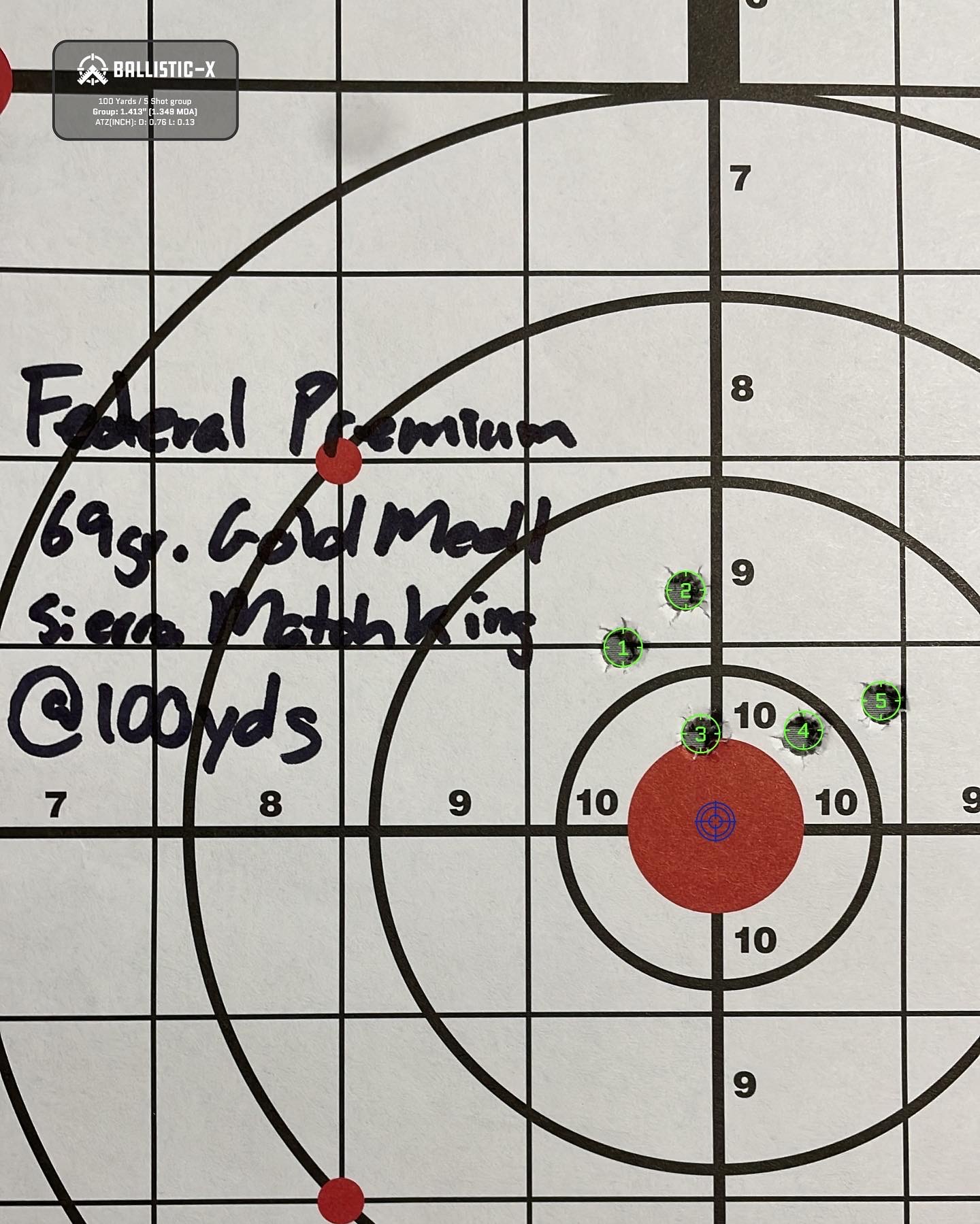

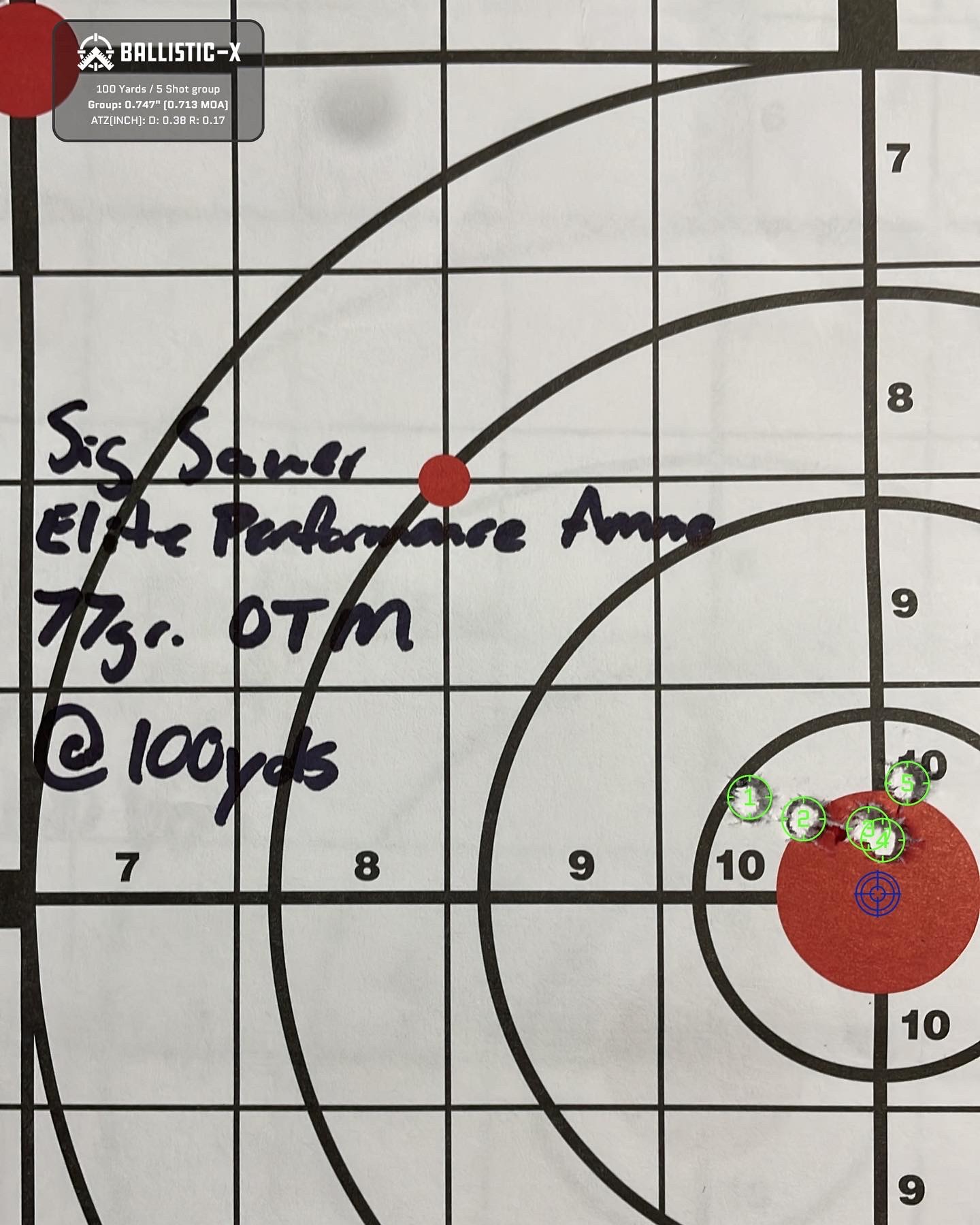

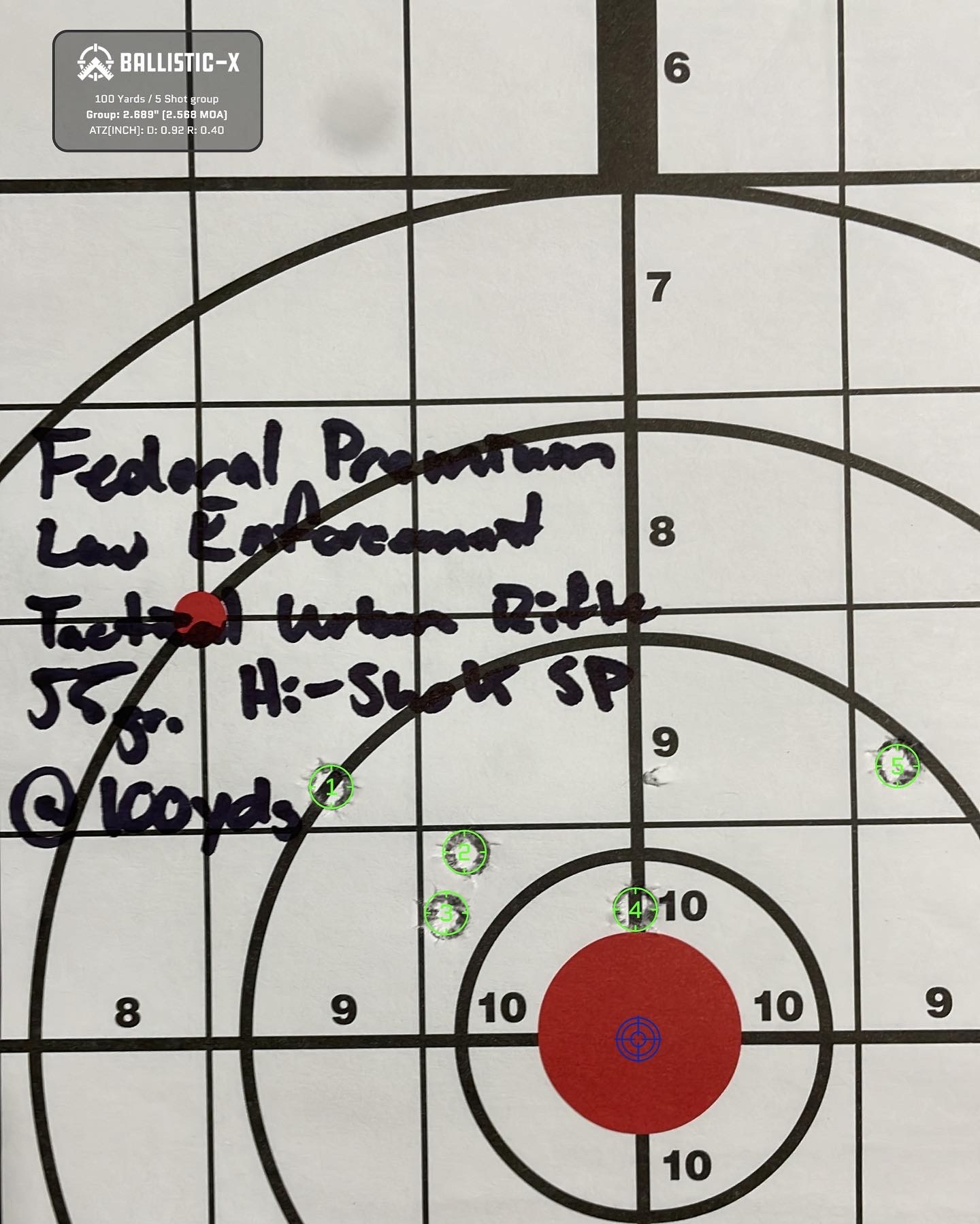

These are the groups I got from my build. I tested 9 different ammunitions at 100 yards at my local range. The pictures are of the 5 shot group from each ammo. Then a picture of the rifle followed by my less than stellar 50 yard zero on the bullseye targets using 55gr ammo. The rifle wasn’t cleaned before shooting the groups and has close to 500 rounds through it, maybe more, with about 10 percent being suppressed. The rifle is a 14.5” Geissele Super Duty complete upper, SilencerCo lower, CMC lpk, Geissele SSA-E trigger, and a Sig Sauer Tango MSR 1-6x.

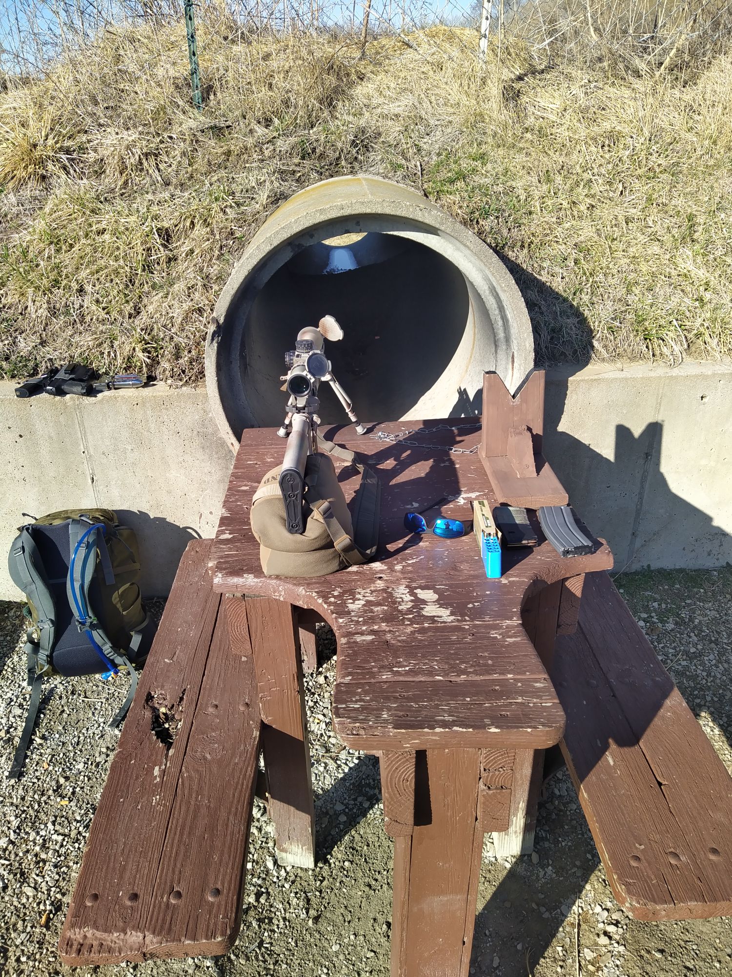

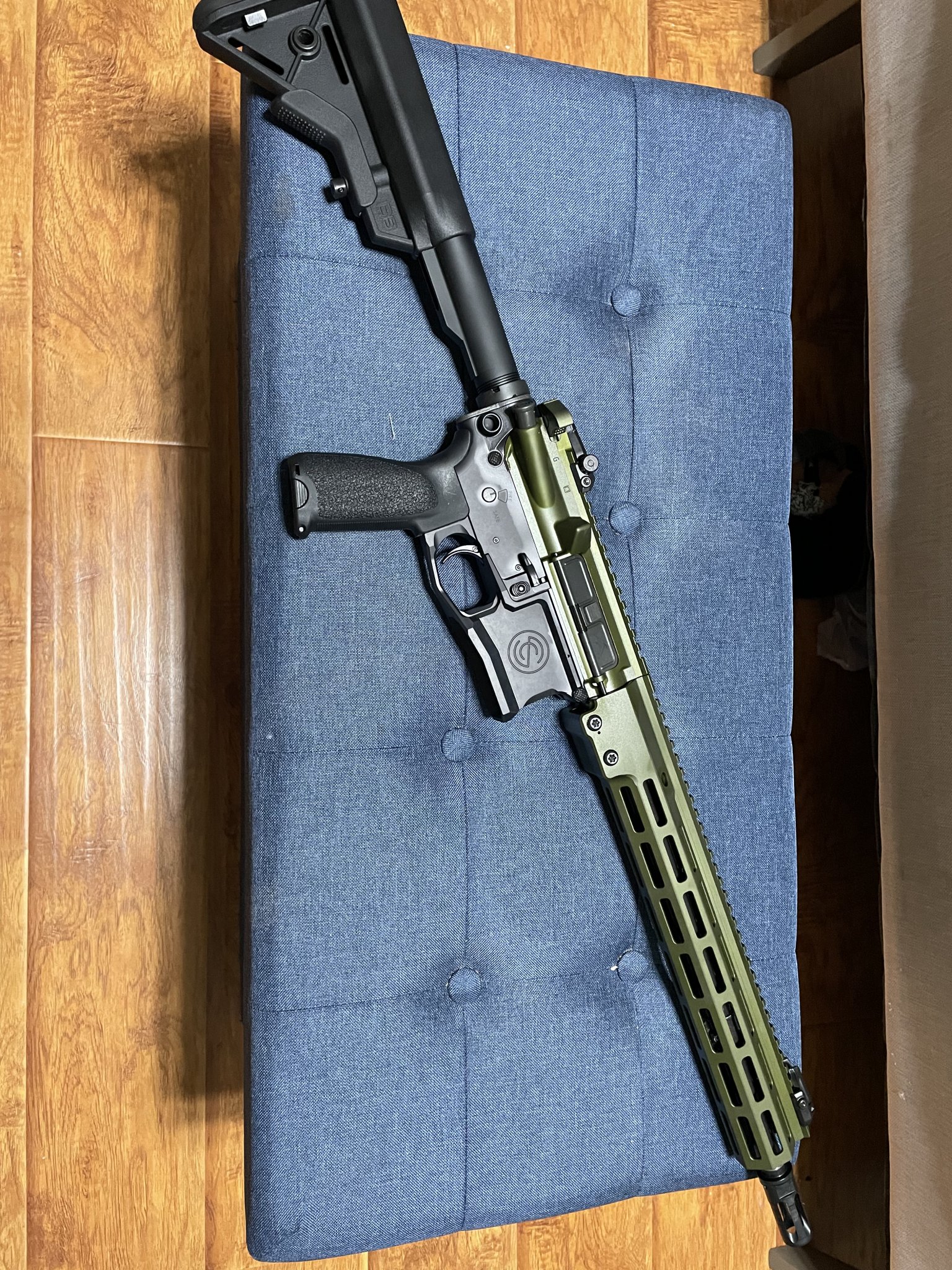

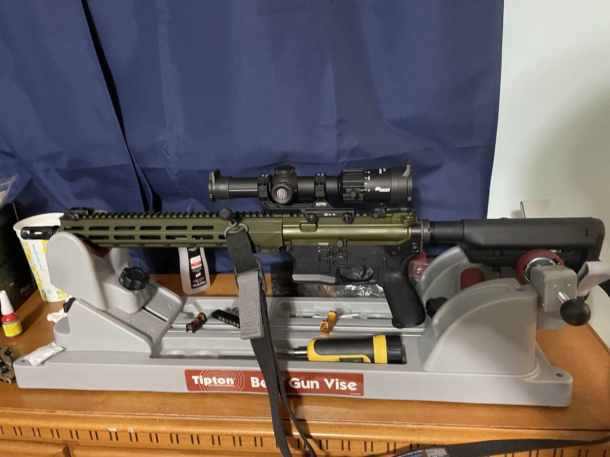

Any chance that you can post a pic of your rig?

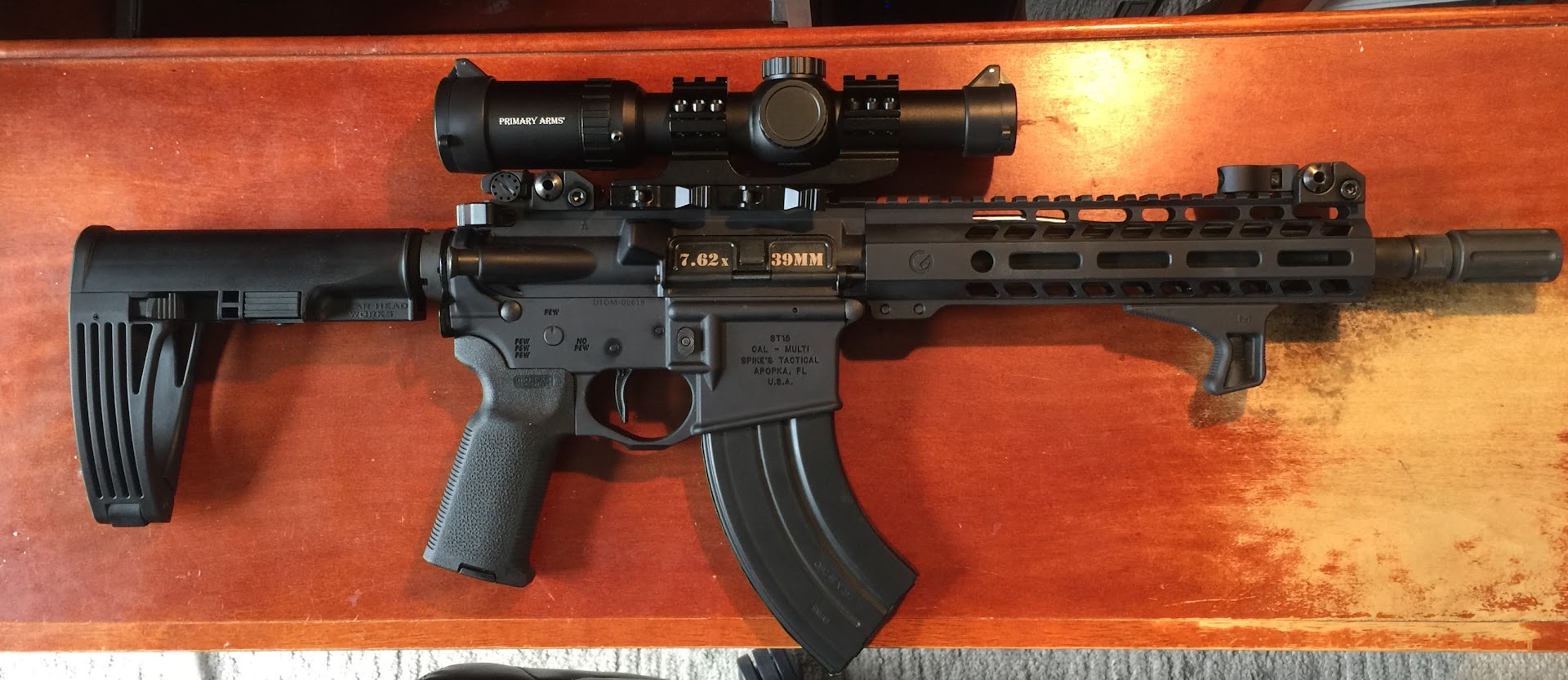

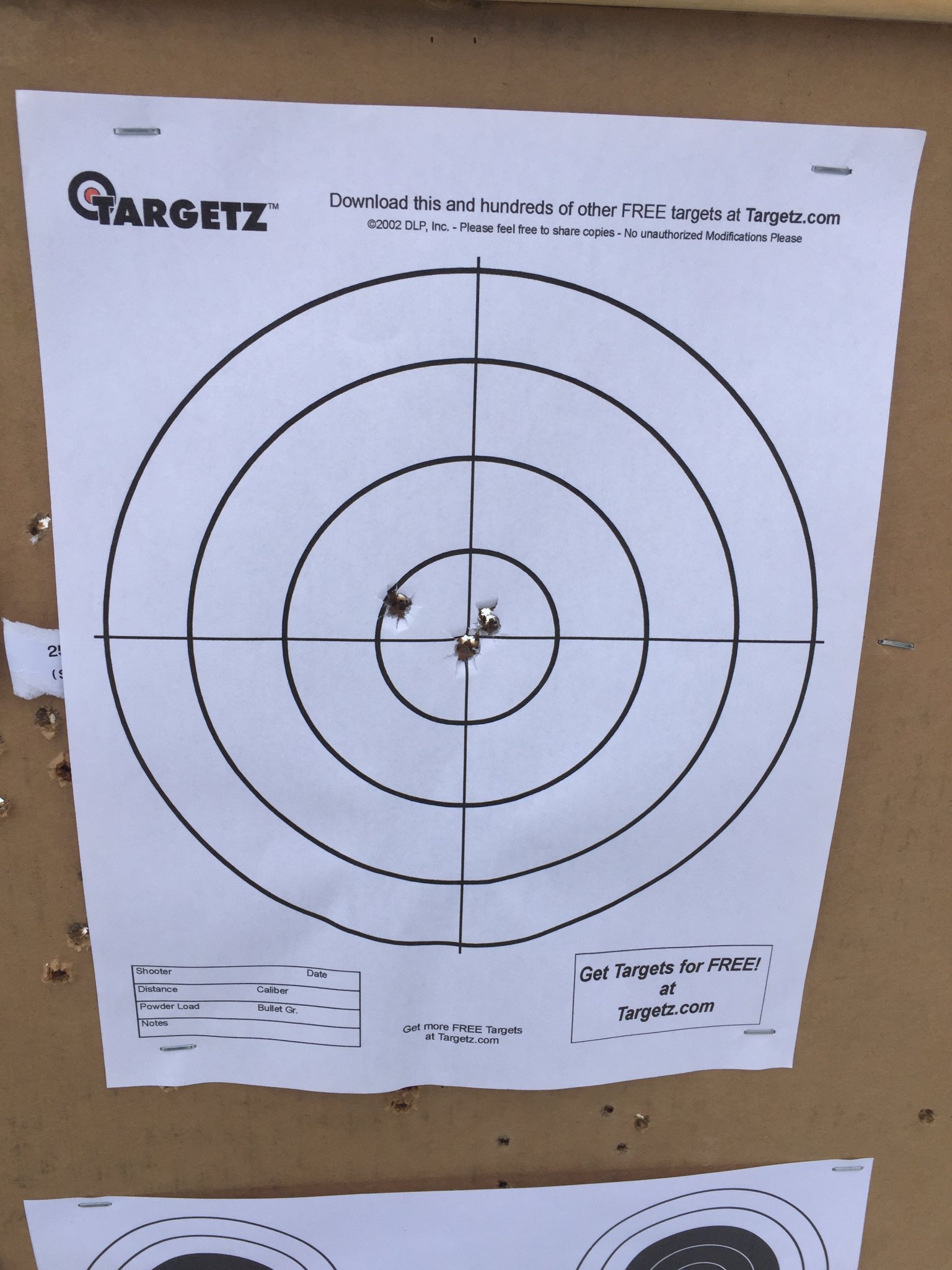

The below three shot group was 100 yards from my Lead Sled by my 10.5" 7.62x39 Build - Ghost Guns Upper, Spikes Tactical Lower- Aero Internals (Handstop replaced with a forward grip per my state statutes to conform to "other" weapon status) -1-8X Primary Arms ACSS scope with a Hiperfire Designated Marksman Enhanced duty Trigger after dialing it in at 25 yards. I was using off the shelf Russian122gr HP TulAmmo. Your groups should be better than they are.

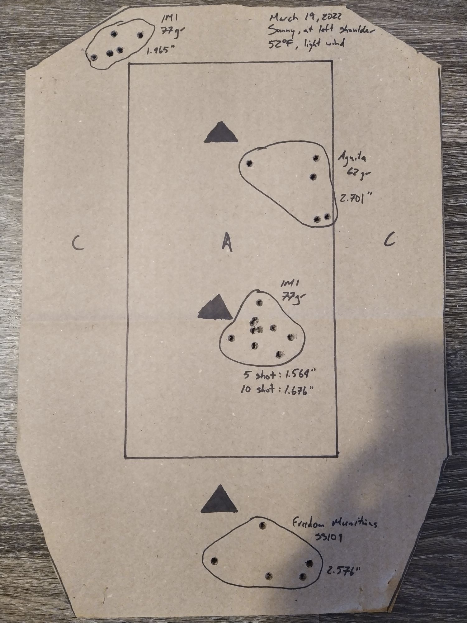

Alright, little update here: Ordered some IMI 5.56x45mm 77gr, might get to shoot this weekend. Next weekend for sure.
Checked scope mounting: all seems good. 15 in-lbs on ring screws and 45 in-lbs on crossbolts (Spuhr mount). The rifle is completely painted, like I said before, so it's got the equivalent of witness marks on the whole thing. Nothing has moved as far as I can tell.
Optic was on another rifle before this and it tracked and held zero reliably, so I want to say that's a known good. It's been sitting in its box for the last couple years.
Cycled some rounds through the rifle manually. Nothing there but some normal scuffing on the bullet from the feed ramps.
Inspected the feed ramps and nothing stood out to me, though I'm not 100% sure what to be looking for. I was mostly checking for roughness or burrs, which they have none.
The sloppiness in the fit of my upper and lower is just enough that you can feel the receivers move in your hands. It isn't what I'd deem as "excessive."

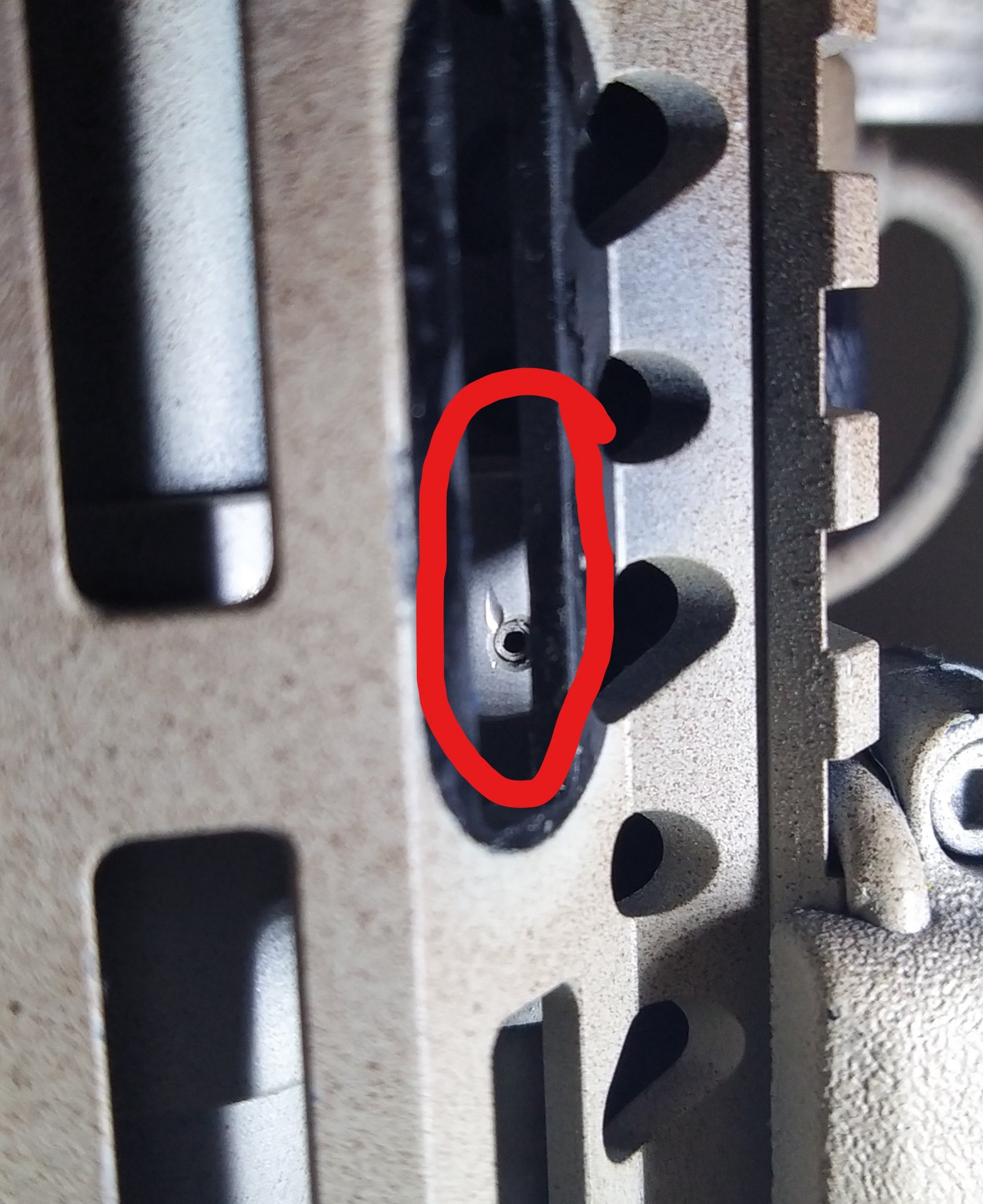

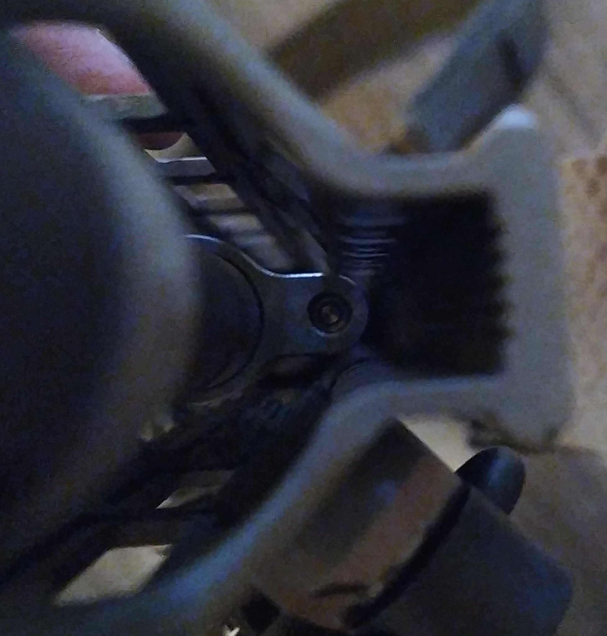

Handguard hasn't moved, though I found something curious when checking over it.
QD sling mount:
Gas block:
There was clearance here, like 3-4mm, but it appears that there was contact at some point in time. I've moved that sling mount and removed my light for the time being just to try to eliminate some more variables.
Haven't checked barrel nut torque (again, BCM handguard gonna be a pain, and I need to get a vise and a workbench). If the issues persist, I'll do a full teardown on the upper and check things there. Probably would let Criterion know at that point too, just to open a line of communication with them. They don't have an accuracy claim, but I'm sure they'll try to help me out.
I'll be dry firing in the meantime if anyone needs me...
Reactions: bfoosh006

It will be interesting if some part was bonking the gas block... and "possibly" causing that large of a group.
I'd honestly love if that's the issue, but I'm not convinced that mark is from shooting the rifle. 3-4mm of clearance seems like a LOT of barrel whip at the gas block

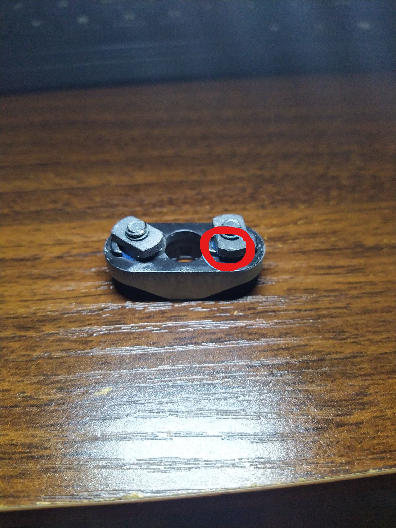

QD sling mount:
Gas block:

The next 10-shot group was fired from one of my Krieger barreled AR-15s at a distance of 100 yards using Ultradyne back-up iron sights. The group has an extreme spread of 0.71".
Alrighty, here we go!
Bought some IMI 77gr Razor Core and headed back to the range this afternoon.
Not the greatest range setup, but it'll do in a pinch. Sat down, warmed up with some dry fire; everything is awesome. Reticle isn't moving when I break the trigger, position feels pretty comfy, I've got the rifle bay to myself.
Shot five rounds of Aguila 62gr that I had laying around. 2.701" group.
Shot five rounds of the Freedom Munitions SS109 that I did last week to keep a baseline. 2.576" group. Not quite as terrible as last week, but probably not outside of statistical deviation.
Shot five rounds of the IMI 77gr. 1.564" group. Got up, drank some water, tried to relax for a few minutes. Sat back down, put five more into the same group, opened up to 1.676". Not too bad.
Shot another five rounds of the IMI, 1.465" group.
So yeah. Probably just don't shoot really crap ammo for accuracy. My brain says, "IT'S NOT GOOD ENOUGH," because that clean ragged hole is euphoric to see, but for this rifle and its purpose, this is very acceptable.

I posted these results in Molon’s Criterion Core thread. I put the barrel in a LaRue stealth 2.0 chassis, with matching lower and MBT. After doing a few shots to begin the zeroing process for my 1-6 scope I shot these two groups. (Adjusted the scope in between groups.)
69 gr fgmm. The fit between barrel and receiver was tight. 14.5” Criterion Core.
