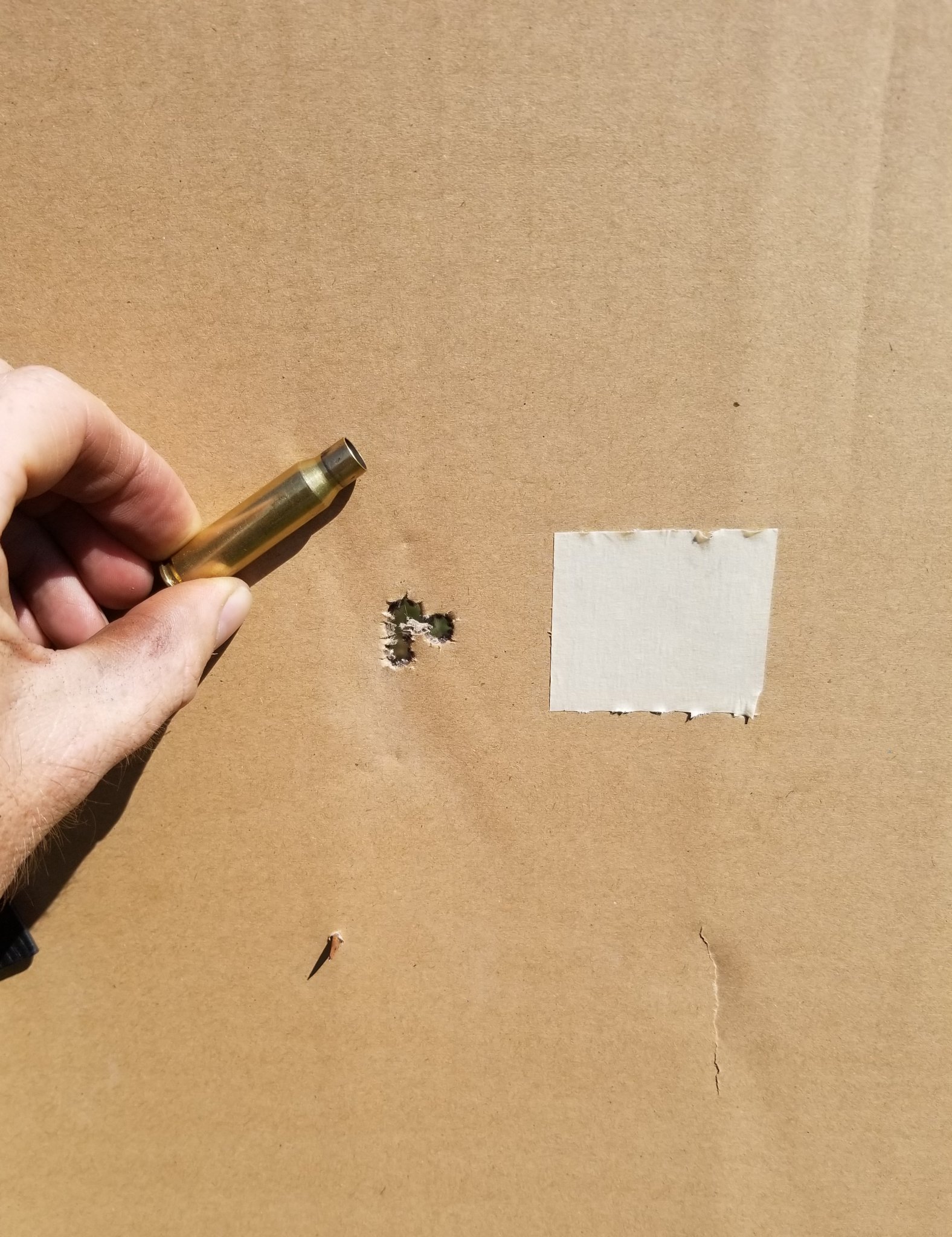

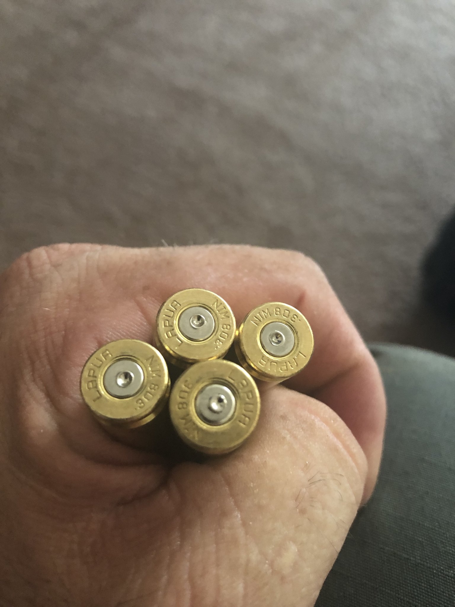

So I shot mine today and this happened. Sending it in too Greg for repairs. Greg is working up a spare firing pin not counting the one with the bolt bushing work. Looking for spare parts for this rifle sucks. Unless ya'll know something I don't know. Really just looking for firing pin spring, extractor, ejector, etc. In other words bolt parts. everything else has been changed out or being changed out. Any help appreciated.

Looking at your pictures I don't see much of a problem. It looks like you have flat primers which is probably adding exaggerating the primer flow. Primer cratering is fairly common, unless you're shaving primer cup into the primer channel or piercing primers I probably wouldn't worry too much about it.

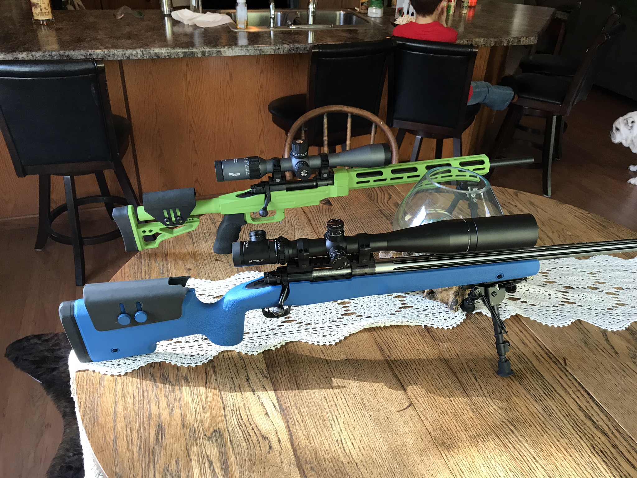

I’m a spr/70 guy as well. I have some with the internal box mag, the factory dbm, the fn to, and the cdi conversion. Calibers range from 22-250ai to 358win and a few in between. My main comp gun had been an spr in 260 or more recently, 260ai for over a dozen years. One reason I went with the cdi after the tbm on that one is because the shoulder width of the 260ai made the rounds jam in the tbm mags if I put more than 6 in a 10 rounder. The 5s had no problems.

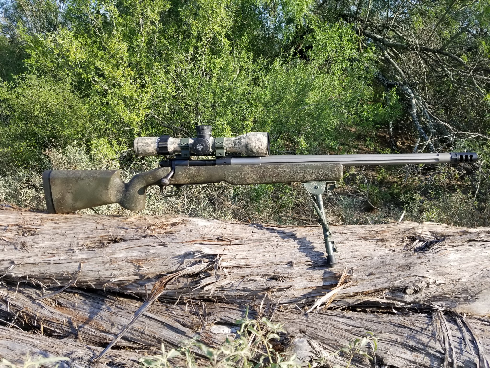

My oldest son runs a 6.5-47 with internal box mag. My youngest runs a 22-250ai in an xlr evolution. I opened up the bottom of the action so it runs ai mags too.
The simplicity of the triggers is a huge plus. I do have a couple with jewell triggers though and those run amazing as well.
7092352

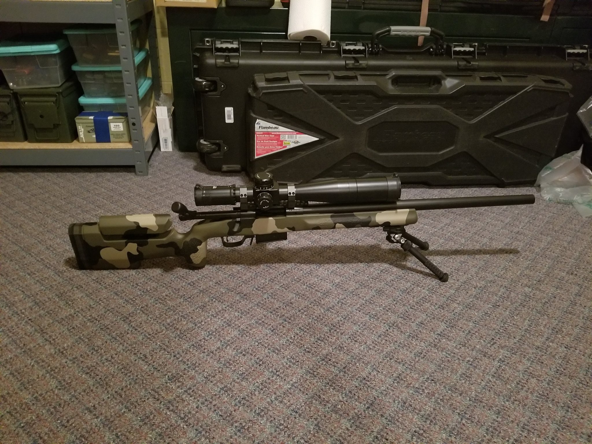

My 260ai
7092355
the green is the 22-250ai and the blue is the 6.5-47.
7092357

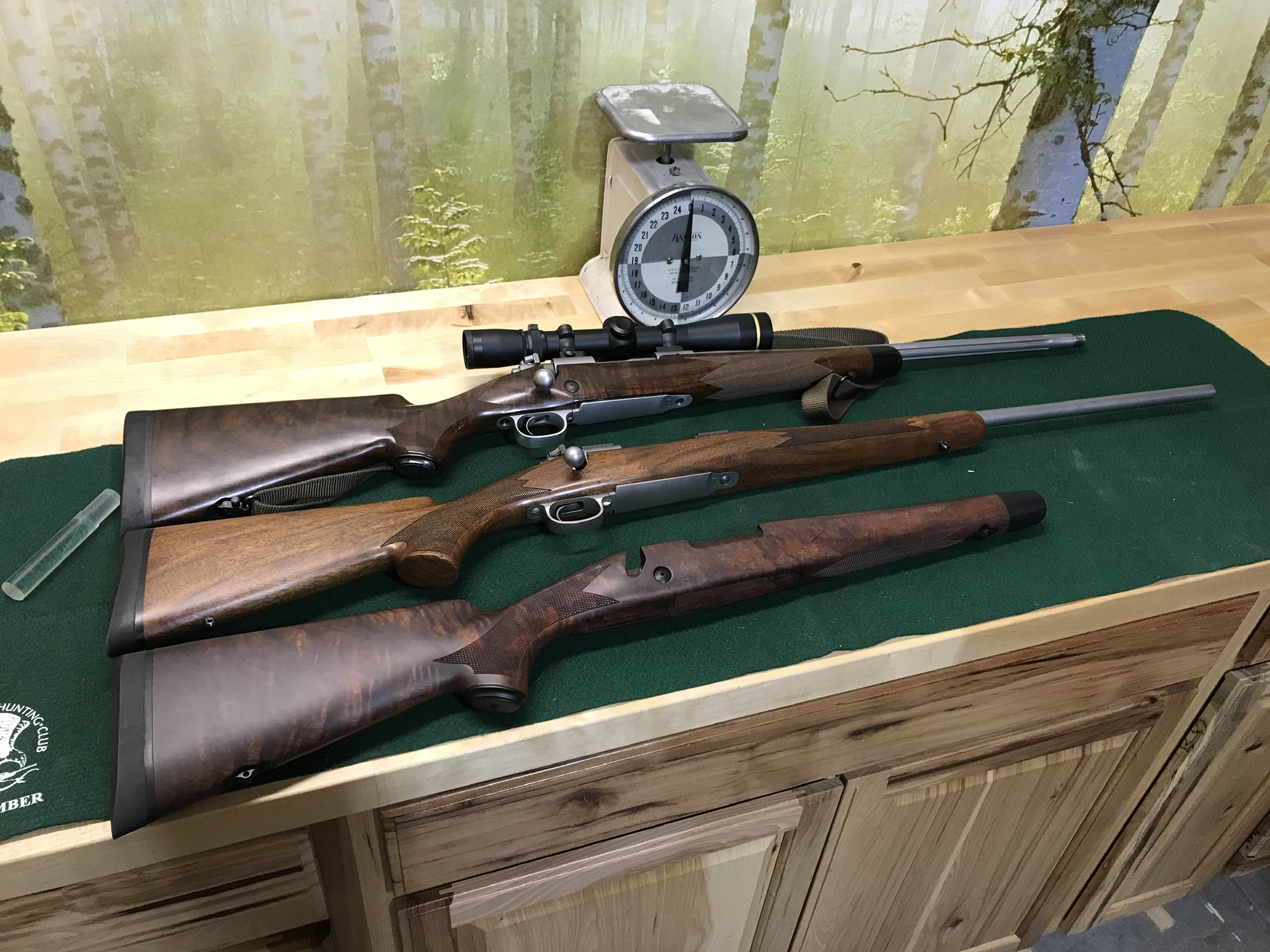

308 on top, 358 next and the future 243? Will be the bottom one.
I don't have this issue with any rifle I have. Custom, factory, or other. The load was not hot by any measure. If the primers look flattened to you, its the picture only. In hand they are not. If this issue is "fairly common" in your experience. I would have a look at your rifles or reloading methods. My thoughts, nothing more.
I meant that cratered primers are fairly common in factory actions. My SPR does not crater primers but I wouldn't worry about it if it did.

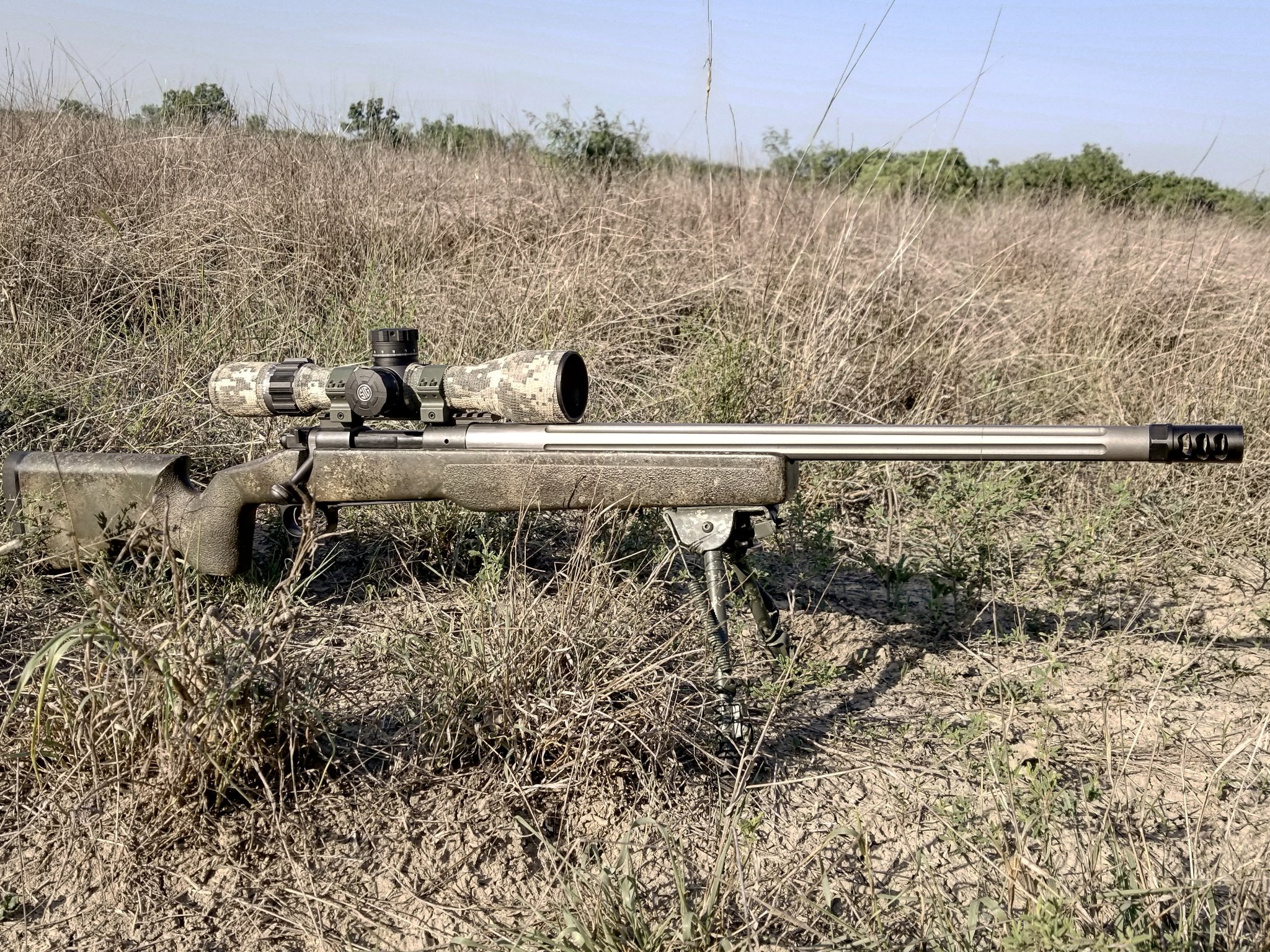

I built it a couple years ago. SPR receiver from GunBroker, Benchmark Sendero 8 twist @ 23" , a Manners T4 with a magnetic adjustable ckeekrest of my own design, bolt knob made from the benchmark blank stump and a FN TBM mag kit.
(I did a write-up on my magnetic adjustable cheek-rest in the Snipershide DIY subforum).
I've bushed the firing pin to .062" to cure the primer cratering.

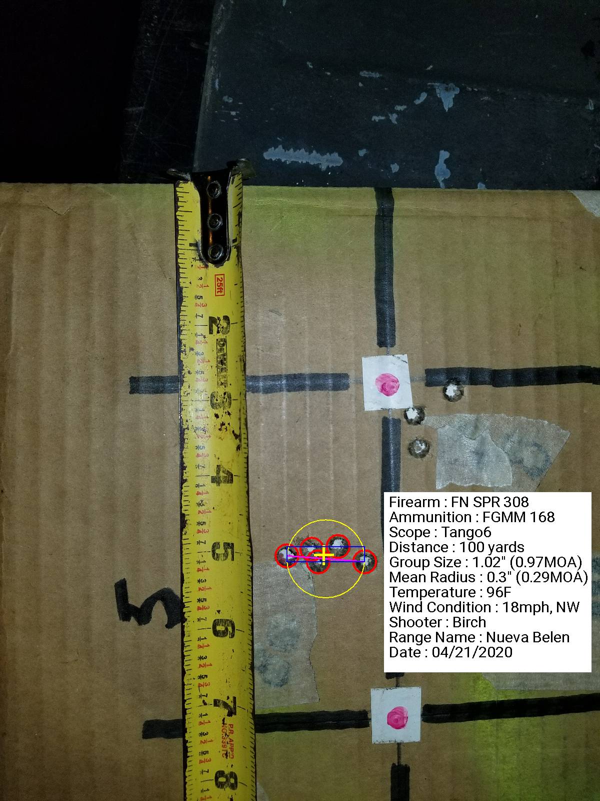

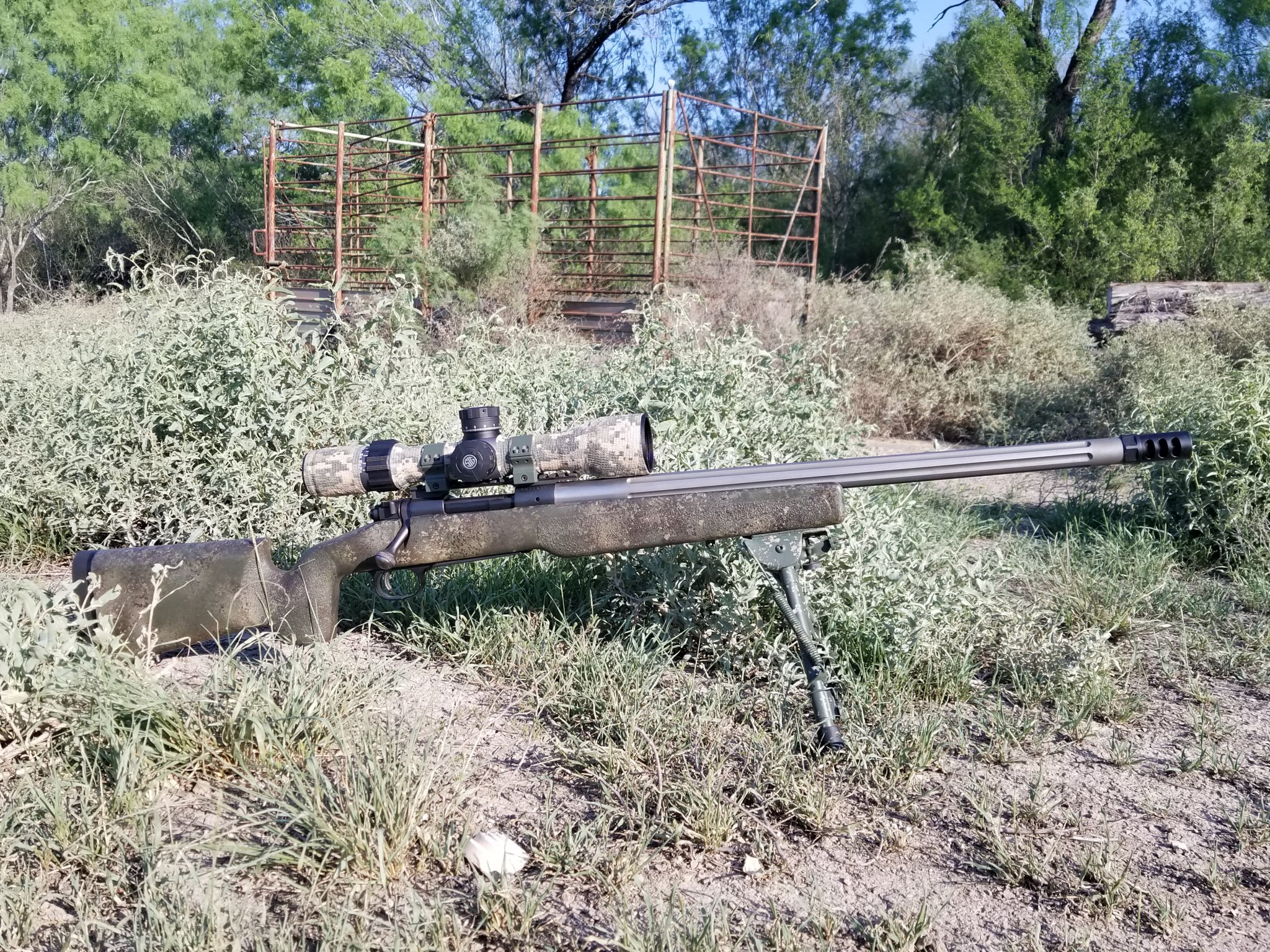

Thanks to whoever bumped this thread back up. I can finally say I now have some thing worthy of posting in this thread lol.
First group I ever shot with it is below. Wind was extremely crazy with strong gusts that day. That group was shot using FGMM 168. I also shot a 5 round group with PRIME 175 that was 3/4 MOA but way more vertical on the prime than the FGMM.
According to a previous owner of the rifle, the specs are as you see below:
FN SPR
.308WIN
PTG reamer
Shilen Select Match 10 twist @22.5"
McMillan A2 stock
I added the following:
Lil bastard
Sig Tango6 second Gen 4-24x50
EOTECH PRS rings (these were some spares I had laying around.
I'll be moving my ZP5 in seekins rings over to this rifle.

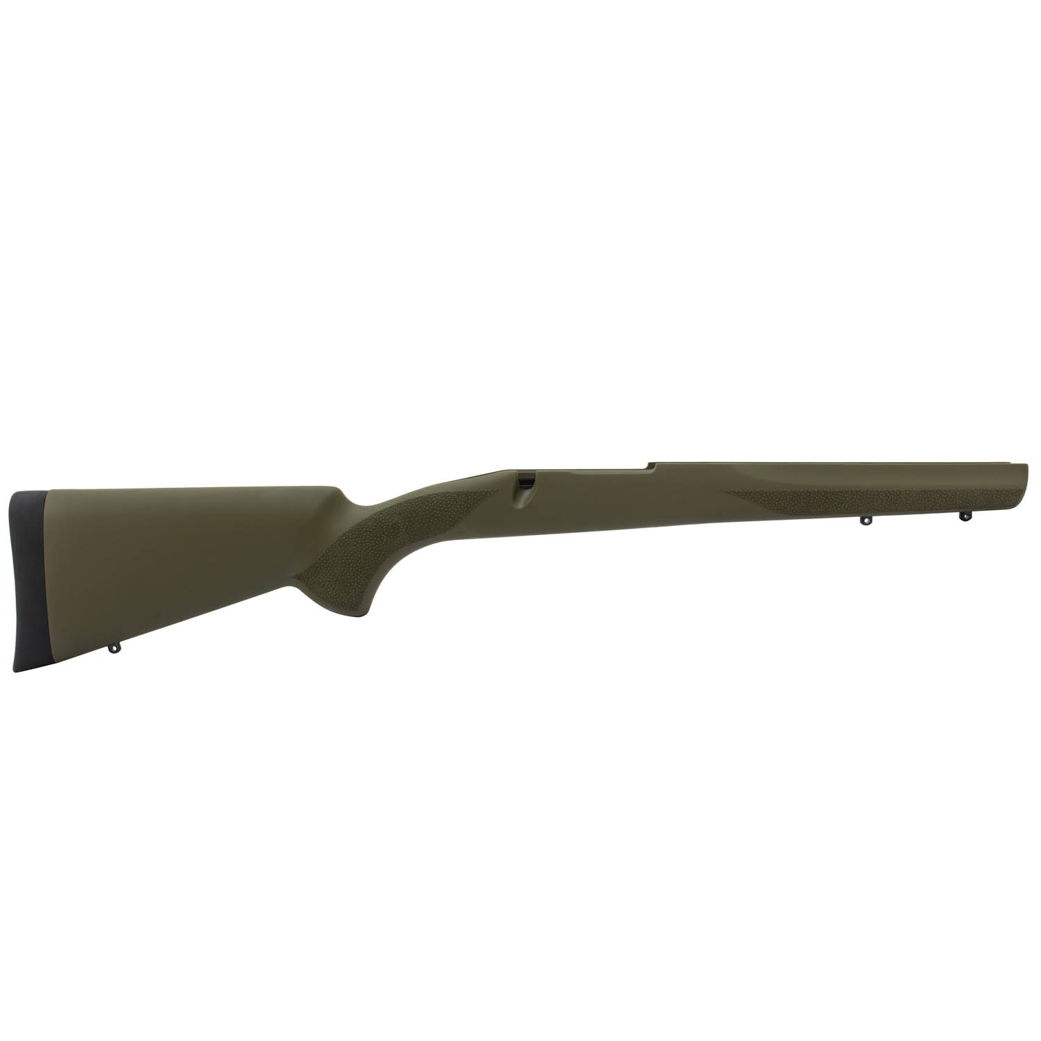

My only complaint about the mod70 sa is that there dont seem to be any economical stocks for it. I was hoping that the.mcmillian me line would have something but no luck.
I may get two hogues from midwest just to have something to build on.
I wish someone made a mini chassis style stock for it which was in the 500 dollar mark
It doesn't get any more economical than this...
or if you already have the bottom metal
