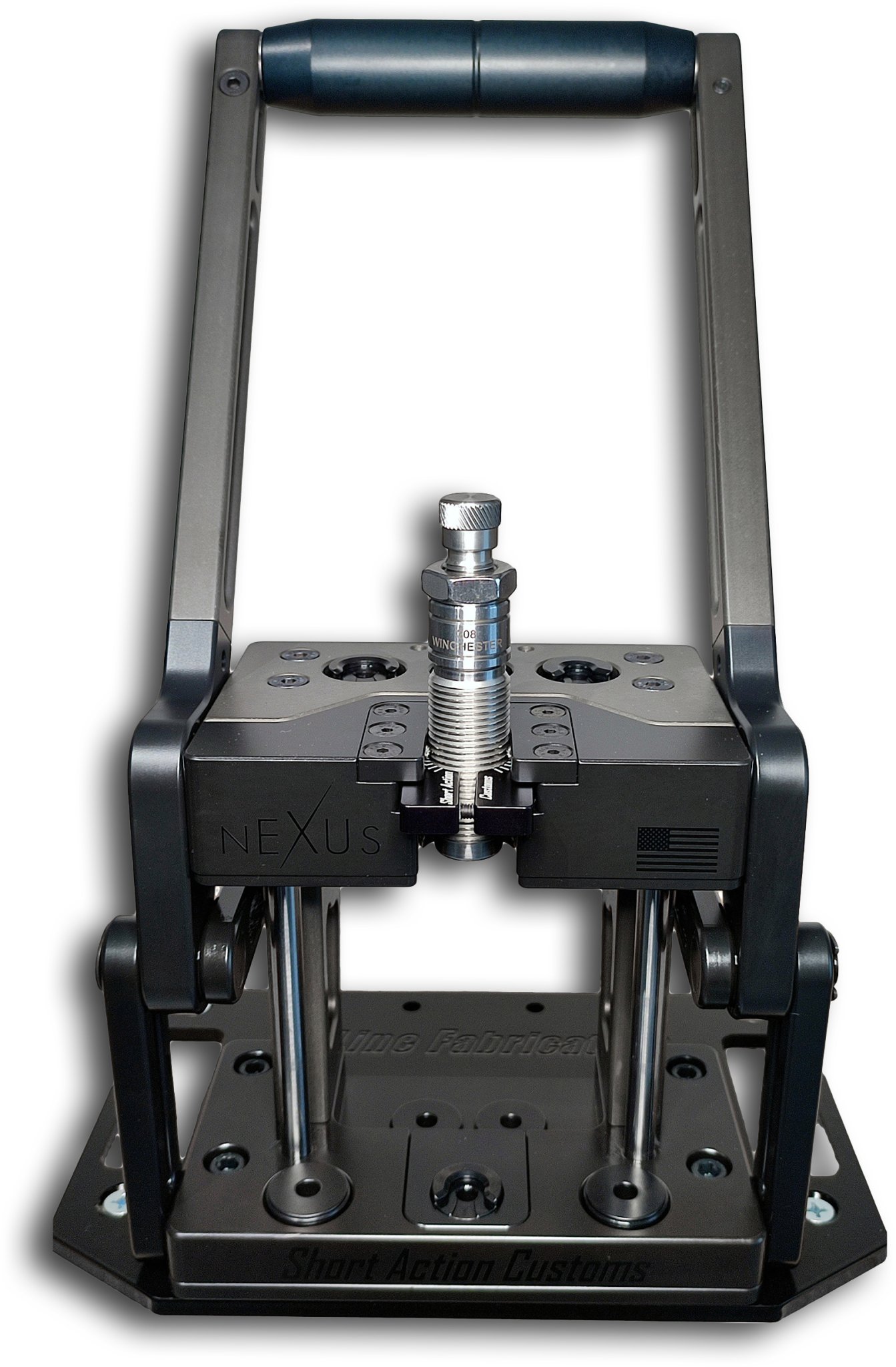

Got it in the mail today, one day earlier than expected.
Still waiting on the InLine Bench plate, but first impressions are really good!
It's heavy, very well machined, tolerances are on point and finish is stunning :love:
Can't wait to start sizing brass with it

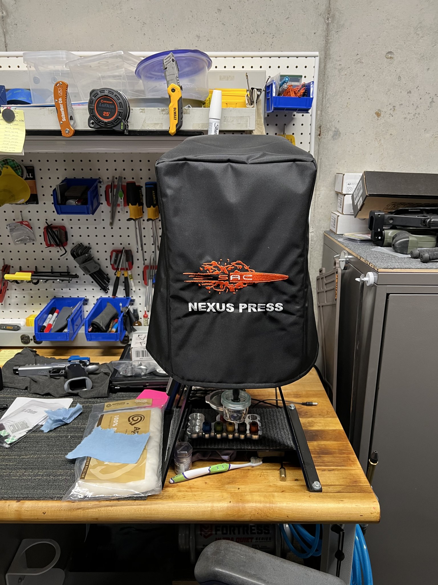

Has anyone found or is anyone making a good cover for the Nexus?

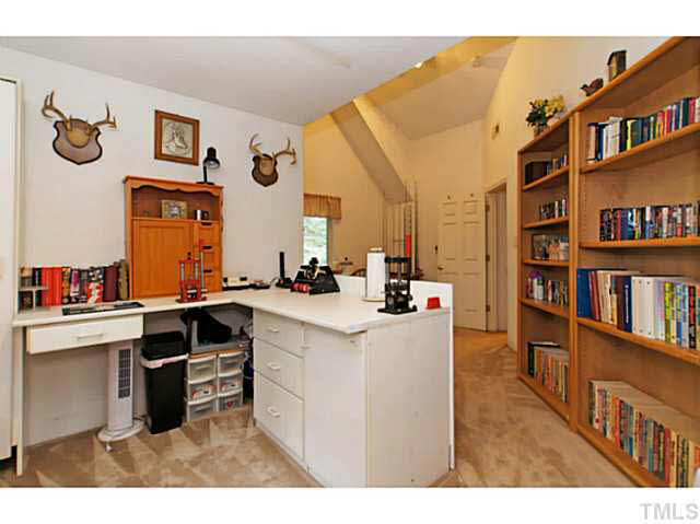

Not trying to get into the battle of the reloading presses. For what it's worth both of my presses are more than 35 years old.
First is my old reloading room with both presses mounted.

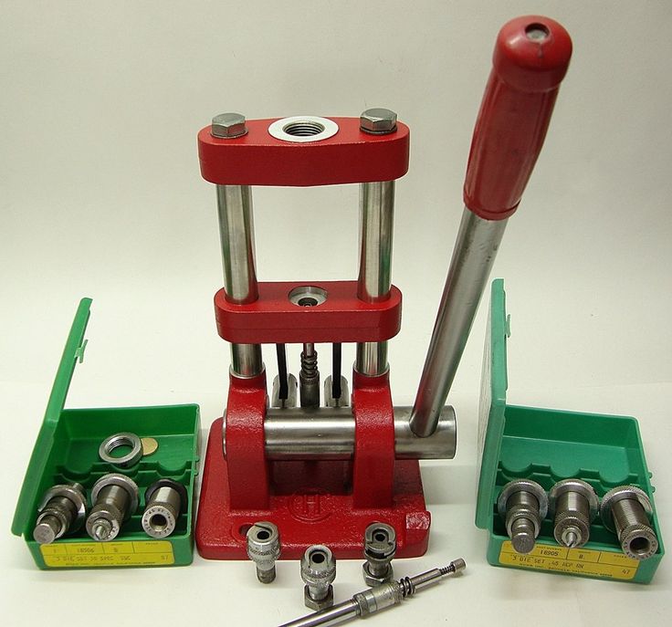

Next is the CH Magnum Press no longer made, but can be found used on E-Bay occasionally.

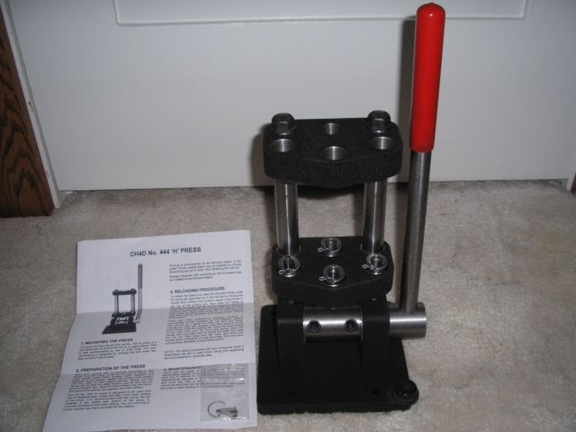

And last is the CH4D 444 press, which is still being made. No 444 H Press
Notice how both bare a more than passing resemblance to SAC's Nexus press. I sure the NEXUS is more robust, but how must robustness do you need??
My CH Magnum is used for resizing and bullet seating.
The 444 press is mainly used lighter chores. I use mine for a Lee Universal depriming die , a Lee neck flaring die , and Lee factory crimp die as applicableReloading.jpgch magnum.jpgch 444.jpg.

The Nexus is clearly inspired from several other presses and combines all the good ideas from these.
I like to quality it as a hybrid between a Turban Präzipress (high quality CNC machining), a RCBS Summit (the die moving down on the case) and a Forster Co-Ax (co-axial design, floating die with quick change). Guess it also takes after the CH Magnum :D

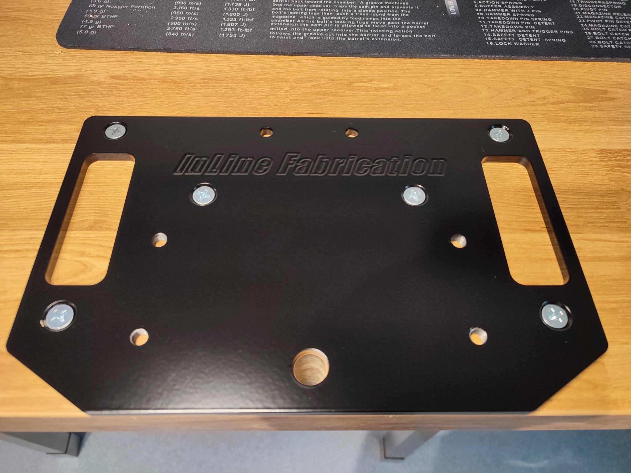

Got the InLine Fabrication mount in the mail today!
Really happy with the product! The mount is very sturdy, and there is absolutely no flex when resizing.
I had to pay an extra $33 for taxes, but it is worth it.
Let's start resizing now :)

If this is not quick connect/disconnect mount what is the difference from mounting the press straight to the bench? Could you have just bought longer cap head bolts and nuts and tightened to bench?

Pretty much the opposite, I think it's a nice addition on the press. I'm currently writing an article for a french shooting revue and I mention it :)
The cutouts are designed for storing shell holders, or whatever you'd like to put in there
