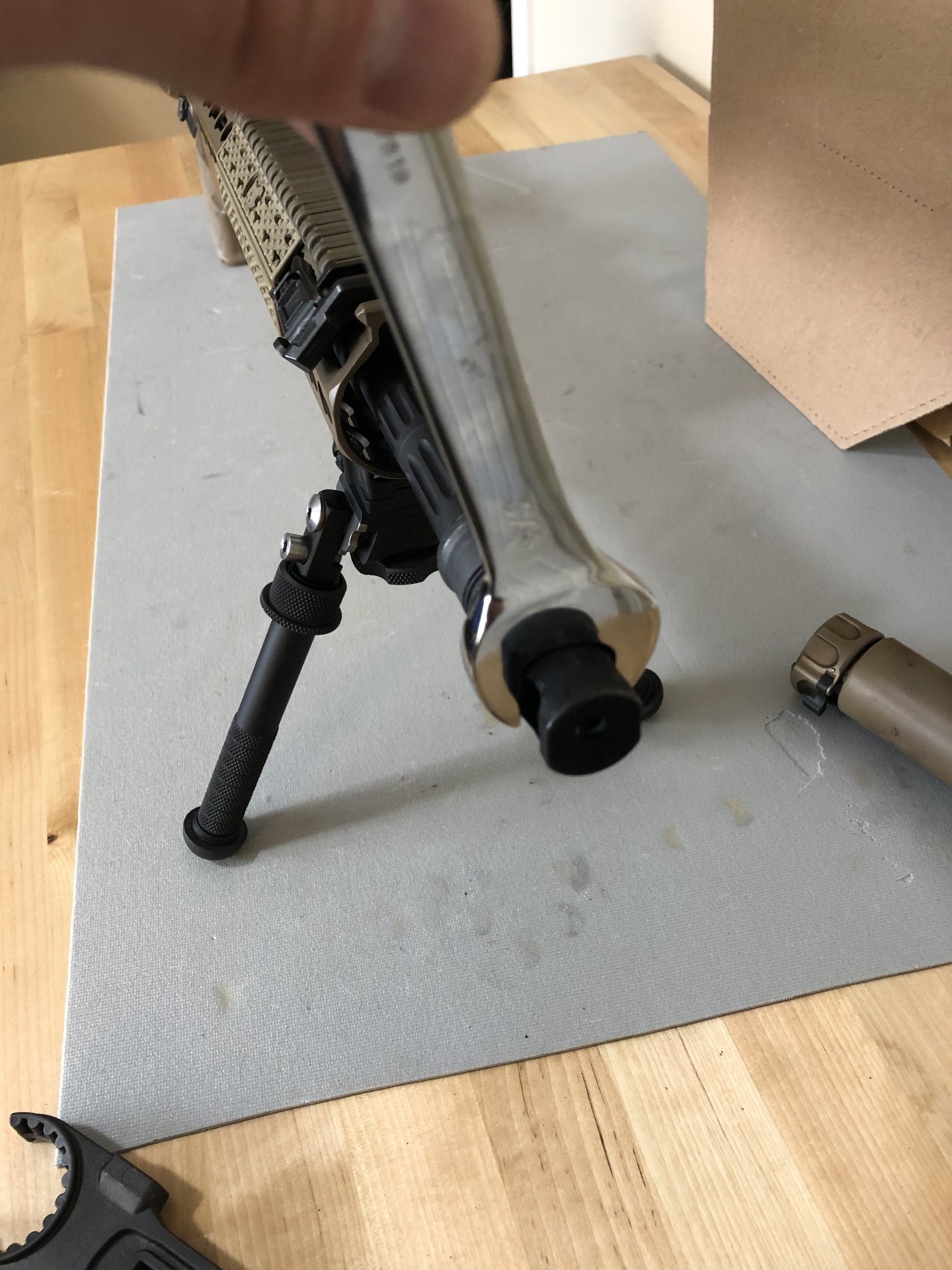

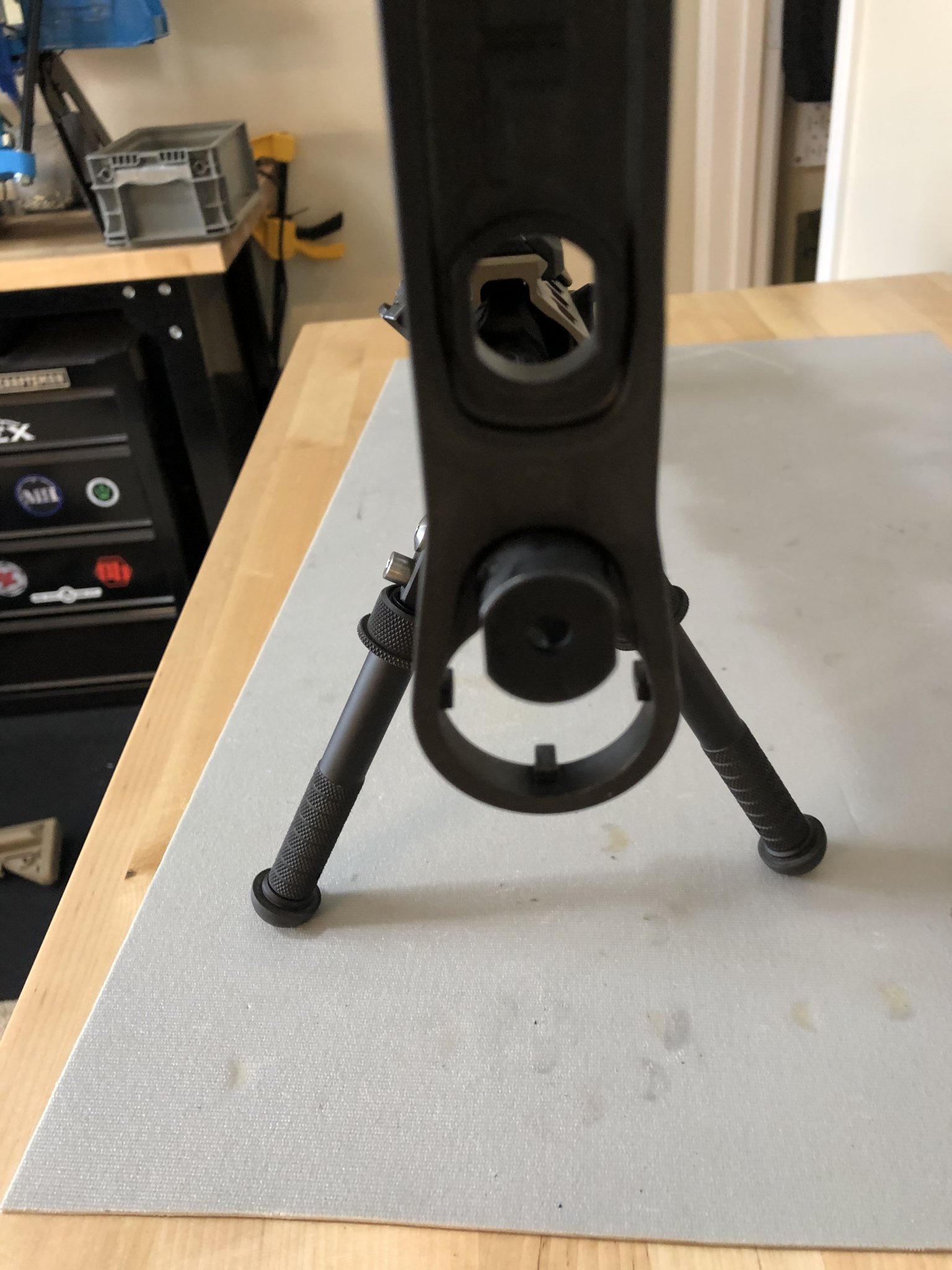

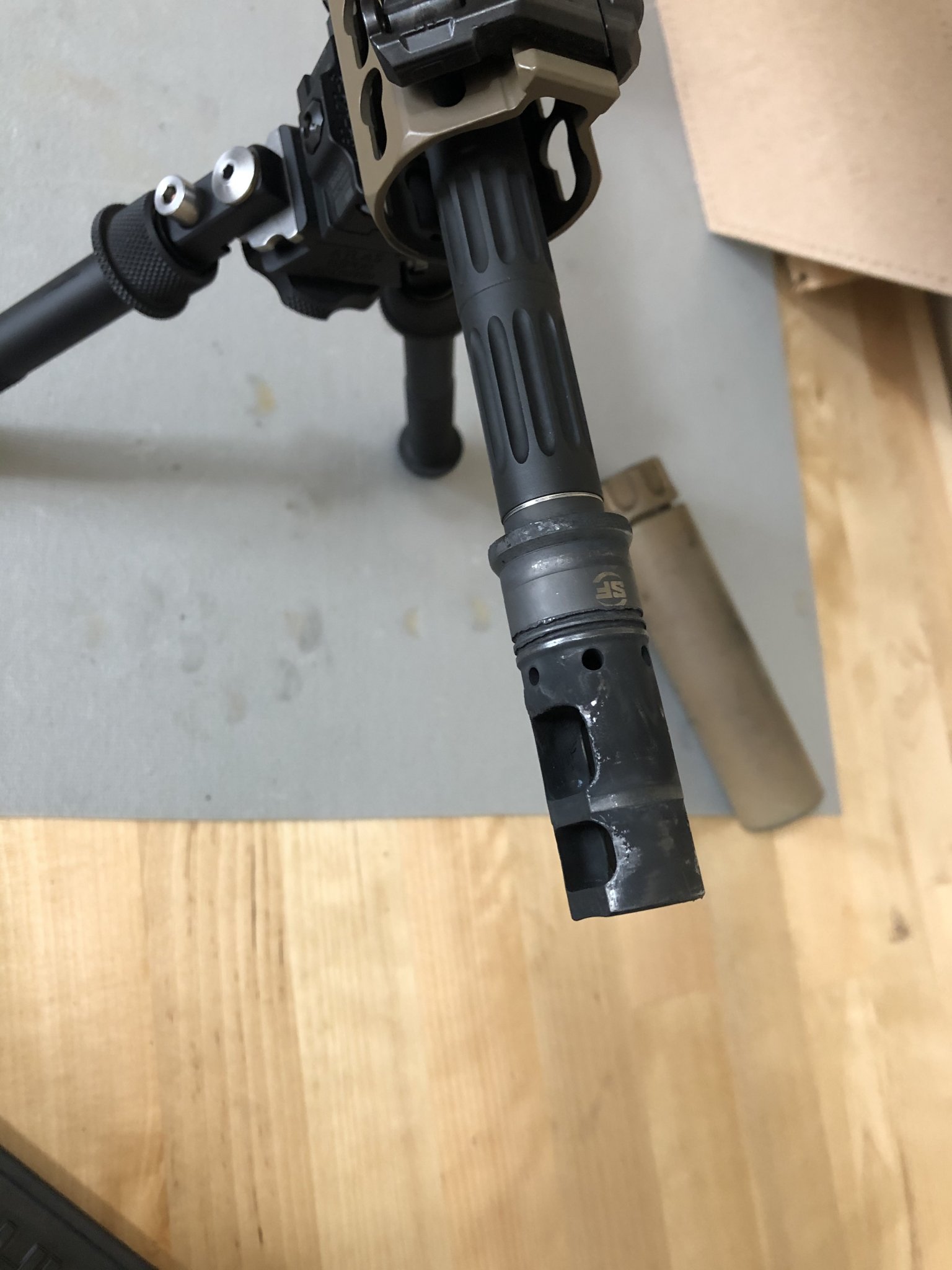

Surefire brakes do have some thin 3/4” flats on the front. Most armors wrenches, or a regular wrench should do the trick.
CBD99607-856F-4F92-9B5C-043CA698DBEB.jpeg0A0D22CE-8DA6-4045-A9A9-A4B291B855FD.jpeg3D4104E5-9D16-4A94-81A0-B72F67F248E8.jpeg
I used my magpul armors wrench last time I pulled one. I used a reaction rod to hold the barrel and upper, and hit the wrench with a mallet and the rockset broke with no issues. (I also installed it with just a tiny dab to start with)

BTW, Surfire brakes come with a little packet of Rocksett, so it’s very possible it was used. That said, the brakes do have a wrench flat between the baffles.
