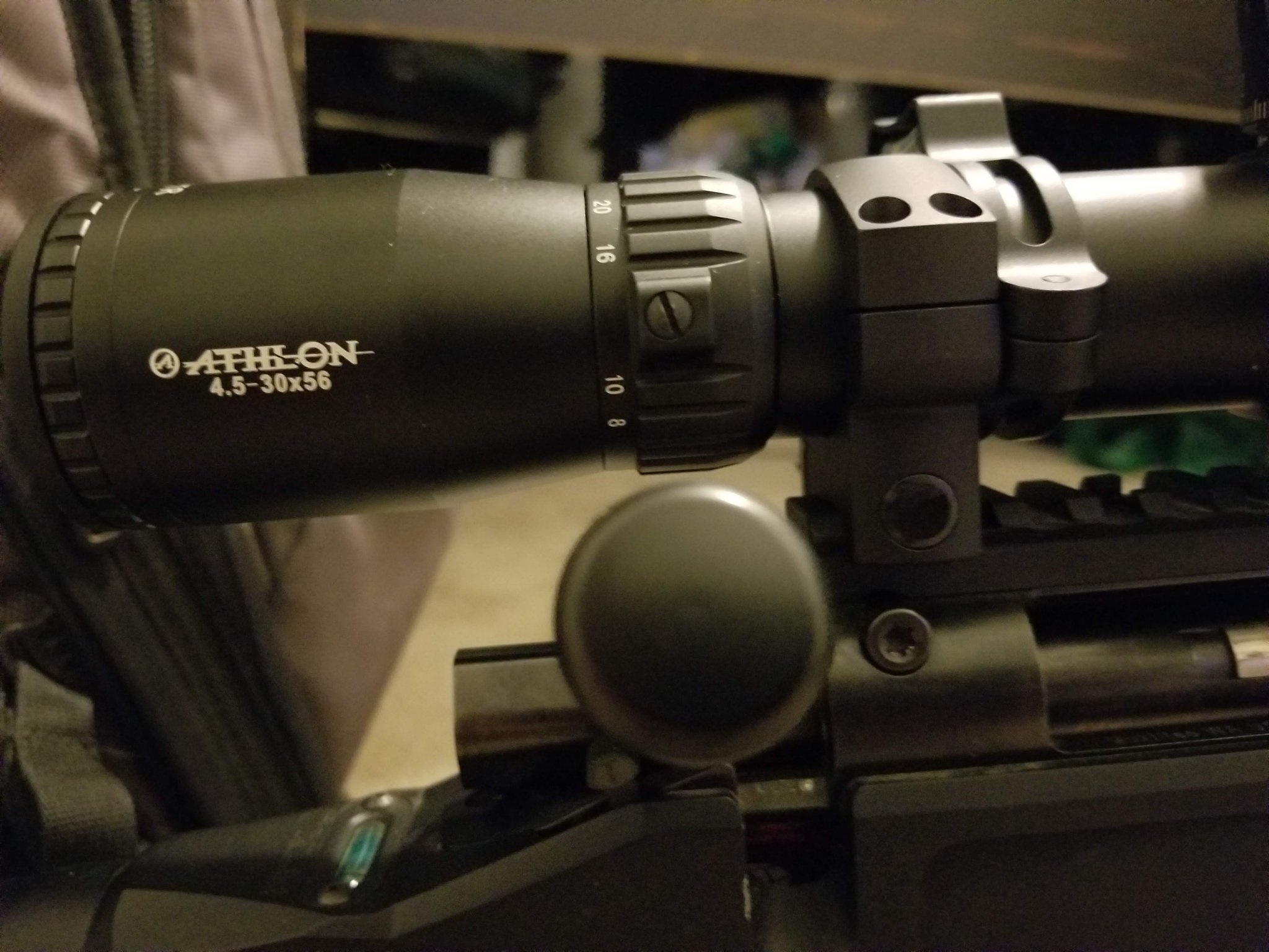

I noticed the new Ares ETR has a machine screw in the thumb knob on the power ring.....Does anyone know was the screw size/thread pitch is on it? Further, would anyone know of a nice aftermarket knurled post that would fit? Further yet, would a post in that position interfere with the bolt throw in any of the magnification ranges? Thanks.

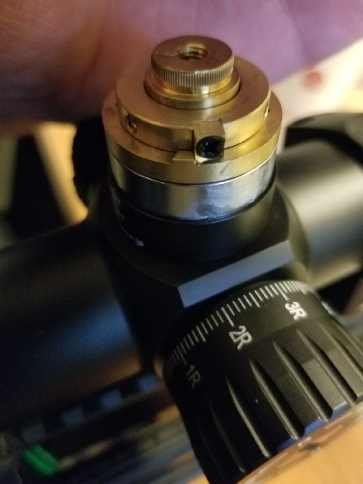

Pictures attached are of the turret zero-stop mechanism and for @StringBender to see whether or not a threaded knob would interfere with bolt throw at maximum magnification. I don't believe it should interfere, but this picture is taken with a Nucleus action so YMMV if you have a 90* bolt throw.
