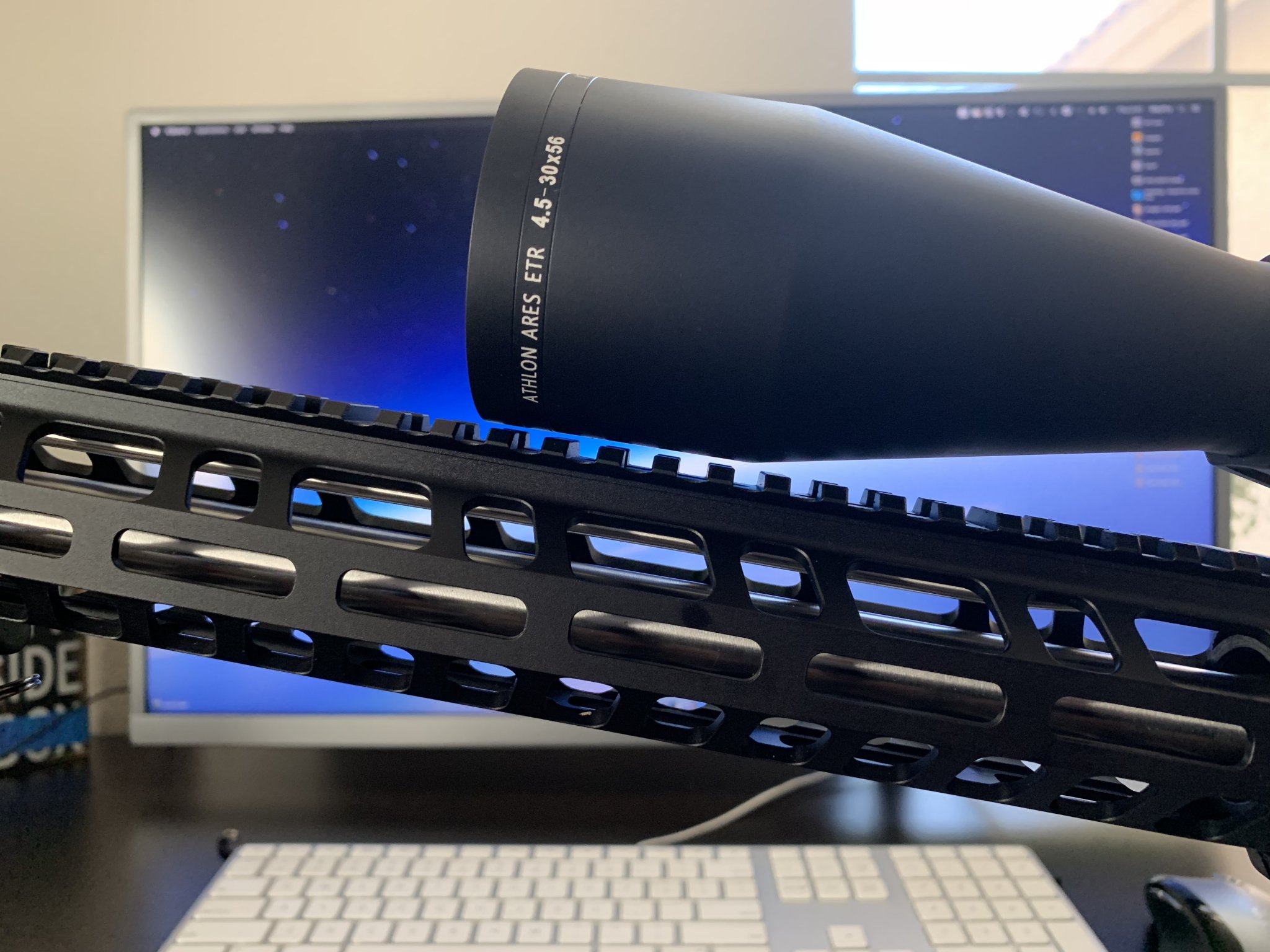

Damn it! How can I take something that easy and make it harder. I've done a killer job at it. Kept looking for 1.25+ (to the bottom of the tube) rings, those are hard to find ya know. It really isn't anywhere near as hard as I thought. Pepr it is then. My ETR comes in Thursday, along with the level, pepr mount and a bipod. Sunday better not rain!
Okay, finally mounted the ETR (mil version) on my Bergara BMP 6.5 Creedmoor. Striving to optimize the ETR for around 1000 yards, I employed the following: Seekins rail with 20 MOA cant and a 1.18" high Spuhr mount which has 20.6 MOA cant for a total of 40.6 MOA (11.8 mils) of cant. This gives me around 27.8 mils of total elevation adjustment while still allowing zero at 100 yards and leaving around 4.2 mils left at the bottom. Using Hornady 143gr or 147gr ELD-Match and centering the scope in the middle of its travel, this setup should be good out to around 1100/1200 yards and out to a mile at max elevation without holds... Additionally, there's still room to spare for some lens covers later on.

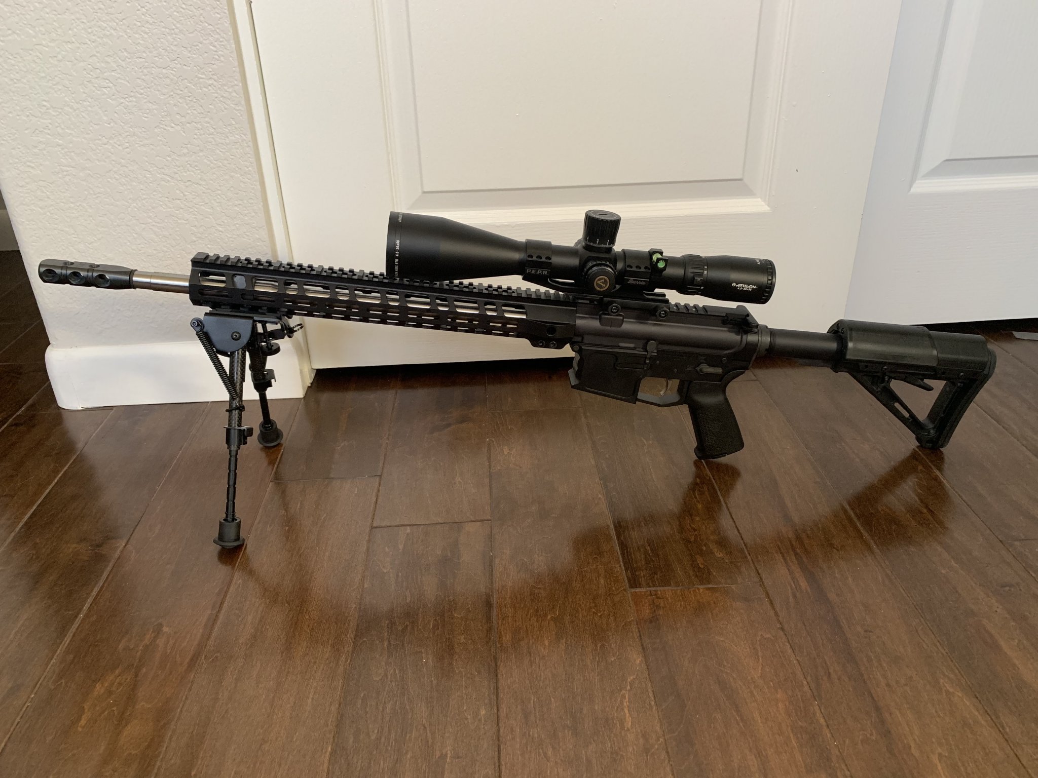

Probably the easiest way to think of ring height for clearance, on an AR, is this:
Objective outside diameter divided by two, divided by 25.4.
So round the objective to 65mm to allow for some room for scope caps. Divide that by two = 32.5mm.
Now divide 32.5mm by 25.4 to convert to imperial and you get 1.2795275590551181102362204724409.
Round that up to 1.28 and you will see, as has been my personal experience, the PEPR mount will allow a 56mm objective scope to clear the handguard of an AR with a little room to spare.

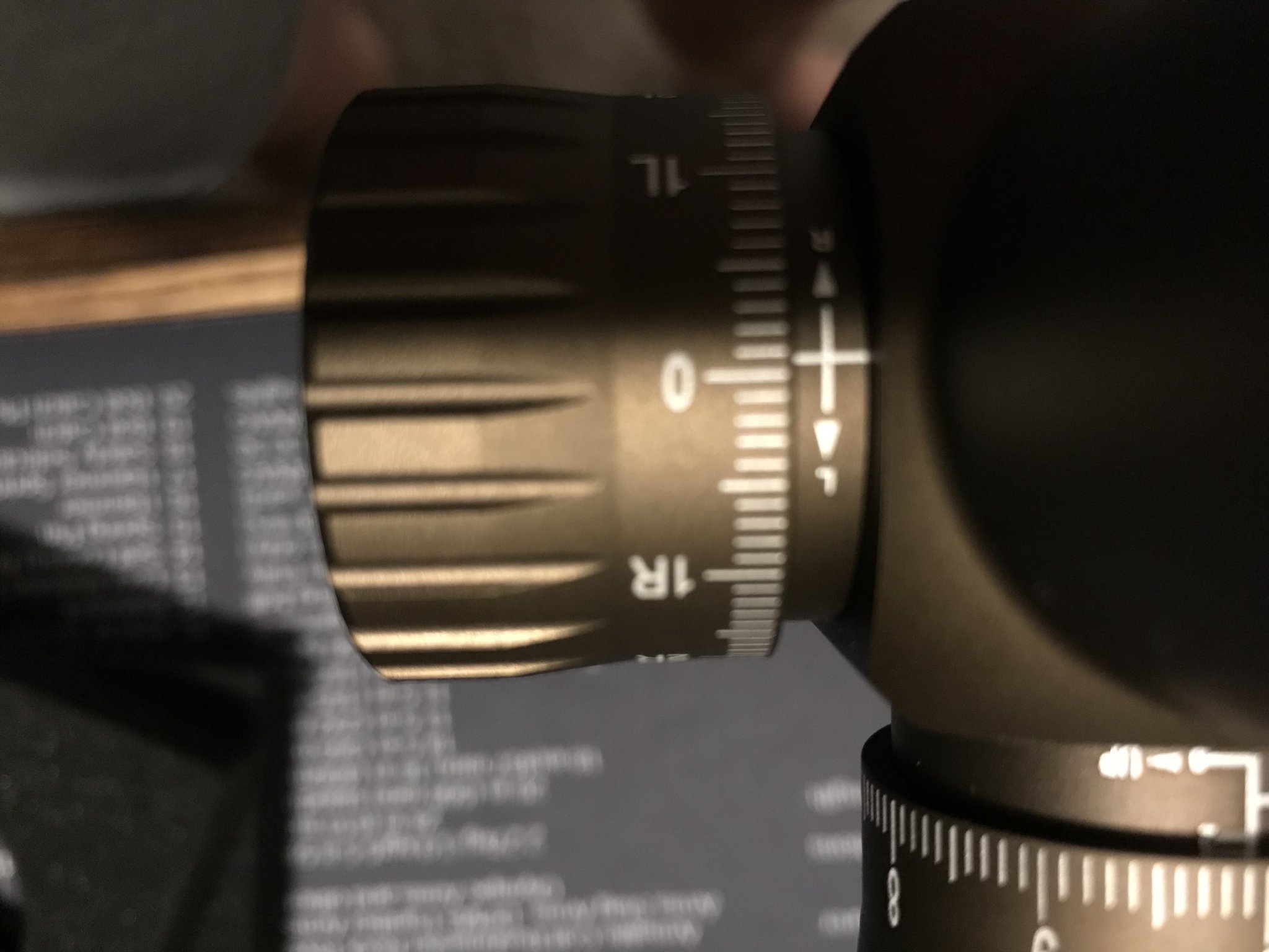

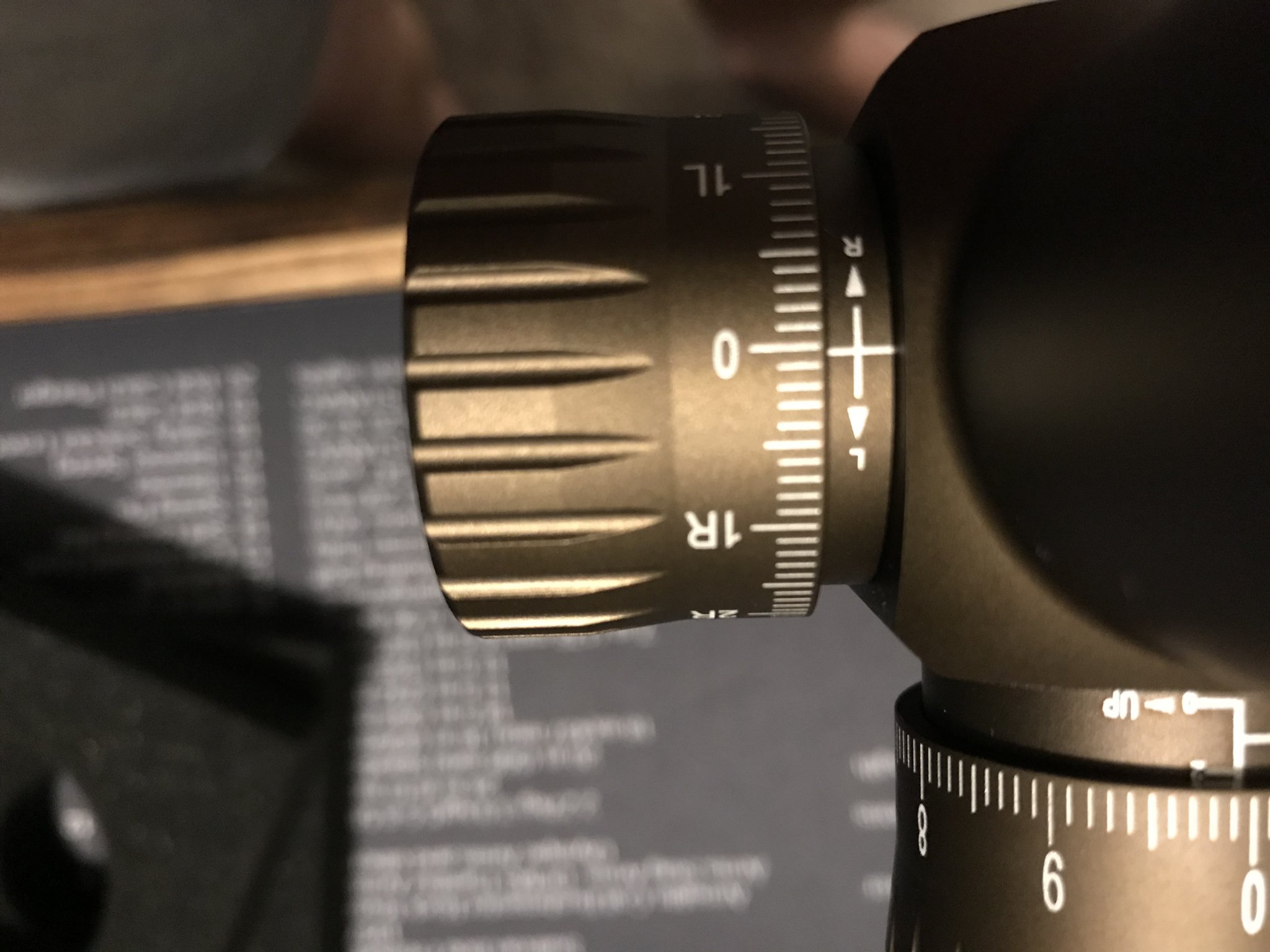

I just received one of these earlier today and my windage turret hashmarks do not line up with the index mark and are almost exactly halfway between the lines and I can’t tell if it’s at .1 or none in either direction (photos attached). I guess I’ll call Athlon tomorrow. Not gonna lie I’m pretty disappointed though.

After speaking with both Doug at CameralandNY.com and Drake at Athlon for few minutes I believe they're gonna get me squared away with a replacement post haste so they can take a look at the unit they sent my original unit.

I would say buy at your own risk with Athlon, I just received my ETR yesterday (it was drop shipped from Athlon on behalf of Cameralandny.com)
I called and spoke to someone at Athlon and passed my contact info to them for the warranty guy to get back to me.
Warranty guy called and I explained to him the problem and he stated he's seen this before on them and says the scope is functioning in it's current condition which I told him I disagreed with as you can't tell where the windage is lined up at zero how would i know three or four turret dials in.
He told me to go through their website and request an RMA and he'd have it back to me in around 9 days.... and wants me to pay to ship it back to them.

That's interesting that you got that response.
I had a similar problem with my original Argos BTR (before they updated the turrets). They told me it was a common problem because depending on where the old Argos turrets were zeroed, the ticks would either line up or sit in the middle. Specifically what they said was if I set my zero 2 clicks in either direction it would line up perfectly with the hash marks and where I was at was set so that it would line up perfectly in between hash marks. That meant that the old Argos turrets would only line up perfectly if you zeroed it on the right setting, which happened every half a mil.
I haven't seen that problem with my Ares ETR (I've messed with the zero to test if it would happen), but I totally understand the frustration. The odd part to me is that when I mentioned that problem to them about my Argos, they actually had me send them a picture of the turret cap and my address. Two days later I had a custom printed turret cap sitting in my mailbox that lined up perfectly with the zero on my Argos BTR. It's disappointing to see that's not the standard of customer service anymore.

I think there was possibly some misunderstanding with my explanation of the situation with Athlon this morning because shortly after that we resolved the situation amicably and painlessly.

Not that it’s acceptable but in my experience with half a dozen Athlon scopes of the 1 or 2 of those that have had that kind of misalignment I can favor one direction or the other while I tighten the turret screw and there’s just enough play to get on my marks I kind of expect this kind of thing on the cheaper scopes but even on my cronus if I don’t hold the turret cap where I want it while tightening it would be off a little bit
FWIW I did try this method to see if I could get it to align.
