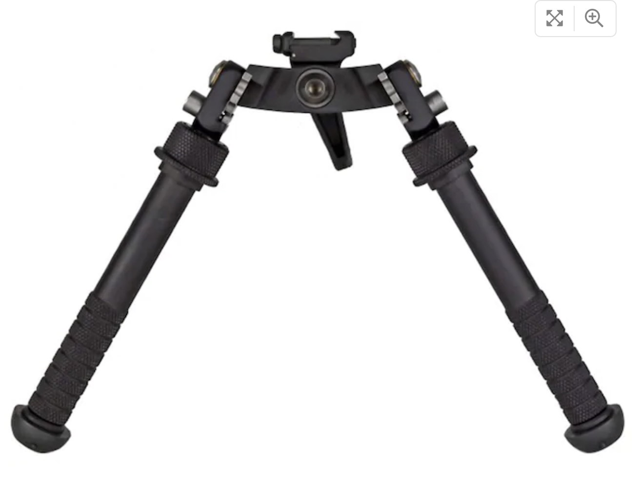

I'm looking at Atlas Bipods now and am considering which of these would offer the best "Apex" point over my bore. I know the 5H definitely would, but I don't like the idea of not being able to fold up the legs. I think this one might do the trick.
Atlas BT65 CAL Gen 2 Bipod 1913 Picatinny Rail Mount 4.75" to 9" Aluminum Black
Screenshot_2019-10-29 Atlas BT65 CAL Gen 2 Bipod 1913 Picatinny Rail Mount 4 75 to 9.png

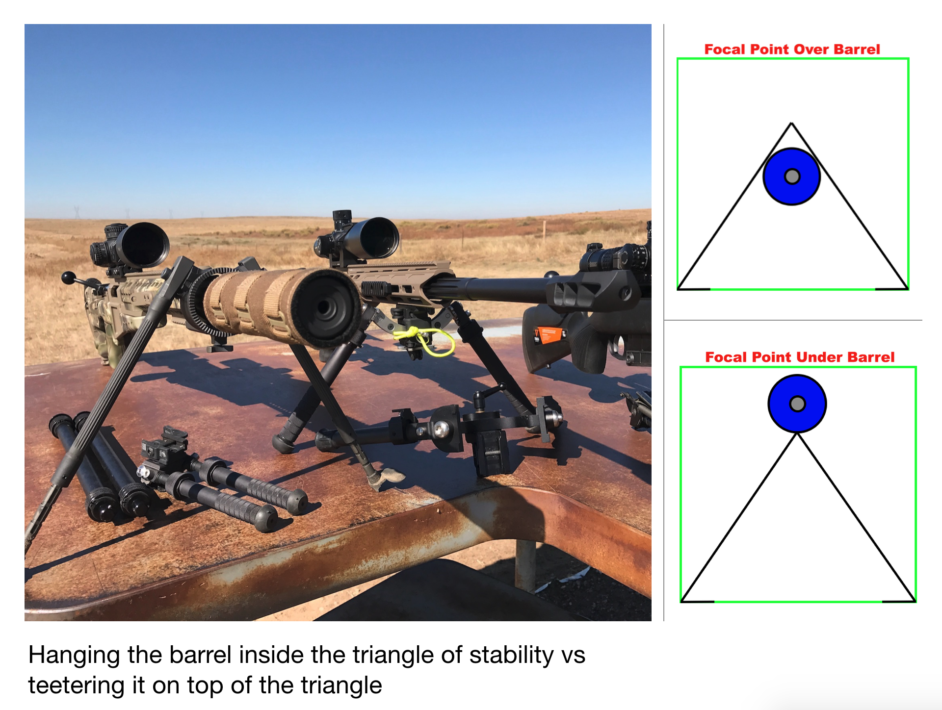

we make do with so much. we are adaptable to the Nth degree.
I qualified in the USMC with a rifle that had a fixed 10x using a P3 type mil-dot reticle, that could not even accept any form of a bipod.
We shot off a ruck or our shelter half poles tied with 550 cord to make a tiny tripod. Our qual is to 1000 yards and includes movers. yes, we did it, but it was not optimal. today that same qualification with modern equipment would be a cakewalk, instead of 8 out of 20 guys failing like we often saw.
We have tons of examples of Harris bipods doing well, but today we also have a 1/2 dozen or so examples of IMPROVED bipods that help promote precision. The idea to support your PRECISION RIFLE, not compromise that precision with a sub=par part of the system. The bipod is an important component, if I asked you to accept an Okay barrel, vs a proven one, most would opt for the better barrel. But when it comes to bipods, everyone defaults to the cheapest thing they can get, which is usually not an Afford thing, it's a choice.
There is reason guys in Benchrest and F Class gravitate towards wider stance bipods, it's the triangle of stability.
In order to keep the bipods small and light, like an Atlas or TBAC, the triangle is a bit wider than a Harris, but the entire platform is much more stable. If you follow the triangle of stability, you see the goal is to hang the barrel inside the triangle versus teetering it on top.
Think of a suspension bridge, hang the road inside or balance on top, which is more stable?
Guys repeat what they see, they see more Harris online vs any other brand, so they default to a Harris or a similar-looking knockoff because what is the difference. However, if you educate yourself on the role a bipod plays in both precision and position (canting) you find out quickly the Harris is lacking.

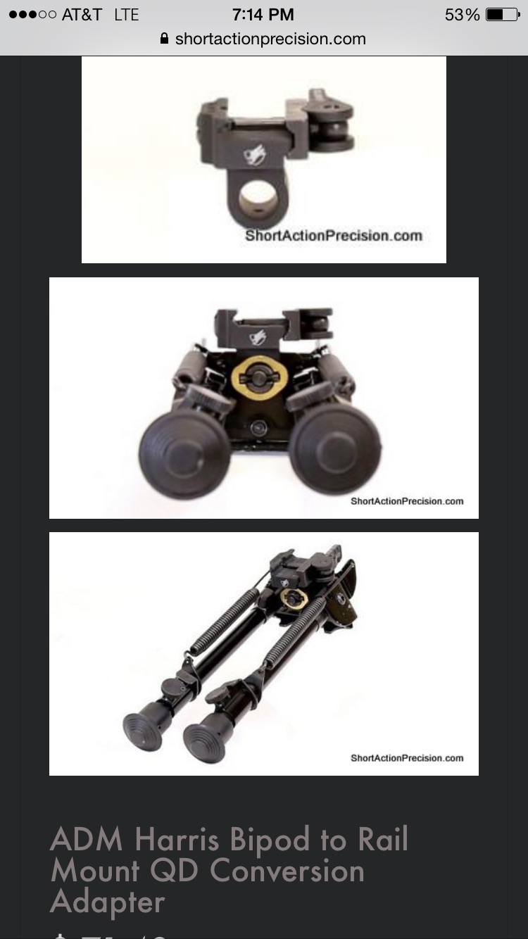

get the NC or ADM pic mount, not the 2 screw

"Triangle of stability"....excellent.

The CAL above is pretty stable, but to your question, the apex point is not so much the issue as the pivot point. The pivot point is right below the rail clamp on the CAL. That’s very different from the 5H where it actually slides left and right on a curved rail, so the pivot point is effectively above the mount. But you can still get a lot of stability from a CAL.

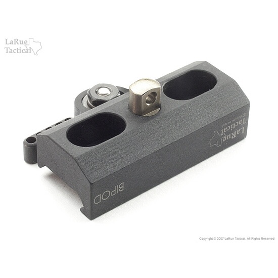

People have no clue how to "Load" a bipod and think that pushing into it is loading it.
The reason a bipod like an Atlas is better, especially for a gas gun is that when they push into a Harris with the handguard it will flex and pull the shot off target. Taking the Slack out you are not putting extra force on the rifle, it's taken up in the slack.
As well the Extra pieces needed to mount the Harris as LaRue uses is a terrible way of stacking errors under the rifle. That system is a band-aid and not a solution. You want fewer connections, not more.

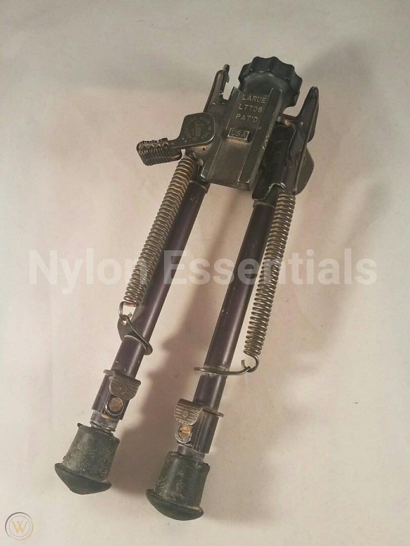

Are you talking about the Larue modified Harris or just their stud adapter? The modified one replaces the stud attachment and is tight. No slop
the newer larue/harris combo that larue makes using the harris bipod (not copped together) is pretty tidy with nothing extra.
