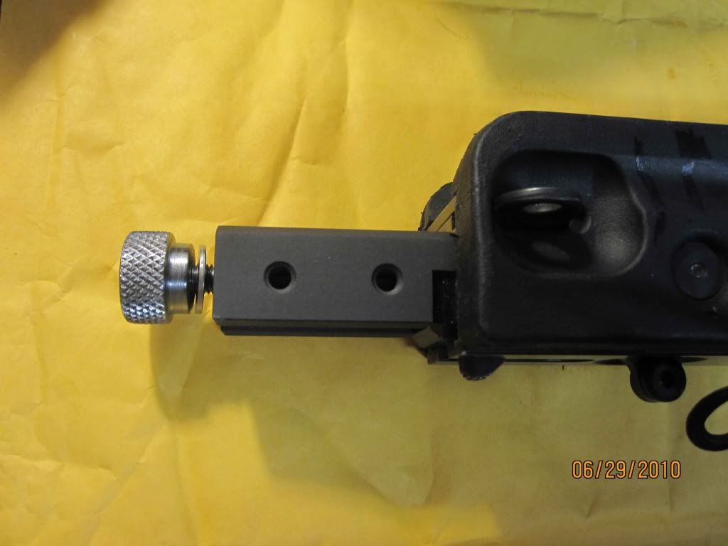

Here is the new V2 AI Spigot prototype, seen in the loose position and in steel, we might use Stainless Steel. There will be a flat washer followed with a lock washer then the knurled nut which is retained on the spigot. No idea on cost but it is designed off the older style so the end user can swap the new for the old. The idea is to loosen the nut press the spigot into place on the stock then tighten the nut.
Nothing new, nothing novel, just plain old mechanics.
What is interesting to me is that with the tolerance found in the actual AI bipod spigot, I thought the bit we had with our Atlas/AI spigot it should be fine. Then you guys taught me different! So I hope this satisfies the need to make things tight, on my chassis, the fore-aft movement is gone and there was no 3 to 9 rocking either and that is hand tight, no tools used.
Suggestions comments welcome.

Kasey, the design looks like just what the doctor ordered. It would even allow some slop for those that like it. Now we just need shipping dates!
Re: Atlas with AI spigot
The338LM yes it is adjustable like that.
Ship date, since I suck at predicting delivery dates, I'm just going to say the design is approved (slight tweak) and production starts quick as machine is open.
Kasey, how much tension is required to stiffen the assembly so it does not wobble? If it is very much at all, I would suggest that the knob be made just a tad bigger to allow for usage with gloves and people without alot of hand strength. I don't think it would need to be much bigger but even a little coupled with the cutout spaces like the tightening knob on the bipod may be of great benefit.
Whatever the case, I want in line for the upgrade and will be anxiously awaiting cost and availability information. ;-)

A quick check indicated that the OD of the Atlas knob will pass into the barrel channel of the AI chassis by about .175", is there any chance that will interfere with a larger diameter barrel?
The current knob is .75 in diameter and it is really not that hard to tighten, I'm guessing about 20-25 inch pounds to bottom the washers out.

The English tension knobs (in my post at the top of this page) are 1 7/16" in diameter, if it makes a difference to you.
I <span style="font-style: italic">can</span> tell you that .175" isn't going to make a difference for my Remington 700 in an AICS, Remington 40X in an AICS, or my AW-50! But it might make a difference to somebody.

Question to consider and one I worried about playing with the airsoft part was the strength of the AICS latch the holds the spigot. Would it be possible to put too much tension on the spigot and round off/snap the catch holding it in place? Just a thought.
Thanks fredreded, I appreciate the demonstration and I've replied to your PM.
In looking at that 1.38 washer, I'm thinking the Atlas Knob at 1.51 is too big. I'll see what we can do, but Ohiogunnut raises a valid question. I suspect the lever will take the pressure as long as the knob diameter is reasonable and tolls are not used to "tighten" the affair...
