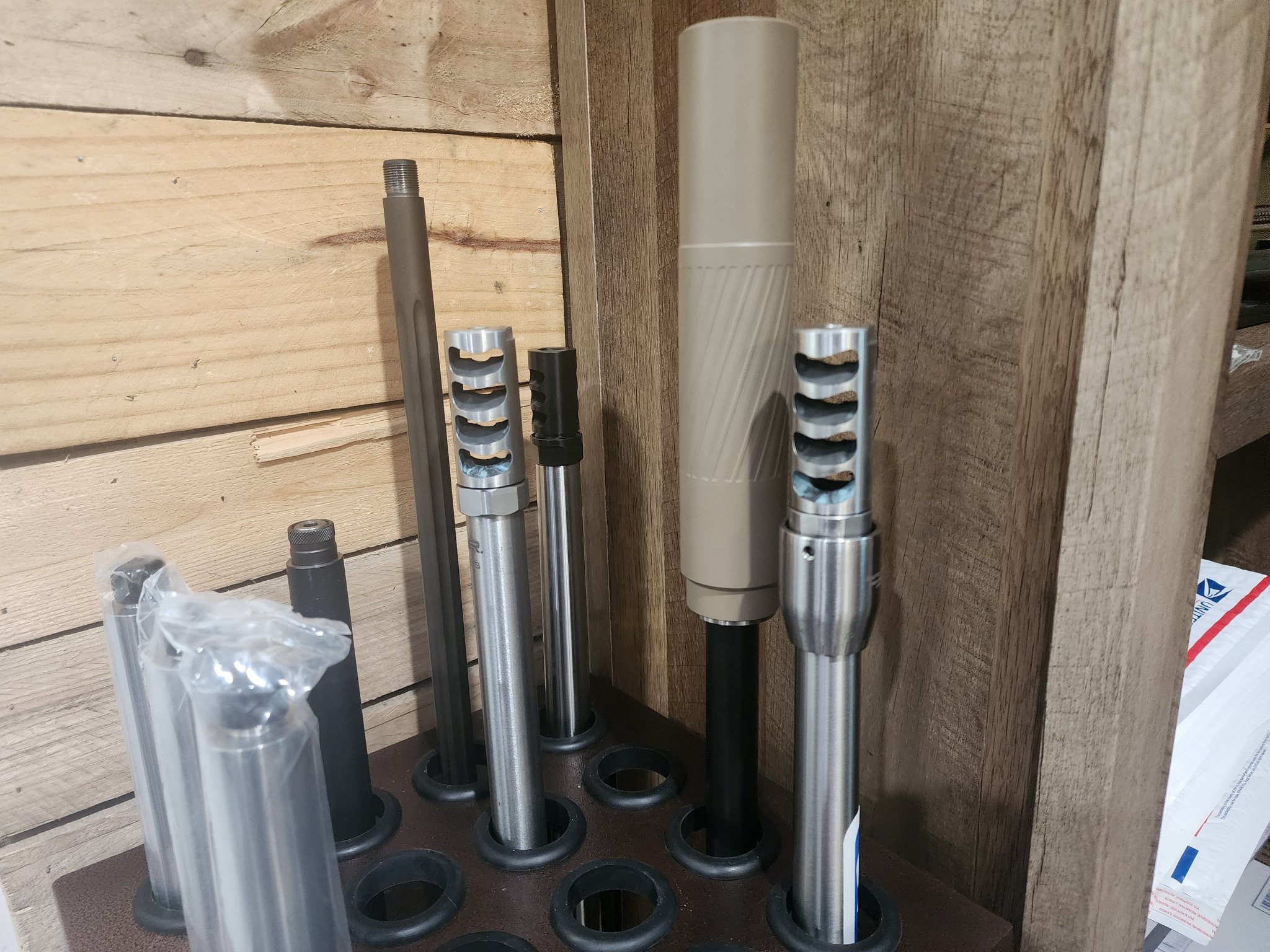

One on left is a 6mm. One on right is a 6.5. Rest of them are on guns.
I havent even played with tuner yet. Thats on a barrel i only shoot factory 6.5 ammo but ive been so busy with other match guns and life, havent even had time to play with it. In fact, the gun that was on has a .223 trainer barrel on it now.

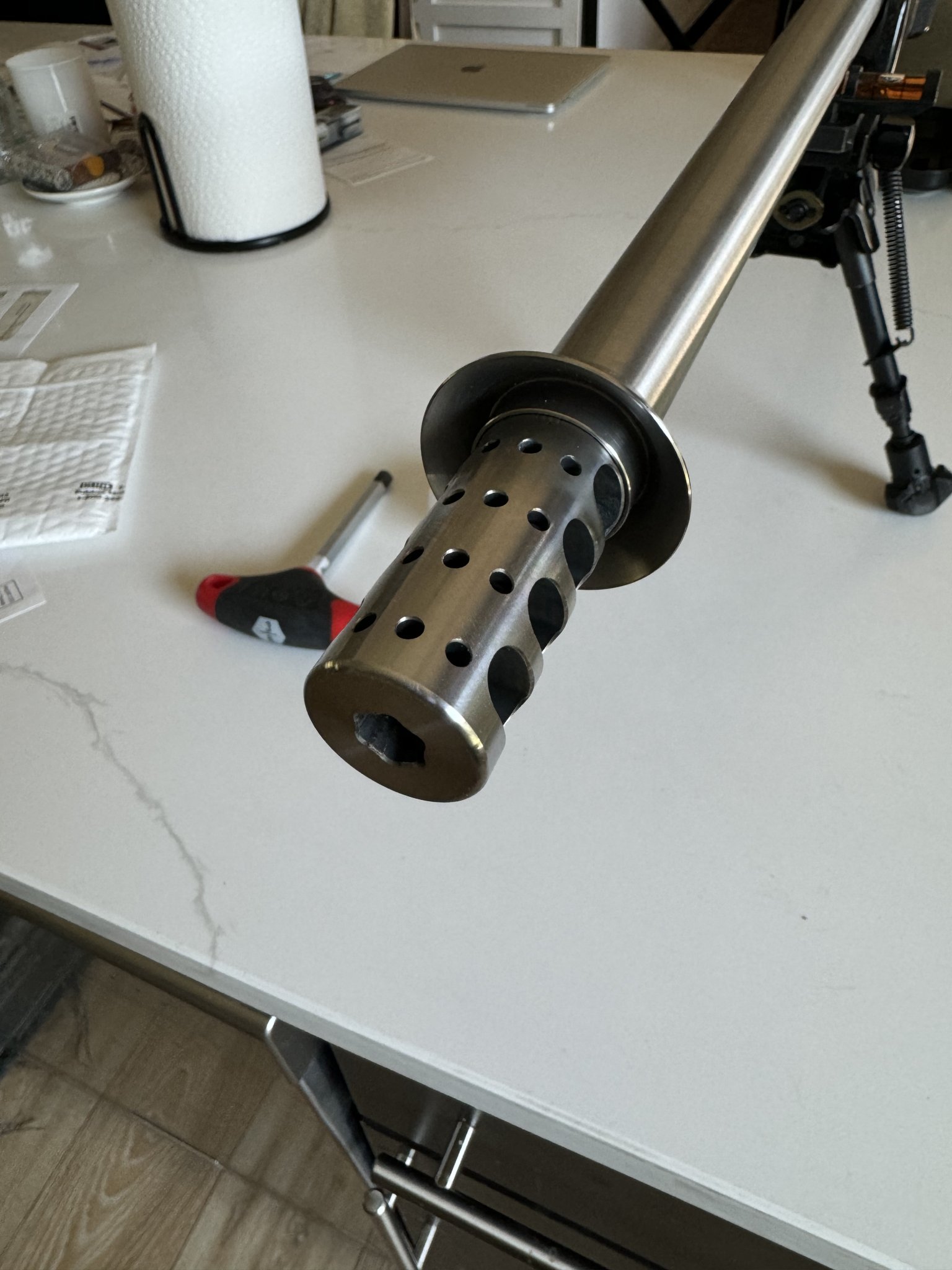

I’m currently shooting the ACE with their newer shield added and am pleased to report that it’s awesome.
If you care about your hearing you need to be using a can or the ACE/shield setup (IMHO).
What’s crazy is, I think the shield actually helps the ACE work better (at least for me). IDK if it’s just a feel thing due to their being basically zero concussion or what, but I haven’t been running it for very long and I have been seeing more impacts/splash than ever.
The ACE is really mild as far as brakes go on its own, but the shield turns it into a pussycat.
