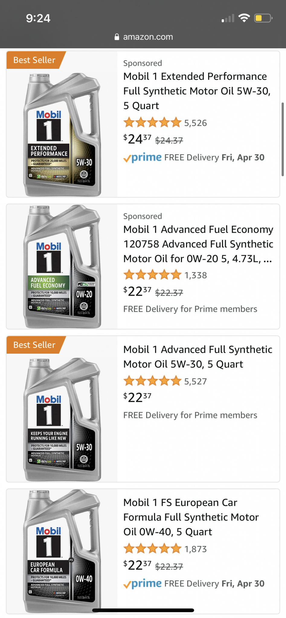

All I want to know is whether the Mobil 1 fully synthetic ive always run is crap or not? As stated above ive had many Toyota’s run between 400k-800k. I’m not sure if that has anything to do with the oil or just the build quality of Toyota’s but I only ran Mobil 1 in all of them.
I think you've answered your own question. Regardless of the quality of the car build, if the oil sucked, you wouldn't be getting that mileage from your cars.
