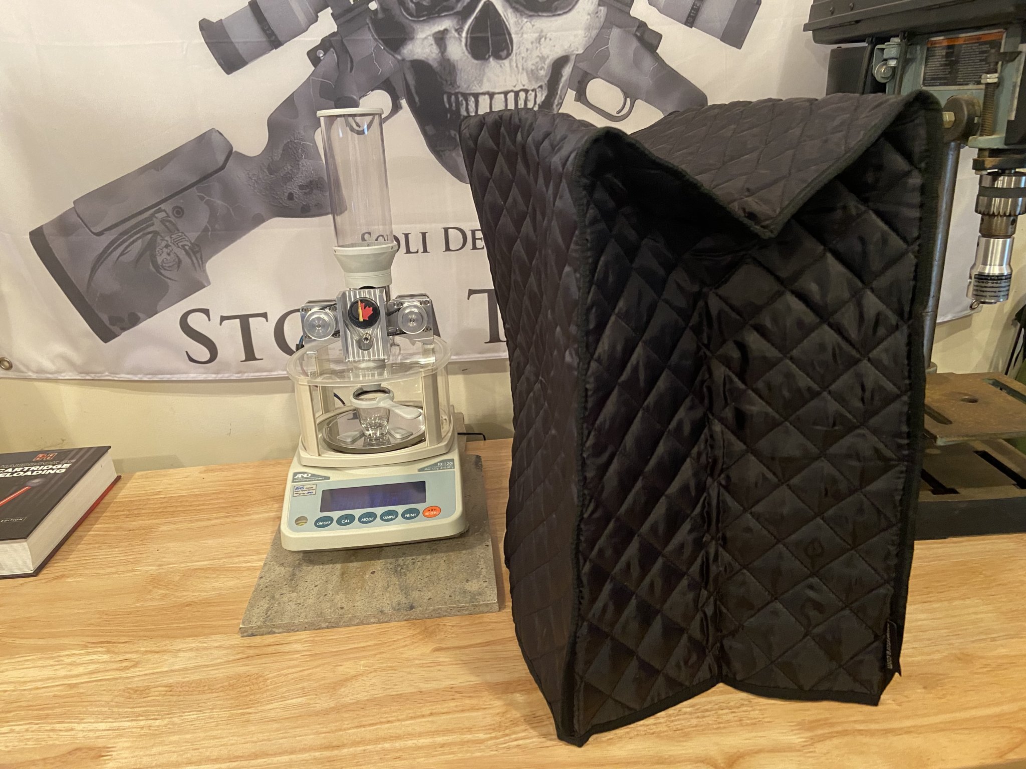

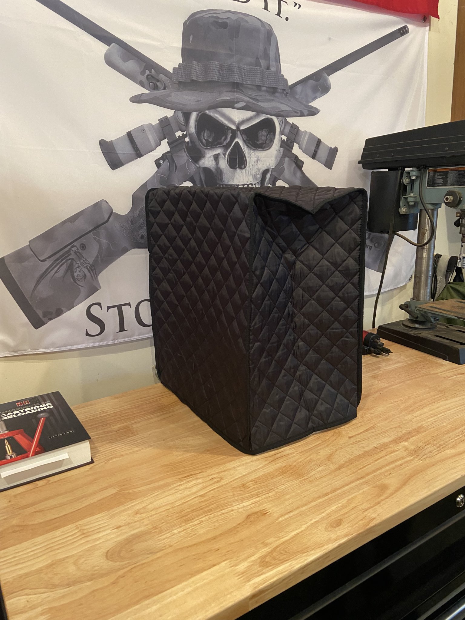

Thanks. I get 12x8x17 with the hopper still attached. The food processor covers didn't seem to fit the LxW of 12x8 but I found a Juicer cover that has a big of extra space. Will report back and post link to it if it fits.

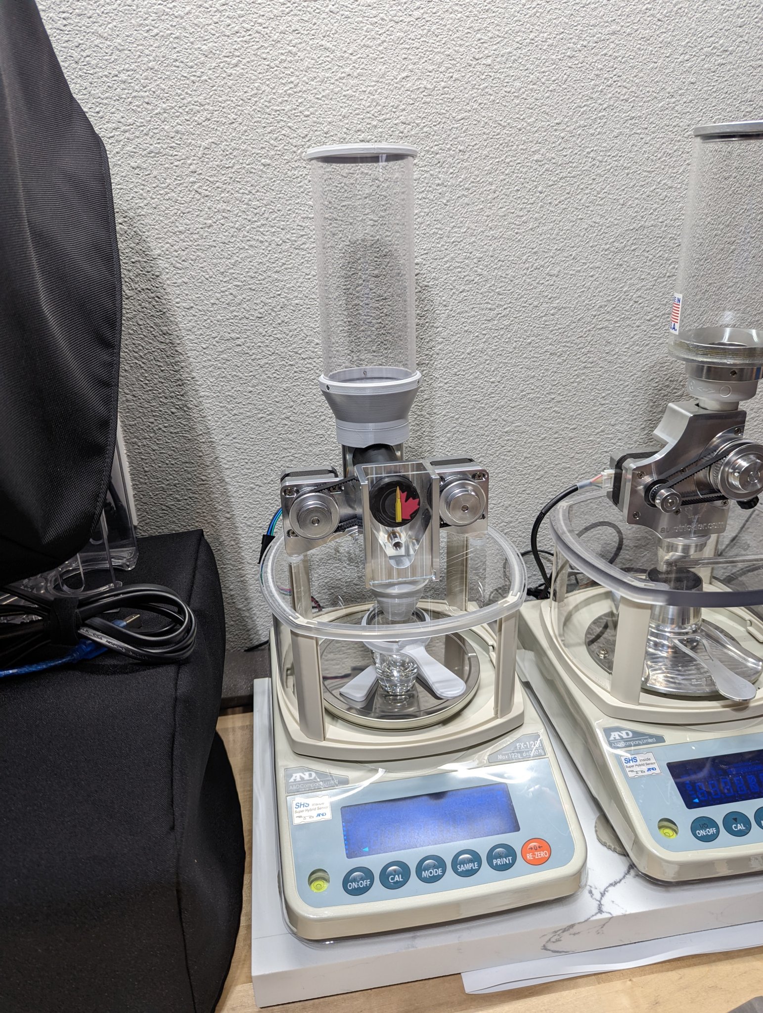

I saw one of the reviews that showed the upgraded cup doesn’t fit as well on the original tray. I’d been thinking about upgrading to 419 parts for the V3 but hadn’t got around to it. Now they’re running a cyber sale and I don’t want to buy anything without it still being valid. So I know the lid is redundant now but can anybody please enlighten me/us on what will still be relevant?
If you've got a V03, the Area 419 tray is a handy upgrade, but the location of the drop spout in the V04 is moved forward a bit so that it doesn't align with the centered divot that the powder cup rests in. It doesn't prevent you from doing accurate drops, but it negates the handiness of the new tray.

I might wait before I buy any 419 upgrade parts unless somebody that has theirs has any thoughts on what would still work w the V4.
Their cup works great. I’ve never been a fan of the shot glass. I found powder bounced a lot with the V3. I used it once with extruded powder in the V4. Nope.
I happened to have a second 419 cup, and it works very well with the V4. The rest of Area419 stuff……..

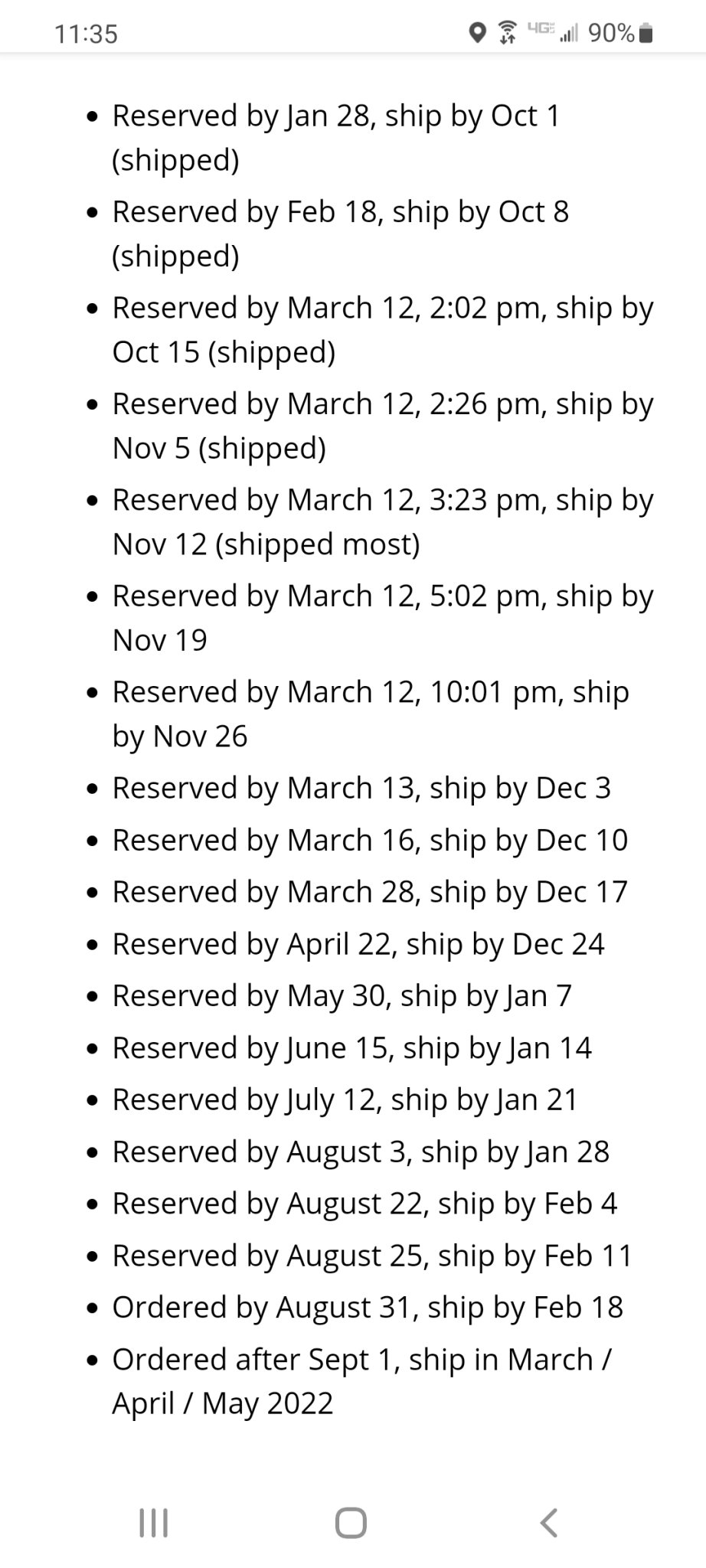

I just found my invoice in the junk mail folder from 11/25! So for everyone who ordered on 3/12 around or after 3:15 eastern time, you might want to double check that you don’t have an invoice waiting to be paid.
I just received my V4 yesterday. I was a 3/12 between 3:07pm and 10:35pm Atlantic reservation holder and paid back in August maybe. Have not had a chance to open the box, but looking forward to it!
Damn. I thought the whole "pay invoice" was because your order was shipping out in 3-5 days. I got my invoice and paid on Thanksgiving... hopefully, I get it shortly and not in late January or February.
From Adam's email from this summer, shipment is being made based on reservation date/time, and you could pay just before shipment or early and wait, with supposedly no negative impact on your reservation time. I just paid because I hoped it might ship earlier and I might forget to pay later.
If your reservation was like mine, it should ship shortly I would assume as he is shipping the 3/12 3-10:34pm Atlantic reservations.
I didn't pay when I got my first notice and opted to pay when it was 'soon to be shipped'. Hence my question. Mine was reserved in the same time frame as you. Just sent him an email to ensure no issues with my invoice as per the above, mine should've shipped by 11/26; I paid 11/24.
Well, after reading this (just happened to see it as I was scrolling past), I started to wonder about what was up with my order. I ordered early, but still hadn't seen anything.
Soooo...I log into my gmail and search on "Adam V4"...nope, just the normal notices about what order they were shipping in, and that my order was supposed to ship on the 12th of Nov..
Hmmm...on a whim I searched on "Adam MacDonald", and lo and behold, there's my request for payment...dated Nov 25th. WTF?!?!?
I then noticed that it came from a different email address than all the other correspondence. FML...smdh...
Payment submitted. Now I guess I wait.
