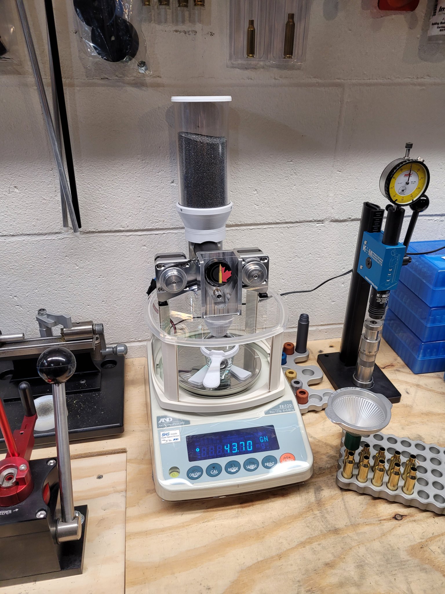

My tracking number showed up about a week after I paid in full. Mine should arrive Tuesday. Mine is a converted v3 order from about 3/10, so right before the v4 was announced and orders started
First real loads last night with it.
I had ran some Stabal through it on initial unboxing and set up. It was a little slow (around 20 sec) but uber consistent.
Last night I loaded some up for real using 72gr of RL22 for 300 WM using 190gr SMK.
Shimming the rear with what ended up as 2 business cards sped it up considerably. I had the slider on about 8 or 9. I think I can shim it even more, it warrants some experimenting. I ran the "Calibration" again after shimming.
RL22 is pretty coarse and did not want to flow through the smaller tube smoothly. Most charges were +/-.02, I did get an occasional overthrow of 72.06 as a max. This usually occurred when the kernels would bunch up in the tube and at the slowest rotation, it appeared to drop 2 before the scale had registered the previous kernel. The green light on the Autotrickler would not come on when this happed, and of course the DRO showed it as well. The green light is not extremely bright but visible under bright overhead lighting. You get 2 warnings if its off target.
I did not get any kernels bouncing out of the cup.
I have mine on my bench without any special isolation and without a line conditioner, I did not experience any drift of the zero. I checked it after seating bullets on the press mounted on the same bench. The reading would fluctuate during press motion but always returned to zero.
I'm am very pleased thus far with it.
The instruction booklet has some settings to go through, mine were all factory set from CE. I'd still recommend checking them.
I don't know if it matters to anyone but I did need to have my location enabled on my android phone to connect to the scale. Maybe try a tinfoil hat if it bothers you.
