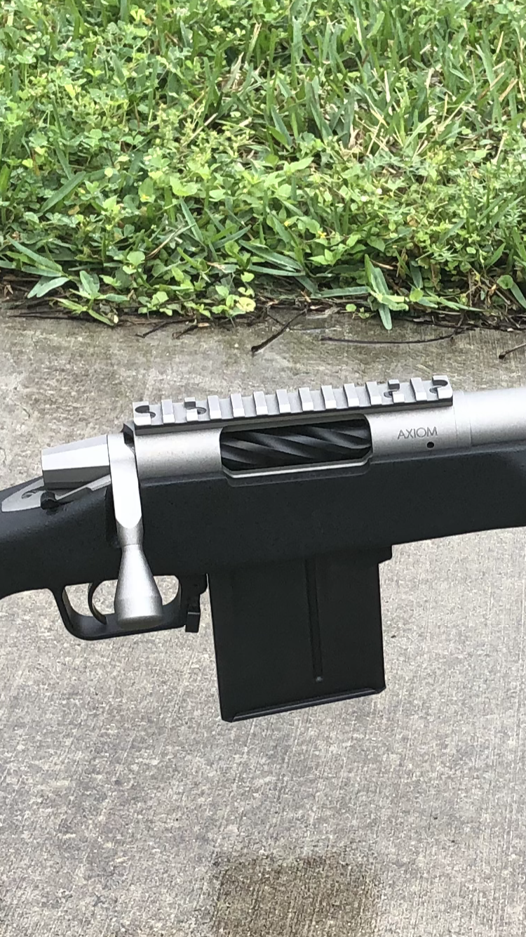

Here is a photo of a axiom in a mcmillan 700 rem. This is how they fit any stock I put them in.
Reactions: smacha538

The bolt release sits high on these actions. It won’t be a problem. The bolt handle will look like the photo I posted. There is clearance there. It won’t rub. Like I said, never had a problem over several stocks and chassis with either fit or feeding issues. If you decide to use magpul mags (i dont like them) a few swipes on the feedlips will allow it to be cycled with upward pressure as well. Magpul mags are junk in many actions as you cant take off enough material to get them to not bind bolts when pressure is applied.
