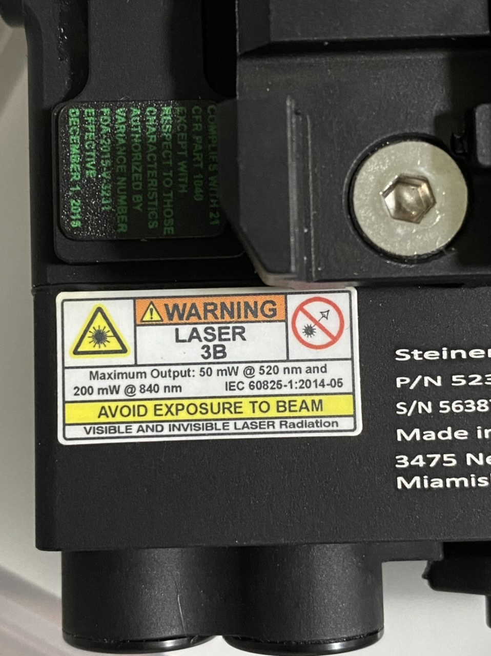

What makes you like the KIJI better?
Build quality is far superior. The beam is much cleaner, no laser artifacts.
On the Luna, the Surefire adapter is really crap, I made a new brass one. The mount is also crap, so I made a adapter to put a LaRue base on it. The adjustment screws need to be replaced with thumbscrews. While the beam has great power (after removing the filter) and the rheostat is nice, that's the only really good thing going for it.
That's a pretty fair assessment.
The mount shown solves the aiming problem perfectly well, locking screws and all. I get the beam perfectly centered at 100 yards at 30x. Would adjustment screws in the head be better? Maybe, but I much prefer this setup to the Luna, and I’ve upgraded that to a LaRue base and thumbscrews for adjustment.
Can you send me details to your larue uograde?
I milled out a strip of Aluminum to fit. The strip gets threaded holes for screws on the LaRue side, then through holes for the screws to the Luna. You'll need longer metric screws to the Luna, the factory ones are quite short.
Pics?
I no longer have the Luna, I'll look and see if I kept dimensions. It's 20 minutes work on the mill, you could do it on a drill press and some file work.
Reactions: BENRAY236
I wanted to make it work with the kiji as it is what I have on hand. I purchased a X and Y adjustable light mount so hopefully I can make it work
