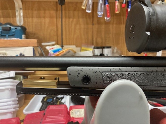

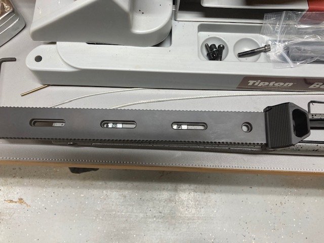

My rail arrived yesterday evening. It sounds like you have the non-weighted rail with the single long slot to the front. Based on the picture, I can beleive that one was easily installed without modifying the stock. I bought the weighted rail that has three short slots plus two individual holes to the rear. After lining it up with the stock, it's clear that only the action screw fits directly with the factory stock. And the action screw provided is too long.
I'll try to remember to take some pics during the process of installing it for future reference for others, assuming I don't mess this up and end up with only embarrassment to post online. Going to try to find a shorter action screw tomorrow at the hardware store. If not, I'll cut down the one provided. Either way, I'll report the correct screw length for the action screw.
I'm also going to drill out two holes for the T-nuts to match the rail slots (or three, depends on how well two seem to hold the rail). Might be useful for others in the future to see how all of this lays out.
Yes, I bought the non weighted rail. I figured that the weight this rifle would need to balance properly was more than the weighted rail would offer. I also didn't want to drill any holes in the HMR stock because after I get the Matrix Pro chassis (it's on order), I may sell the HMR stock. The action screw provided with the rail I bought was too long also, but I had others on hand and just cut one down to fit.
When you get the weighted rail mounted, let us know how it balances! I'm curious if I made the wrong choice. Wouldn't be the first time! lol :)

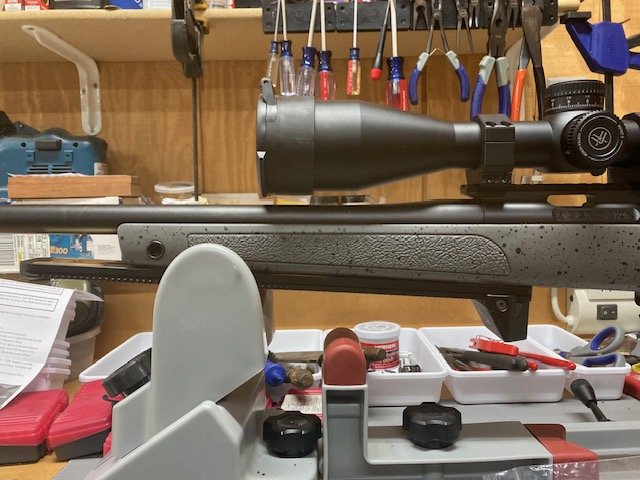

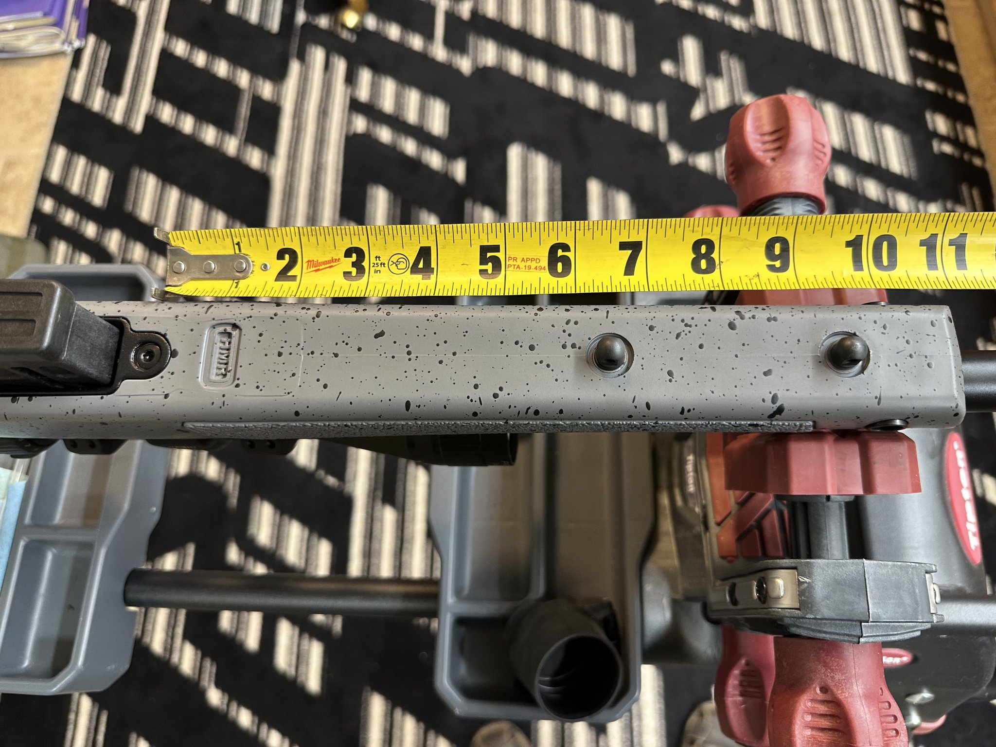

Well, I have some info. The action screw is 1/4x28 threads, and it needs to be 1 3/8" long to attach the weighted rail and not bottom out. Store had 1 1/4" and 1 1/2", and neither worked, so I ended up cutting down the one included with the rail. Polished the edges with a fine file, and it was good to go.
The factory studs are 3" apart, so I drilled new holes 3" apart, offset by 1.5" from the factory studs. Those lined up nicely with the rail slots.
Installed. It still does not balance at the barricade stop, but it's a lot better, and I have not yet received the ARCA bi-pod. That should help as well.

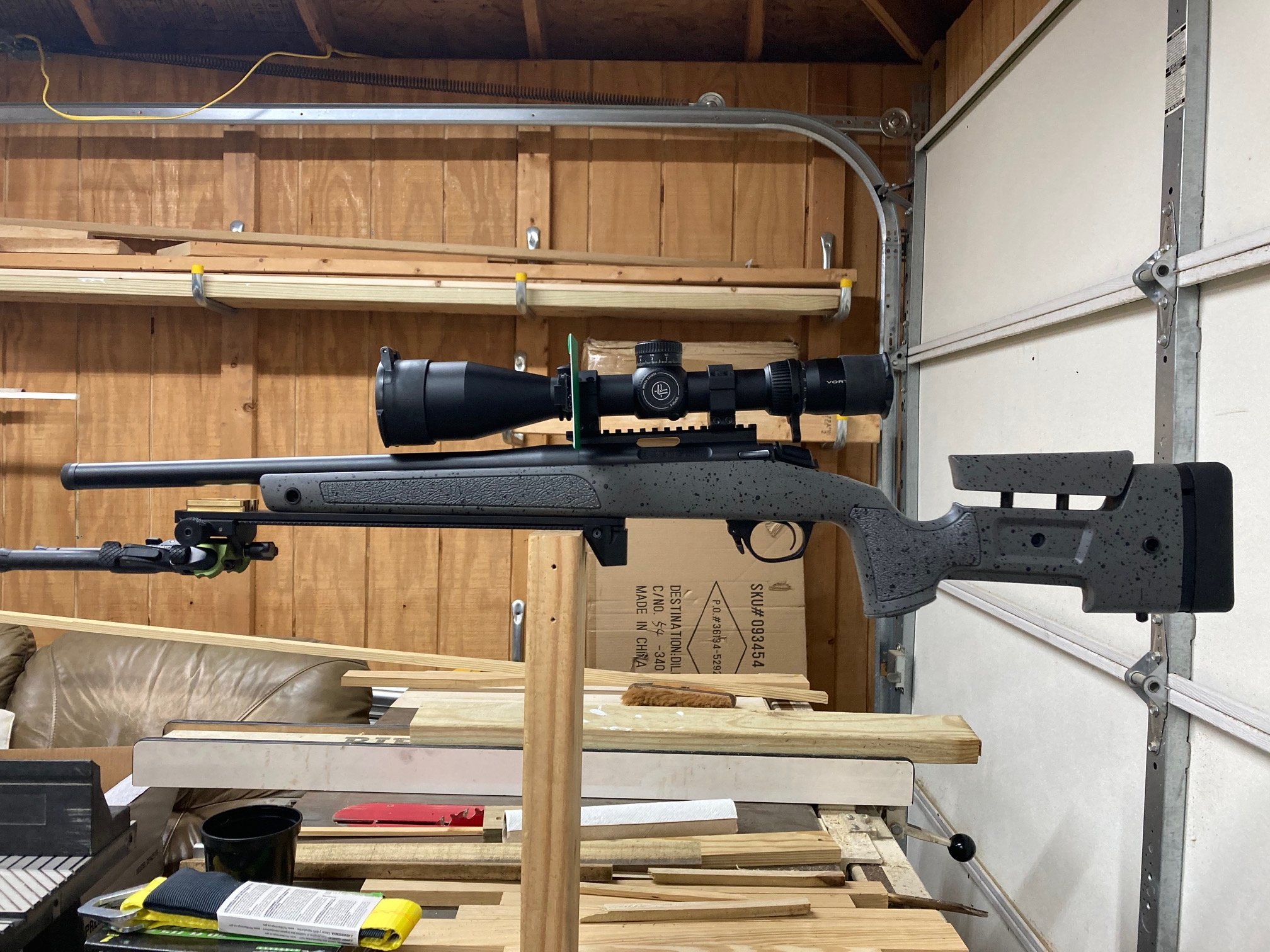

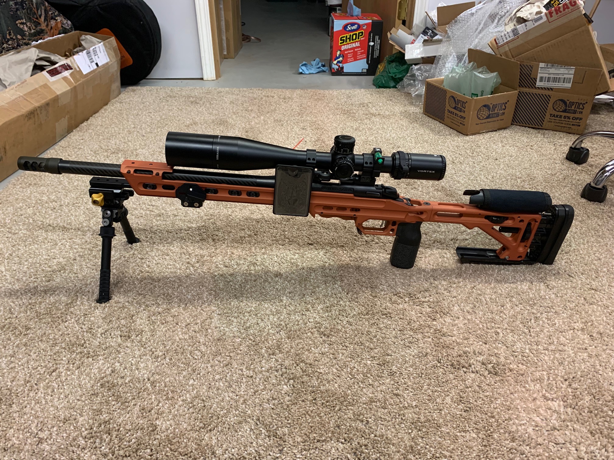

Shown here is my b14r carbon perfectly balanced next to to rimx and a custom vudoo!! Weighs 12.3 lbs!! Bergara gets the most range time because it is not fussy on ammo. It will shoot both cci sv and tach-22 sun moa up to 100 yards fairly consistent!! Very cheap trigger time!!
Nice, when my MDT bipod arrives, I'll post mine. Assuming it balances. If not, I'll post something about being a total loser who blew a lot of money on stuff that just didn't work right... Then just go shoot it anyway.

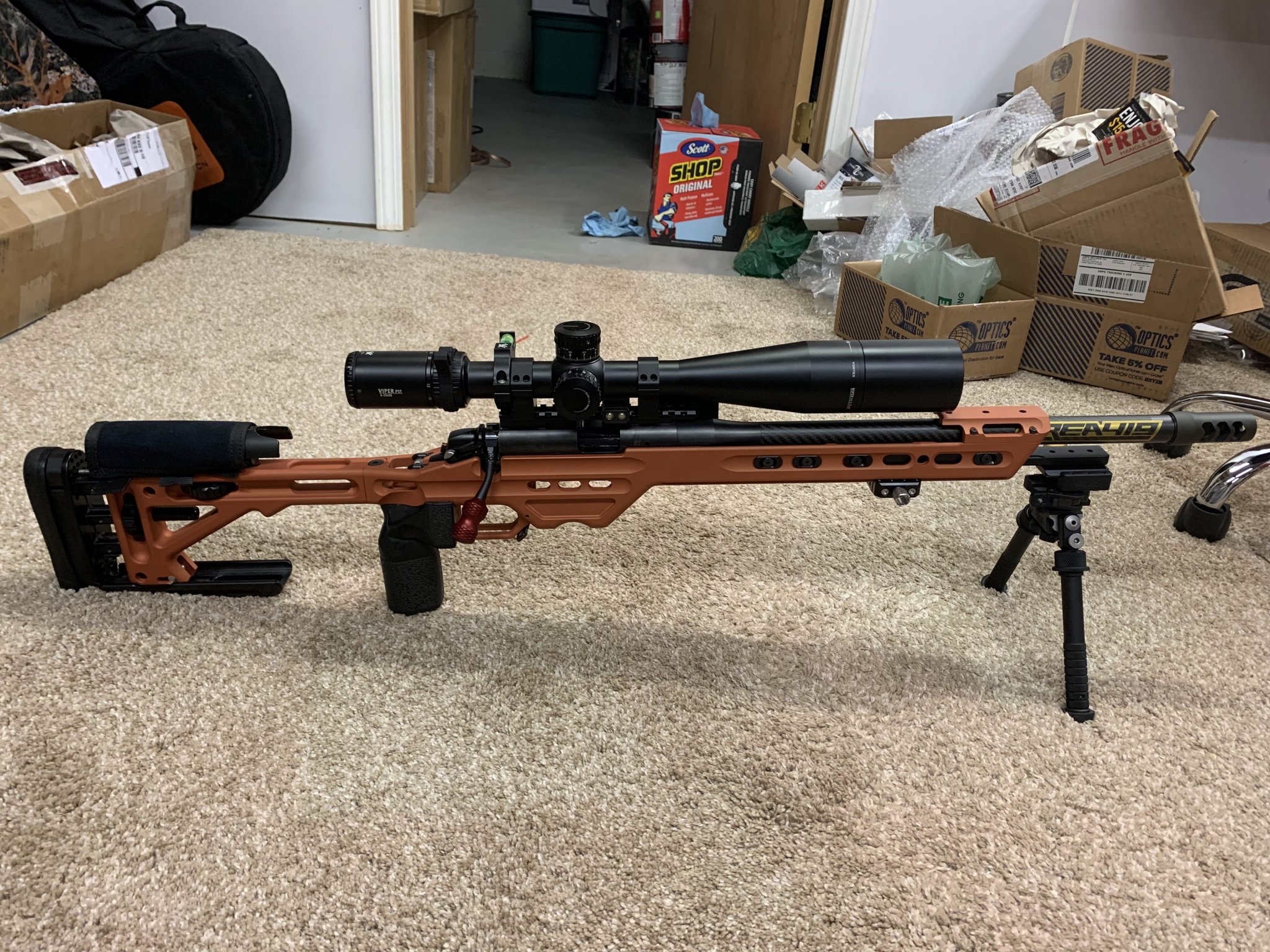

So what are your final specs on the build?
Bergara B14R, steel barrel
Vortex Venom 5x25x56
Vortex Precision Matched Rings, 1.10"
L3I 10 MRAD base
Area 419 weighted 14" rail, with weight closest to mag moved on top of one closest to muzzle
Area 419 barricade stop
MDT GRND Arca bipod
(not shown)
Anarchy Outdoors threaded bolt handle and knob
L3I Elite magazines
TriggerTech Diamond Flat (on order)
About 13.7 pounds total weight.
This was my attempt at an 'affordable' entry into PRS Rimfire. Easy to get carried away.

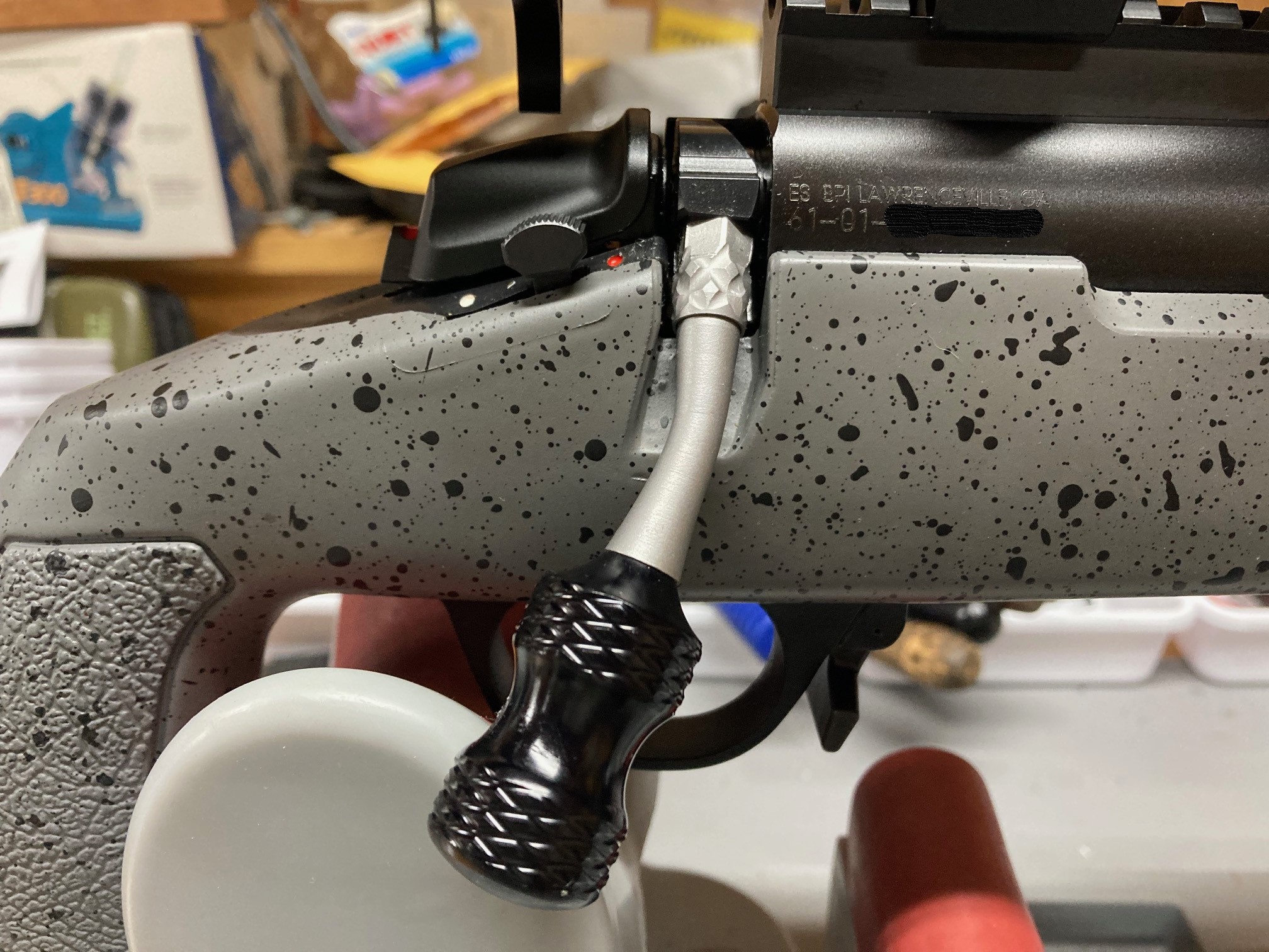

How difficult was it to change from OEM to the Anarchy Outdoors bolt handle and knob?
I called them to ask for hints, and the response was to watch the video where their guy just spins it right off the rifle... haha
It took a good 5-6 minutes of TLC with my Black and Decker heat gun on high right at the middle of the OEM handle. Then I crunched the OEM knob in a padded vice and spun the bolt itself. Knob came loose. Crunched the OEM handle in same vice, spun the bolt again, and the handle came loose. Between the heat and the vice, it is hard to get those off without leaving at least a few marks/spots. The bolt came through with no marks or other even minor damage at all.
Clean out the thread locker you just torched from the bolt, install, tighten, and go.
I bought the stainless instead of black handle, because as I feared, using a wrench to lock down that nut did slightly rub the edges of the nut. If it was the black handle, I would be afraid of stripping the black finish off the edges of the nut with the wrench.
I watched that video too and thought, yeah right. That was loosened beforehand.
Thanks for the tips. I figured there was thread locker used to install the bolt and you just confirmed it for me. I bought the black handle, so that will be fun! lol

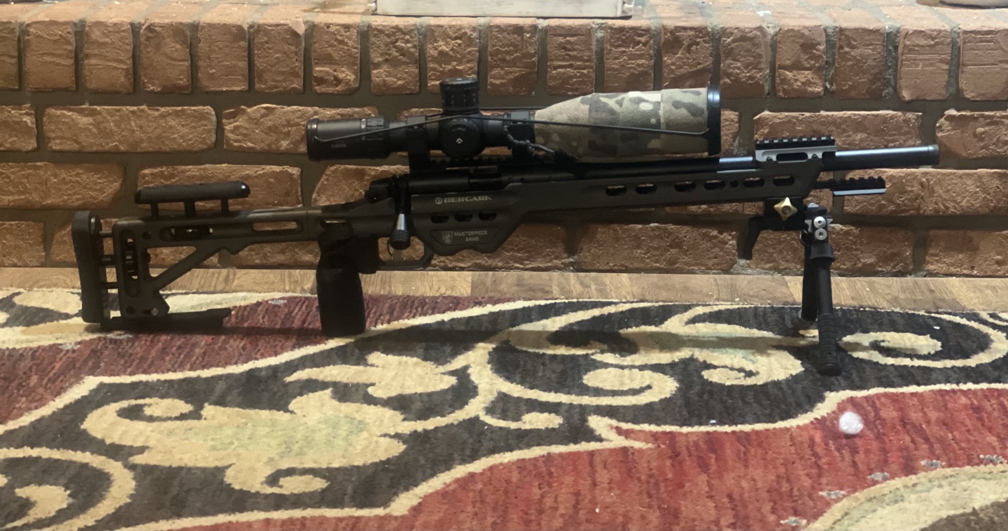

My B14r carbon in MPA chassis with weights
Vortex Viper 5x25x50 with 20MOA rail
Vortex scope bubble level
Anarchy Outdoors bolt lever and knob
A419 Hellfire Brake
Atlas Bipod
Precision Rifle ATR Thumb rest.
Bolt spring kit from Crossroads Precision.
Bix’n Andy tac sport trigger
1 converted mag with L3I extender.

Bought it as a complete rifle and really liked it. Dropped it in a new MPA chassis this weekend and it balances really well and the adjustability makes it fit me even better.

What acra rail is this? Is it a mlok rail to the bottom of the ridgeback? Did you drill any holes? Is it utilizing the front action screw like area 419s?
Where have all the aftermarket barrels gone? The Lilja is out of stock, and all the others I had bookmarked are no longer listed. Looking for a heavy match barrel, 20" or a bit more, with American muzzle threads.
Pretty sure I saw somewhere he said it is the sawtooth rail for it
