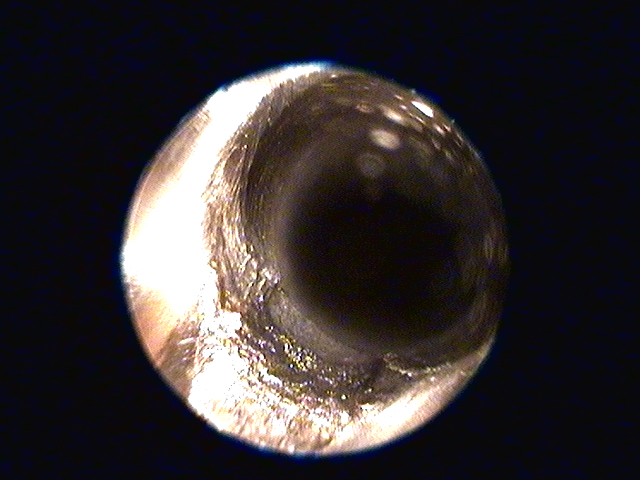

Not cleaning technique. I have bore pics of the gas port on barrel 2. Can't post them now but they are interesting. Wes you are a genius. ;)
Eta- gas port is damaged. Appears to be from a burr from drilling.

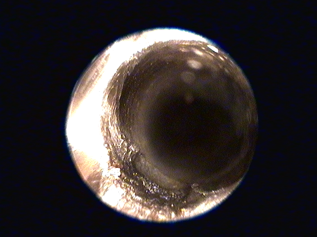

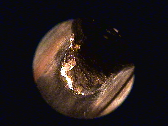

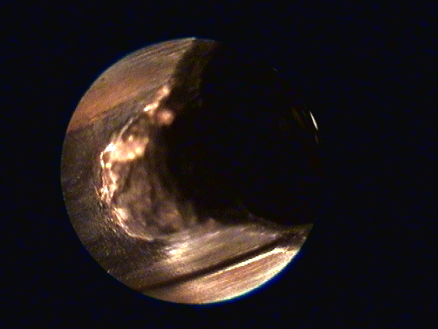

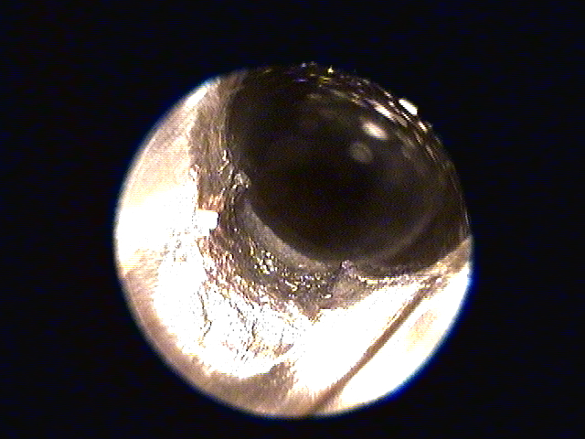

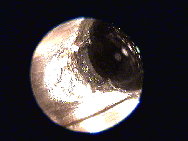

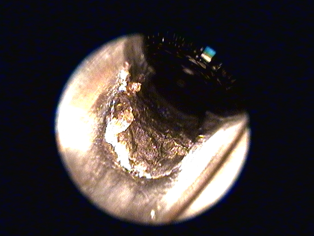

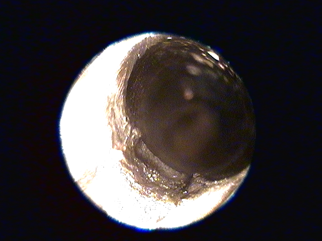

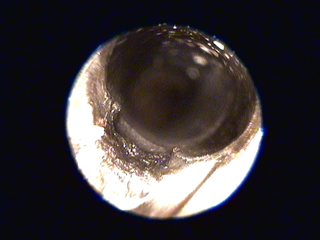

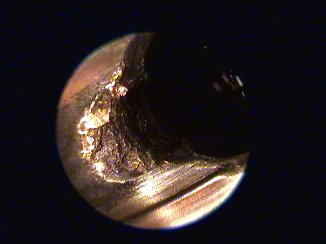

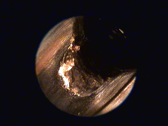

Pics
Here are some pics

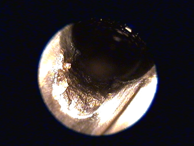

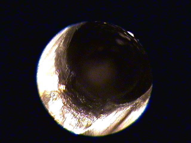

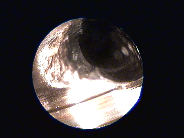

additional pics
More pics

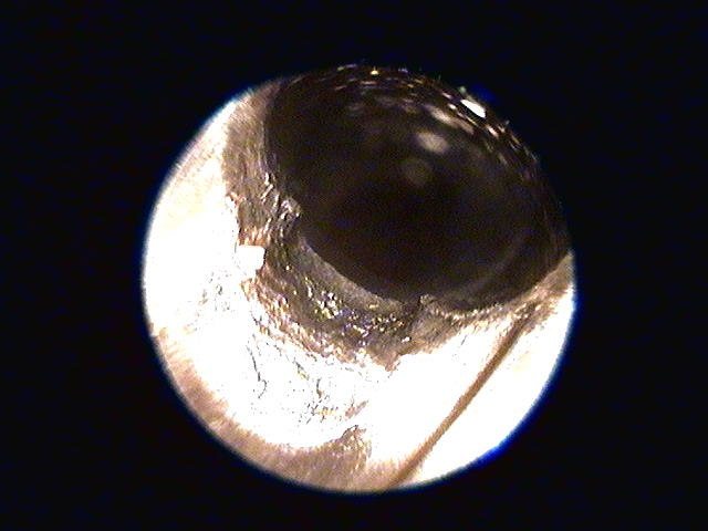

Last of the pics
Last of the pics
I ordered a Krieger 1 in 7.7 18" long from compass lake a month ago with the highest of hopes till I just read your post. got billed for it just this Monday and awaiting it's arrival. I sure hope this is not the norm. keep us up to date on your issue and I will inspect mine for any such problems. no disrespect to compass lake as im sure they will take care of the issue promptly.
kyle
Those gas port pics look like every AR15 barrel in which I've ever seen borescope pics of, you should see how nasty it looks at 10,000 rounds...
I don't know if a copper brush would be enough to remove a burr from the gas port being drilled.
I also don't think a burr, which would be hard to survive the first bullet, would all of a sudden cause the groups to open up.
Those pics are after 45 rounds. I also looked down a Daniel Defense CHF barrel today and it doesn't look like this. That barrel has had 400-450 rounds down it.
I too am skeptical of a bronze brush removing a burr.
Im curious how a hole is drilled for the gas port with out getting a burr? I wonder if pouring cerrosafe down the barrel to the area your going to drill would prevent it . Or maybe forcing a lead slug down to the right spot .
Ports should be drilled most of the way, but finished with a reamer then the barrel is finish lapped. This is the correct way to do it.
They come finish lapped from Krieger and shipped to Compass Lake. So I'm not sure how Compass Lake is doing the gas ports.
I'm still pretty new to this...but how would a gas port burr "knocking bullets out of whack" allow the barrel to hammer when brand new and go to shit the second time to the range?
Good point. But don't know what gas port looks like in the barrel that was shooting good the first few rounds. Those pics are of barrel #2s gas port that shot bad from the beginning.
Much appreciated sir!
The scary part is how many have barrels were sold and shipped like this? Remember we bought our barrels several weeks apart. I hope it was only a few for the customers sake.
That is normal gas port erosion in a stainless barrel, it is not a burr. A drill bit can not produce that kind of erosion in a barrel.
That is not what is causing the bad accuracy. I have a Krieger DCM barrel that I have had since 2007. It looks a lot worse than that and still shoots under 1/2" off the bench with 69gr SMks.
I spoke to Frank. It is a burr.
Also that is normal erosion for a gas port with 3000+ rounds through it not 45 (according to Krieger who has also seen the pictures) ;)
It may produce that kind of premature erosion if the steel is also bad. Bunny (Compass Lake for those of you who don't know who she is) assured us this afternoon with all things considered they would be replacing both barrels with NEW barrels and we should have then next week.
Stay tuned.
bustin I hope my Krieger shoots 1/2" too. :)
Stay tuned.
That's pretty weird because I think a burr is a raised piece of metal protruding from the surface due to a dull bit and too fast of feed rate not erosion deep into the metal. But hey if they want to replace your barrels good for them. If you can borescope your next barrel after 45 rounds just for the heck of it.
Look at the pictures close. It's both raised burr, and erosion. I have since borescoped several barrels. We just scoped another stainless 18" barrel with over 1000+ rounds that looked 20x better shape than this one at 45. So I doubt the next one will look that bad after a few rounds....as long as it's deburred etc. correctly. Like I said, erosion could be from bad steel. I don't know if this is the case here but it's a possibility.
yes I've seen it almost daily for the last 20 some odd years, I inspect 20-50 new barrels a day on average. Knowing Krieger I doubt it's bad steel, that is the one company that will not send out bad product. If those are DCM barrels which I believe they are because the port is between the lands. Krieger turns the barrel, and short chambers it. Krieger drills the gas port. All Frank does is chamber it and crown it. I just looked at a new one in the bin that has not been chambered, no burr around the gas port just a perfect hole. I have a .224 wildcat barrel on the shelf in the next room that has had 20 shots fired through it. It looks almost as bad as the photos you posted. I guess it doesn't matter since they are sending you a new barrel. Might be a good idea to bore scope it before you shoot it and then again after 50, that will answer your questions first hand. If you still have the barrel use the bore scope around the crown.
