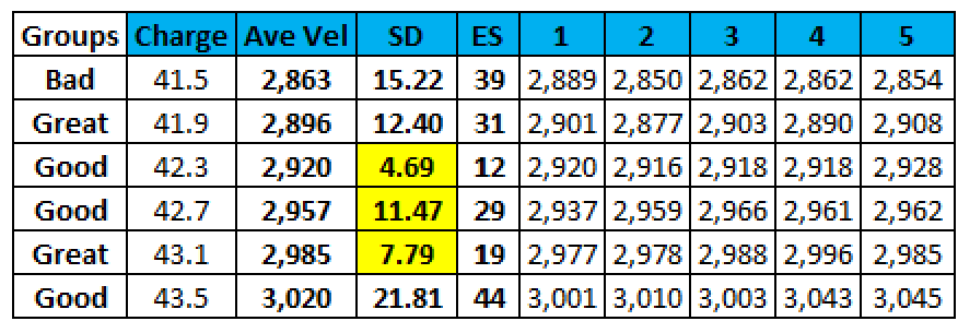

Bad SD and ES but good group...
For what it's worth I would pick 38.7gn or 39.0 (or a load in between) as a test with +/- 0.2 gn on either side in absence of any other information. 5 shot groups. See if the POI repeats. If it does then you can work on seating depth and see if the groups tighten up.
