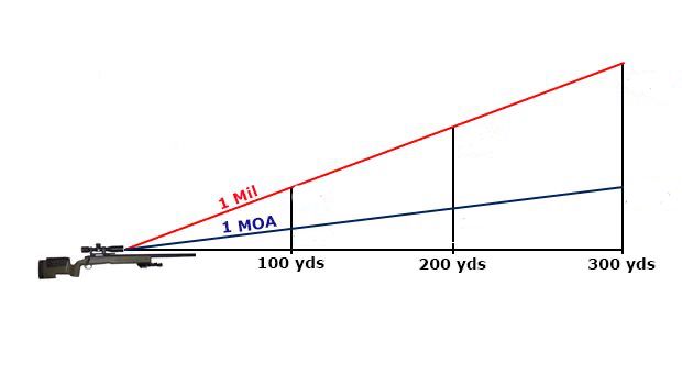

I have zero understanding of mils...
If you actually understand MOA you understand MILS.

Lol. I have zero understanding of mils...I blame my dad.
Exactly! They are both the same thing, just called out differently. If your turrets match your reticle, you are gtg. Don’t convert between them or to inches etc. and you won’t be confused…….
When using an MOA scope, think in MOA. When using a MIL, think in MIL. Scopes in MOA are generally 1/4 moa clicks. MILs (MRAD) are commonly 1/10 mil clicks.

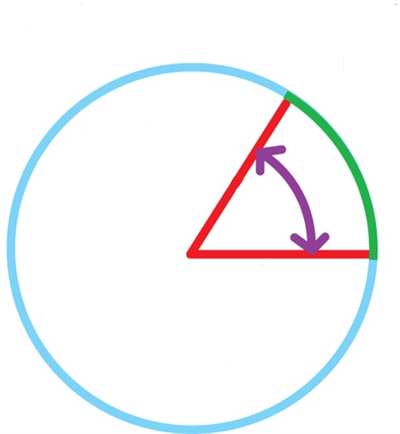

If you don't understand milliradians (what mils actually stands for) then you don't understand MOA either.
Instead of getting pissed at me, think about what I said from a fundamental trigonometry point of view.
Then seek more knowledge by reading which will lead to understanding.

It was self-deprecating comment on my part, not pissed at all. I do understand the trig involved with both MOA and MILs. What I probably should have said is that is that having learned to shoot using MOA, I don't have to stop to think or work out calculations to determine adjustments in MOA, e.g., if I see a round impact 4 inches low at 600 yards, I know I need to dial 2-3 clicks on a 1/4 MOA turret to bring POI up to where I want it. I haven't taken the time (I know I should) to get achieve that level of comfort in MILs.
You're doing it wrong. Converting between linear and angular units is what fudds teach. @Max already advised you to not do so. We do not care about linear measurements on target at all, regardless of which angular system we're using.
Tell me, honestly, how do you measure 4" (with any level of accuracy) from 600 yards away?

Just to reiterate. If you are thinking in “inches at the target,” you do not understand mils or moa, how to use your reticle, or the fundamentals of what the turrets are doing when you make an adjustment to your scope.
Before this becomes mil vs moa thread (we have not had one for a long time, so it is due) I suggest to always check zero every range visit. Until you accustom/grow to the rifle it will probably change with conditions like clothing, lightning, state of mind. And yet more. If your zero is up click or two, it means that your downrange hits also are. You can check the zero after shooting and see if it has returned once you are "warmed up". You want to learn not only your bullets flight but also how you perform.

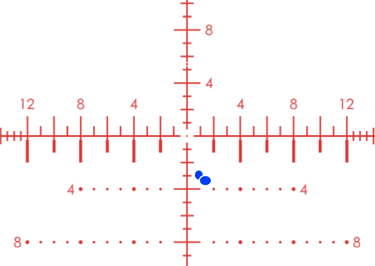

OP, look at the example below. Say the two blue dots are impacts. To correct, you would raise elevation 3 and move windage left 1. It does not matter what the range is!!!!!!! Up 3 and left 1. Whether it's 100 yards or 1000, you're moving up 3 and left 1. If the reticle subtensions are in an angular measurement called ghublats, it.does.not.matter. You adjust 3 ghublats up and 1 ghublat left. It doesn't matter if the range is 3.654 phlibbits or 8.1223 phlibbits, you adjust up 3 ghublats and left 1 ghublat.
Linear measurement has no place in making your correction!!!
