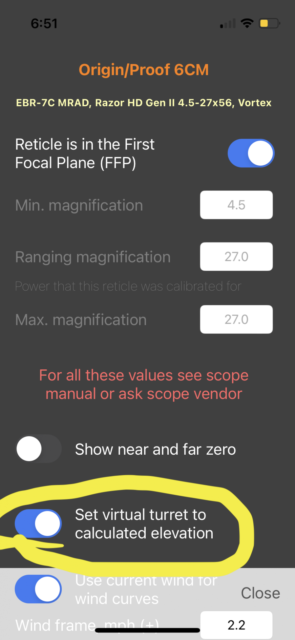

Full disclosure, I did get spoiled rotten fast on the library of reticles and ammo. And how the program trues the reticle and also gives you a reticle view of your target. And the library of targets, too.

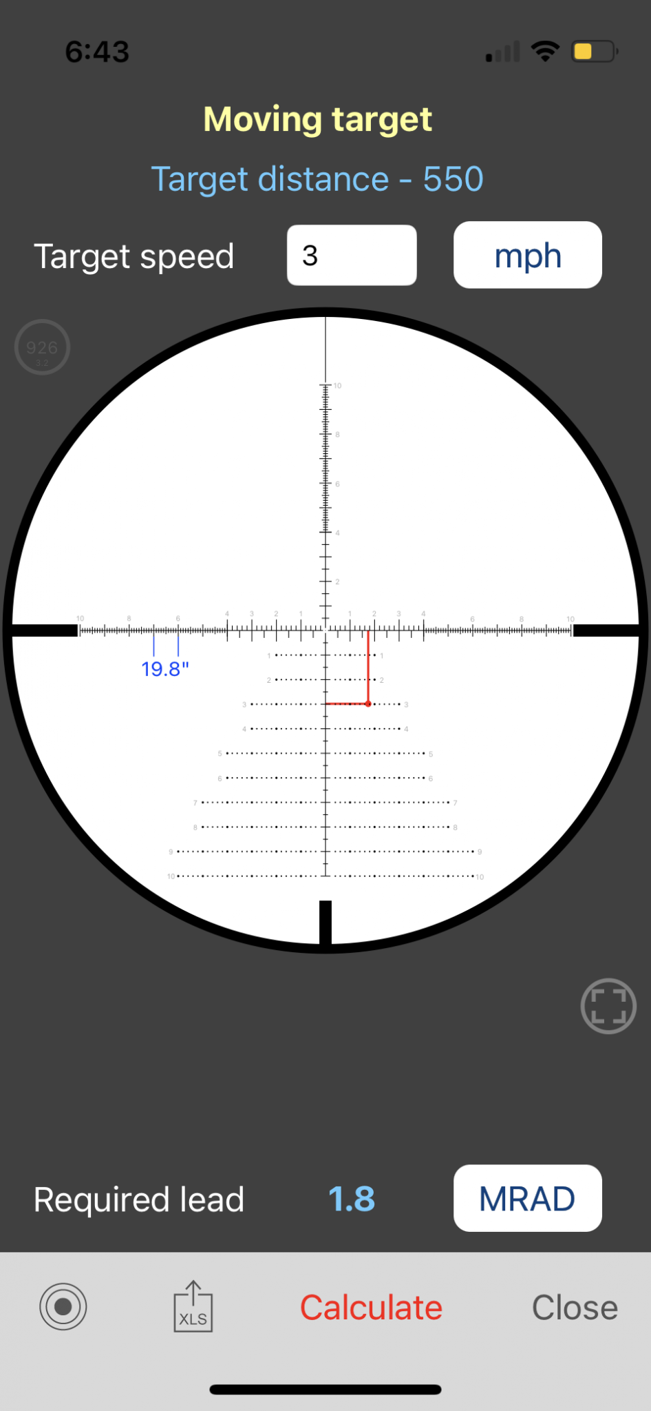

While the reticle view feature on the home page of Strelok Pro is pretty useless... the reticle view on the mover page is helpful IMO for visualizing one's lead. Though, weirdly, there's no "set virtual turret to calculated elevation" option like there is on the home page's reticle view settings pane.
...pretty cool:
...would be cooler with this:
I'd email Igor about fixing it, but I doubt he gives a shit about doing an update on an App that's banned in most places people can afford and are allowed to even have the rifles you need first... doh.
Also, the intergration of the weather with all the other stuff, without it being very complicated, is what's cool about Strelok... it lets you make a "custom range card" , easily, every time you update the weather/wind. Helpful, duh, since dope changes throughout the day/conditions.
IMO, Strelok Pro + WeatherFlow weathermeter = "SuperKestrel" ...but designed so a dumb child can do it. I literally tell it which way I think the wind is coming from, point the WeatherFlow into the wind, press save to capture the weather and go back to the home screen, press "calculate" on the home page to update the dope, and voila... first-round hits 90+% of the time.
Plus, you can shoot matches like The Mandalorian (shot a 1-day like this a couple of weeks back, kicked ass, never touched a pen/marker and had clearer, more detailed info). I entered 10 stages 3-6 targets each in like 5mins well before the match even started, never had to worry about it again (just updated weather throughout the day):
