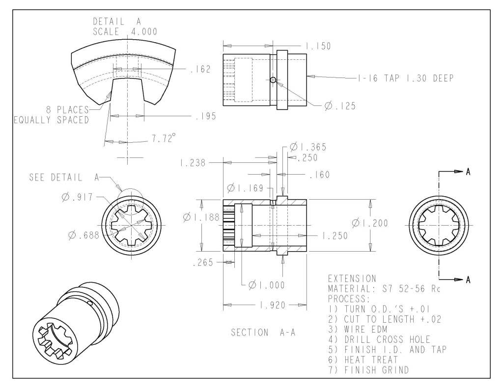

I have a KAC SR25 upper that needs to have a barrel installed. The barrel I got is from Rainier Arms, a 16" Ultra Match. The barrel is about 1-2 thousands of an inch bigger than the opening in the receiver.
The question I have is would it be okay to freeze the barrel and heat the receiver with a heat gun to make the installation possible without machining the parts to make the dimensions match? Would this small difference in dimension distort the upper receiver?
Talk to Rainier. I know voodoo had a few barrels with the same problem. What happens is the alignment peg gets mushroomed out a bit when pressing it in and then it won't slide in the extension.
I found these specs online, I don't know if the source is legit though. My extension measures a 1.186-1.1865 in diameter, where as the print shows 1.188. I will try to give Rainier a call today.

I got the barrel in this morning. Just a little heat from an electric heat gun, and it dropped right in.
