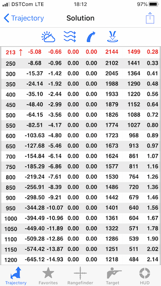

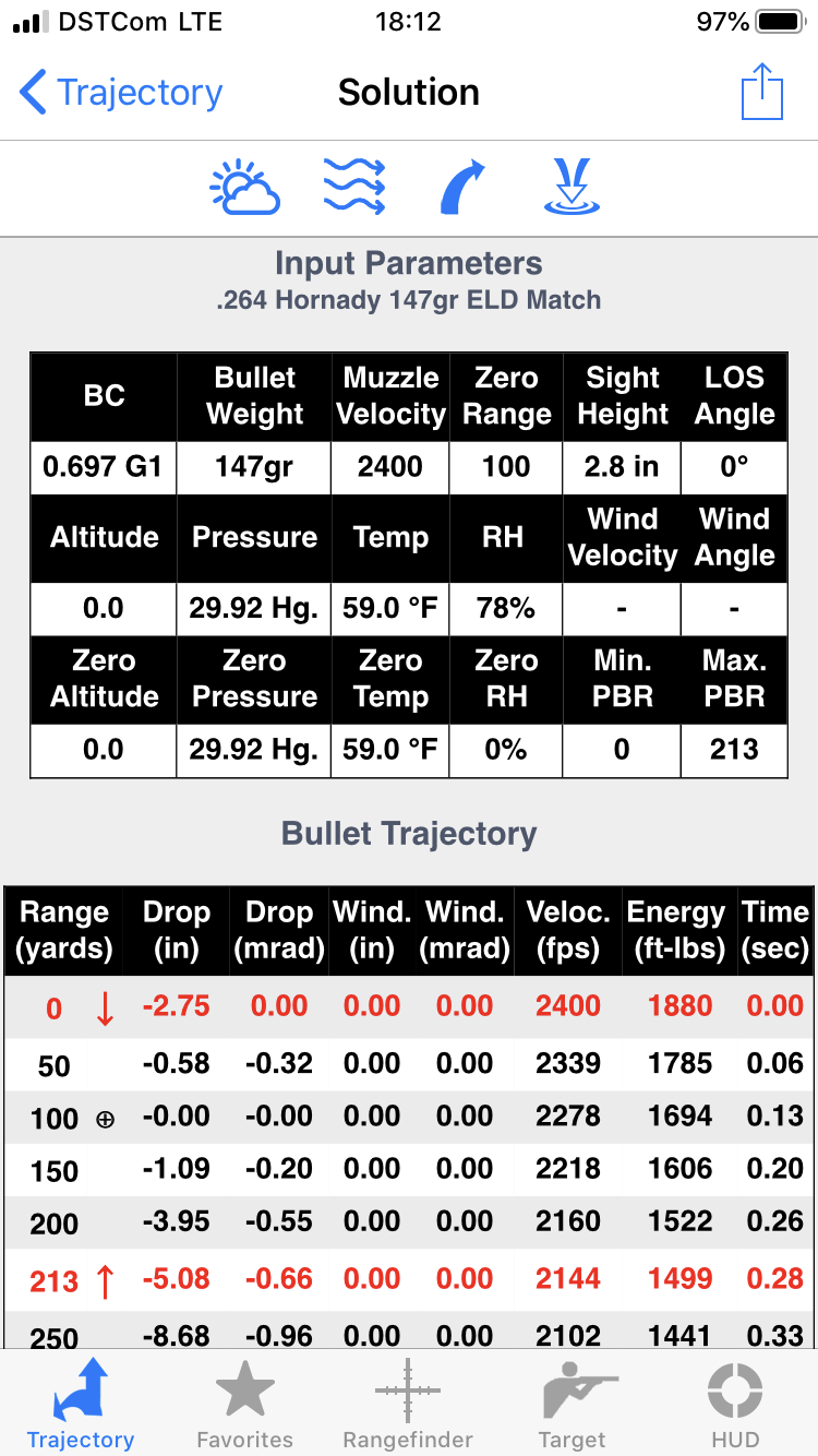

16" is probably the shortest that would work. With a 2400 fps muzzle velocity using the Hornady 147 Match, I get 1218fps at 1200 yards using the Ballistic AE app. Based on looking at others velocity numbers around the interweb, 2400fps at the muzzle with a 147 grain bullet should be a fairly accurate velocity estimation and maybe even a bit conservative.
