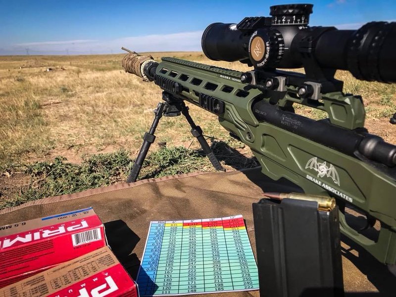

    With factory Prime Ammo I am getting 2800fps 21766829_10155732926197953_7956311413377619047_n.jpg?oh=98d8e3e30c195e555d377c20b3344167&oe=5A...jpg

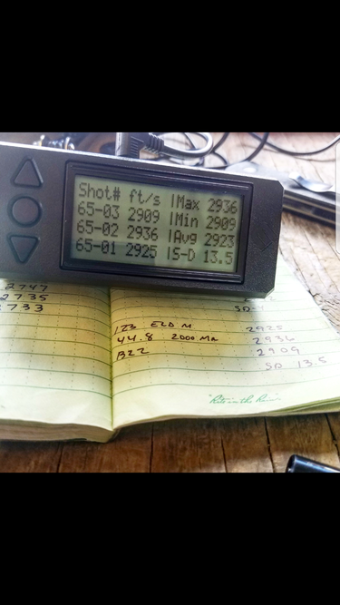

    Im running a 2012 AX with a used barrel i bought here , 16.5 Benchmade chambered by TS Customs . I wasn't expecting miracle ballistics but im more than happy. 123 eldm 2000mr powder and Br2 primers in the 2900s Suppressed. Hornday brass isnt lasting but three firings due to the load but there are no ejector marks no swipes no primer seapage no sticky bolt... load at your own risk. 1100 yards im dialing 9 mils of elevation at sea level and its plenty consistent. I will likely stay at 16.5" when i burn up this barrel. Dont be scared to go with a short barrel 6.5 creed its better than a 20" 308 in my opinion. Screenshot_20171107-144016.pngScreenshot_20171107-144558.png

    Ive been using Alliant Power Pro 2000mr in short barreled 308s , 260 rem and now 6.5 CM and its good stuff . Heres my same load that i shoot (123 eldm 2000mr Br2 ) Screenshot_20171107-145737.png but this was out of an AW 20" 6.5 cm chambered by GAP reaching 3k fps no pressure signs . Load at your own risk **

    2000mr is like Reloader 17 but its a fine ball powder instead of extruded. In my old 21" 260 rem Bartlein barrel i had the 142 smk flying 2860s suppressed no pressures with 2000mr in lapua brass .

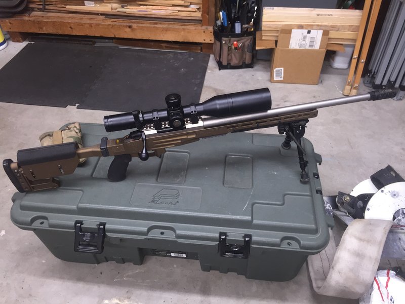

    In my opinion, giving up 100 fps by going 20" is not an issue. I just picked up a Tikka TSR-1 in .260 Rem with a 20" barrel and it is a shooter. Since I can load my 26" barreled .260 to 2850 fps without issue using 136 g Scenars, The 2750 that I can get with the 20" barrel will do just fine. Consistency is much more important to me than sheer speed. Plus, like you, I appreciate that the 20" barrel provides a bit shorter platform for my 9" can.
    Oh yeah, it looks great too!
    You mean it looks like This? Getting 2738 with a 143 ELDX:). I've had zero issues getting hits to 1300.
    Sent from my SAMSUNG-SM-G890A using Tapatalk
    lash
    Swamp Rat
    Sep 28, 2012
    8,092
    11,650
    63
    Central Florida
    You mean it looks like This? Getting 2738 with a 143 ELDX:). I've had zero issues getting hits to 1300. [IMG2=JSON]{"data-align":"none","data-size":"full","src":"https:\/\/uploads.tapatalk-cdn.com\/20171120\/15fa0f24ff33eb0432a646943c7b6a20.jpg"}[/IMG2]
    Sorta, kinda, but with just a couple differences I made.

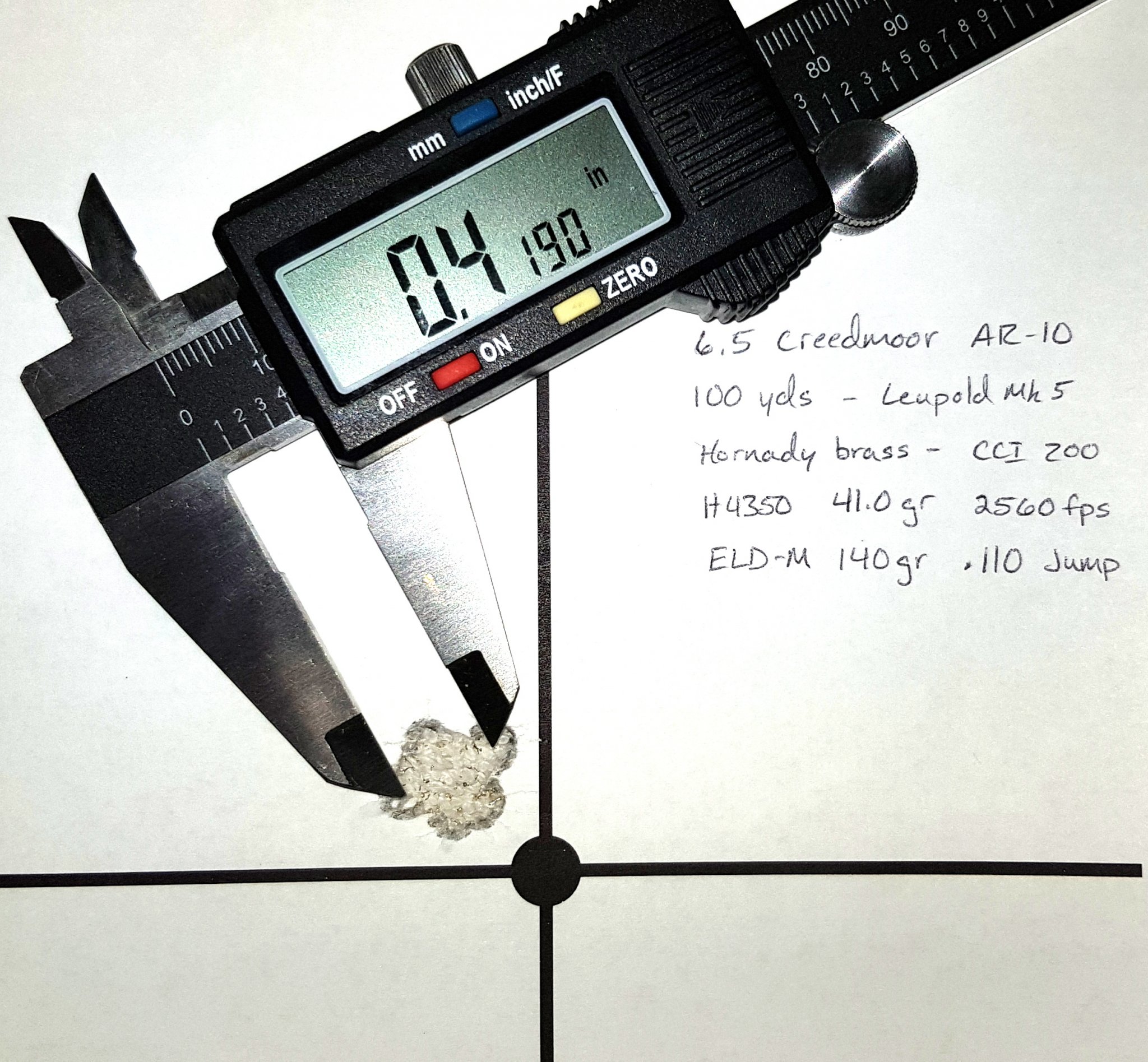

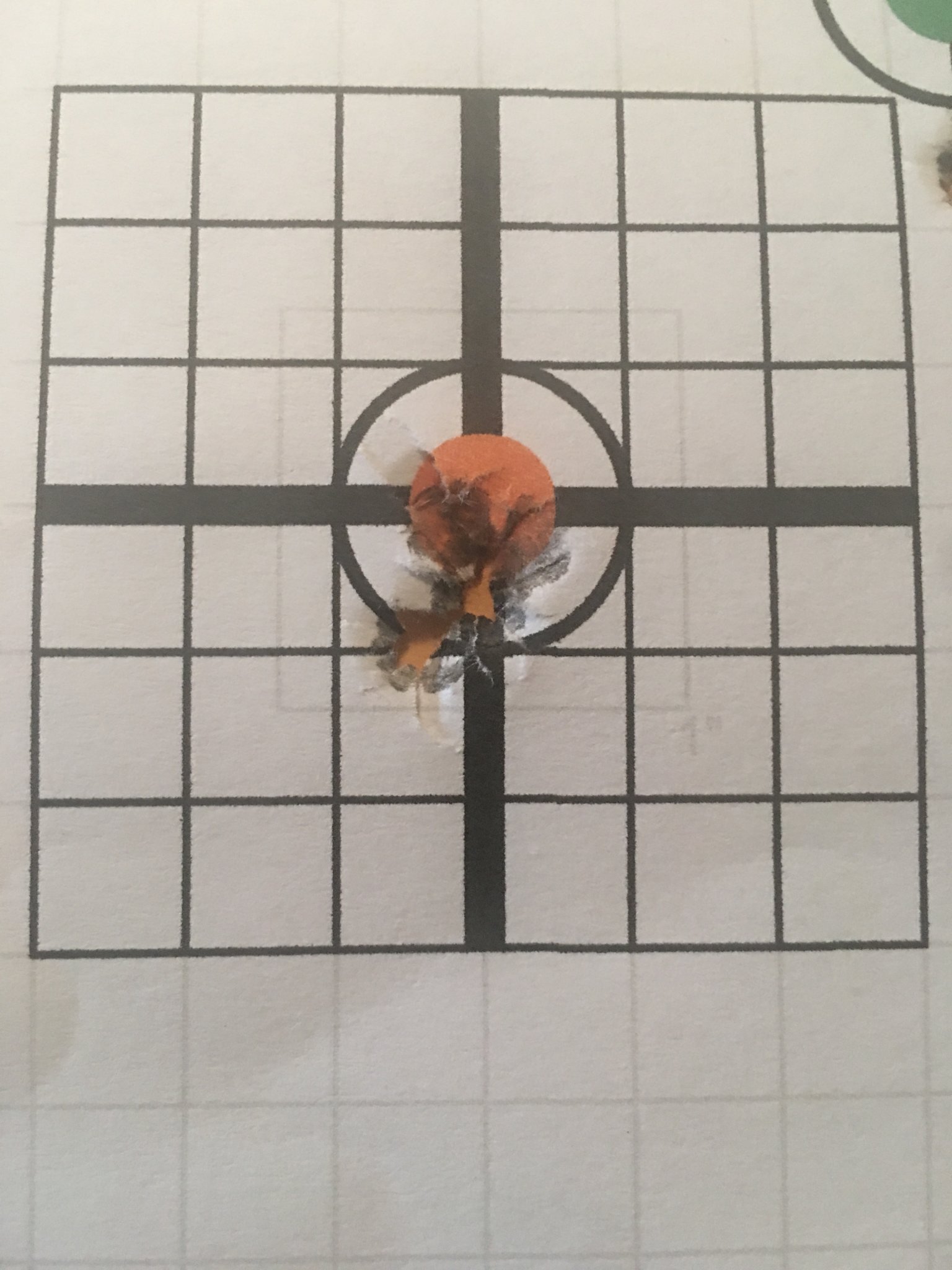

    I know this thread is a bit old, but I found it useful so I'll add my 2 bits. I was concerned that my velocities were too low, but after seeing these posts I think I'm right where I need to be given the short barrel.
    I have a 6.5 CM in an AR-10 platform, 18" barrel, shooting with Omega can.
    Loading Hornady brass, H4350, ELD-Match 140gr, CCI 200 primers.
    My charge weights and velocities on a recent trip to the range were as follows:
    40.0 2510
    40.2 2496
    40.4 2510
    40.6 2554
    40.8 2554
    41.0 2554
    41.2 2574
    41.4 2564
    41.6 2594
    41.8 2599
    42.0 2614
    42.2 2609
    42.4 2666
    42.6 2650
    42.8 2704
    Found good nodes around 2554fps and 2600fps. Feeding from mag so can't seat to lands, however tweaking the seating depth led to a nice group at 2554fps. Going to try 2600fps and see if it yields equally good results.
    Hope that's helpful to someone!
