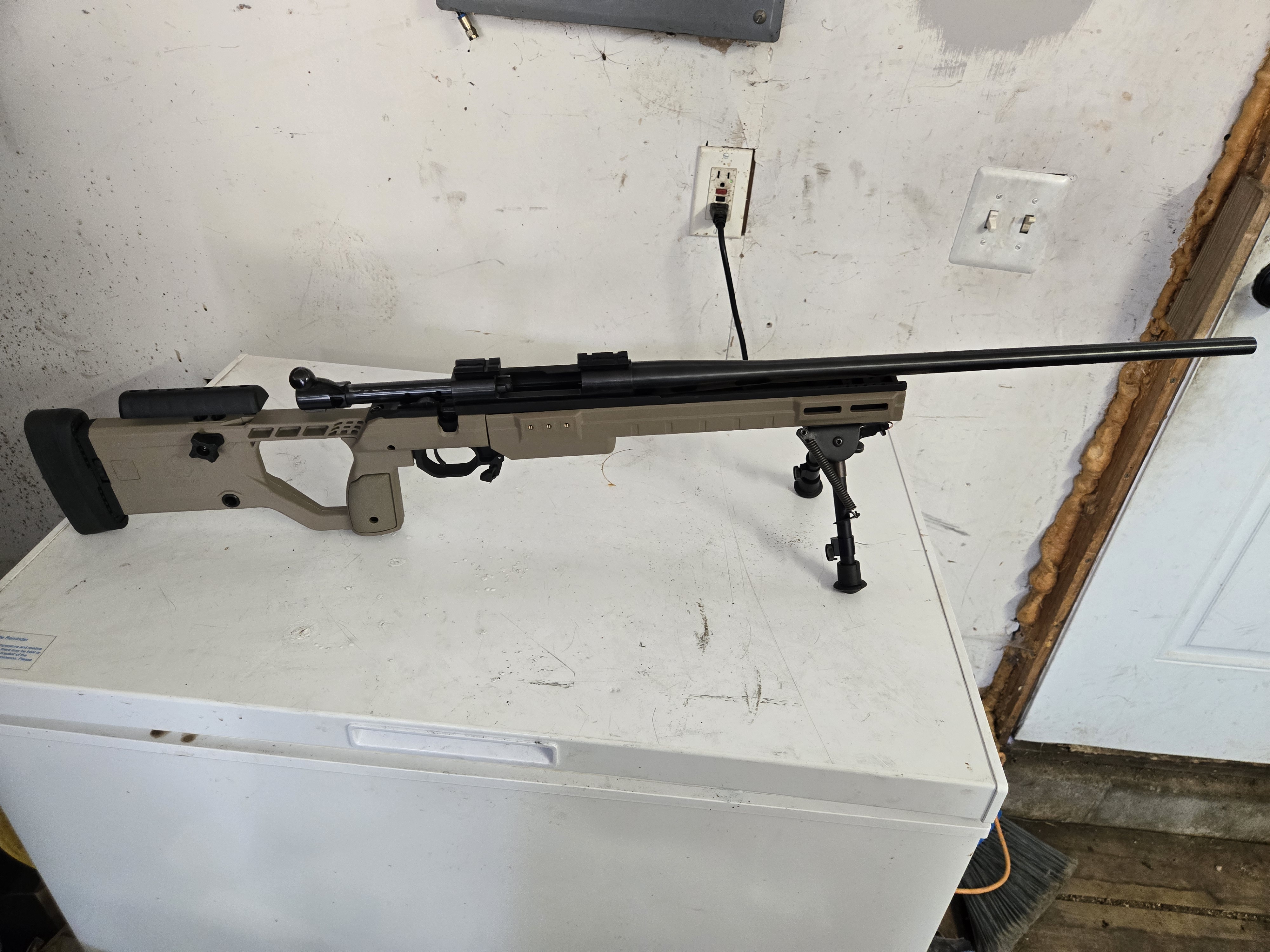

Im building a 8t 223 off a howa 1500 rhats currently a 204ruger and I have it in a krg xray. I have a m24 blank on order from pva and im torn on if I should do a 20" or 26" or something in between.
I plan on shooting the 73-80gr bullets with varget for local prs out to 750. Range work out to 600. I have a suppressor thats about 6" and idk if I'll run it at matches or just off bench.
I might coyote hunt with it too and I don't have to walk far so the weight isn't an issue.
My plan is to have my bergara hmr rebarreled into a 22gt or 6gt next year and thrown into a chassis for a more dedicated rig. (308 currently).
Whats the hide think i should go with?

Im more worried about balance in that xray. If it was a bravo I could add the rear weights. I guess I have 2 options. Run 26" and swap out xray buttstock for a bravo and run weights. Or try 26" and get it cut down to 20" if needed.
But id rather just choose now and be done

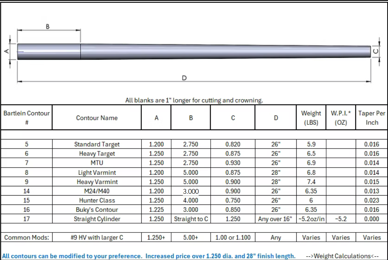

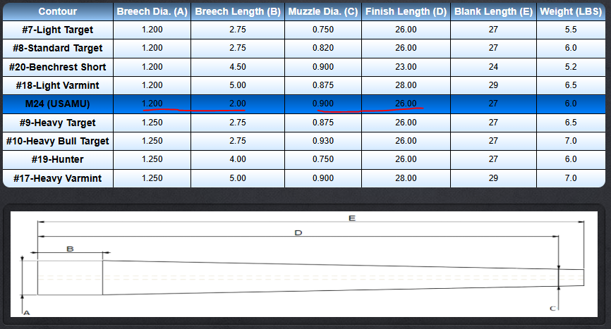

Yea i hear ya. Like stated b4. I have a hmr 308 that I wanna rebarrel next year anyway to a gt of some flavor for a dedicated prs rig. Id still run it now just 20" 308 is probably slow and recoils more than the 223. I shoot more at range than I do coyote hunt. I think I'll go 24-26" and see how it does. I can always bring it back to my smith and have him cut it down. Anyone know what a m24 diameter is at 20" and 24"?
