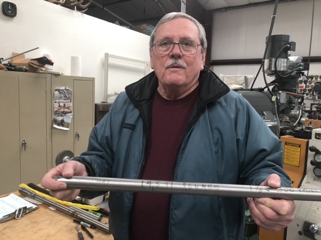

Once you witness Schneider’s 5P rifling process on a barrel it will leave you smiling. Pic is the returned Marine Corps 308 barrel they tried to shoot out.. still made the accuracy cut at 300 meters.
Bet it has another 2500 Rds of life left?
