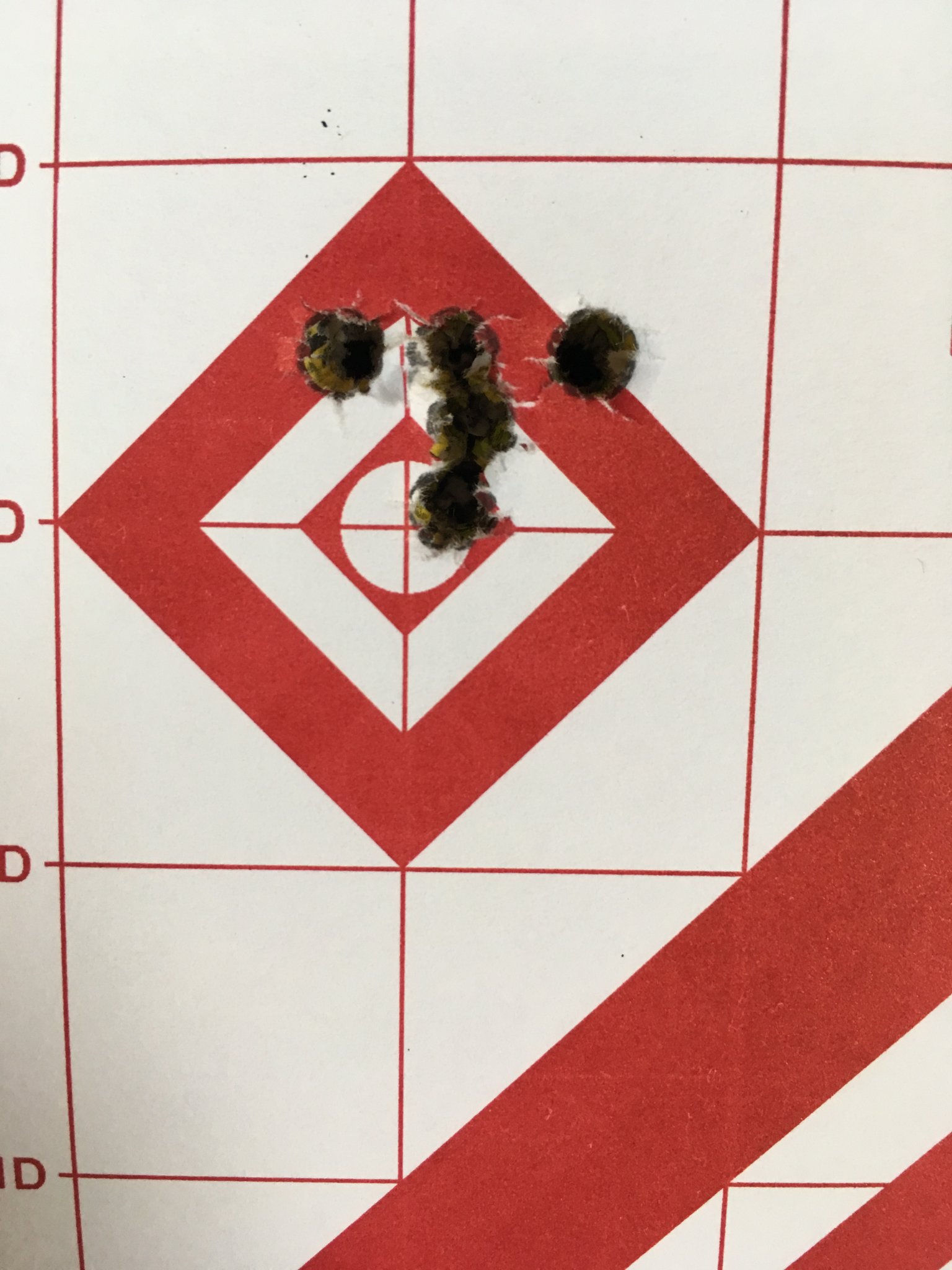

Here is 20-30 shot string in 5-10 minutes. I ran my scope from 200-1000 back to 100 to check zero with a HOT barrel. Not bad for an off the shelf Ruger RPR with a can. 5 shots.
Reactions: billt

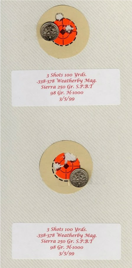

This picture is rather ancient, (1999). But it shows 6 shots out of my .338-378 shot in under 5 minutes. Not much spread as it heated up. The lower group was shot last. Not too bad considering 588 grains of powder was consumed.
I couldn't keep my hand on the barrel for very long immediately afterward. And in today's world, H-1000 isn't all that slow.

I was referring to the groups at 100 and 200 yards , not shot counts. I was responding to all the pictures of group sizes and I’m not sure what those can teach us about muzzle velocity if they are taken at such short distances.
