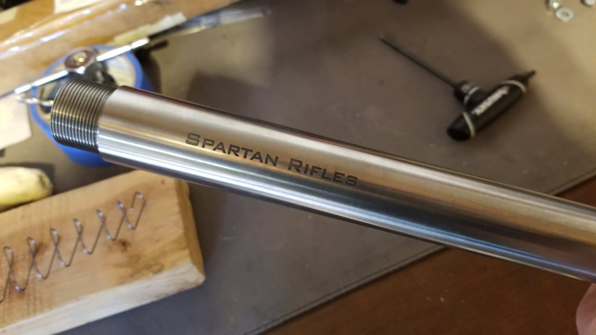

We’ve been stocking up on Bartlein barrel blanks in 6MM, 7.5 twist and 6.5MM in 8 twist. All #14 M/24 contour. We can do pre fits or hand fit to your supplied action in 7-10 business days. Additional finishing services are available but could add a couple more weeks depending on what you need. Email [email protected] or call 408-451-9850.
All of the common receivers coming out that are consistent enough to do it. Impact, Defiance Ruckus and Tenacity, Bighorn etc. They're all getting on board with this now. If I haven't cut one for the particular receiver you have then I'd need to have it here the first time. I'll save it's dimensions and top center location for logo etching/timing so I won't need it again in the future. I've been saving that information for all of my customers for awhile now so I can ship them pre fit barrels that fit perfectly no matter what action they have.
