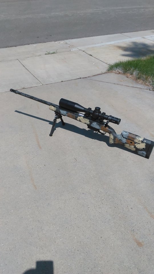

5 yrs ago I made one of my bold claims that I would never pay for a CF barrel, this summer I ended up spinning one on. It was a build for a kid, the rifle ended up at 11.7lbs, not sure on weight savings or where that got away from us. I can say, that overall I am impressed with it, accuracy is there, and for our application it flat works. It will never be what us here would consider a Heavy use gun, and I expect 2, maybe 3yrs life span from the barrel at the rate it will be fired, that could change.
Would I use one for myself, a barrel usually lasts me under a yr, and I rebarrel 3-4 rifles a yr, so I am going to say no, mostly from a cost standpoint.
But damn, does that rifle look good.

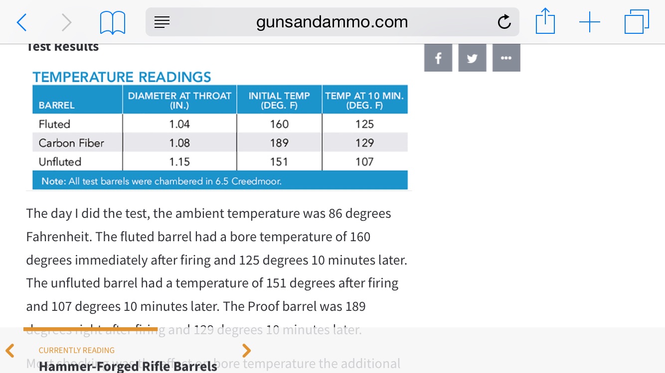

Not that Guns and Ammo is the ultimate resource for some scientific testing, but they just did a little comparison on a standard, fluted and CF wrapped barrel - 20 rds, check temp, wait 10 mins, check temp. Probably worth the 2 mins it takes to read. Searched Google for KRG SOTIC, pulled up the GA “review”, and it was the second/follow-on article. Titled Hammer Forged Barrels or some such.
Spoiler: standard steel wins, fluted is in 2nd and CF is 3rd. Caveat: the CF cools quickly (most quickly, in fact), but that’s moot since it starts significantly hotter.
Really depends on how you want to use your barrel. LIMFAC is going to be movement of heat from barrel to atmosphere once the barrel “saturates” if you’re doing high volume shooting. Initial heating will be largely dependent on mass and the specific heat capacity of the material...and, in the case of CF, the thermal conductivity throughout multiple layers. Academically interesting? Absolutely. Useful? Maybe. However, I get the sense most match shooters don’t run their guns that way ;-).
