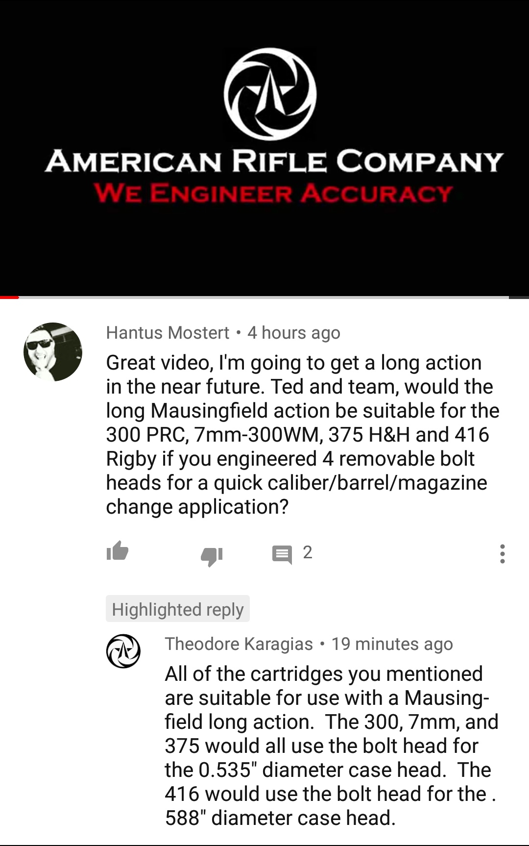

$1600 is very expensive but I'm going to try the Mausingfield in the near future.
