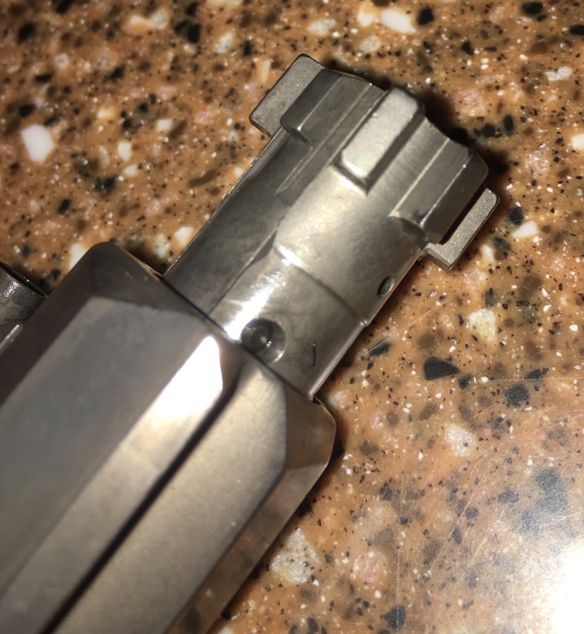

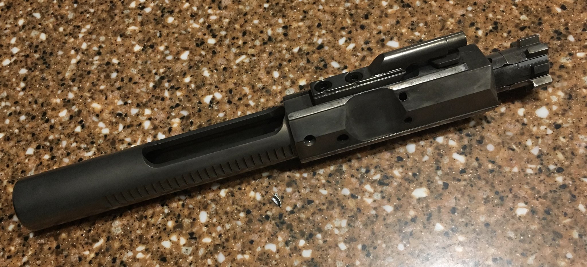

the carrier is in surprisingly great shape, the bolt lugs on the other hand look a little beat up. I’ll try and upload photos, but some of the corners have lost their edges.

After scouring the interweb and potentially hitting the end of the internet, I ended up just ordering a JP Enterprises LMOS BCG with the high pressure bolt. I really didn't want to spend that much at all, but it seems to be the undisputed go to BCG for large frame ARs that are serious precision setups.

Be sure to check that bolt with your barrel to see where you are on headspace.
I make dummies from brass sized & measured at (from zero on a headspace gauge) to -.001, +.002, .003 & .004".
I really prefer it to fall at about +.002-.003 inches.
