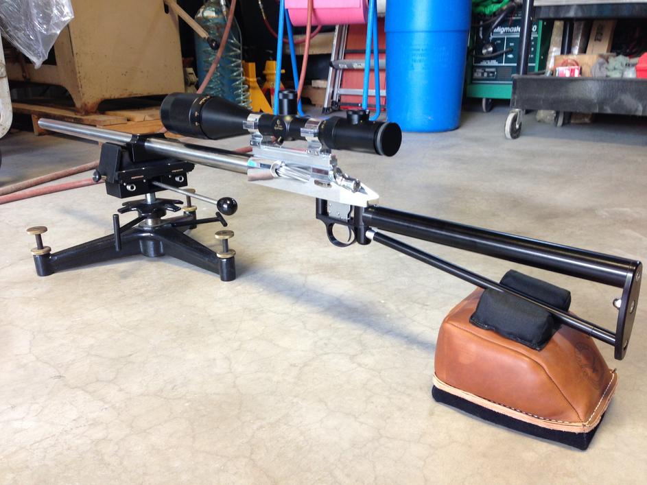

A completely different take on bedding and recoil management.
Aeon1,
Exceptional job!
I was actually thinking for some time now of buliding "stockless" custom MN rifle, exactly the same concept as yours - massive receiver (for everything functionally important) and simple metal stock attached straight to the rear. No stock - no bedding problem. Theoretically, should be extremely accurate and consistent setup.
Here is another proven confirmation of the same concept from 1941:
Picture of the Degtyarev PTRD 1941 (PTRD-41) - Military Guns
PTRD-41 was viewed as pretty accurate rifle by itself, according to various sources.
I can't take credit for the design. After seeing a couple of similar ideas being used I was mulling over how to fabricate my own version when this one came out. At the time I was putting together a 1000yd BR gun and decided to try it. It was manufactured by Gene Beggs in Odessa TX. Gene is a short range benchrest shooter who also owns his own test tunnel. I don't know if he still manufacturers them or still uses them himself. Gene also makes his own version of a barrel tuner that he used with this stock. People were skeptical that they would work with forend/bag rider mounted to the barrel. It tunes and shoots just like a normally stocked rifle. I have a traditional laminated wood BR stock for it for comparison but I have never taken the time to finish it so I can swap and compare.
An early version of this concept that got me thinking and Gene to acting on it: Davidson?s Amazing ?Tinker-Toy? 30BR within AccurateShooter.com
A writeup on Gene's stock: Beggs? Radical Skeleton Stock within AccurateShooter.com
I have not tried it at the muzzle. I have thought of trying it and also thought of moving it fore and aft to see if it liked a particular position better than another but with a tapered barrel it's not an easy thing to do. At one time I talked to Gene about this and he found it didn't care too much where the block was mounted. He's used them on different profile barrels and just slides the block up to where it fits that particular profile and goes with it with the fine tuning done with the tuner. I do have some of Gene's tuners but have not used one on this rifle. I'm guessing you've found that rifles with conventional stocks sometimes respond better with different rest placement in relation to the forend.
BTW I spoke with Gene a bit ago this morning, he still uses the stock and still has a supply of them although he's hesitant to sell them to just anybody. He said he prefers to sell them to someone that does their own machine work in case there are any fitment problems. It was originally designed for a Stiller Viper and I had to shim mine slightly for a Panda.
It's interesting, that's for sure. I'm impressed that someone actually built something so weird (and that has a lot of thought in it). I've often wondered about something similar. I'd like to see what happened if the stock was moved up inline with the bore so that the entire rifle was shaped like a crutch. Possibly with a counterweight on the bottom to balance the scope. With a perfectly symmetrical rifle, I bet you would have something that was very insensitive to loads.
Not exactly what you are proposing but close in concept: Joel Pendergraft Sets New IBS 1000-Yard Heavy Gun World Record « Daily Bulletin
There are bunch of short range BR rail guns built with that concept too.
To add: Gene's stock was made to conform to IBS and NBRSA short range BR stock dimension rules although I believe NBRSA recently has eliminated the stock rules for the Sporter class. No such rules apply as far as I'm aware for long range BR.
