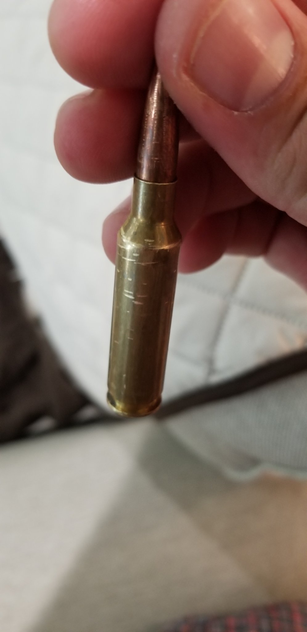

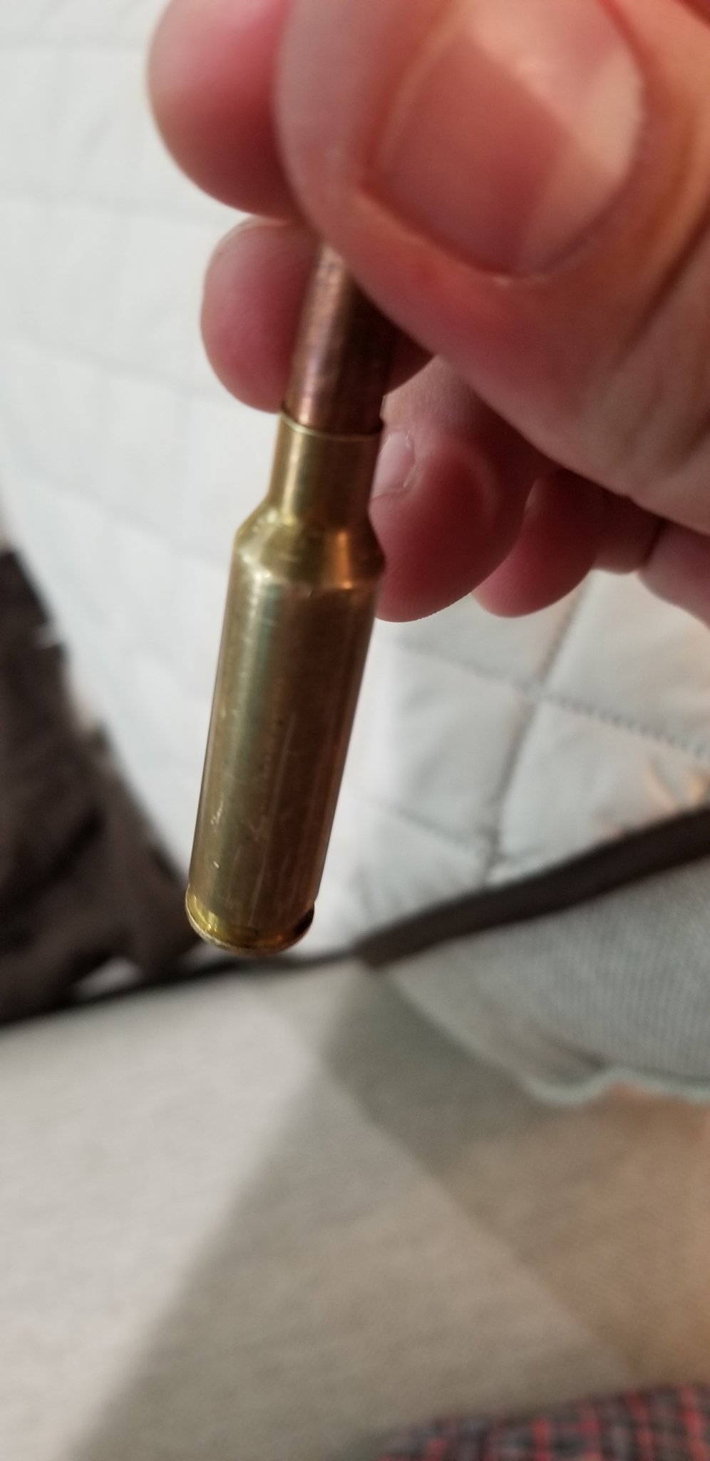

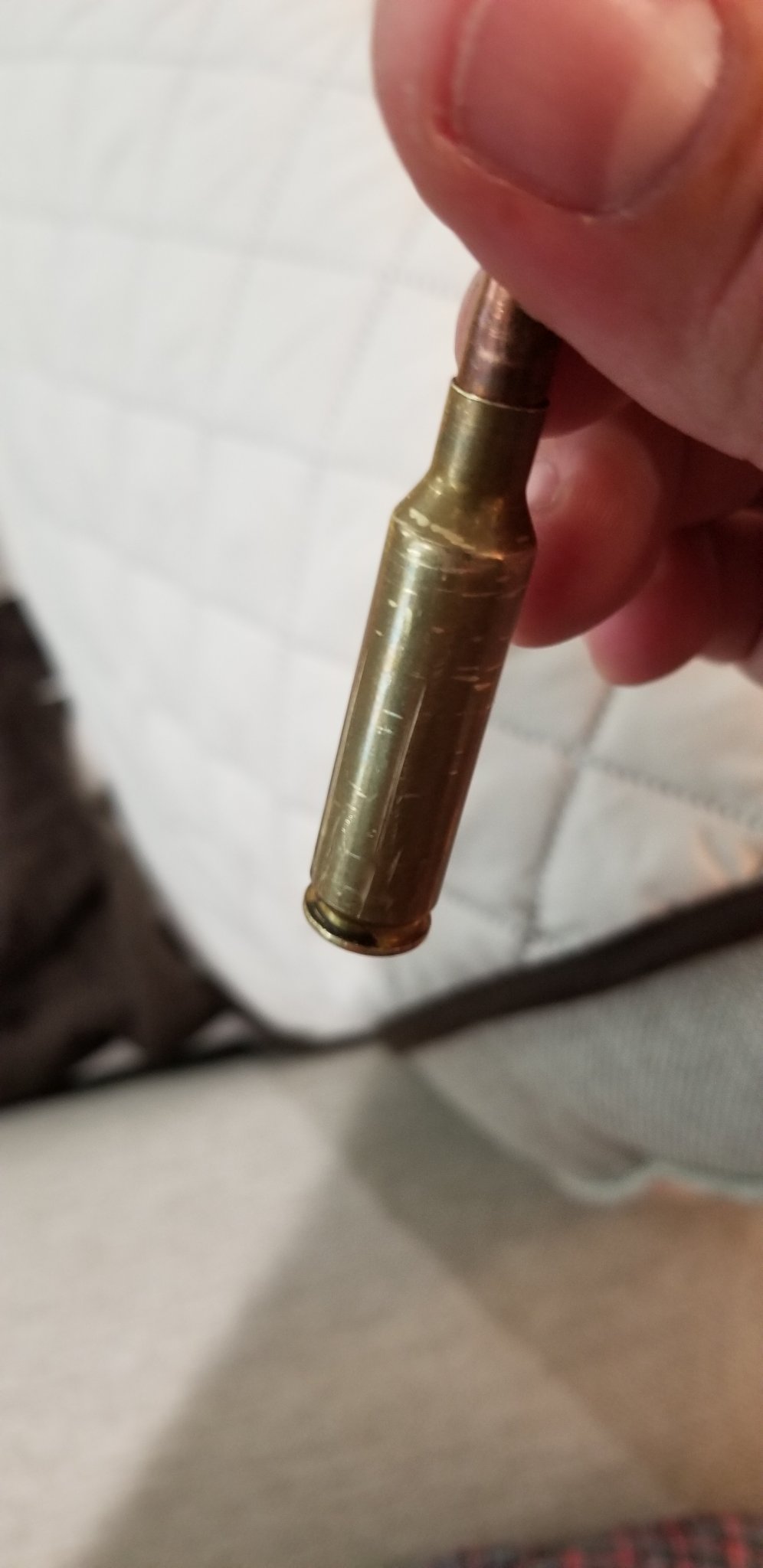

    2. Chambering a round from the internal mag is very clunky. Again, takes more force than I would think neccessary. Also feels as if the round is catching on something. The dummy round I cycled was scraped up pretty good. I'll include a picture of that as well. My first though was maybe too much tension from the mag spring?
    I'd appreciate anyone who can weigh in and provide any info.
