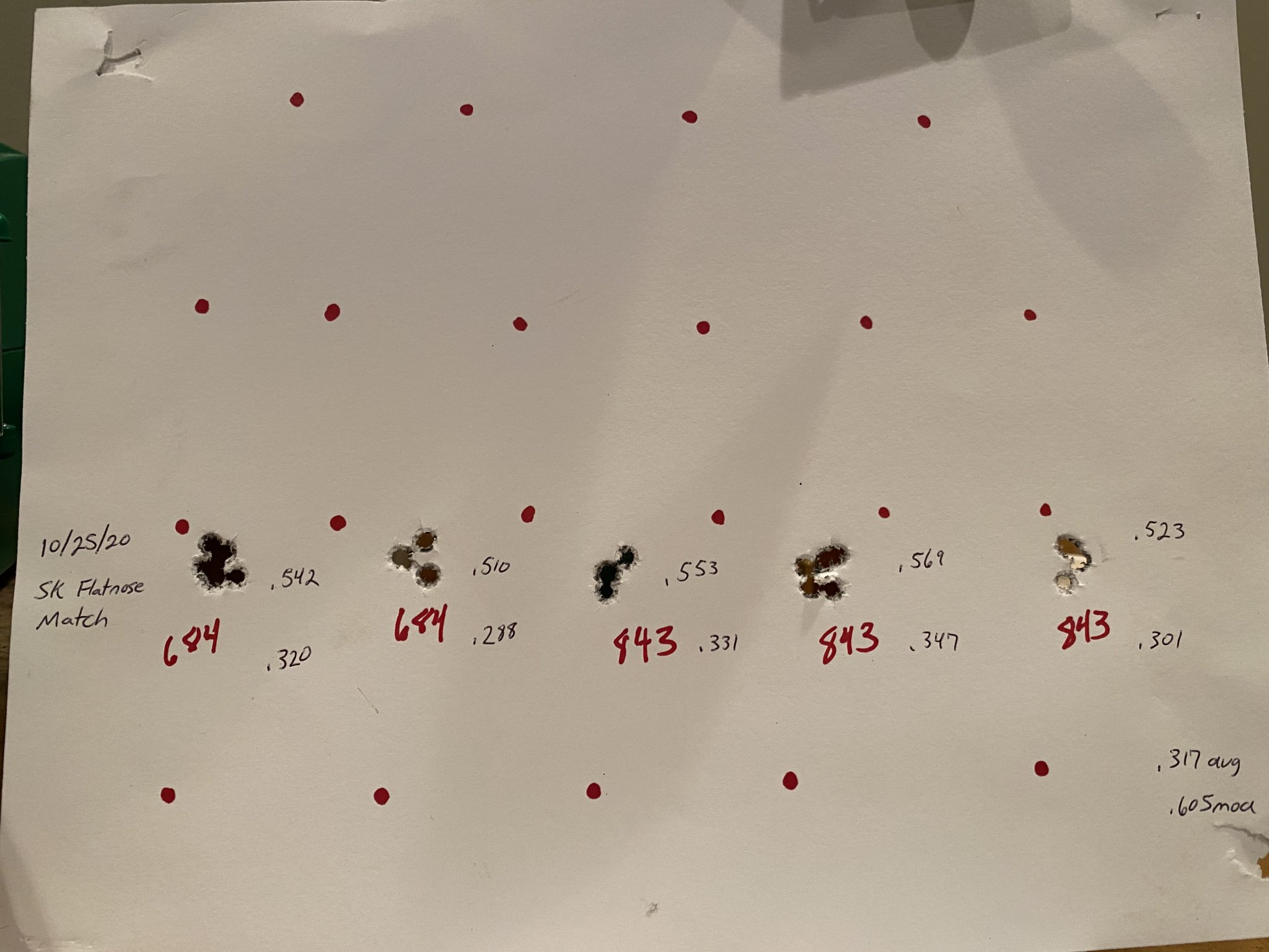

Ran some of the SK flatnose match earlier today at 50yds. Nothing spectacular from either of these lots, but it was consistent.
This ammo is very sensitive to proper feeding. I had the B14r in a manners that I had bedded for a different rifle and had 30% failure to feed with the FN match but no issues with Sk Std + or Center X a week earlier. When swapped back into the factory stock, 0 issues with feeding today.
.6 with SK sounds pretty good to me. Real close to what im getting with CX
Have a brick of the FN, but waiting to bust into it until the RM and STD+ show up next week.
