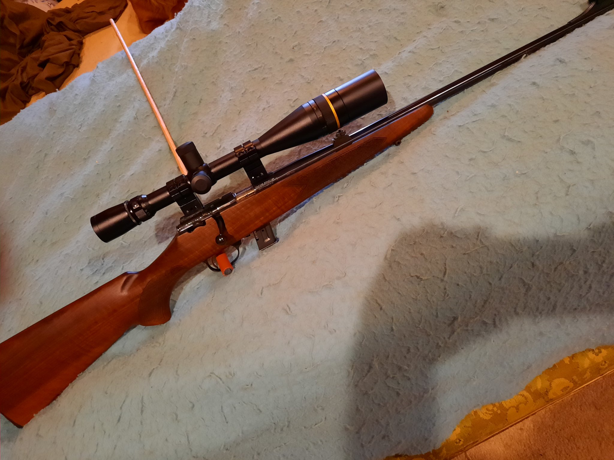

New b14r. Tried 3 different types of rounds, all would not extract unfired round from chamber. Fired one round and case extracted fine. Rounds are being shoved into lands and can see marks. Filed bullet down a little and extracts fine. Was using federal 36 and 40 GR as well as cci standard velocity. Any ideas? Is this normal and will it change with some rounds down it? Any suggestion on diff ammo?
Response from bergara was prompt which I appreciated but not very prescriptive.

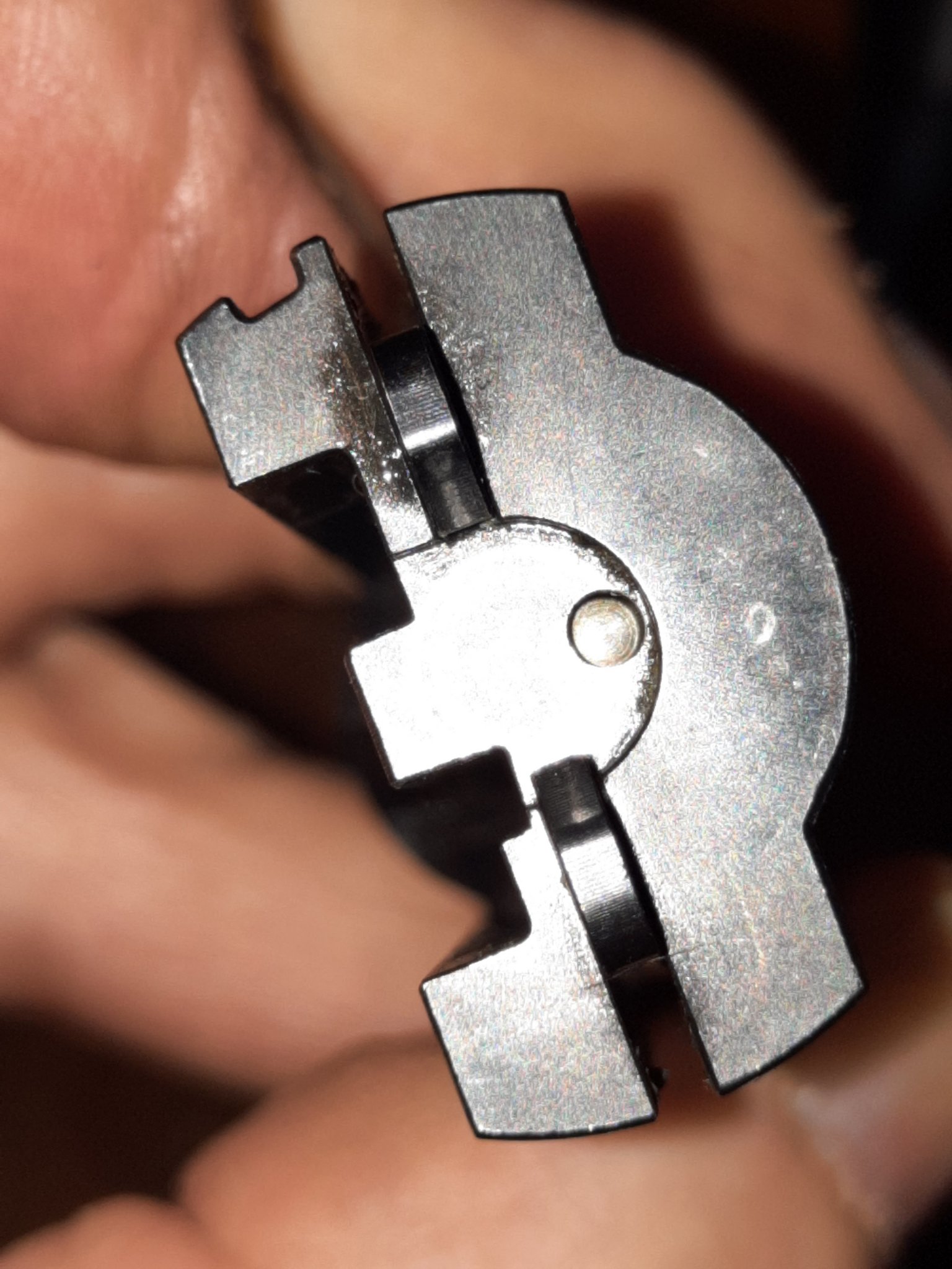

I don't own a Bergara but know several people who do, one just had severe extraction issues during a match. The extractor spring had completely given up, Bergara replaced it quickly, yours is probably headed that way. As far the chamber goes any and all "match" chambers will engrave rifling on a chambered bullet, how much is the secret sauce for that gunsmith/company/purpose of that rifle. It is also dependent on ammunition brand as to where the driving bands are (too much engrave and you cannot extract an unfired round). That is why every response to rimfire accuracy is "shoot every ammo you can" find what performs and is accurate in your rifle.

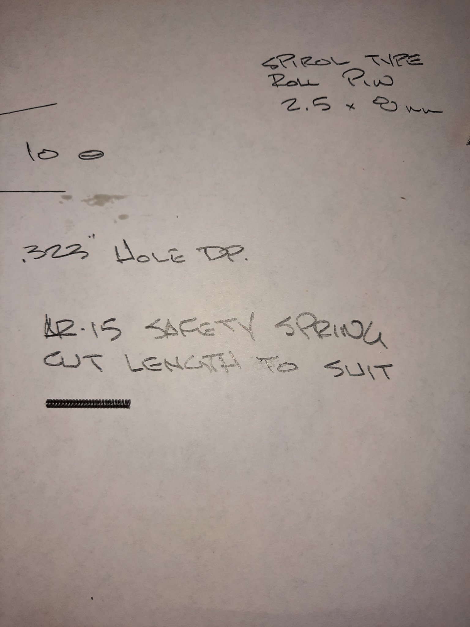

Take a look at this thread. I had a few that wouldn’t extract and the assist spring on the tensioner claw fixed the issue. Took 2 mins to do.

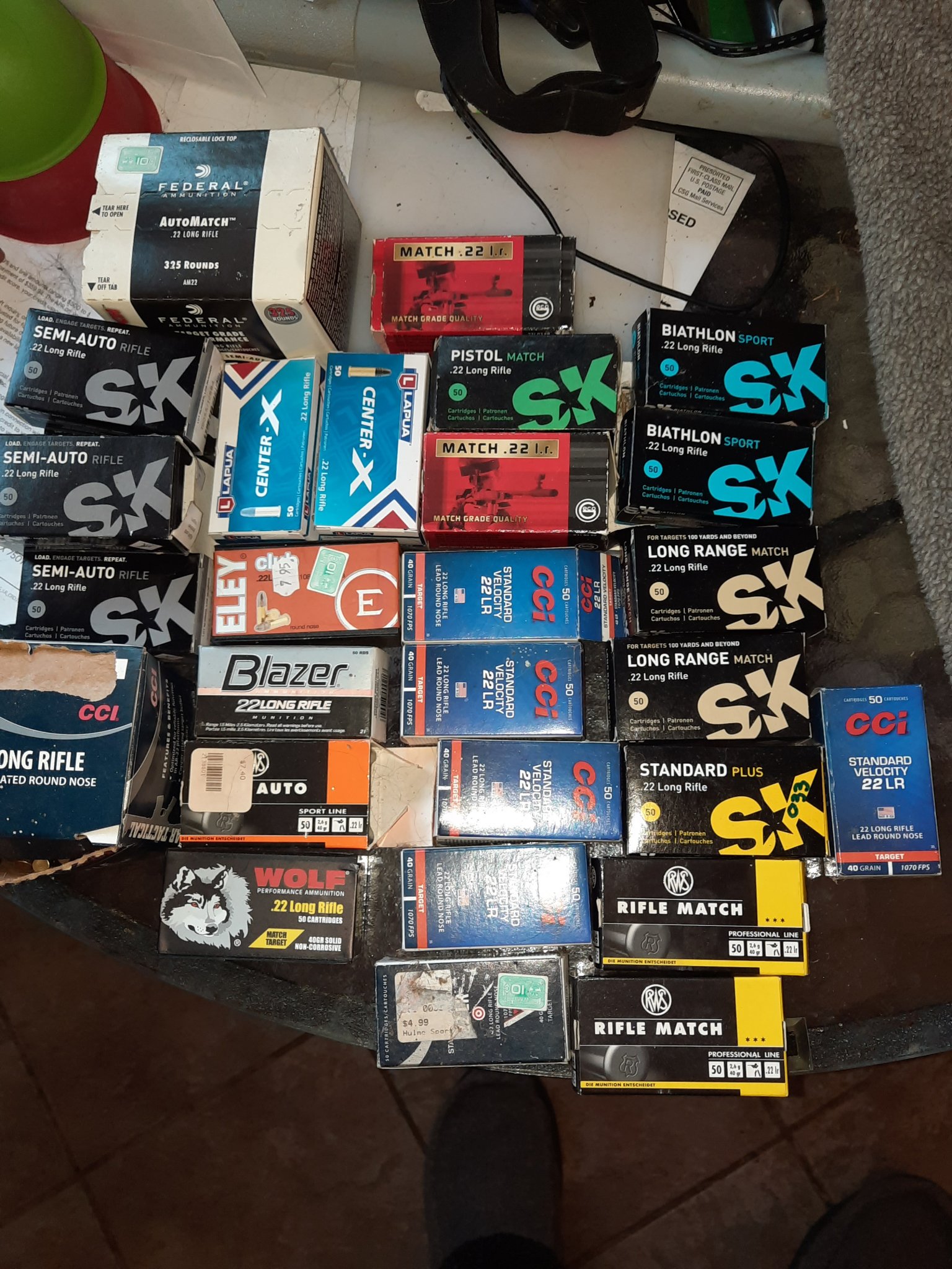

My B14R has been fed all sorts of ammo with no issues whatsoever. (see attached image. ) When my Vudoo was sent out for lot testing,
someone told them to start with Midas Plus. I asked Devan to please try Center X and he actually got better results. As a matter of fact,
none of my guns likes Midas Plus better than Center X. It is almost seems like the V22 found the most consistent lot of Center X
and that that ammo does well in all but two rifles.
When I test ammo, my objective is to find the best shooting and the most cost effective that I can get. It is almost always ends up being
the lot of Center X that my V22 liked. BTW.... none of my guns have any FTE issues. I would not be tolerant of that even it
was only 2 / 100 rounds. I would have to resolve it.
I have a Serbian made MP22 that does pretty well with SK red box. Strangely, it doesn't like Center X at all. I have forgotten but I think
it liked Wolf the best. I have over a dozen other guns that hate Wolf. Hate means any group over .375" ctc. is unacceptable.
I considered shot #6 in image #3 as my fault. I will be re-testing that gun.

Back to your point.... I would look into the extractor and spring. It is after all a childishly simple design that simply grabs the rim of the
case. There is little to go wrong from a design standpoint. My B14R extractor spring is at least twice as strong as the left side finger.
And the extractor finger edges are very crisp so as to not roll off of the case rim.

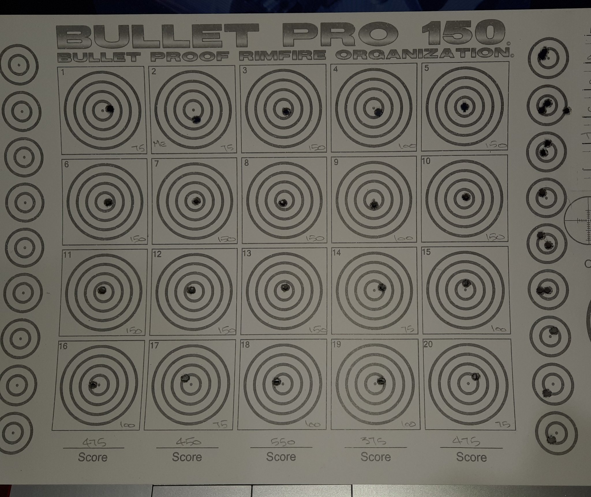

In image number 3, the circles are .50" and 1" diameter. My aim point was the black dot and I was shooting to
see how it grouped. Image #3 was for the Zastava MP22. Image number 4 and 5 were for the B14R.
In the future, all testing will be done using the Bullet Pro 150 target. I have them printed on thick card stock at the UPS store.
The bullet holes print much nicer than on plain thin paper. I also have a .22 E-Z Scoring Plug on the way from Nikk in Canada.

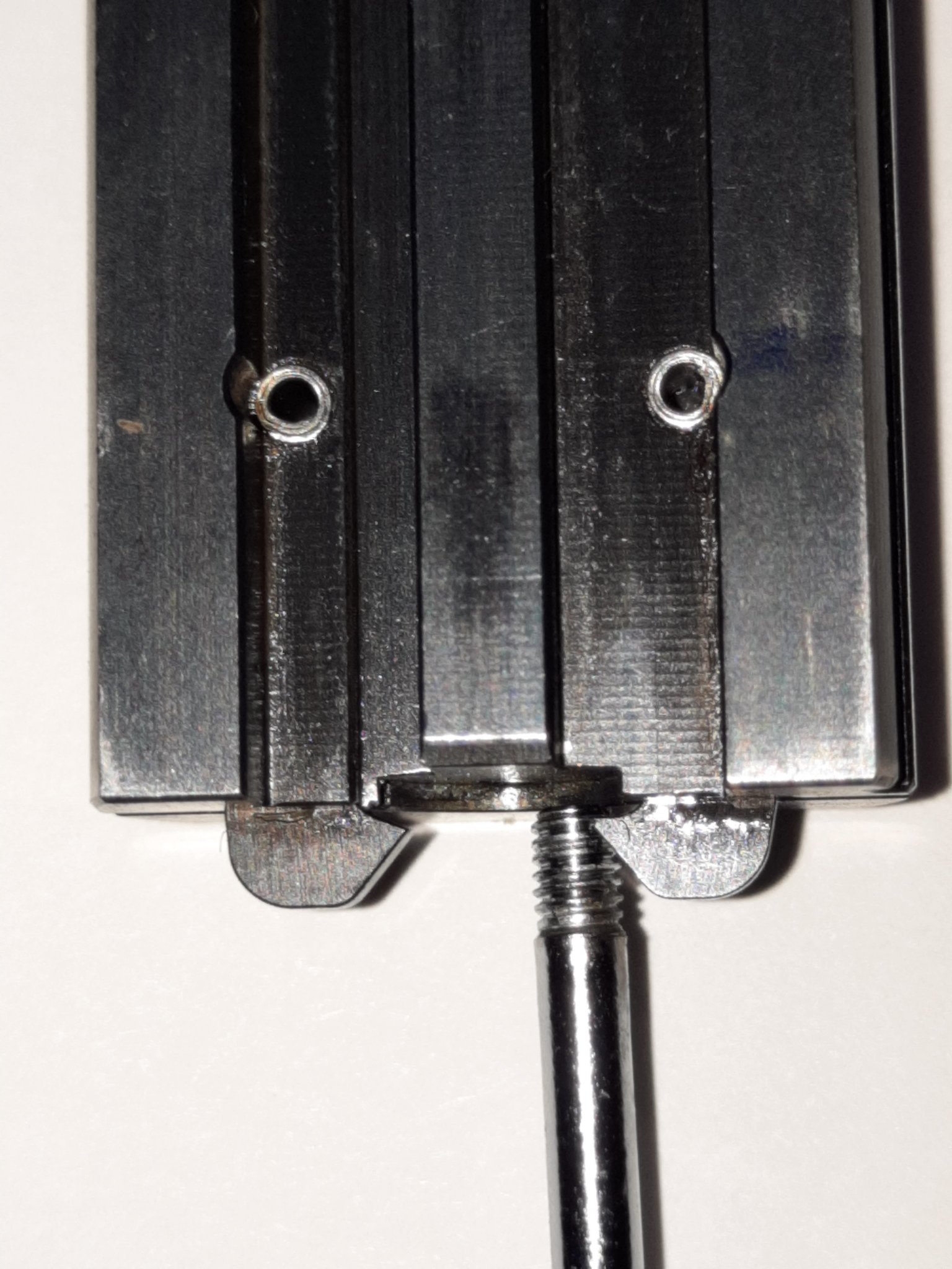

I suspect you have seen how to add a 4.5 pound #6-32 long nose spring plunger to your trigger to change the weight to 11 ounces??
The mod also provides you adjustable sear engagement and stop. Cost is $4.56 and 20 minutes. Your trigger already has pilot holes drilled
so all you need do is enlarge the hole and install the plunger. Part number 8495A11 ( order one with nylon thread locker)
If you have already installed a #4-40 set screw, you can still do this mod.
My SH connection is painfully slow but you can contact me on my email which is shown on my Avatar face. There is no need to
open the trigger module..... It is also a reversable, removable mod.

Thanks will try the detent spring approach to stiffen up that side.

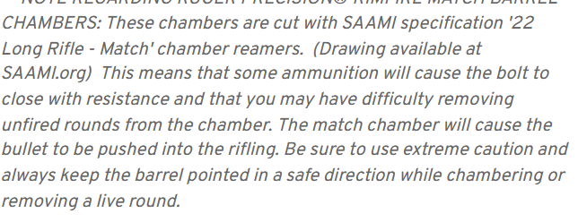

This really is not an unusual thing, many barrel makers actually have disclaimers to state this may happen with certain types of ammunition. I have one match chambered rifle in particular that hates all CCI offerings, SV, subsonic, Green Tag.
Reactions: Peahi2
I do believe that it states in the manual that the match chamber may not extract unfired rounds.

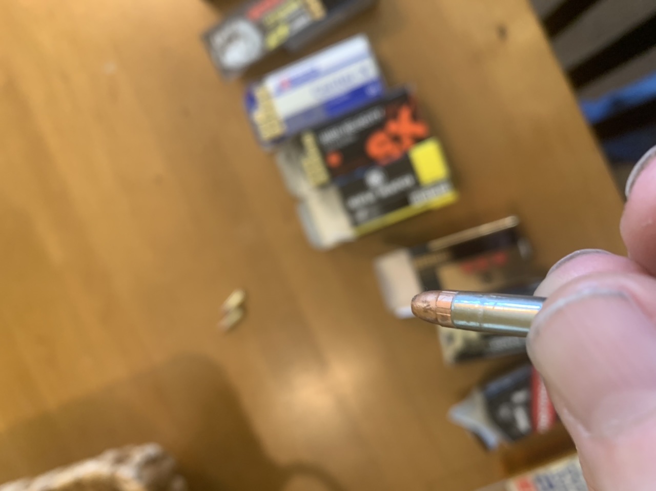

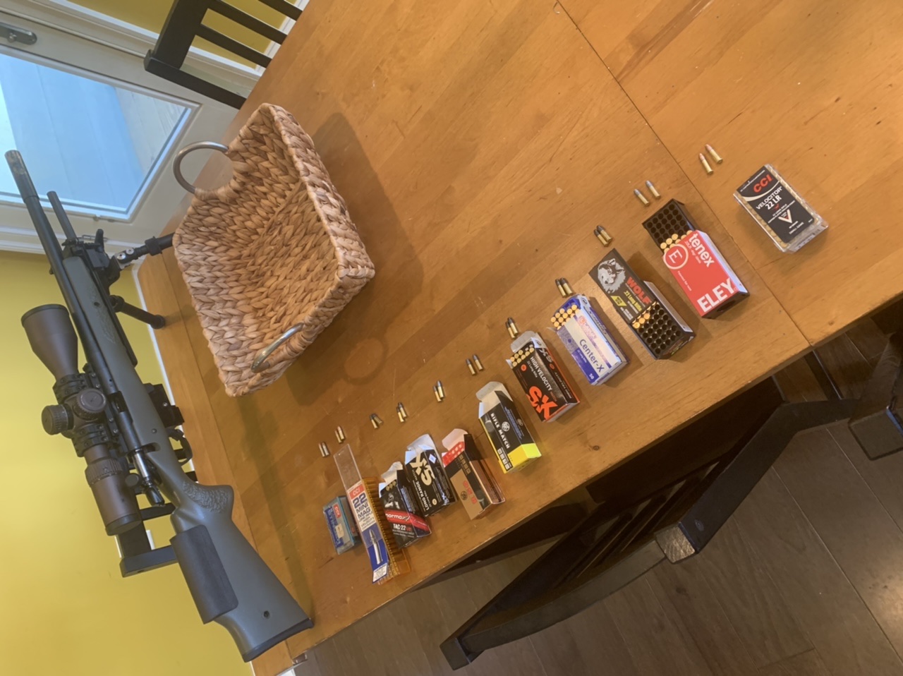

B14R in Manners w mini chasis. Mack brothers mag.
Have a pretty good variety on hand so I loaded the mag up with 2 each.
22 rounds 2 of each pictured fast cycling.
No issues. I know it’s not that many, but I figured it might show me if a little more work was needed.
The velociters engage a bunch of rifling, & stingers case is so long I think the case hits Rifling. They all extracted without issue.
And yes I know the bi-pod is on backwards.

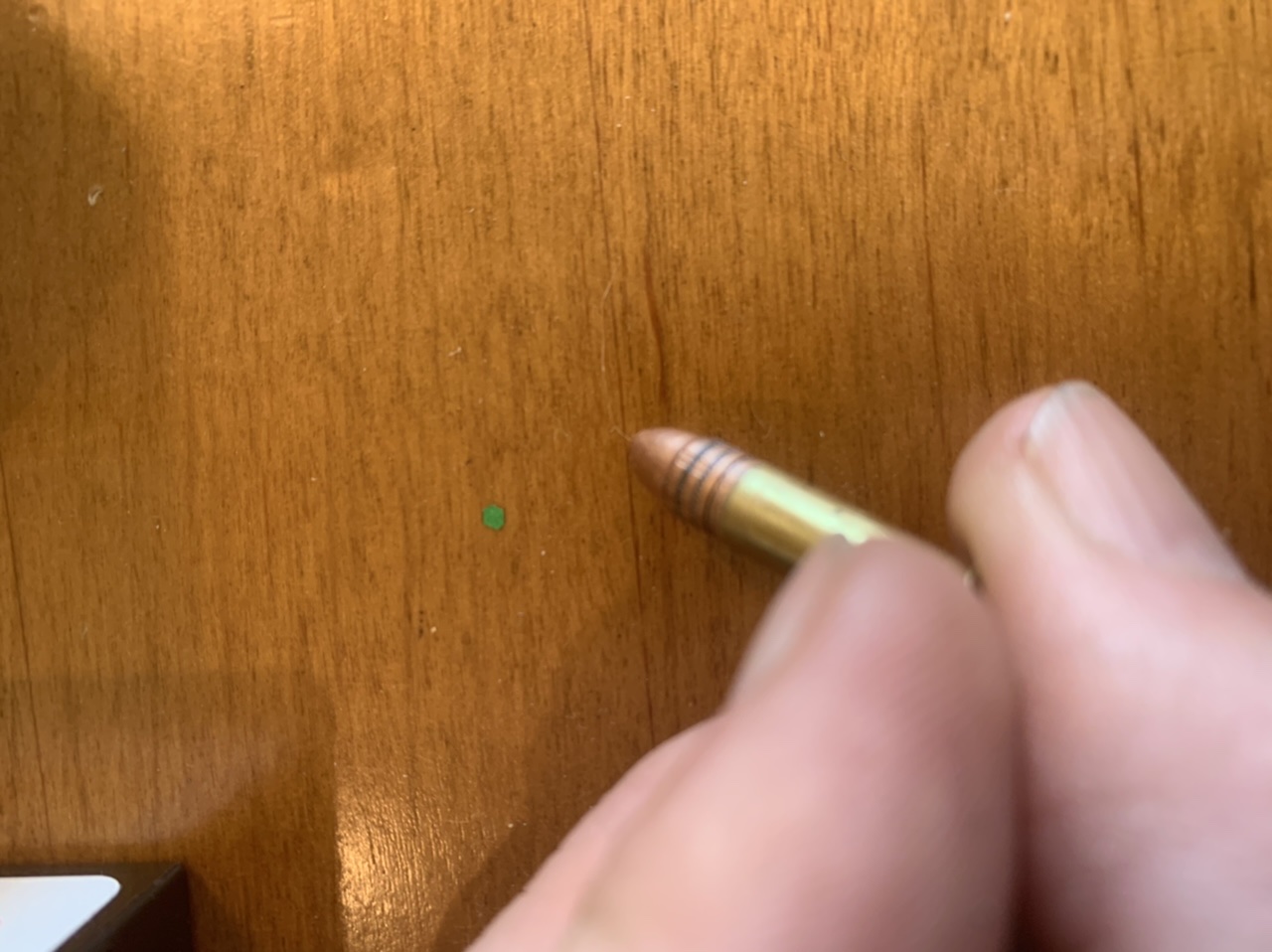

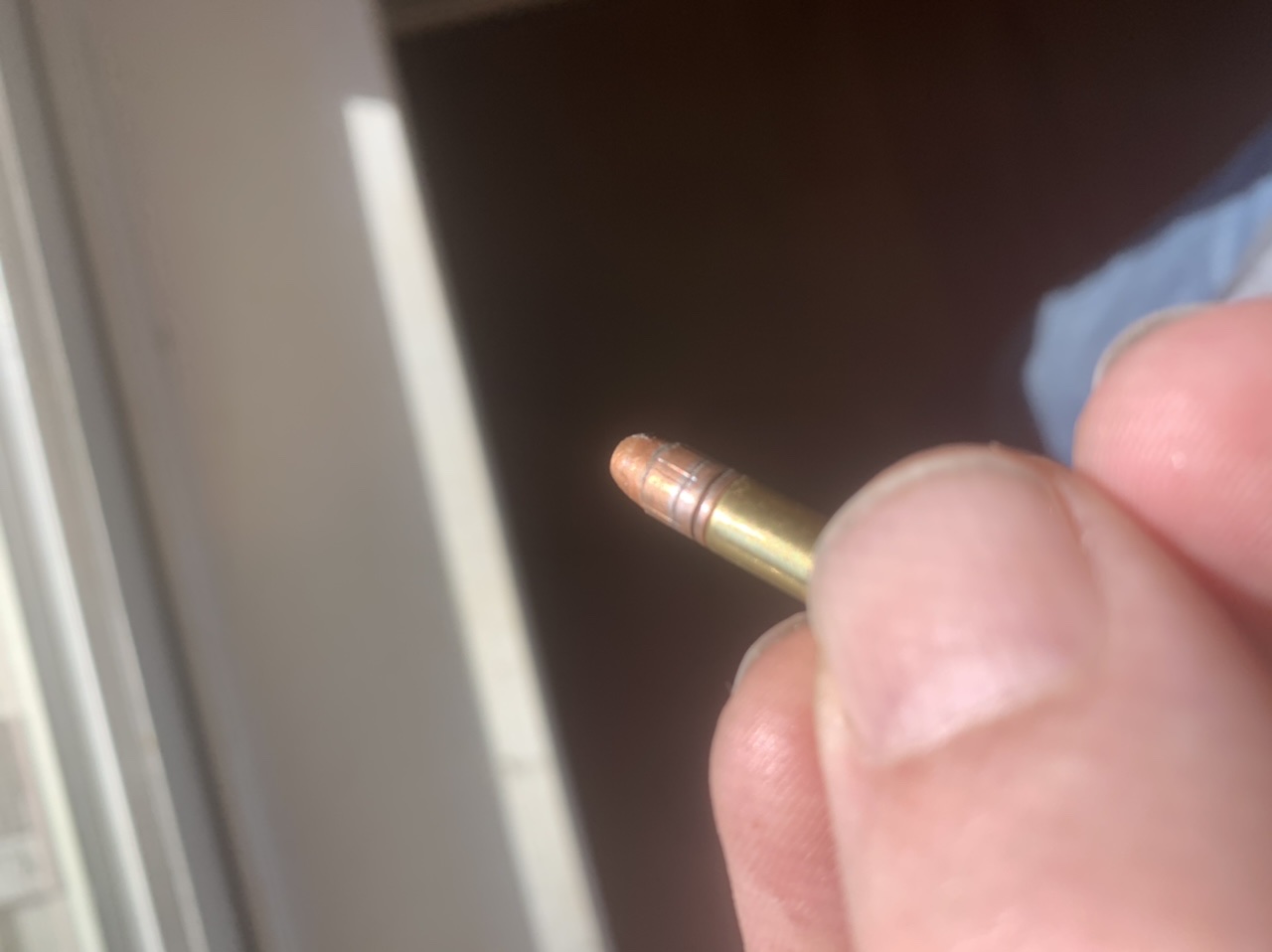

I was using match ammunition, and I wish I would have recorded it so everyone could see what it was doing. It would not extract any live ammunition.

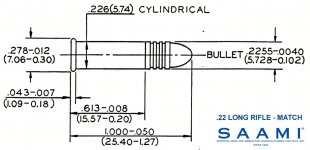

inappropriate ammunition here. I suspect that the ammunition in post #17 all fits withing the SAAMI specs.

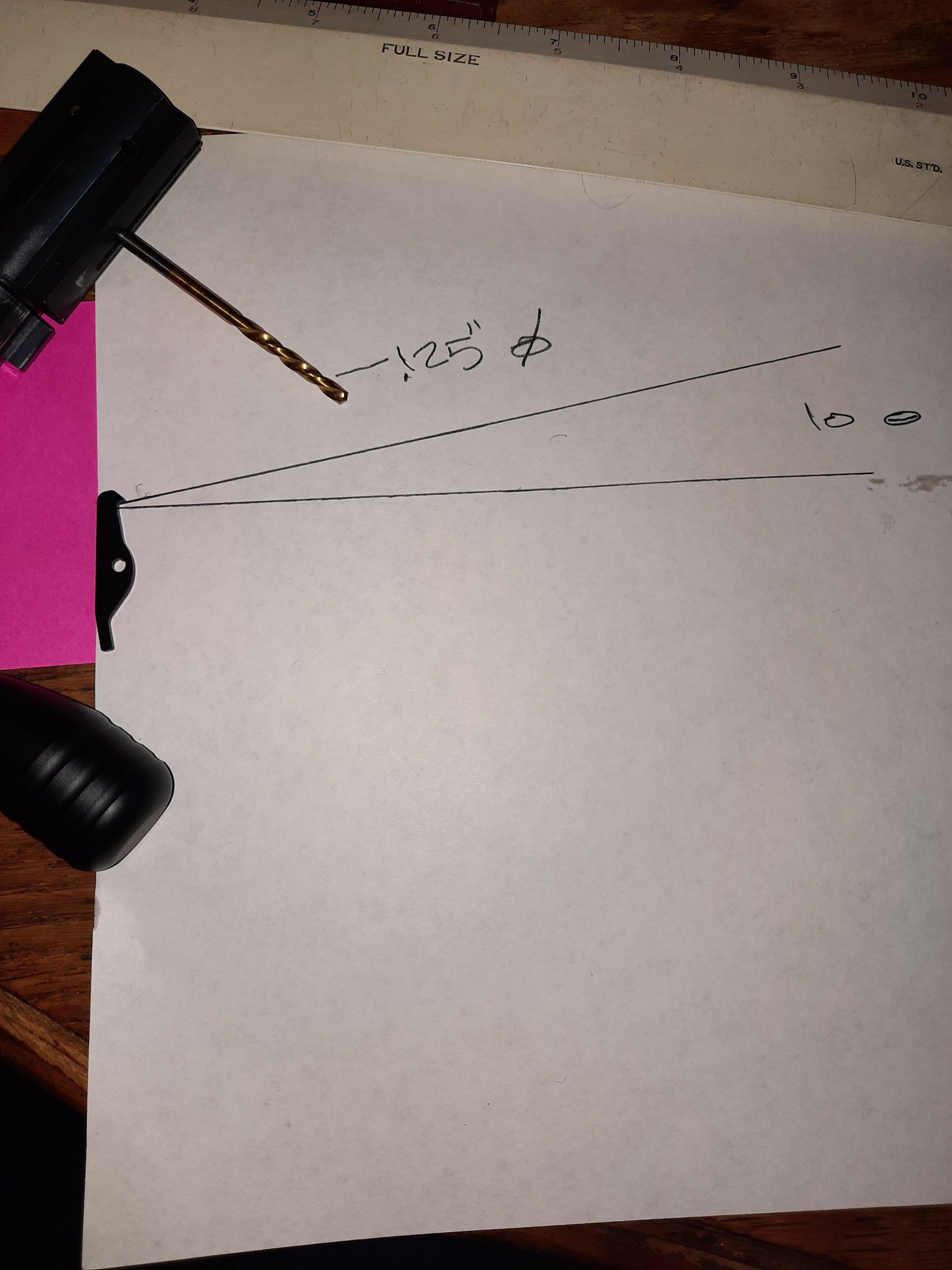

Have you ever seen the springs used in a Vudoo? They are small little things. 1/16" OD ??

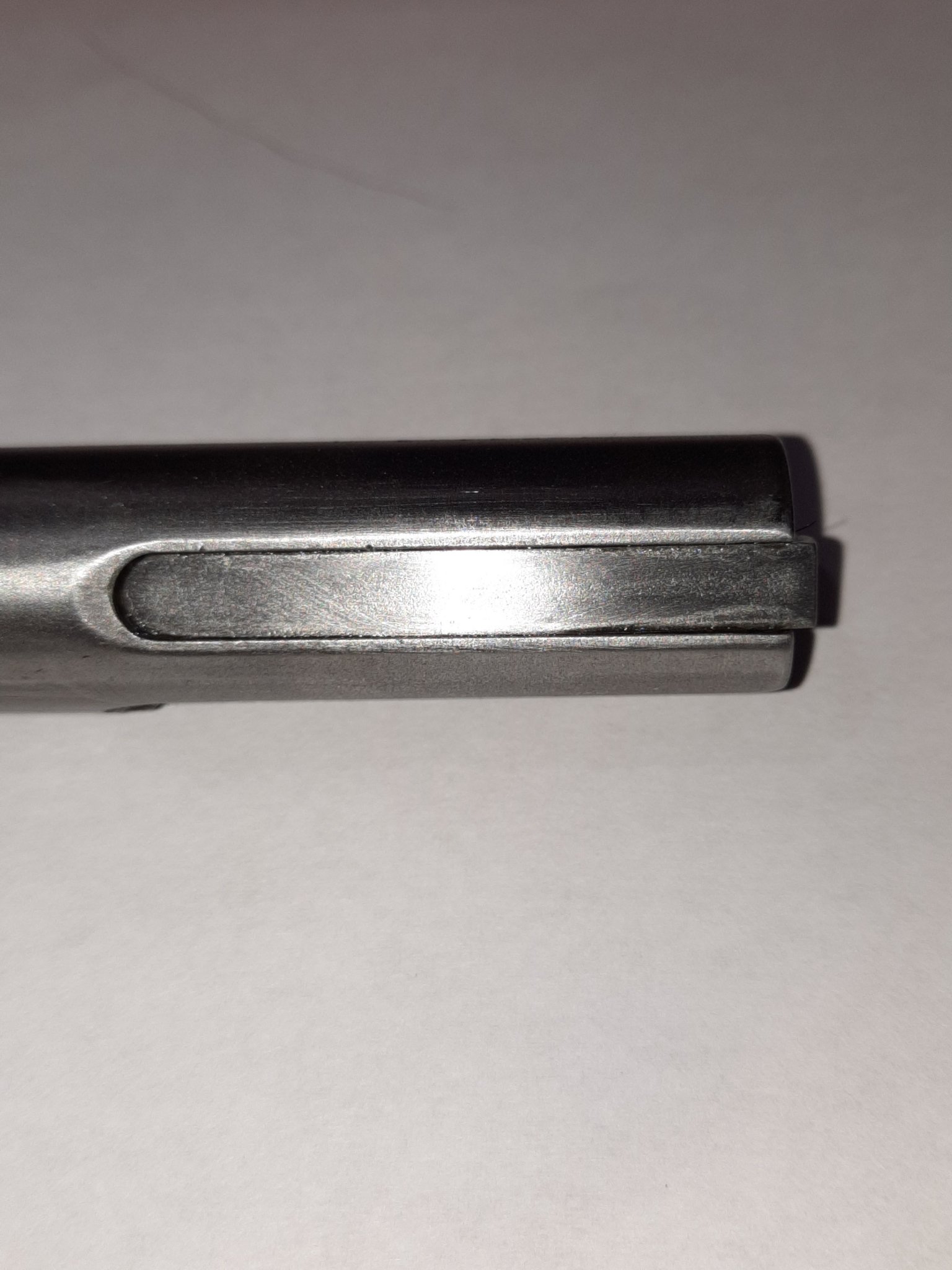

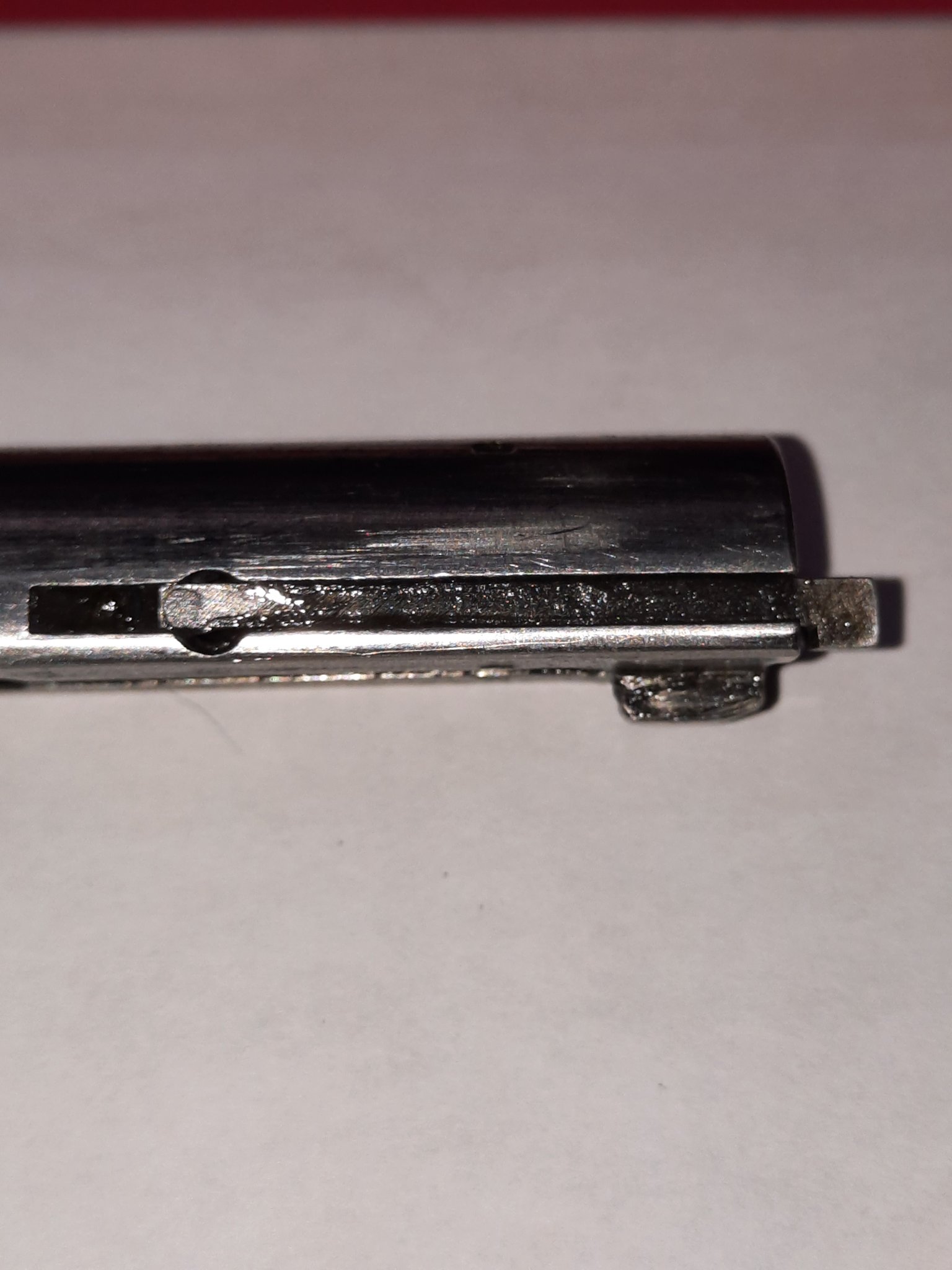

The Springfield below has an extremely robust extractor. It can hardly be deflected with your thumb.
I just put a Stinger into my 1922 and it pulled the bullet back out without issue. You could see where the over length case had
gone into the chamber. It had no rifling marks, but it would not have mattered.
The Winchester 52 uses coil spring but they hole they go into is around .13" Of great importance is that the right-hand side extractor
has very sharp, crisp edges. ( think kittens claws) The sharp edge is set up so that it contacts the case near the case wall to maximum
the extractor force.
The Win 52 finger is cut to about 95* angle so it grabs the cartridge.
I just looked and virtually all of my guns keep the spring / pivot pin / grip edge of extractor at about a 1:1 ratio.
My B14R has about a 1:1.2 advantage over the extractor tips. It's finger is about 87*. It has about a 3* shed angle. :-(
If any of my guns had FTE issues, I would stone them to match the Winchester style. I'm intolerant of mechanical devices
not functioning properly.

My main concern is/was that I plan to use this gun in NRL/PRS style matches. You must move often during course of fire and the bolt must be back when you do so. If the round does not eject, I will now have to drop mag (or misfeed when bolt is closed), close bolt, reinsert mag. All of that takes time which is in short supply in those types of matches. I do not plan to use it for benchrest. Maybe I bought the wrong type of gun for this type of match, but my 2 buddies have the identical BA and neither have this issue.
Run match ammo like SK/Eley and see which one live ejects and run that one. My match chamber on 10/22 wouldn't eject live CCI SV rounds, but ran SK Standard Plus like a champ.
For my Vudoo I don't even bother running anything else but Lapua/SK ammo, so no concern there..
Reactions: Boxerglocker
Don't even bother with lesser ammo in match chambered barrels. Your not the first one to have unfired round extraction issues in a match chambered barrel. I have one barrel that with CCI SV the extractor will deform the rim before it let's go. That's how hard the bullet is pushed into the rifling. Lapua, Eley or SK no issues.
Tried SK standard and match as well as Aguila match this past weekend, none would extract
Handfull,
I don't have a dog in the race so I don't need to defend the Bergara, or anything else for that matter.
My B14R has no problem with anything I feed it.
I doubt you got the wrong gun for your NRL/PRS stuff. It will likely be a surprisingly small detail and simple fix. Have you ever

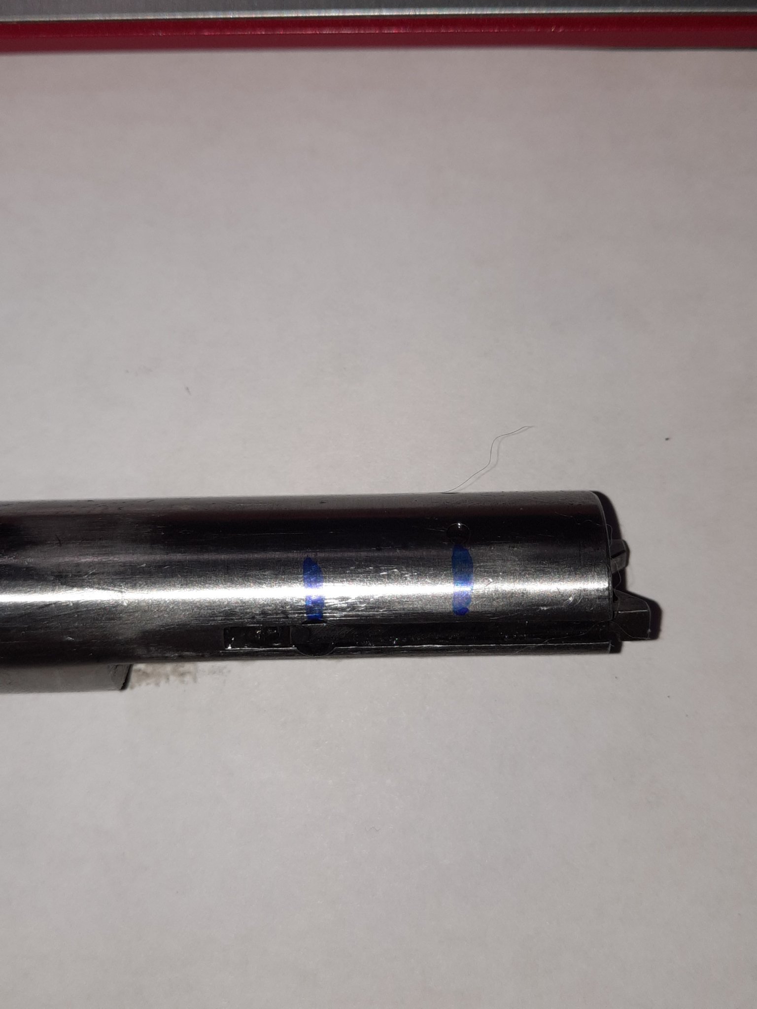

tried someone else's bolt to extract the bad round?

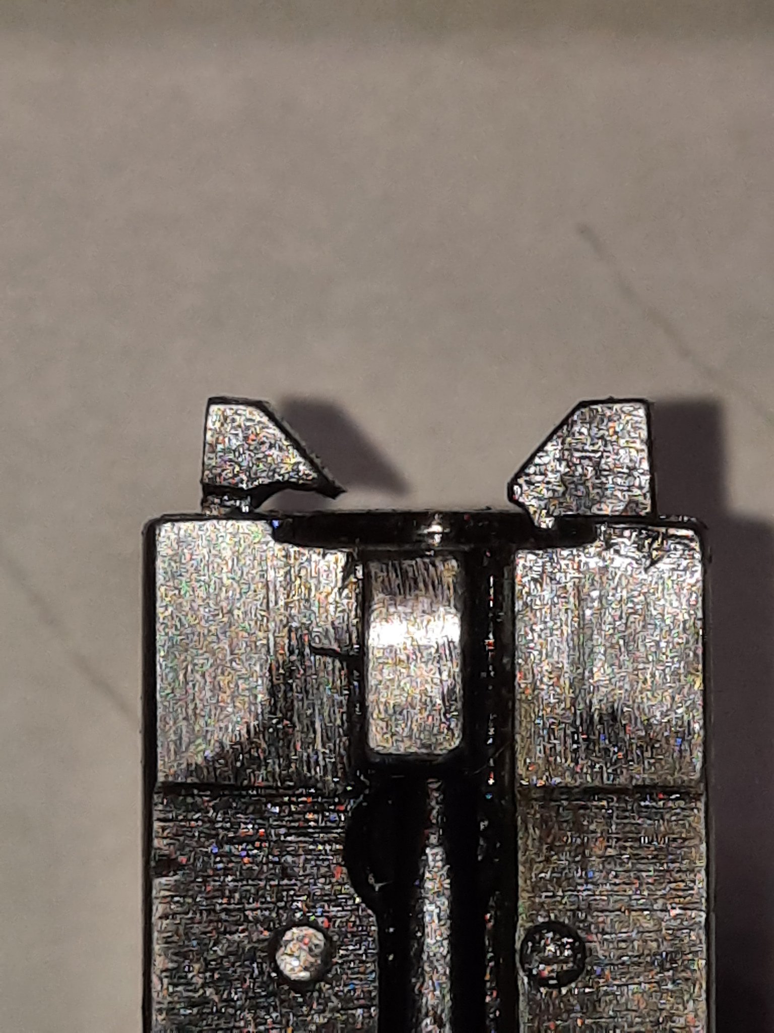

To me, that would suggest an extractor spring or shape issue. I just looked at my bolt and putt a case on it's face.
Both extractors touched the side of the case.
You may even go so far as to deactivate some rounds to intentionally test it. An overnight soak in some WD-40 will likely do it.

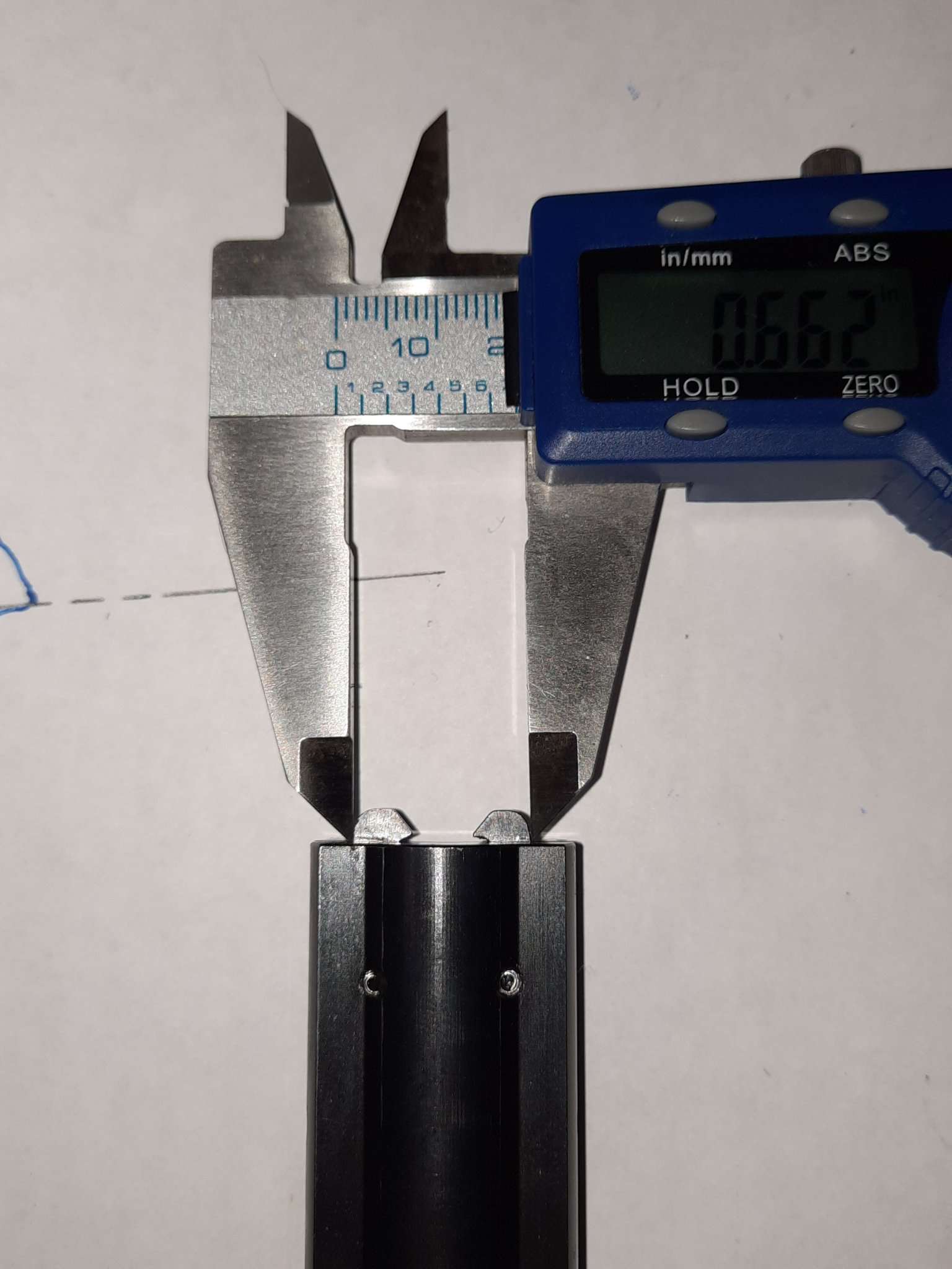

The dimension between my fingers' is .662" to the outside edges. That may help you determine if you have any particulates
under the extractor arm in front of the pivot that keeps it from completely closing.

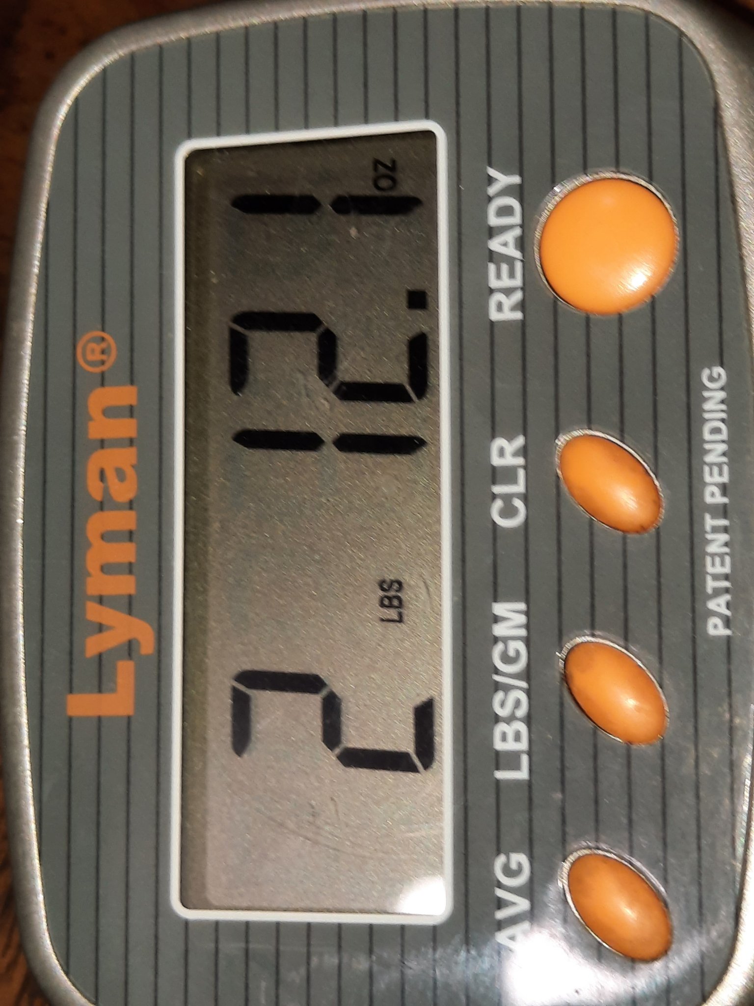

I used my trigger scale to estimate the right hand extractor force. From it's closed, empty position, it took 2 pounds 12 ounces
to deflect it approximately .030" That moves it's tip so that it is coincident to the edge of the case base 3 o'clock position as shown.
You should get similar values.
Hopefully that information may help you.
Don't give up...you can resolve it.
Good luck.

My Tikka had issues extracting live rounds once, and it ended up being that the extractor bottom right corner was slightly chipped rounded off so it wasn't able to apply the full force before slipping off the round. I swapped that extractor part and it ended up working just fine.
B14r is a pretty popular rifle so next up is to compare with someone else at the range/area and see.
Quick update. Pulled extractor spring, stretched it a little and put back in. Cycles sk std and long range fine now, so I have a pretty good idea on how to solve now. Thanks for all the help.
Reactions: Masojoh
The extractor claw or the tensioner claw? My extractor claw was pretty firm already. Tensioner was soft.
Tbh not sure. It was the weaker one, by far. Other is very stiff already.
I wish you would have measured your spring.
McMaster Carr has springs that are .12 OD and of various wire diameters.
I would call the extractor finger the one on the right hand side. It is the stiffer one of the two by at least twice the force.
The left side I would describe as a stabilizing finger. It holds the cartridge and spent case in line with the bolt axis during
operation.
As a side bar, I would suggest that people don't put an #8-32 plunger in their trigger. Among other things, it nicks the safety
ball detent. I still feel the #6-32 is your best option If all you want to do is modify the factory unit. I will be posting photo's of
the B14R trigger soon. The sears of the B14R are not particularly well defined. They have very slight radii.
The B14R extractor spring is .255 long x .1185" diameter with .0215 wire. The hole in the bolt is about .127" diameter and .323" deep.
If you look for a new spring, remember that they do not have a precision OD and when compressed the diameter actually
gets a little larger since they unwind. McMaster Carr does not have any suitable springs. The one below shown in blue MIGHT work.
It's .120" OD x .025" long x.024" wire diameter. It would be close in the OD. You could also get one in .023" wire.
You may also be able to use the safety detent spring from an AR-15. Shown in the second photo. Since I have them, that would be my
first approach to making the extractor grip more robust. Even if it were simply to test the theory. I don't feel stretching the spring has
any long term value that you should count on!
It hasn't changed any of the springs physical characteristics. I think a better fix would be some #00 washer in the hole to
increase the actual pre-load force.
The extractor hook end is about 10* but when in place it is nearly square to the cartridge base. It's edges are cut sharp and crisp
as I would expect them to be. At least mine are....
Just suggestions...
