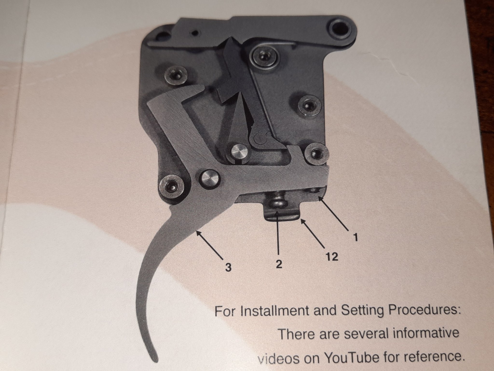

The Jewell trigger below changes it's trigger weight by changing the trigger spring at position number 3.
They supply you with three springs and that changes the weight from the maximum 48 ounces to 1.5 ounces.
They are the same outer diameter but different wire sizes and length. The sear engagement was left to the factory
setting.

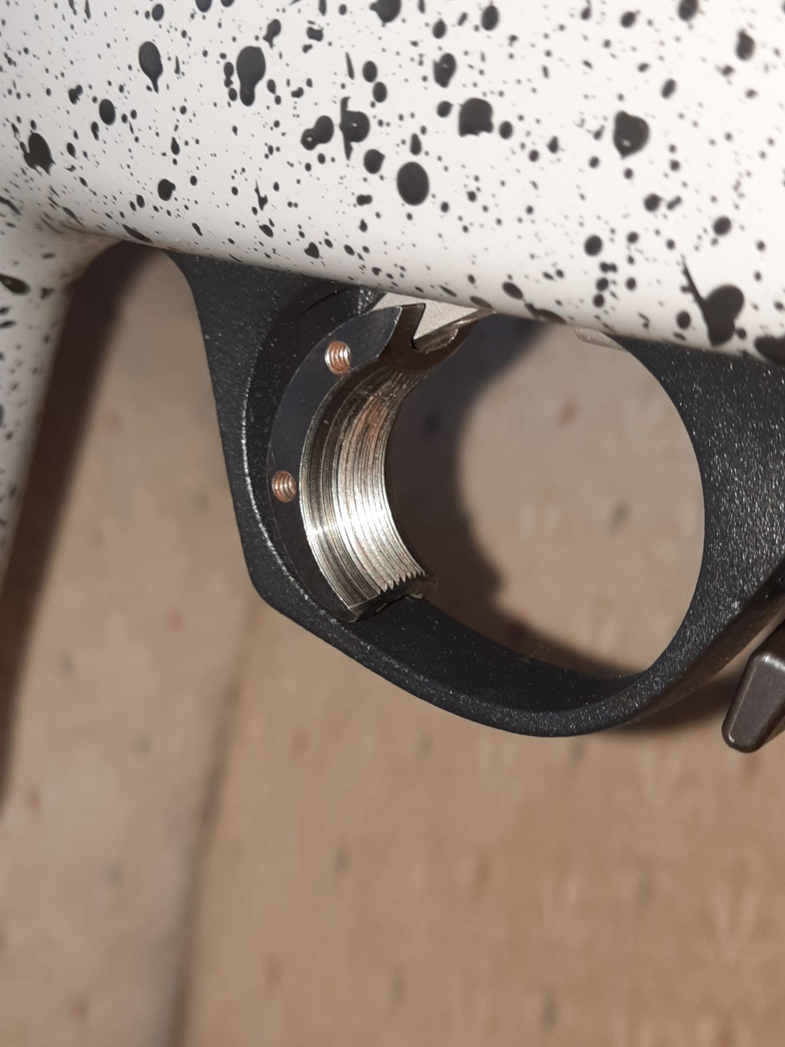

It's an #HVRTS-A Right hand and was set to 1# from the factory. It feels great with the ACE trigger shoe btw.
Maybe nicer than my Trigger Tech Diamond set to 4 ounces. All I did was change it to the lightest spring.
