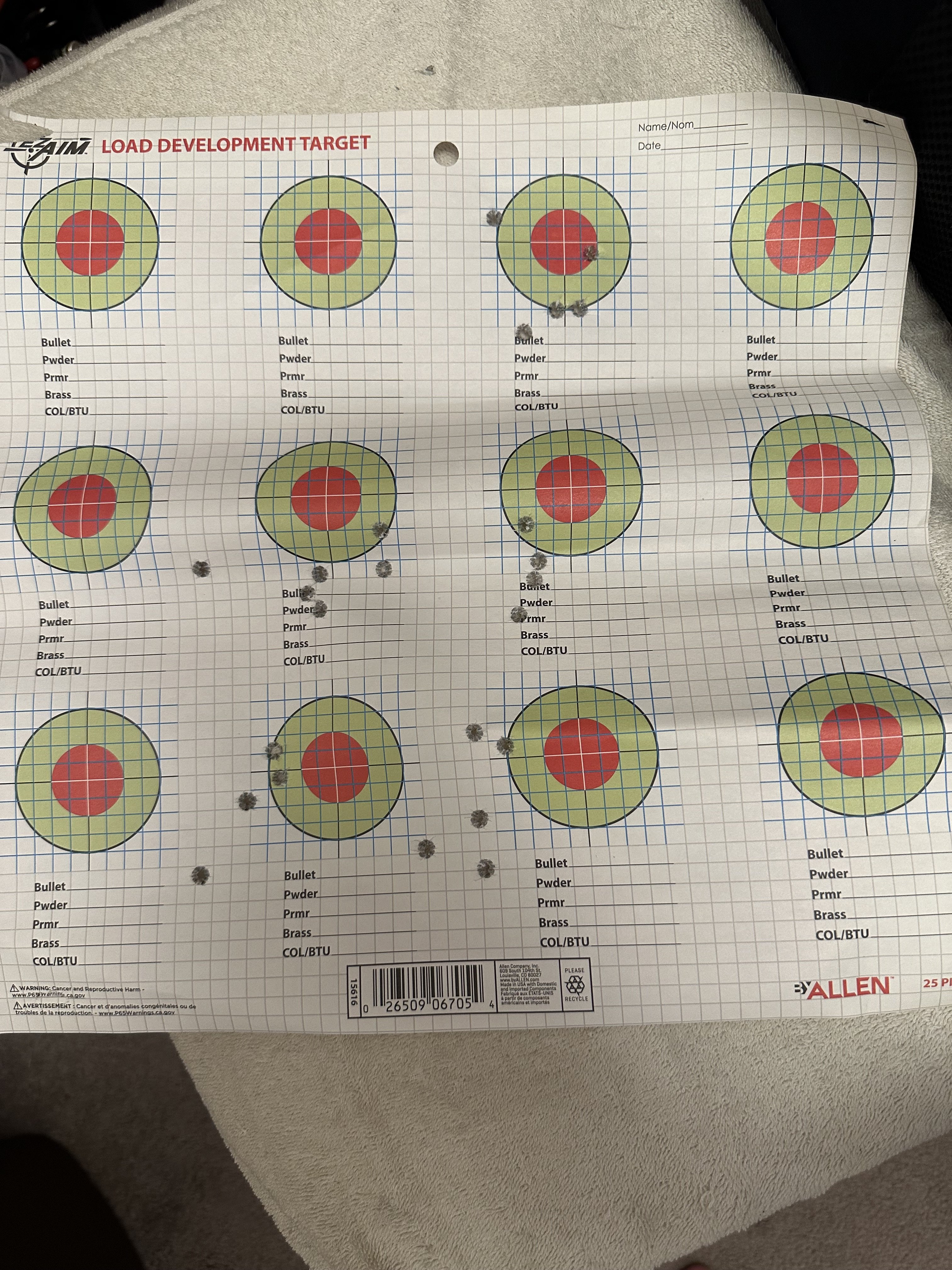

Here’s my RPR in 300 PRC the day before at 200

There aren't that many things that could cause a "one hole" load at 100 yards to blow up to a 2 MOA load at 200 yards.
1) As @matt33 mentions, parallax would be the first thing I'd look at. While 100 to 200 yards isn't a large yardage difference, it could be enough in parallax adjustment that if either you're off in dialing it in or the scope is screwed up in that regard, that it could be a sizable portion of what you're seeing. I'm still skeptical that parallax could be so far off that it would be entirely responsible, but I'd start there.
To Test:
First, make sure you've got your parallax set correctly. Move your head side to side and up and down. The reticle should not move in relation to the target as you move your head. Adjust it until it doesn't.
Second, change the parallax relatively significantly and see if the scope's behavior changes (it should). If it doesn't, you may have a parallax issue with the scope.
Third, put another scope on it and test.
2) It could be you. Granted, if you're getting a one-hole group at 100 yards, you should be able to do well at 200. However, if your one-hole groups are from 3 shots, try 10 or 20 at each range and see what happens. Note that when I shoot for groups at 100 (or 200, or 300 - any range where I can see the bullet holes through the scope), I use orange dot stickers ($6.99 for 1000 1" dots at Amazon) and always dial in like 1/2 a mil to one side or another. The reason for this is that you always want a clean point of aim. Otherwise you end up sort of chasing the group, which opens everything up.
To Test:
First, are you zooming in with your scope when you go to 200? Try zooming out. It seems counter intuitive, but I find that more I zoom out (within reason and only out so far), the tighter my groups get. This is because when you're zoomed in more, you tend to chase the wobble. Not that this would account for everything you're seeing, but it could contribute.
Second, find someone who really knows precision shooting to check out everything. No offense to your law enforcement friend, but some of the law enforcement folks I've met that have had sniper training are not what I'd call experts in precision shooting. Know that most sniper engagements are less than 200 yards - training for that vs. hitting a 1 MOA target at a mile are two completely different regimens and skillsets. Maybe your friend is good, but ideally you want someone who has had a lot of experience with precision shooting across a number of different rifles.
With all that said, it's entirely possible that something with the bullet-load-barrel combo could cause a load that works at 100 to fall apart at longer ranges. This was proven to me in the first long range training I ever took - and Jeff Siewert devotes some pages to the subject in his book. However, it's highly unlikely that with today's quality components in a modern rifle you'd be creating a condition that would cause this - AND - while I've seen groups fall apart at like 500-600 yards, getting such a massive degradation while going from 100 to 200 feels like it has to be something else.

Thanks. I’ll check the parallax and see if that’s off. As I said, and in my last post you can see that I was shooting pretty decently (for me) at 200yds with my RPR in300 PRC with Peterson brass. I noticed I was getting ES’s in the high 70’s too. I wonder if this 5x fired brass is toast. Though I doubt it because I anneal after each firing and there’s no signs of head separation etc. parallax is definitely a consideration. So is this darn Burris scope, I really don’t trust that brand. But it’s one of their higher end models and I figured it’d be ok. Maybe I was wrong. Though if it was I’d think the issue would show up at 100 yds too. I’ll report back next weekend with what I find.
I appreciate all the advice guys! The parallax checks out according to the test from that was posed in the thread. I’m going to try some sierra match king 142g and see if that makes a difference. I know sometimes a particular rifle just doesn’t like a bullet. I ended up getting a box of the match king X’s that I think are relatively new to the market. And I know that means starting from scratch for a load development, but I guess that’s how it goes sometimes.
I also loaded up 10 rounds of the Berger 10k off the lands to see if it likes less jump at longer ranges.
I’ll report back after the weekend to let you know how it went.

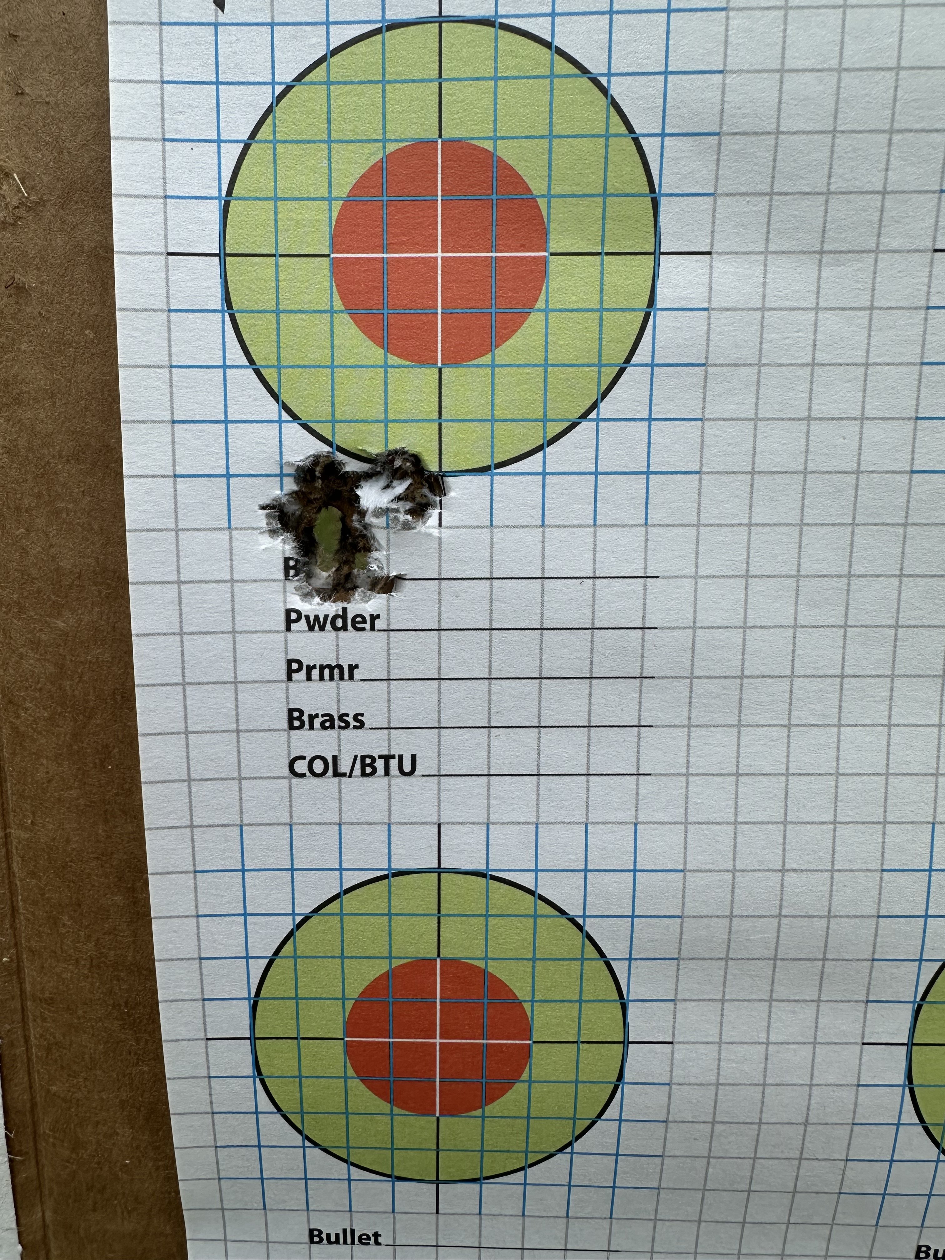

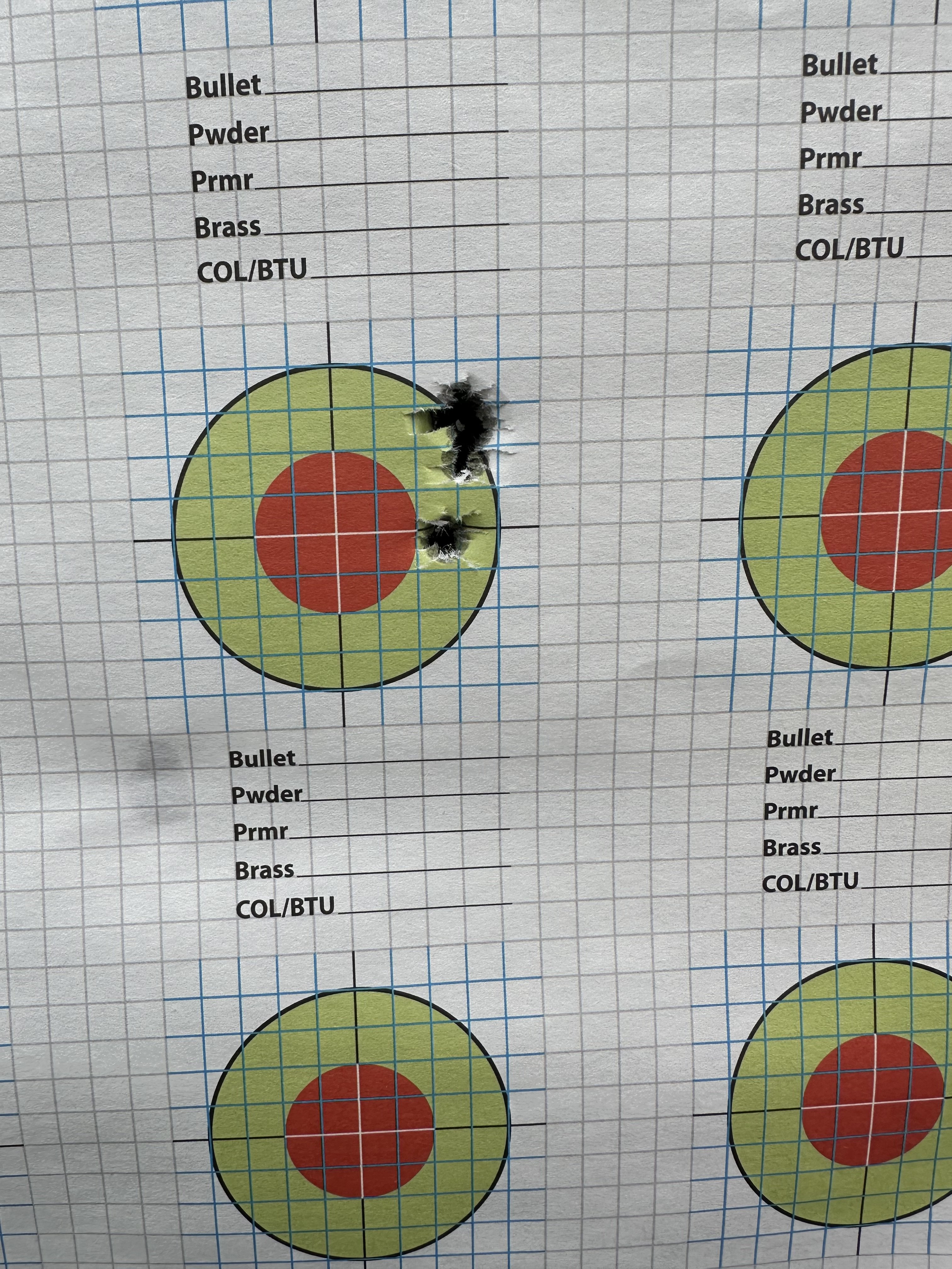

We have a saying where I work. If you don't have photos it didn't happen.
Show us a photo of the group at 100 and the group at 200. Maybe fresh eyes can pick up some evidence of instability. Shape of the group can show certain shooter errors as well.
Also, tell us about the prone position you shoot in. Is there any difference between your 100 and 200 positions? Bipod, rest, surface, wind?

No difference between position, range, etc. weather conditions were similar (about the same temp but not 100% sure). The 100yard target is a 10 shot group.

I would expect a proper load, shot from a good rifle, in a good position to have a circular shaped group. Even barely stable and unstable bullets will give a circular shaped group
Your groups seem very vertical. Even the shots at 100, apart from two, are very vertical. If you are using a bipod, maybe you are getting bipod bounce? I have see a few people get a lot of vertical when the bipod rests on bare concrete.
If using a bipod, remove it and try the exercise again with a sandbag or x-bag rest.
If you are using a sandbag or SEB type rest, I'm stumped. Apart from a load with a very bad ES or very slow velocity, I cannot think of anything else that will cause your results.
