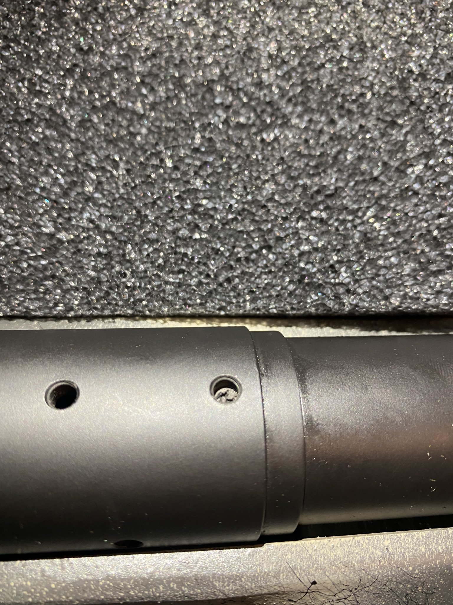

Does anyone make a stronger aftermarket one by chance? But my next issue is how do I get cerakote out of my scope base hole? The gunsmith filed down some sharp edges re painted it and now there is cerakote in the hole and I can’t get the scope base bolt all the way down without a lot of force.
You can get a stronger spring but you need the one you have out to compare size and diameter. But i would just strech that one first and try that. It will more than likely work just fine. The cerakote you need to cut the cerakote around the hole first with a razor blade. Then you can use an exacto to remove the bottom of it and a tap to clean the threads, if you dont razor around the hole it may chip.

This is the first hole above the barrel. Seems like I would need to remove the barrel then tap the hole.

I would run an exacto knife around the top rim of the hole before i ran a tap. If you run a tap you will clean out the threads without clogging up the hole.
I was thinking a small drill bit to punch through the threaded hole first then followed with a tap. What would cutting around the hole do?
What about the cerakote at the base of the hole or against the top of the barrel. The picture don’t show it but it’s built up at the bottom as well. Haven’t fired one round out of it and it’s been one thing after another ready to throw it in the creek.

Run a small drill bit in the hole to loosen things up. Stop of course when it touches the barrel. Use a flat nose tap and it will thread all the way to it touches the barrel. If you use a pointed (starter tap) it wont.
