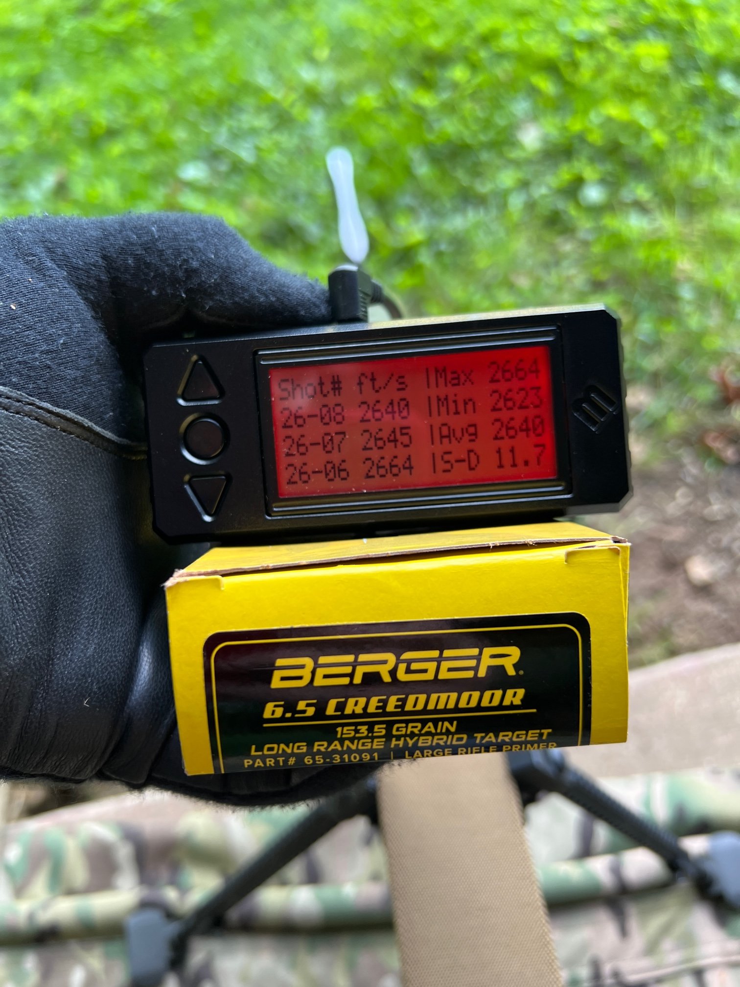

    Anyone have any luck shooting burger 153.5 grain bullets in their 65 Creedmoor?
    I took these to the range and chronographed a box… Got a 2 inch group at 100 yards with a 24in Bartlein 1:7.5 stainless… which sucks.
    The rifle can shoot the crap out of 147 grain ELDM‘s all day long…
    The SD of the berger factory ammo was phenomenal…

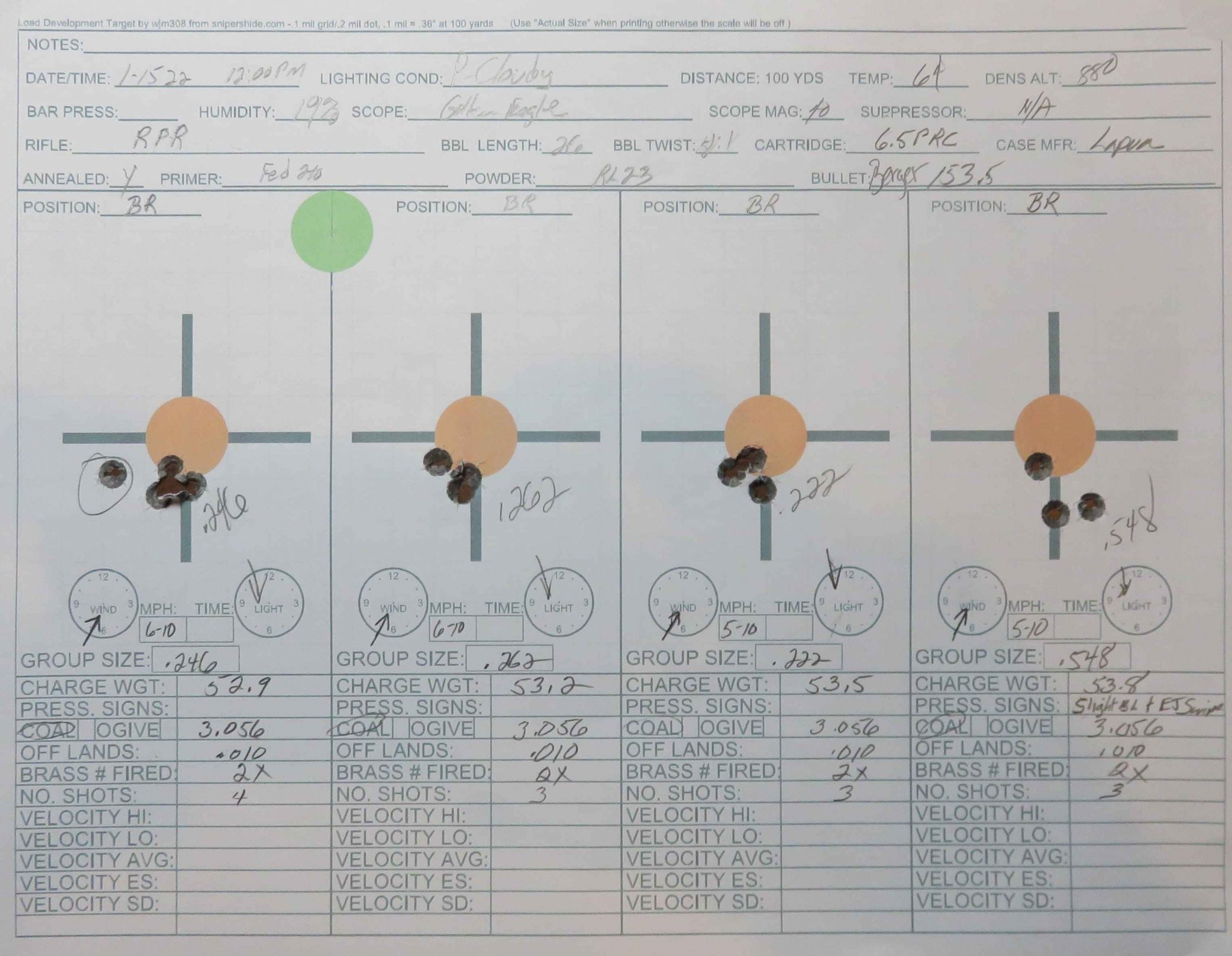

    That's surprising that they shoot that badly out of your gun, even if it's factory loads.
    If you're reloading, I'd guess you just need to find the right powder combination??? 🤷‍♂️ I love them out of my PRC, pushing them at ~2917 fps.
