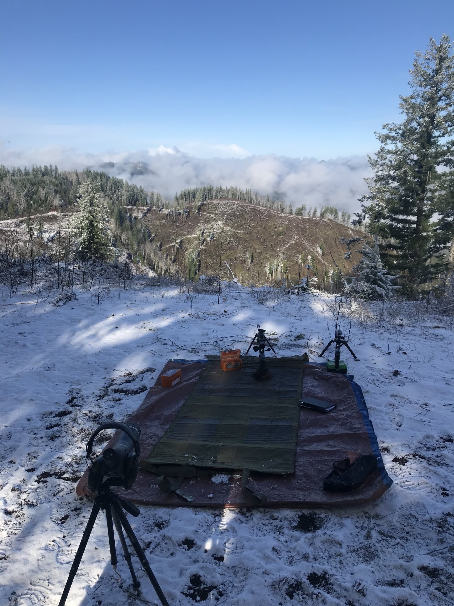

with numbers at 100, 775, 1050 and 1810 yards with a speed of 2920 G7 BC of .375 jived on ballistics AE.
with a bit of coaching on position and how to titty squeeze the rear bag my Canada buddy got a first round hit at 1050 and nailed the second as well.
He’s never shot a rifle past 100 yards before.
yes my spotting scope is a tragedy.

What a beautiful place to shoot!
So the berger and eldm are same nice. Ive heard of bergers blowing up but with high speeds. Yeah nice place to shoot where is that

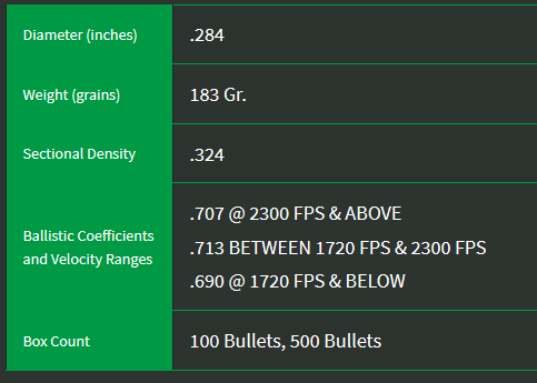

A little odd how Sierra breaks out the BC on the 183. It's got a "Goldilocks" zone between 1720-2300 fps.

The 183 from Litz's book:
Above 3000 .815/.386
3000-2500 .769/.381
2500-2000 .743/.373
2000-1500 .703/.373
Below 1500 .672/.378
Avg 3000-1500 .736/.377
