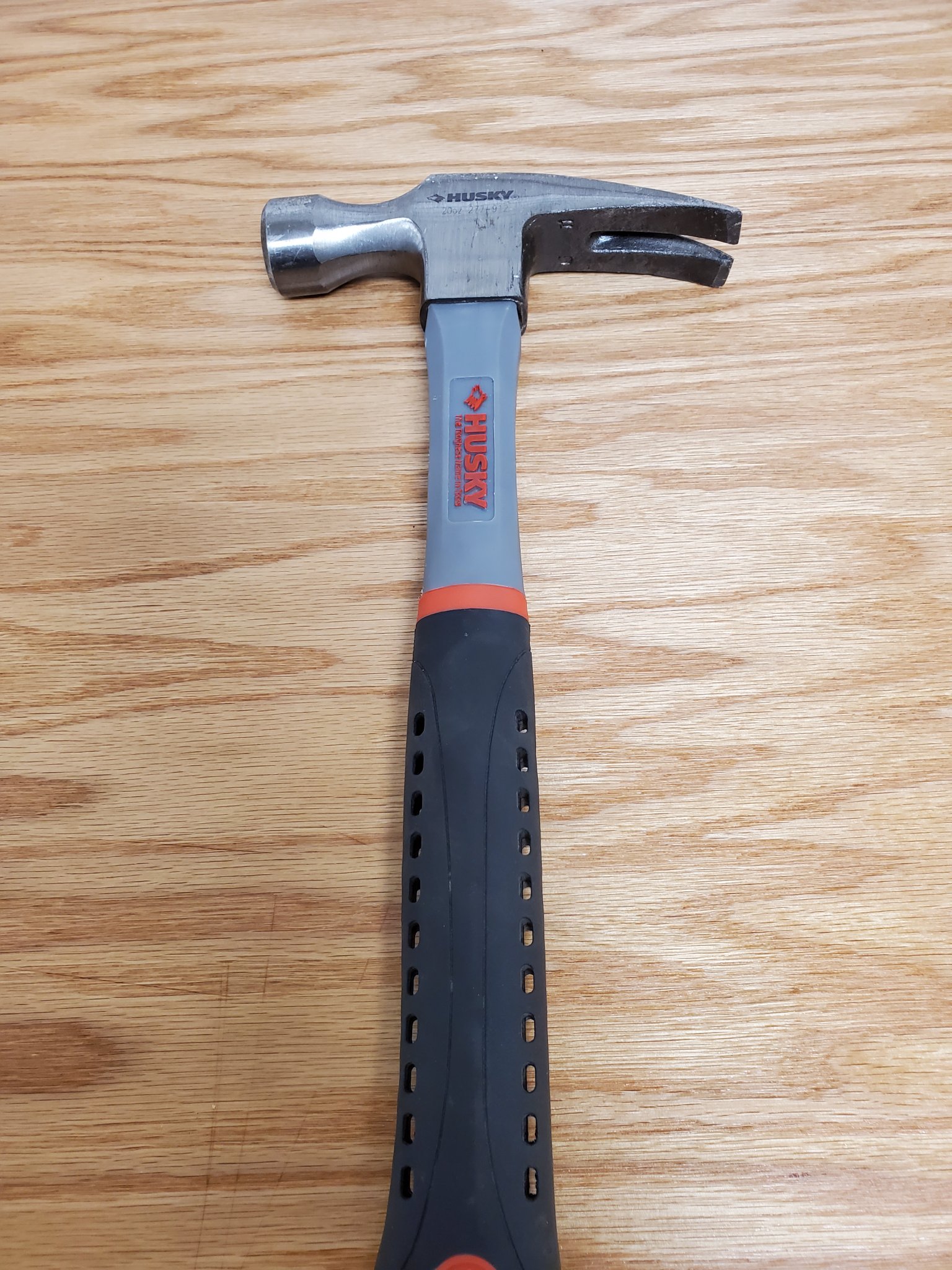

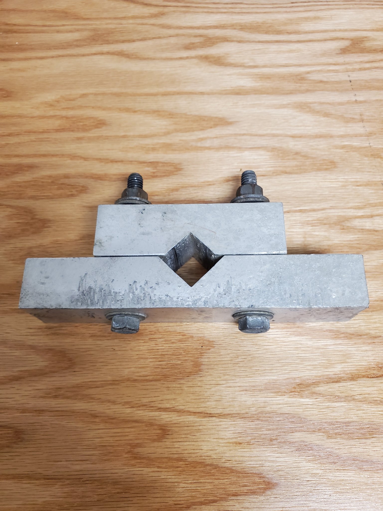

Hi,
Built this about 25 years ago...
If you add this to it..all bolt actions become quick barrel change.

I thought about doing what Theis did in lieu of the Ross vice, but didn't have the scrap or the time to mess with it when I needed it. The material+my time was Ross vise money.
