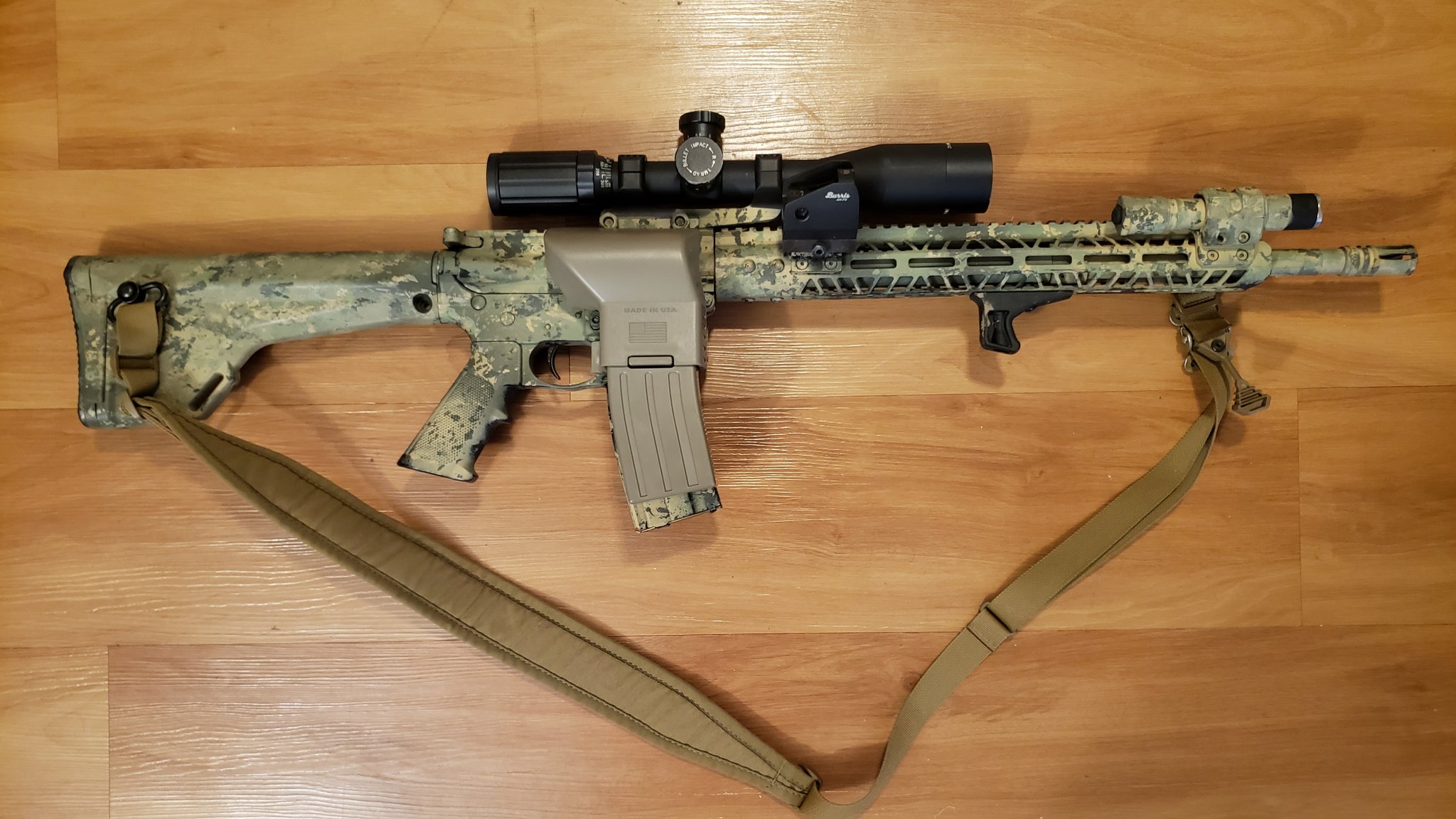

My attempt at GP rifle.
The PST G2 3-15 with RMR in a Larue mount have worked out well

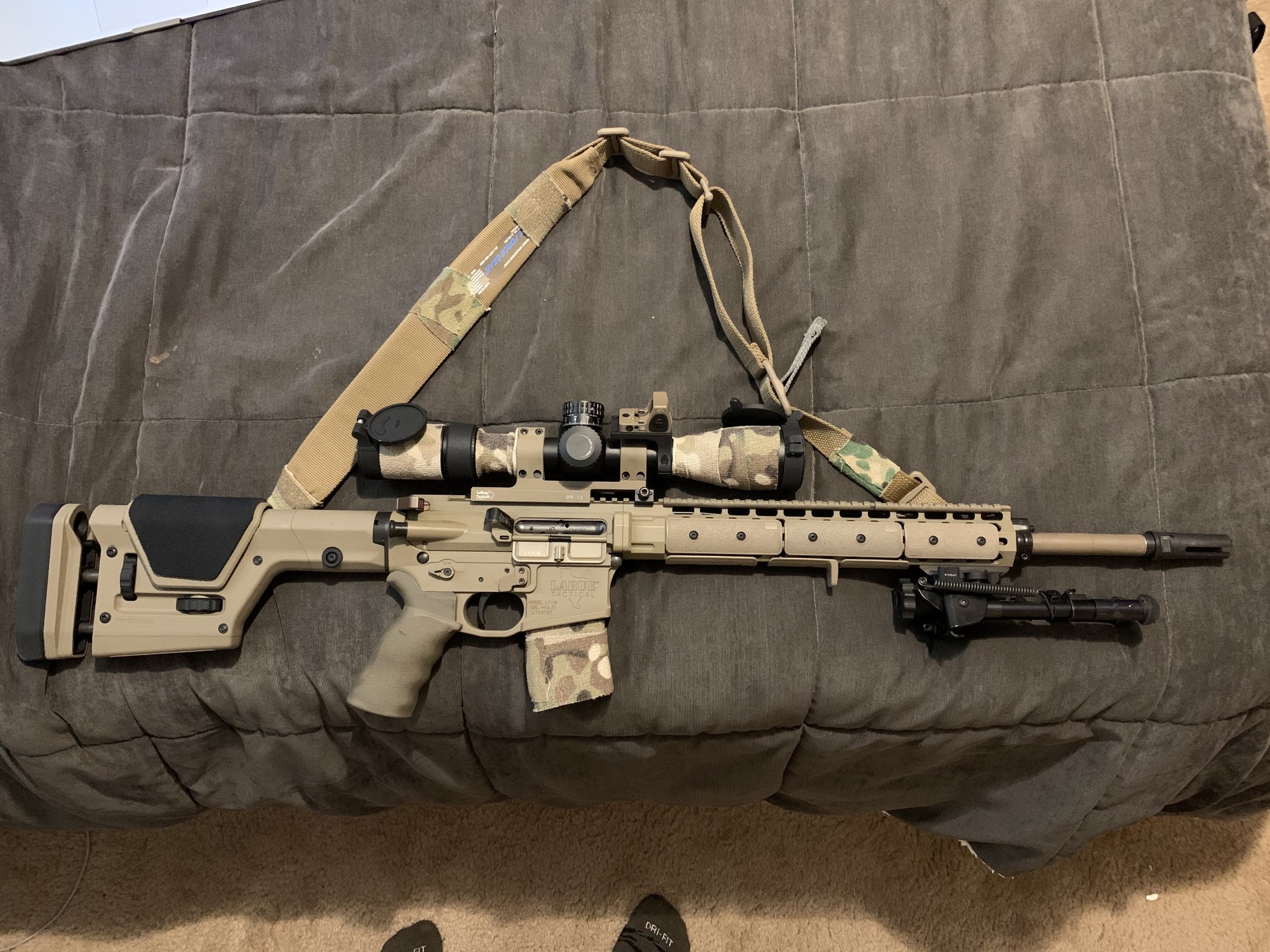

These are just a few from 20” down to 12”.
Top is set up for distance out to 1200yds with Leupold HD.
18” LaRue set up for intermediate range/SHTF with GRSC Japanese LOW 1-6x24
16” Lilja set up for hunting/intermediate range DMR with Burris 1.5-6x
12” set up for SHTF/intermediate range SHTF/HD. That set-up surprisingly got me out to 800yds on 36”x24” steel buffalo TGT with 9/10 hot rate with 2 different types of factory ammo, the 123gr Hornady AG and Federal 120gr OTM Match, which have some of the lost BCs of any factory loads out there. Elevation was 6600ft, so air is thin at that range.

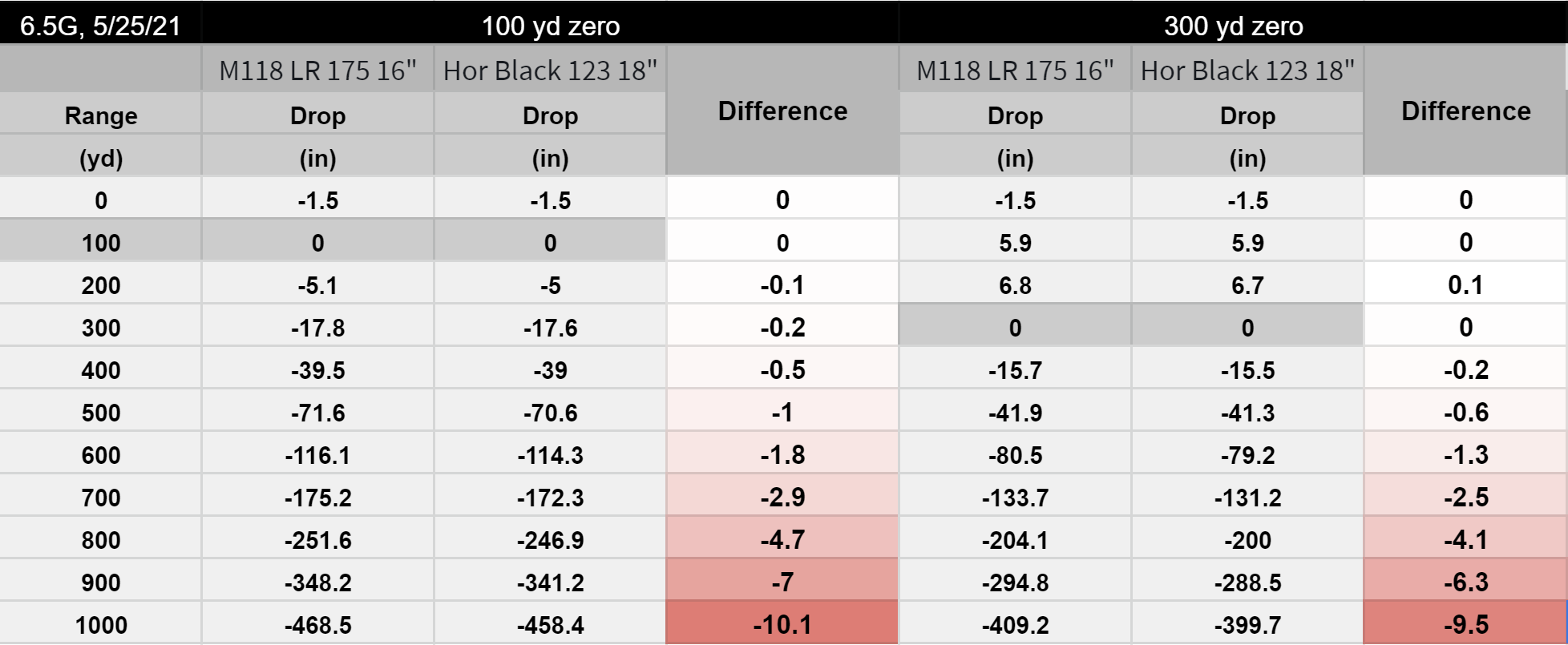

So the GRSC is designed for M118 LR (175 grain) ammo fired from a 16 in. 1-10 twist barrel .308 rifle.
I see the recommendation is to zero different loadings using the 300 yd stadia at 300 yds and everything else should be serviceable? Let me do the math.
Another reticle with circles for head estimation that correspond to the range-specific stadia. https://www.badassoptic.com/how-to-use-acss-hud-dmr-reticle/
Ed's reticle seems to share that feature with a few reticles, some older it appears. An even bigger subset use vertical and horizontal stadia but I can see the argument that the head, being almost a sphere, is most consistent in reference dimension from any angle.
If I am not twisted around, the GRSC and the Arrowhead are almost the same optic with almost the same featureset at similar prices, except the GRSC is FFP which I thought was more costly to manufacture effectively? But you're right, I am not so interested in SFP.

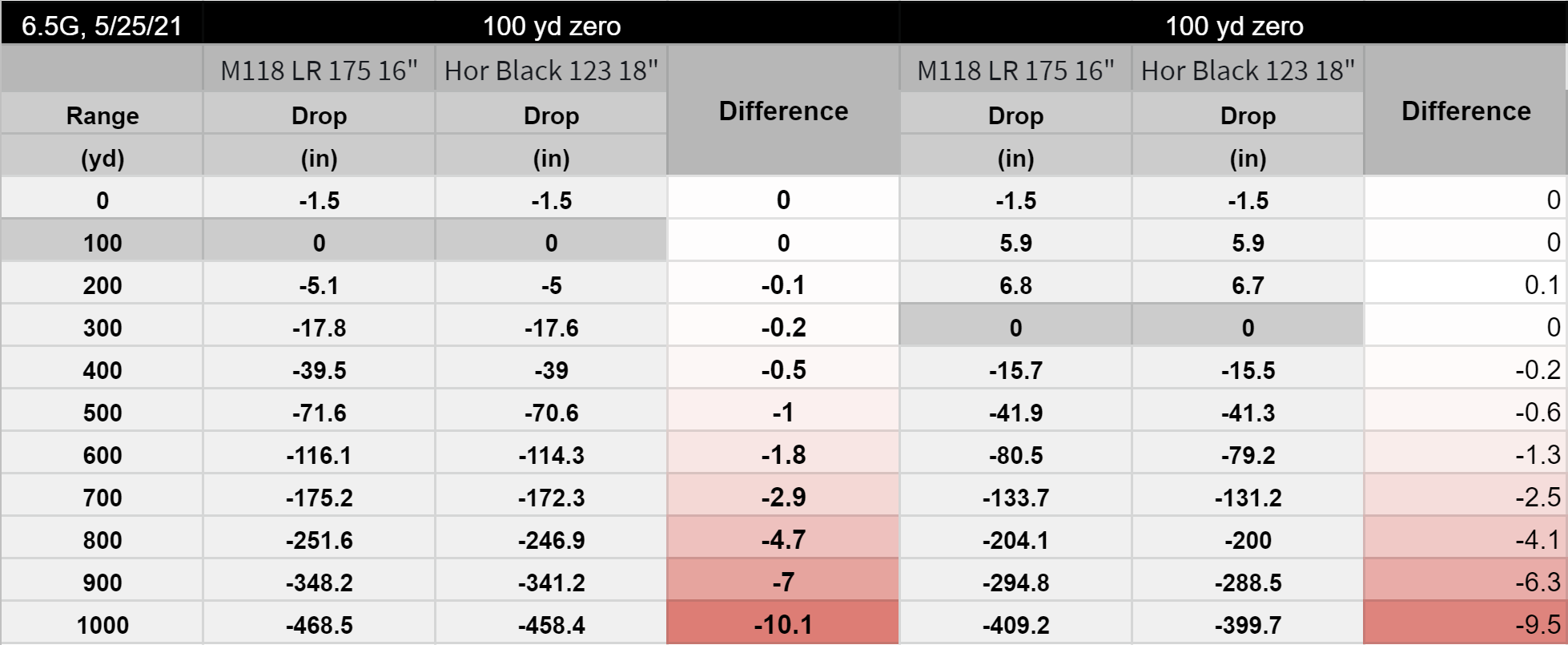

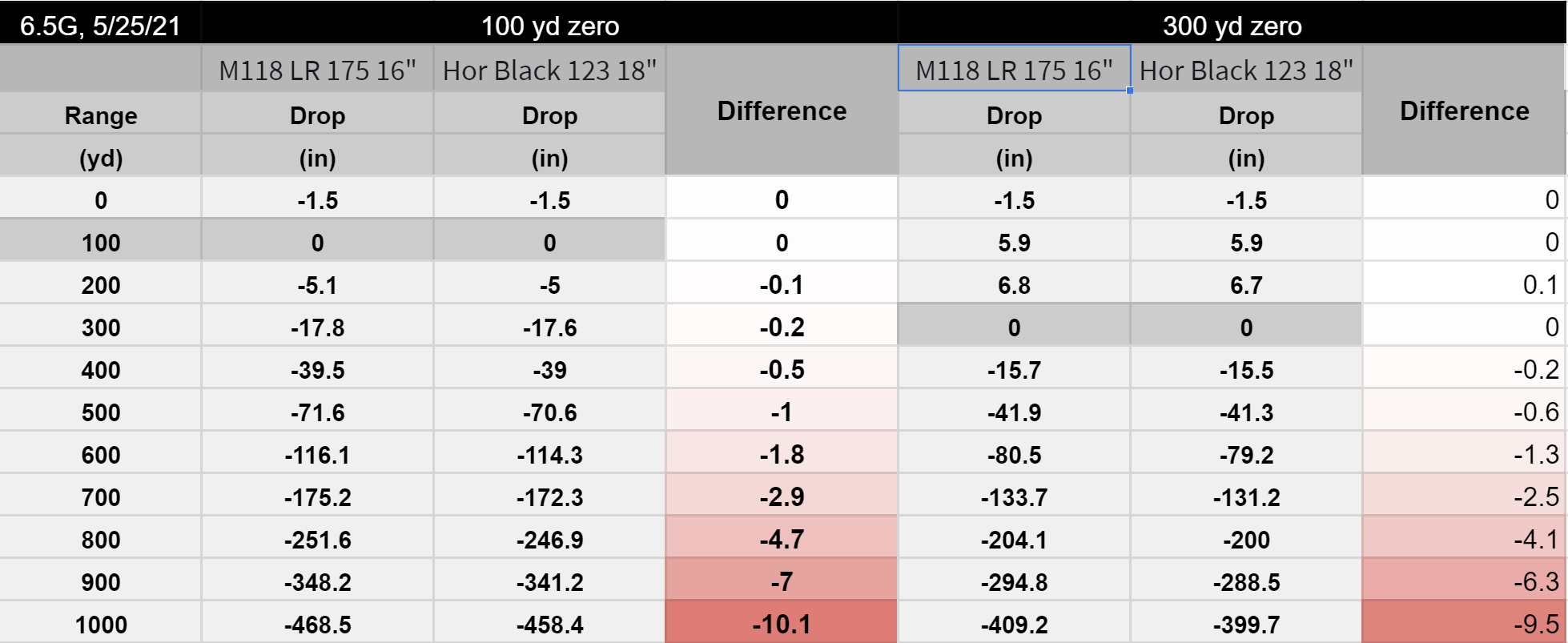

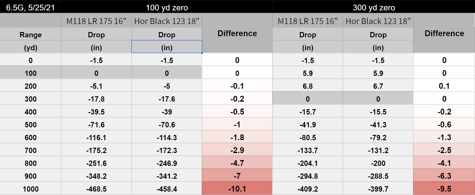

The trajectories at hand. Pretty photo, and raw data to make it easier for people to copy. Am I missing something or is the GRSC reticle for the M118LR out of a 16" barrel a bad fit for a 18" Grendel? Really diverges after 600 yards. But I guess I'd be dreaming to try to do much with a BCA past that, and the class/the range with a student discount are max 600.
6.5G, 5/25/21100 yd zero100 yd zero300 yd zero300 yd zero
M118 LR 175 16"Hor Black 123 18"DifferenceM118 LR 175 16"Hor Black 123 18"Difference
RangeDropDropDropDrop
(yd)(in)(in)(in)(in)
0-1.5-1.50-1.5-1.50
1000005.95.90
200-5.1-5-0.16.86.70.1
300-17.8-17.6-0.2000
400-39.5-39-0.5-15.7-15.5-0.2
500-71.6-70.6-1-41.9-41.3-0.6
600-116.1-114.3-1.8-80.5-79.2-1.3
700-175.2-172.3-2.9-133.7-131.2-2.5
800-251.6-246.9-4.7-204.1-200-4.1
900-348.2-341.2-7-294.8-288.5-6.3
1000-468.5-458.4-10.1-409.2-399.7-9.5
Look at how closely they track. They’re practically dead-on with each other.
You can’t resolve or hold 2” difference at 600yds with that reticle, or most precision rifle reticles even. That’s a margin of error far finer than your heartbeat or breathing control effects on the reticle even from prone/bipod/rear bag.
Those drop charts show how ideal the 7.62 GRSC reticle is for 123gr Grendel, which we already know from running ballistics on them for years and seeing how a 123gr in the .5 G1 BC region from the same barrel length matches M118LR from the same barrel length.
I’ve been watching the whole saga with that reticle from the beginning, which dates back. Ed came up with it well before anybody else, went to all the optics manufacturers at SHOT and their own facilities on a campaign to get that reticle into LPVOs for Designated Marksmen and Dismounted Infantry soldiers. Every single optics manufacturer told him they weren’t interested, it would never sell, wasn’t right for them, etc., then the next year or so, they put a dumbed-down horseshoe reticle in their scopes. ACOG was the first one if I recall, then others followed until practically everyone has a horseshoe reticle, but without the ideal graduated ballistic stadia and rule of 10 circle intuitive ranging and indexing system.
