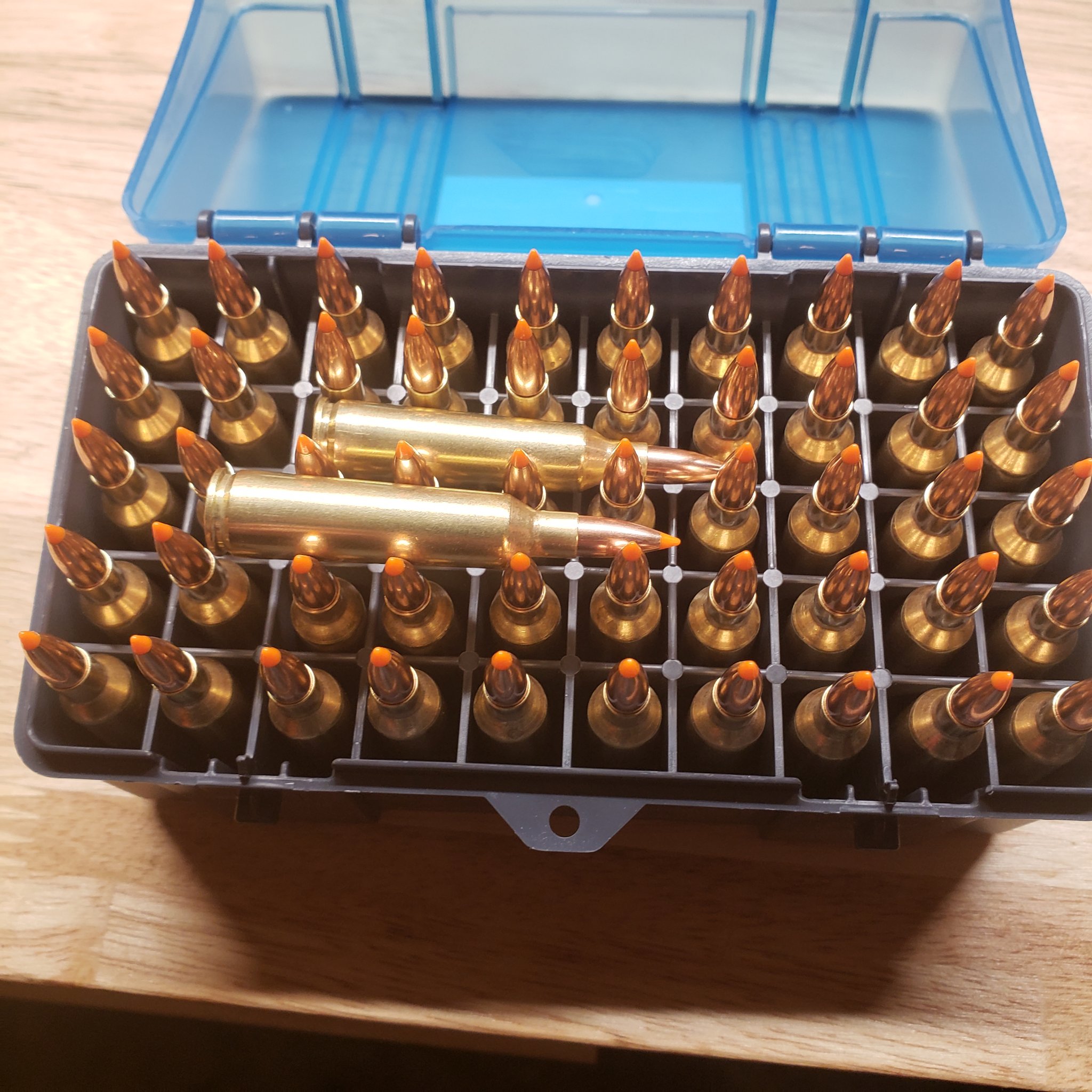

I am using Nosler 55gr Ballistic Tip Varmint bullets loaded to 3500fps. It is a brutal load with next to no pelt damage. Here is a pic of 52 of them.
