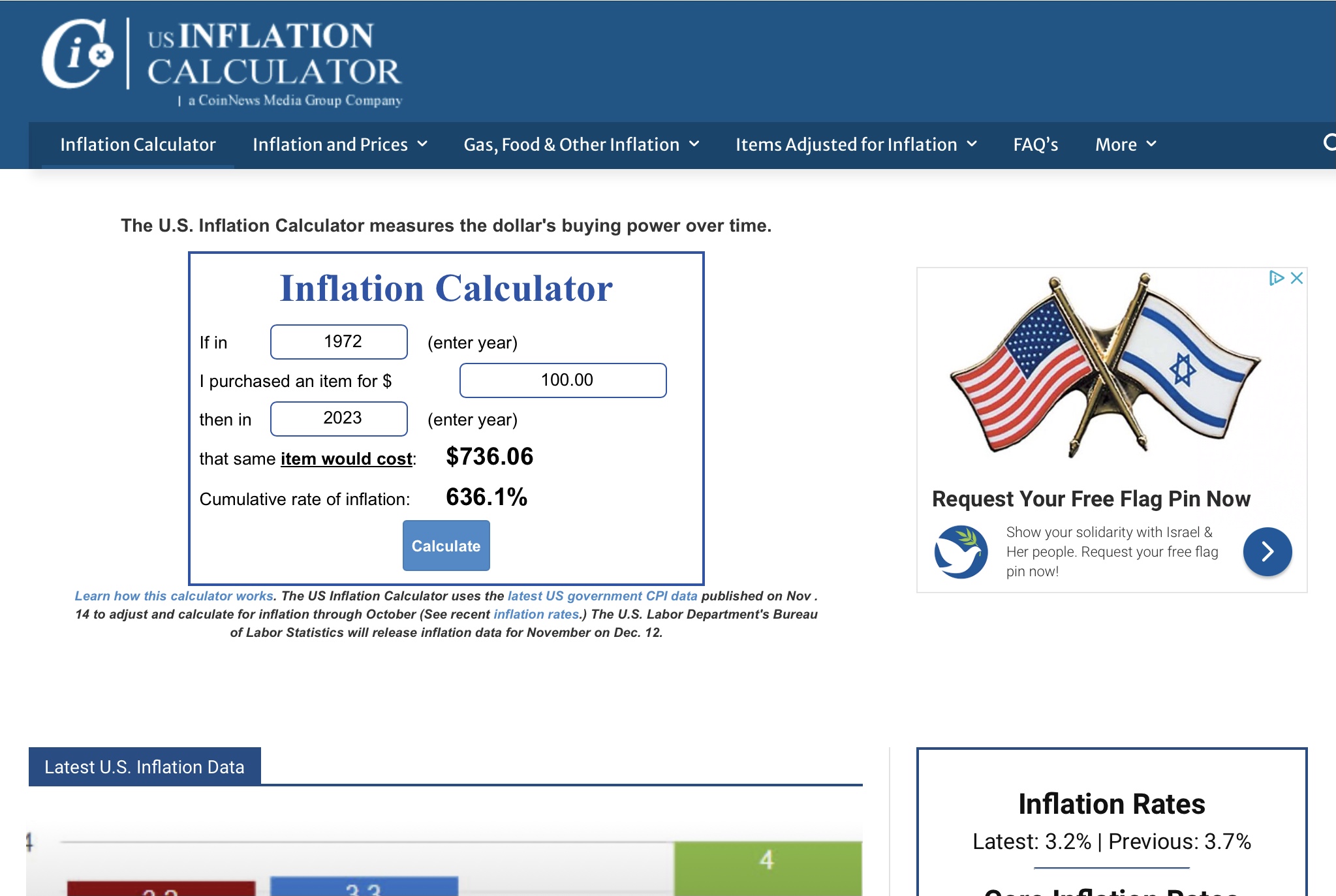

When I started reloading in 1972 I bought:
RCBS Rockchucker single stage press
RCBS Powder measure
RCBS powder funnel
RCBS Powder trickler
RCBS Primer flipper
RCBS shell holder
RCBS lube pad
RCBS case lube
RCBS deburring tool
Ohaus 1010 powder scale
RCBS .243 Win dies
100 rounds Hornady .243 brass
100 Hornady 75 Grain Hollow point 6mm bullets
1 pound IMR 4350
1000 CCI LR primers ($6.00 as I recall)
a white plastic no name micrometer
And a Lyman reloading manual
Total cost was right at $100.00
I was making $300.00 a month at the time that summer. Still in HS.
$75.00 a week @$1.10 hr for 68 hours washing dishes in a popular burger joint.
But I had cash money and a ‘62 VW Hand-me-down Beetle that took about $2.00 to fill up.
Great times.
Checking the inflation calculator It seems it would be a lot more today to get started:
