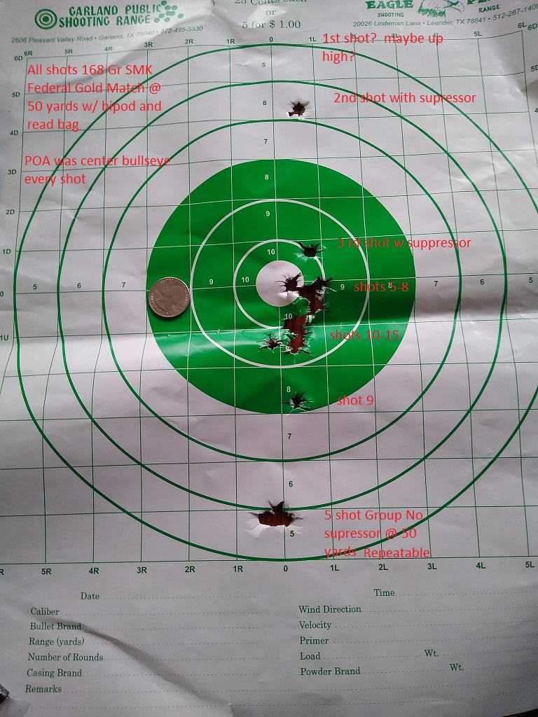

Something is mighty wrong. Here is the results from today. I finally chased it onto the paper and POI moves with successive shots.
My 5 shot group at the bottom, no can for comparison.
50 yards (no 25 available today). all 168 gr Federal Gold Match. My standard was low as I was chasing the zero all afternoon, but this shows what is happening. My zero with no can is repeatable. (the target before, when i finally pinned down the verticle stringing my group is in the same spot relative to point of aim. I did everything I could to make sure the can was on good and tight--interestingly enough this vertical stringing is repeatable.
