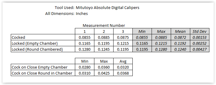

After working my way through this thread, I'm at least going to share my measurements with Zermatt/BigHorn and see what they recommend, if they'll send a piece out or if I need to send my stuff in to get timed. I assembled the entire rifle myself with a TriggerTech Primary on the BigHorn Origin. I noticed the lockup of the bolt was really stiff and felt like more than just "new part" stiff. When I asked BigHorn about it they said that it would improve over time, but then I found this thread and did some measurements. I measured the indicator protruding from the back of the bolt as instructed and came up with the following measurements. I took 3 measurements for three different conditions, bolt open (cocked), bolt down locked on an empty chamber, bolt down locked on a round in the chamber. Basically, I got ~0.035" +/- 0.002 inches.
I have not fired a round through the gun yet. I don't know if there's any concern with doing so (potential jam of the cartridge in the chamber or something?). I'll see what BigHorn says, and it was good to get some similar numbers as a few people referenced a CoC of ~0.030". It is kind of tricky to measure since the bolt shroud is not flat in the back.

Any and all comments on my situation are welcome.
Update to my issue. I sent pictures to Ray at Zermatt/BigHorn and he made it sound like I had updated stuff, and he sounded surprised by the issue (which surprised me given this thread). When I broke down the rifle to ship him the action and trigger, I noticed the problem went away. Turns out, the front action screw was ~0.020" too long, and slightly interfering with the bolt lugs during lockup. I ground the screw down a little bit, reassembled it, and the bolt operates without any resistance. Hopefully, this information helps someone in the same situation. The action is in a KRG X-Ray Gen 4 Chassis.
Oddly enough, I think I would have discovered the root cause earlier if this thread did not exist, or if the bolt had a more defined interference than what I was experiencing. I'm actually glad I went through the process of disassembling. It seems like a pain, but sometimes taking it all apart and watching out for a specific issue is the way to go.
