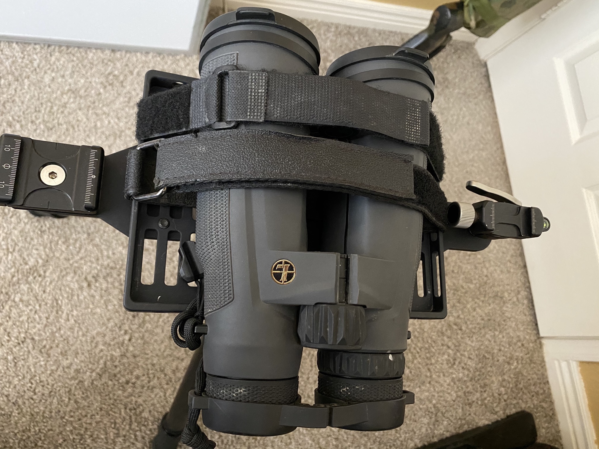

I’ve used them all and the most vibration free is
an abel table with a solid ball head.
this is my setup and used at the top of the hill during the NF ELR where we had 60mph winds
the wind speed right before I shot
the RRS cinch is great for quick on off in a hunting scenario but for allday spotting I like the binos being centered on the ballhead
this is my setup and used at the top of the hill during the NF ELR where we had 60mph windsView attachment 7362512
this is what I'm using, tripod with ballhead. I see the table youre using, but how are you mounting those binos' to that table?
perfect. that's ideas I'm looking for. thank you. what Leupold binos is that?
Leupold bx-5 15x56

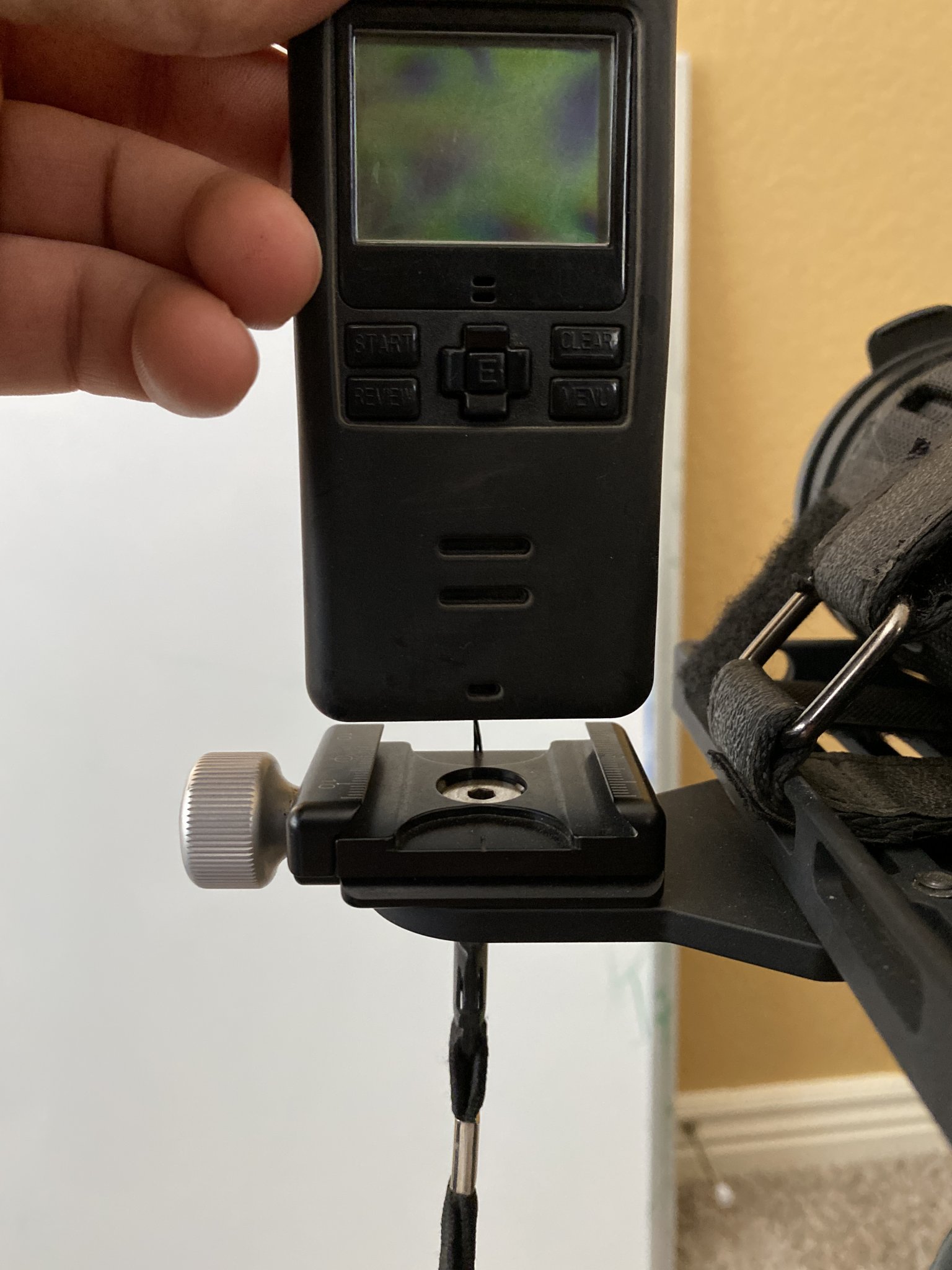

Very nice!! WTG on the setup. What's the RRS Arca on the left for?
Best,
JAS
few things, sometimes I’ll mount my spotter 45 if I need more magnification and a reticle for calling corrections. The other thing I’m making right now is a 3d printed mount to hold my shot timer so I can see it out of the corner of my eye while ROing

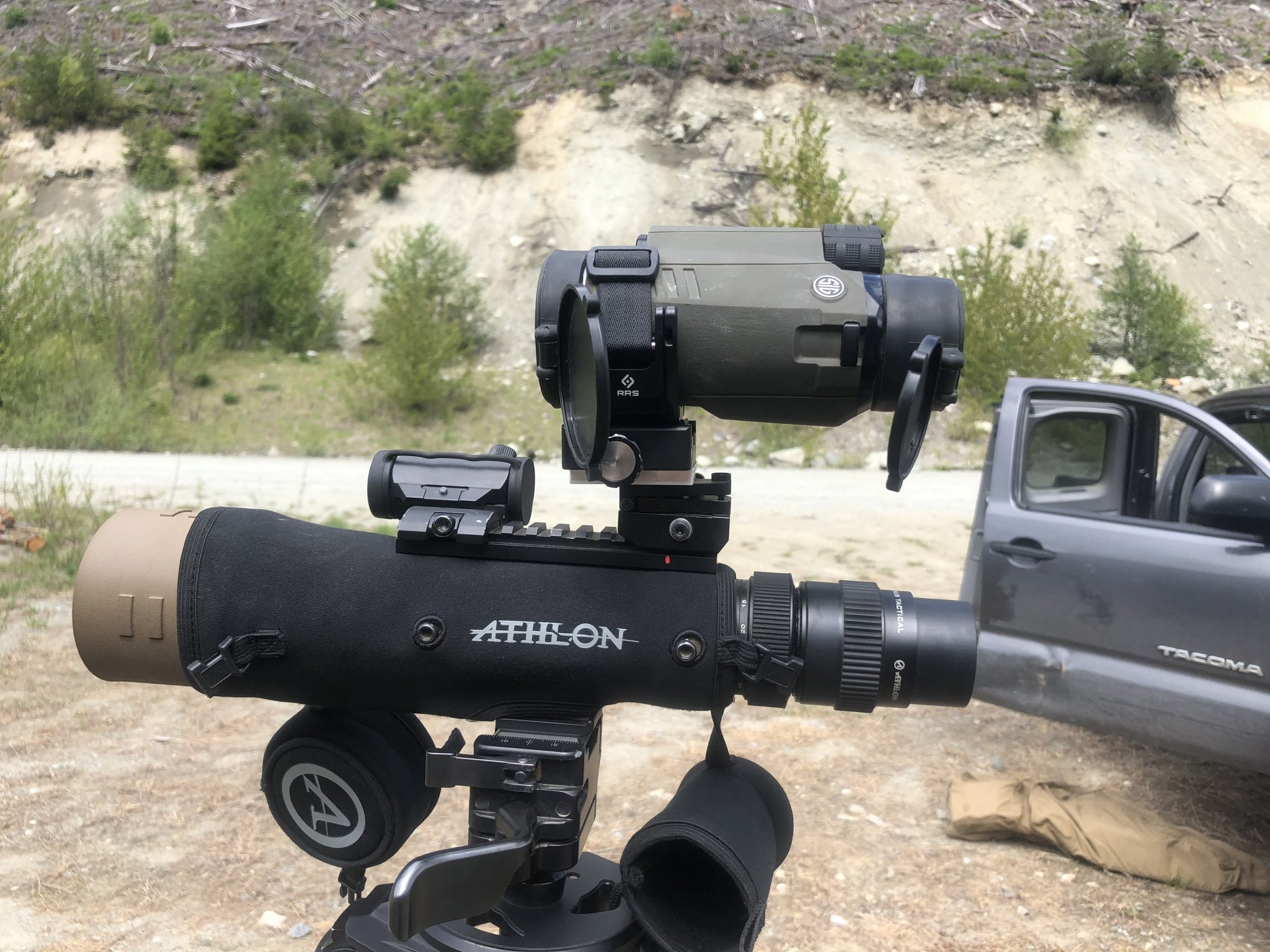

I'm a big fan of the RRS Cinch. I keep mine on my Kilo 3000s permanently. Still fits in my bino harness but quickly and easily attaches to my Anvil-30 or to my home-brew co-aligned adapter on top of my spotter.

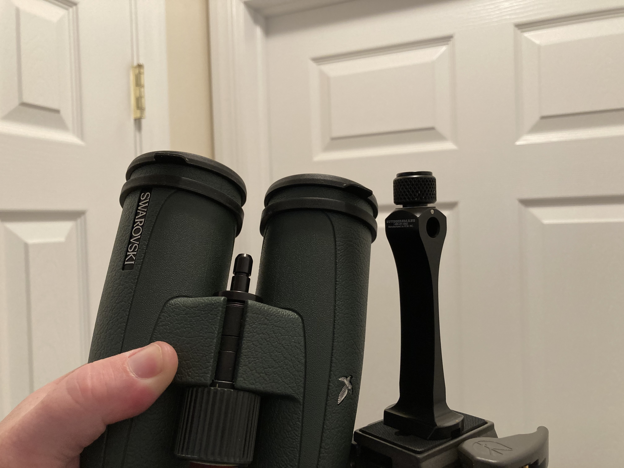

I’d recommend the Outdoorsman Bino adapter. Has a stud that screws in the front of your binos and allows you quick release function.
How solid/steady of a mount is the Outdoorsman? I'm seriously looking at going to one for my Sig3000BDX LRF binos. I'm currently using a BOG bino cradle on a ballhead works fine but trying to cut weight and bulk in my pack. I wish that I had initially gone with the Precision Rifle Solutions Universal Optics Tripod Mounting Plate but forgot all about them. That plate looks small enough that it would fit in the 5.11 pouch that I carry my Sigs in without having to remove it.
It's not going to be a solid as bino's strapped to a plate. The bino stud is round, as is the post hole it goes into, thus it will be able to rotate a little even with the tension knob tightened down (knurled top piece). That being said I've found it to be extremely stable in normal conditions, but have not tested it in higher winds.

It’s very stable. I have the adapter screwed to a ARCA plate that I use with my ball head. The main reason I went with this was weight savings. I too had the bog pod and made a homemade bino cradle but after carrying it around all day at a match I had enough. Went with a Leofoto tripod and ball head, and with the bino adapter and binos I cut my weight by more than half. I’m running the Viper 12x50 HD binos. I’m very happy with the setup plus it’s a quick disconnect. I’d suggest getting one and trying it and if you don’t like it send it back.
